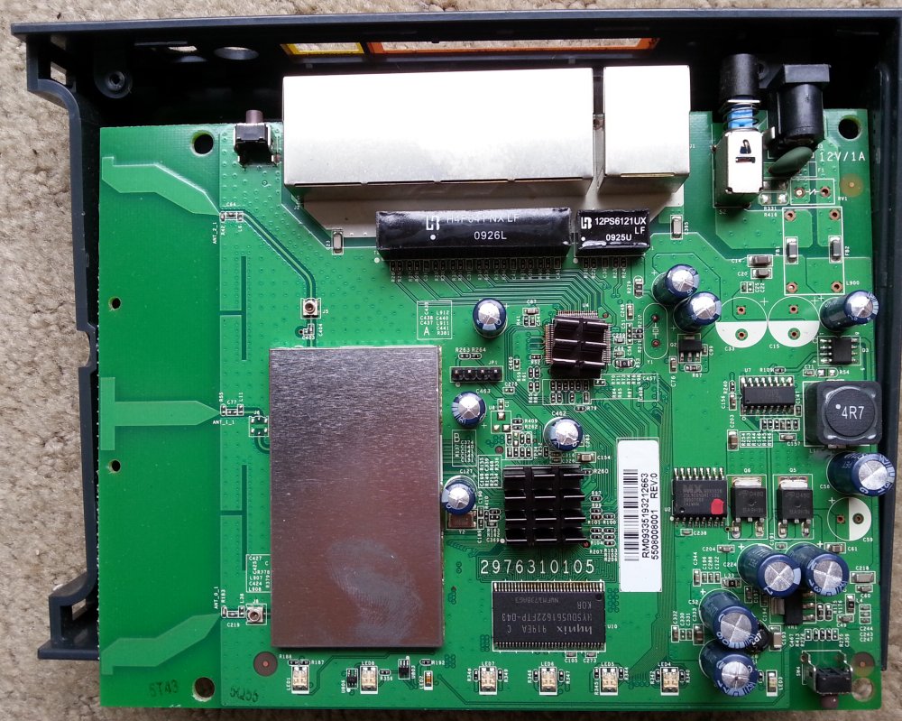

    On a Netgear WNR2000 (v1 - no version suffix on model label, with the FCC ID being PY308200083), I found a lot of bulging LTEC units inside being all of the 100uF 25V units and the 470uF 10V unit.
    When all of the LTEC units were replaced, the unit works perfectly, and I am now contemplating converting this unit to a wireless bridge (enable the connection of wired-only devices to a wireless network) with OpenWRT firmware.
