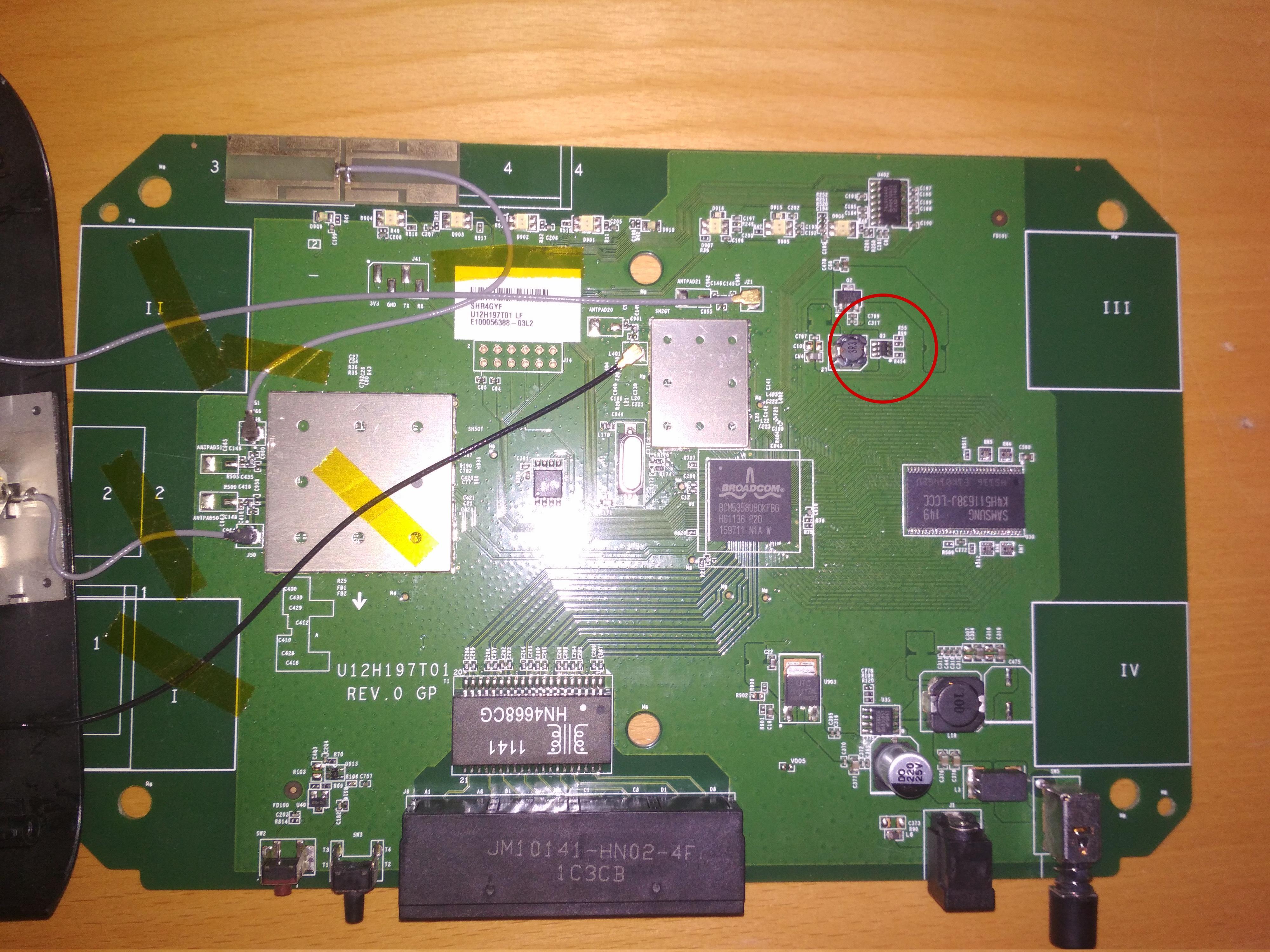

      I found a schematic for the WNR200v3 so maybe it exists somewhere. I have already created a few subcircuits myself. Unfortunately, I can't identify a component that has broken (marking F42A 1K (1K crosswise)) . But that probably belongs in a different thread.
      Furthermore, I have not yet found a data sheet for the broadcom bcm5358ub0kfbg chip.

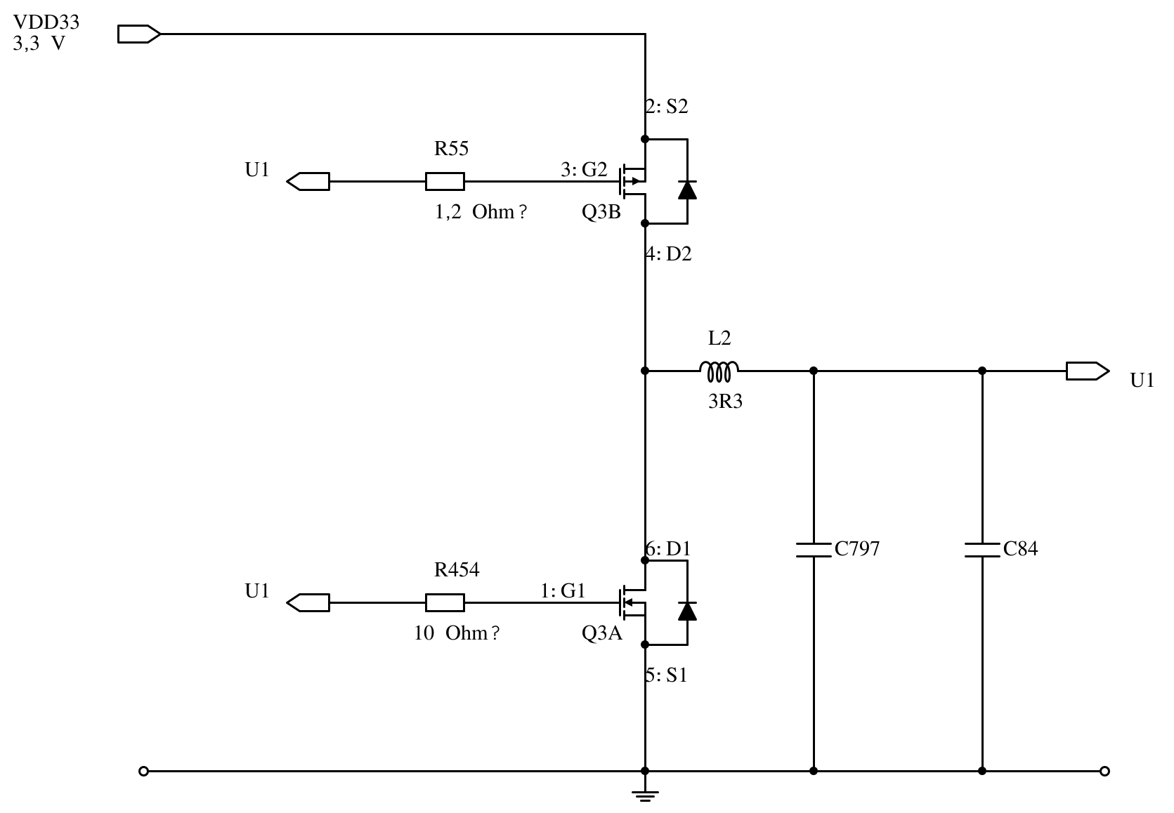

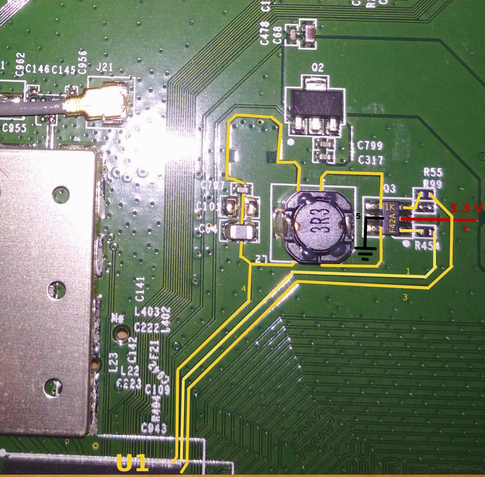

        So here are the subcircuits that I created myself. Without guarantee. Among other things, Q3 is broken but so far I have not found out what kind of component it is (marking F42A 1K). Maybe someone here can help me.

          a guy told me the component Q3 is the AO6604 mosfet by A&O.
          So I soldered the component in. There is now 1.2 V at the output (pins 4+6). Unfortunately, the extender is still not working correctly. The diodes light up as follows (all continuous):

            Have you connected a serial console ? It should be J41 on your picture
