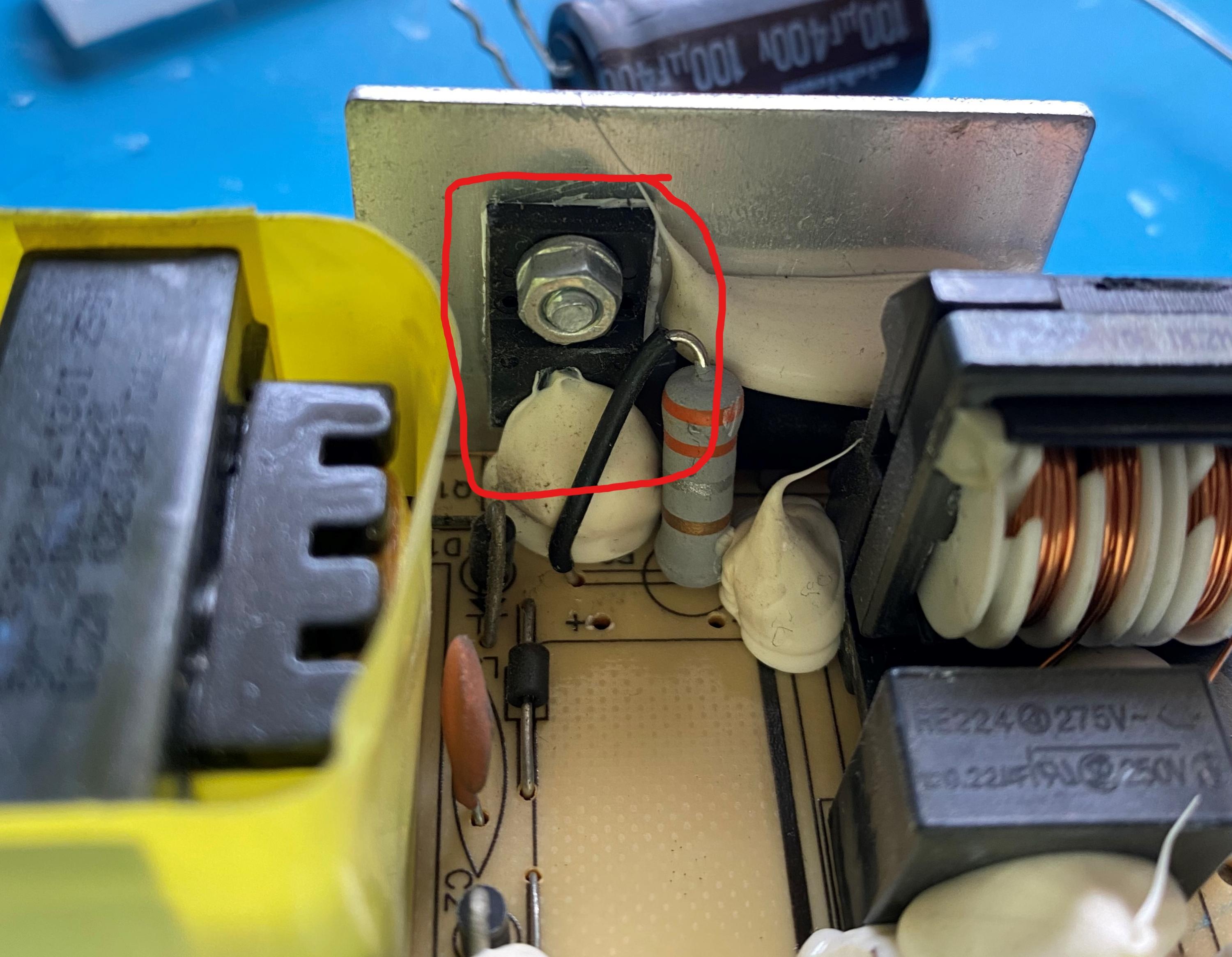

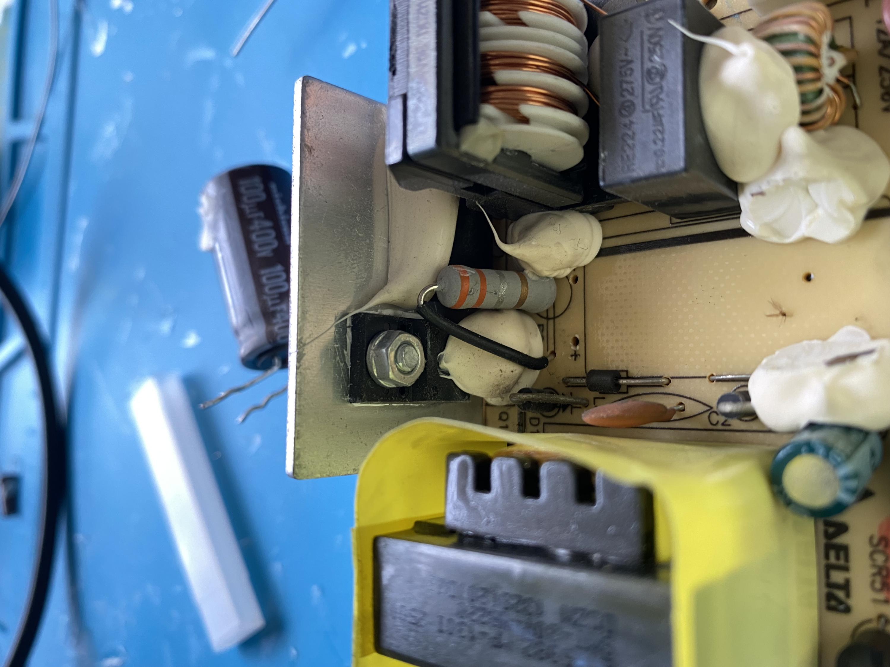

          Not so lucky for me so far. My Netgear GS716T died last night and it has a Delta ADP-40VP power supply in it the same as the others on here. Found this forum thread and promptly popped out the 47uf cap and replaced it and no difference...still dead. Pulled out the 400V 100uf filter cap and it's got 90uf...bought a new one...new one is 97uf so not sure if that's the issue. Kept tracing and noticed the big resistor at the filter cap legs (Orange, Orange, Silver, Gold) My resistor chart says 0.33 Ohms +/- 5%. When I measure across it I get 22kOhms.

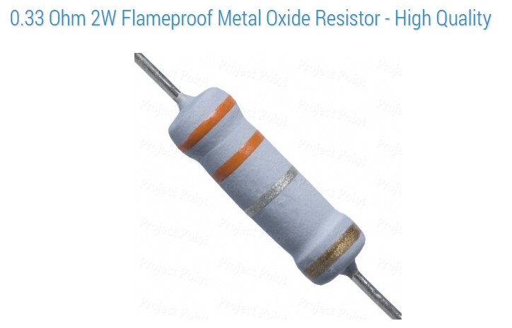

          Before I rush out and buy this one too...is it supposed to be 0.33 Ohms? I'm pretty sure 22k Ohms is wrong.
          thanks for any advice.
          Update...found this pic and I'm pretty sure this is the same type of resistor. Can I measure this type the normal method...resistance setting on my fluke?

            the resistor acts as a fuse - something is probably shorted.
            most likely the big chip/transistor hiding behind the white stuff

              Do you think it's the part I circled that's most likely to have taken out the resistor?

                probably, you can meter for shorts between its pins on the other side of the board.

                  If that resistor blew, chances are good for the FET to be blown too. Now if the FET blew too, you have to check the whole gate drive circuit of the FET.
