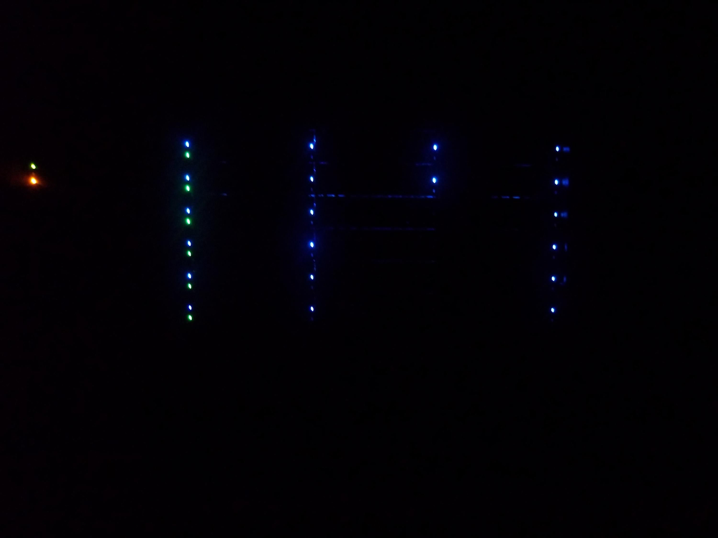

          I spent 3800 on my server.
          $420 norco case 24 hot swap bays 8087 sas/sata backplanes
          $199 supermicro board
          2 or $3something on E3-1230 cpu
          $120 16GB of ECC Kingston Ram,
          $429 each for two LSI HBA 4 Port 8087 cards,
          $169 each, eight 3TB drives
          and a couple of other things. I moved the old corsair 750w and 6 1TB sammies, two WD RE 500GB, two seagate 1.5TB and a 2TB sammy from my old fileserver to the this new one.
          I bought a USB 3.0 card for my mythtv usb tuners, and recently my first seagate cheetah 15K drive to fool around with, I was disappointed with it, since it's performance sucked ass according to other drives from WD and Hitachi. That's why it was a refurb on newegg and so damn cheap $54. I end up using it to migrate the O/S on the old maxtor pata drive.
          I used my vacation pay and some money I had saved up for a road-trip that never happened. I finally paid it off last month. It was built in June 2012.
          I'll be honest, I'm very proud of it and I treat it as my baby, you guys have your cars, I have my server.

              It's my fileserver, mythtv/mysql/httpd, print server using CUPS, then running in KVM is pfsense router, personal web server, pxe boot server, and WSUS server.
