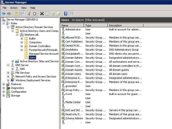

                            Re: Anyone Experienced with Server 2003 TS & AD ?
                            Originally posted by Toasty
                            How are or should the 2 DC's be joined? As I said, this is very unfamiliar territory to me.
                            If both controllers are active and on the same domain then they should already be joined.
                            Why would running the 2nd DC on APP be a bad idea?
                            1. Security
                            2. Stability - less stuff running means less chance of crashes
                            3. Microsoft "needs" to sells more licenses, therefore they encourage this idea.
                            Should it be on its own box?
                            Yes for the above reasons, however it is a judgement call in the end.
                            Back to a previous query:
                            The Primary DC (MAIN) should not have users on it, correct? I find a bunch of remote users in its D&S folder, many the same as in TS.
                            I am not sure what you mean by the D&S folder but my (limited) experience is mostly with Server 2008R2 and I am not sure how different it is from 2K3. You are going to have the network users listed under the domain like in the image I have attached (User names erased.) but I am not sure this is what you mean. Only network Administrators should be able to directly log onto the domain controller.
                            What should be on the DC and what should not? There seems to be a lot of replication of applications. Sort of a "backup plan" in case something dies.
                            I would say that is determined by the available resources and risk/reward analysis. If these are all the servers you are going to get and the network being available is more important than security I would leave them alone, but others on the forum may disagree with my logic and have good reasons for doing so.
                            I was also told that to perform updates on TS, I should drag it out of Terminal Services on AD and place it in Computers, then run (command prompt) gpupdate. Once the updates are done to drag it back to TS and gpupdate again. Is that correct or necessary?
                            T
                            I cannot answer this question so hopefully someone else will be able to do so.
                            I just want to be clear that my experience is mostly limited to my personal equipment, studying for MS certs and it is from working with 2K8 R2 opposed to 2K3. Hopefully others with more experience than me will also give you their opinions.
                            I was very glad to hear that you were able to get server back on the domain.
