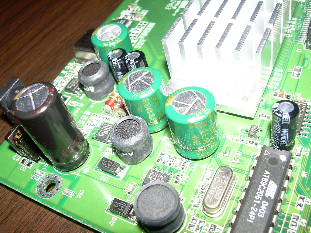

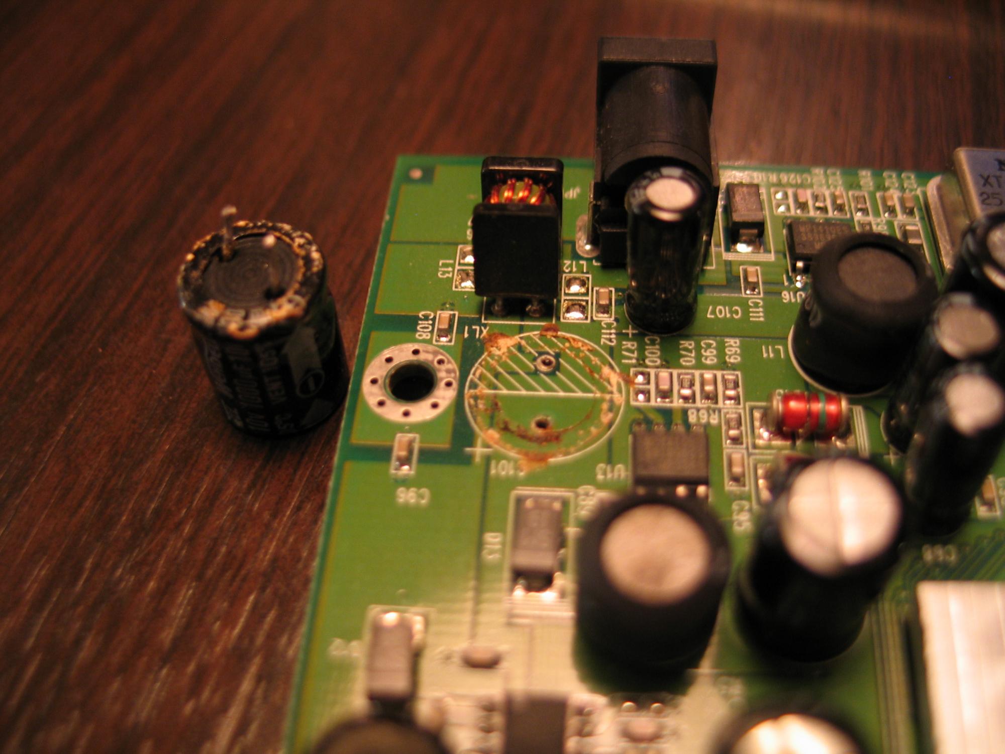

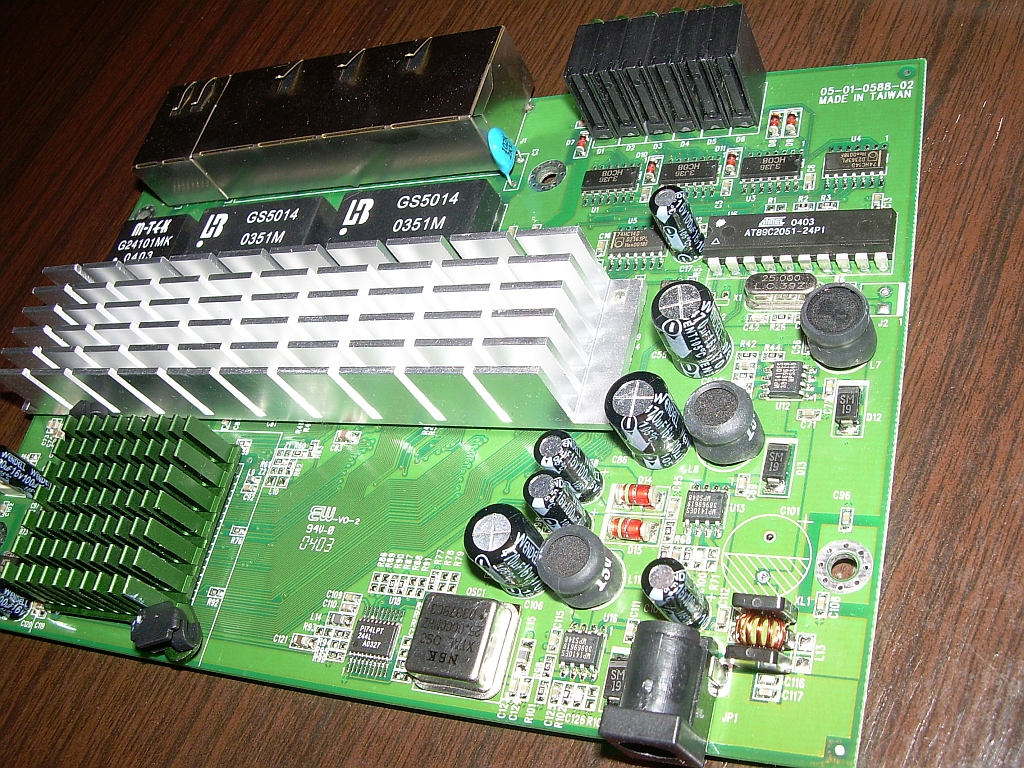

    Found this at the garbage dump - one of the Wendell caps has vented.
    I can not find datasheets for wendell caps at all, also they have no series markings and is only marked as Wendell, uF, volts, vent 105.
    The cap that has vented I'm gonna replace with an fm, also for the 3 470uF that has not yet vented I have 3 Sanyo wx.
    Will the wx series do this job ?

    It's working perfect now.
    Replaced the 4 Wendell caps with fm and wx.

      they should be fine.
