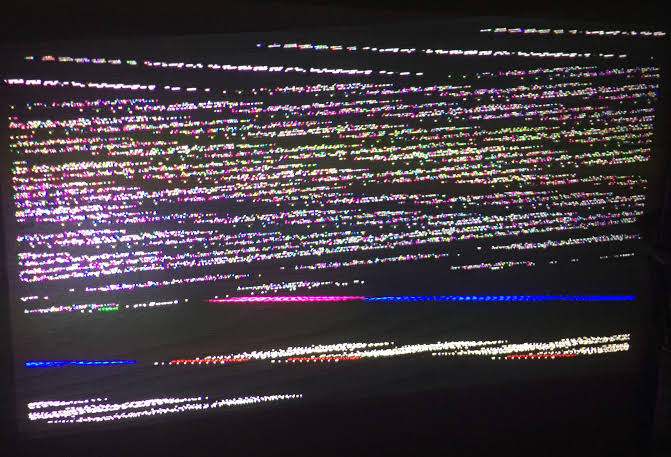

    Hello please anyone help me out
    I have a Gtx 980ti gigabit graphics card The problem is that without installing drivers display is fine but when I trying to install drivers drivers installation failed and garbage in display picture is attached

    Re: Gigabit Gtx 980ti garbage display
    32bit 64 bit system. What driver did you install? What operating system?
      Checked on win 7 64bit & win10 64bit both same issue
        That looks like it could be memory corruption. It is semi-common for these cards to get Ram failure, but also if it is a ram failure then at least it's fixable. Are you familiar with Mats Mods? It is a program you can run on your card that will test the Ram for you and tell you which one is bad if one is bad.
        If not I highly recommend you watch a video from Tech Cemetry he goes over this in detail. It's a bit of a process, but what isn't when working with graphics cards.
