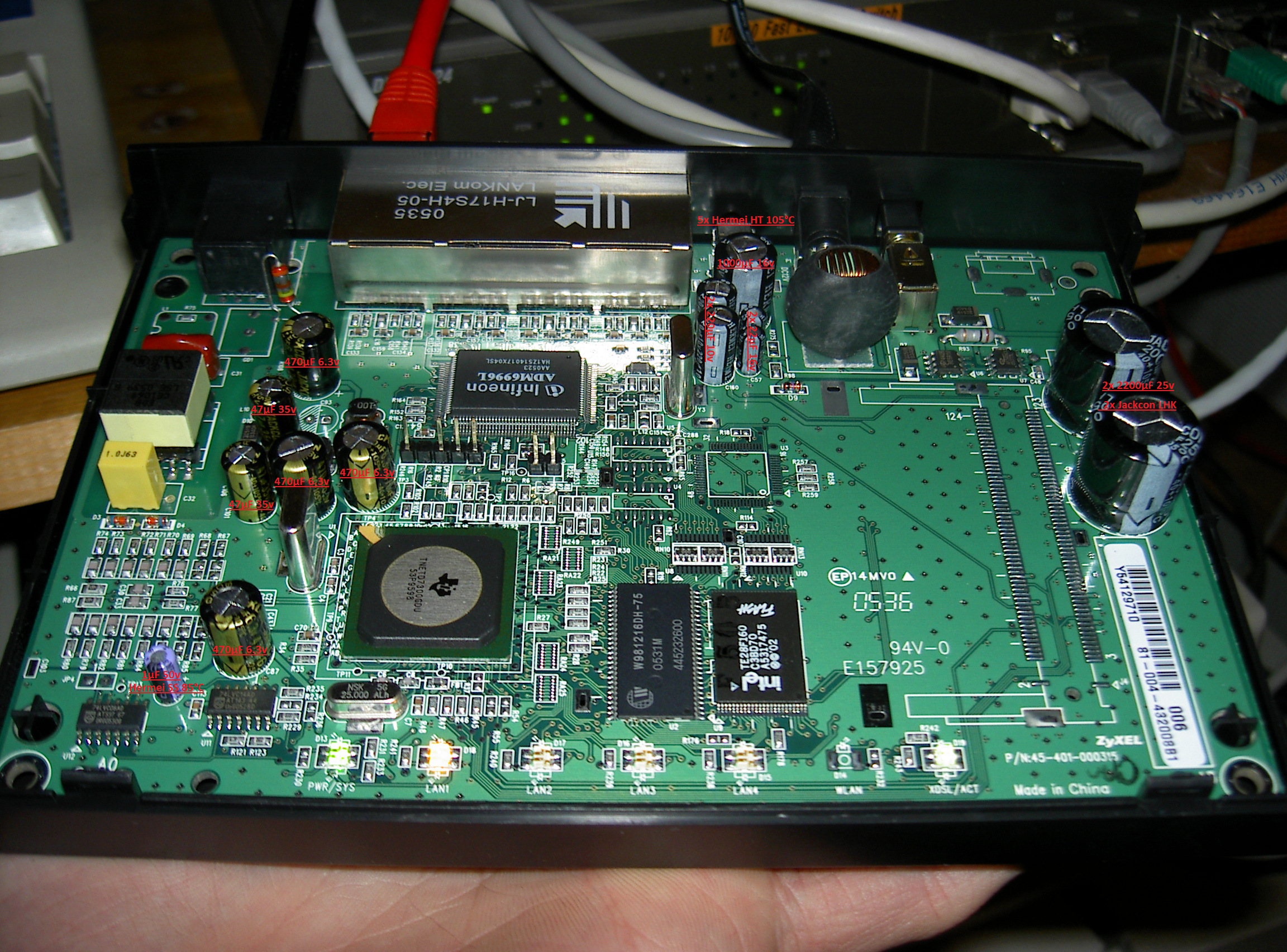

    I've been a dialup user for like 10 years but a few months ago finally got ADSL...
    Well, the "modem" I got for free from my ISP is a Zyxel Triple Play, and I just today opened it up to see what was inside... While the layout looks very good and the total number of capacitors and their values seem well in excess their names where not as impressive: Jackcon and Hermei
    I'm gonna keep it "cabbed" from now on, it's in my basement and it's only like 18°C down there so hopefully it will live a long and happy life... I do have a Cisco 827 ADSL modem just lying on my workbench but it's limited to 8mbps (which is what I have now but when I get around to it and swap out my copper lines in the house I hope to be able to jump up to 24mbps...)
    There is another problem and that is that I do not have a working config for the Cisco modem, I only need regular RFC1483 bridging but I've followed Cisco's guide on it right here without success. I do not even get Sync with the ISP...
    Anyway, on with the picture, I do have more if anyone is interested.

        If one of those caps blow then it could be recapped. ADSL modems sould have the same solder job quality that is done on motherboards.
        Am I seeing things or those two big Jackcon caps in Per Hansson's post have those honey-comb vents?

          Newbie2; https://www.badcaps.net/forum/attach...1&d=1399819684

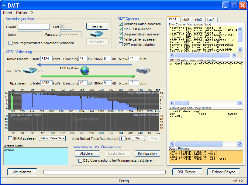

            This is how the link looked before the recap:
            And this is after the recap, the link is slightly better, due to the improved capacitors:

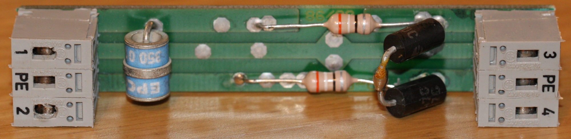

            What was interesting with last weekends lightning strike is that it improved the link, the phone line was cut in two places which the telco had to repair, after this it became much more stable:
            I will also need to buy a new "whole house" protector for the incoming phone line because it got destroyed, as did an APC surge protector with built in phone line protection...
            (This was a part of the reduced quality on the ADSL signal but the biggest reason was the line itself...)
            Note the very cool "lightning strike pattern" on the underside of the PCB between the lines & ground! (It arcs over even before it reaches the Epcos surge arrester)
            The name of this surge protector is OBO Blitzbarriere FLD 60T

              • 31218
              Re: Zyxel Prestige 660H Triple play ADSL Modem
              what's that "DMT" software?
              • Per Hansson
                • Jul 2005
                • 5895
                • Sweden
                It's a software for certain DSL modems that allow you to check the signal quality:
                http://dmt.mhilfe.de/
                For my specific ZyXel v6.12 is the best supported.
                That is to say with this software "latest is not greatest"
                You have to check which major X.YY version number is for your modem...
