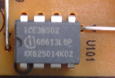

      My LG L204WT monitor Power board IC just burned cant figure out the IC U101 part no

                Here's a slightly clearer pic
                  Nice job! I didn't have time to mess with it any more yesterday.
                  What technique did you use on that?

                    The first few I tried (artificial light) didn't turn out at all. In the end it was natural daylight, no flash with a Lumix DMC-LX5 -- and there's still room for improvement.

                      Oh. Brain fart. THought you took my pic and processed it.
                      I should have noticed the missing cap

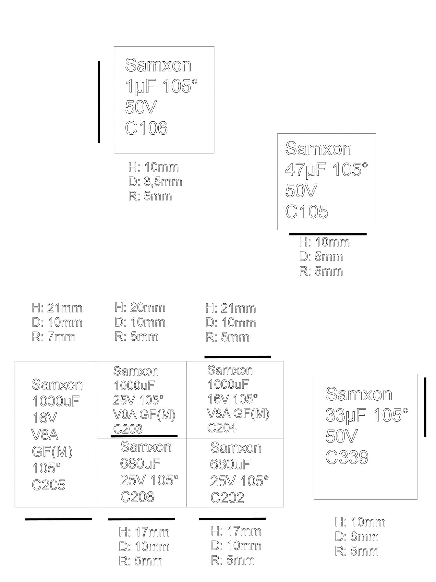

                                  Yesterday my L204WT-SF died on me (buzzing sound, barely flashing LED, turned on after being under power for like 30-60 minutes). I want to thank all of you who contributed with information here, because it helped me repair my monitor in a matter of minutes, especially MadMalloc who's description of how to pry the monitor apart in an easier way really helped me get started.
                                  I also want to contribute. Someone asked for information which cap goes where. While this was asked a while ago, others might still be interested, so I attached a diagram I drew containing all necessary information of the original caps. The diagram uses the same orientation as Smason's picture of the circuit board.

                                    I Know this is an old thread but Thanks to all.
                                    Mexxxi awsome Diagram, Really help me to order the right CAPS.
