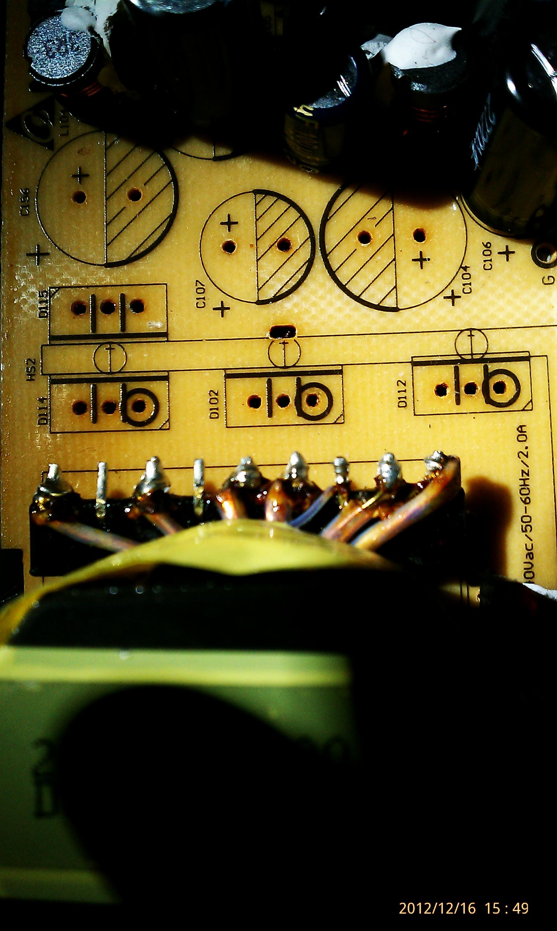

    here's a picture of the power supply board with no caps

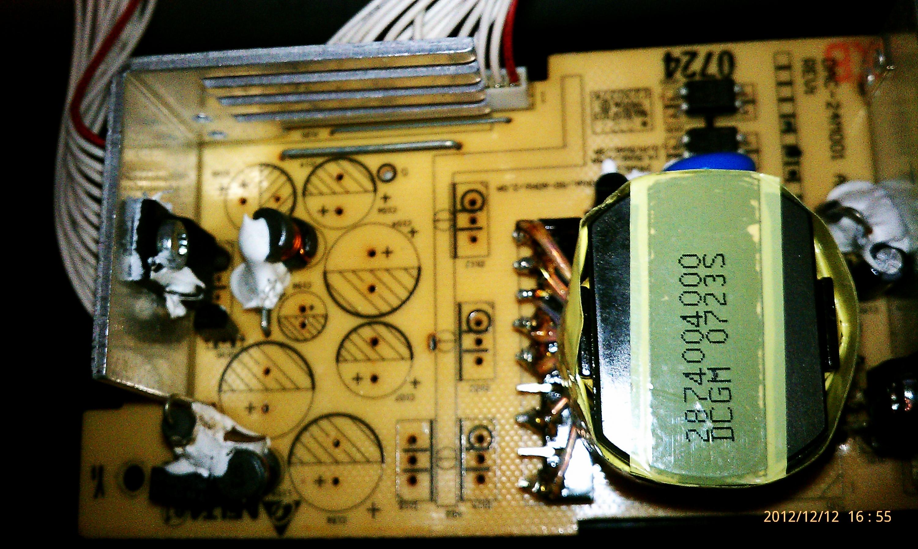

        Re: Westinghouse L2410NM 24" LCD power goes on and off, blue light flickers
        Here is a list of the caps on that board - can you amend it to show just the missing ones.
        1 1 P14382-ND CAP ELECT 2200UF 10V FR RADIAL 0.94000 $0.94
        2 2 P12417-ND CAP 680UF 35V ELECT FM RADIAL 0.85000 $1.70
        3 1 P12368-ND CAP 1500UF 16V ELECT FM RADIAL 0.85000 $0.85
        4 2 P14424-ND CAP ELECT 1000UF 25V FR RADIAL 0.91000 $1.82
        5 1 P14413-ND CAP ELECT 100UF 25V FR RADIAL 0.33000 $0.33
        I know where the 2200uf one goes
        EDIT EDIT
        Forget that - they are ALL under the heatsink /Missing
        EDIT EDIT DO NOT USE THAT LIST TO ORDER SOME CAPS ARE TOO TALL

          #164
          what value cap is in location c-104
          what value cap is in location c-107
          what value cap is in location c-156
          what value cap is in location c-106
          what value cap is in location c-109
          what value cap is in location c-158

            #165
            cant read the board numbers on your picture
            • rclafton
              • Dec 2012
              • 9
              #166
              here's a better pic of the board numbers.

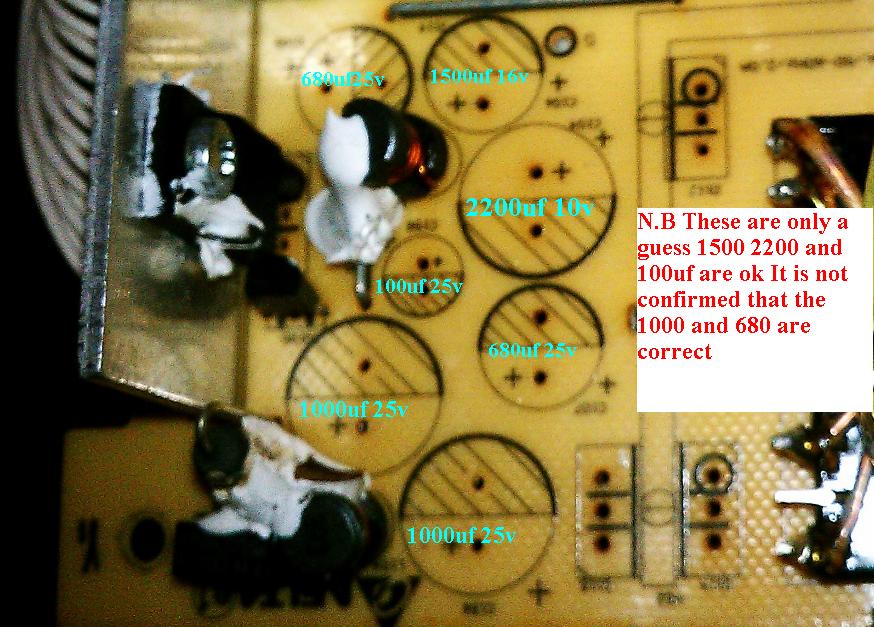

                #167
                You have replaced some?
                I have a theory but it is by no means proven.
                The cap that always fails is the 2200uf which is C104
                The 100uf is going to be the smallest cap so C??? cant see
                but you already have it in there?
                There is a pic somewhere on here showing the 16v 1500uf
                which is at C106
                In the good old days the circles on the board were an indication of the size of the cap so based on that the cap at C106 the one next to it and C107 would be the same size.
                Looking at the sizes available this would suggest that the cap next to C106 and the cap at C107 would be the 680uf
                This leaves the last two circles which are the same size and larger than the 680 of circles so that would where the 1000ufs would go
                Unfortunately that is where the theory now fails as modern caps are different sizes.

                  #168
                  thank you selldoor,
                  have all the caps installed,now to replace all the regulators,will postthe end result

                      #170
                      C104 -2200@10, C107-1000@25, C156-680@35, C106-1500@16V, C109-1000@25. Can't read C158, if its the one next to the choke and the vertical mounted power resistor, it is 680@35.
