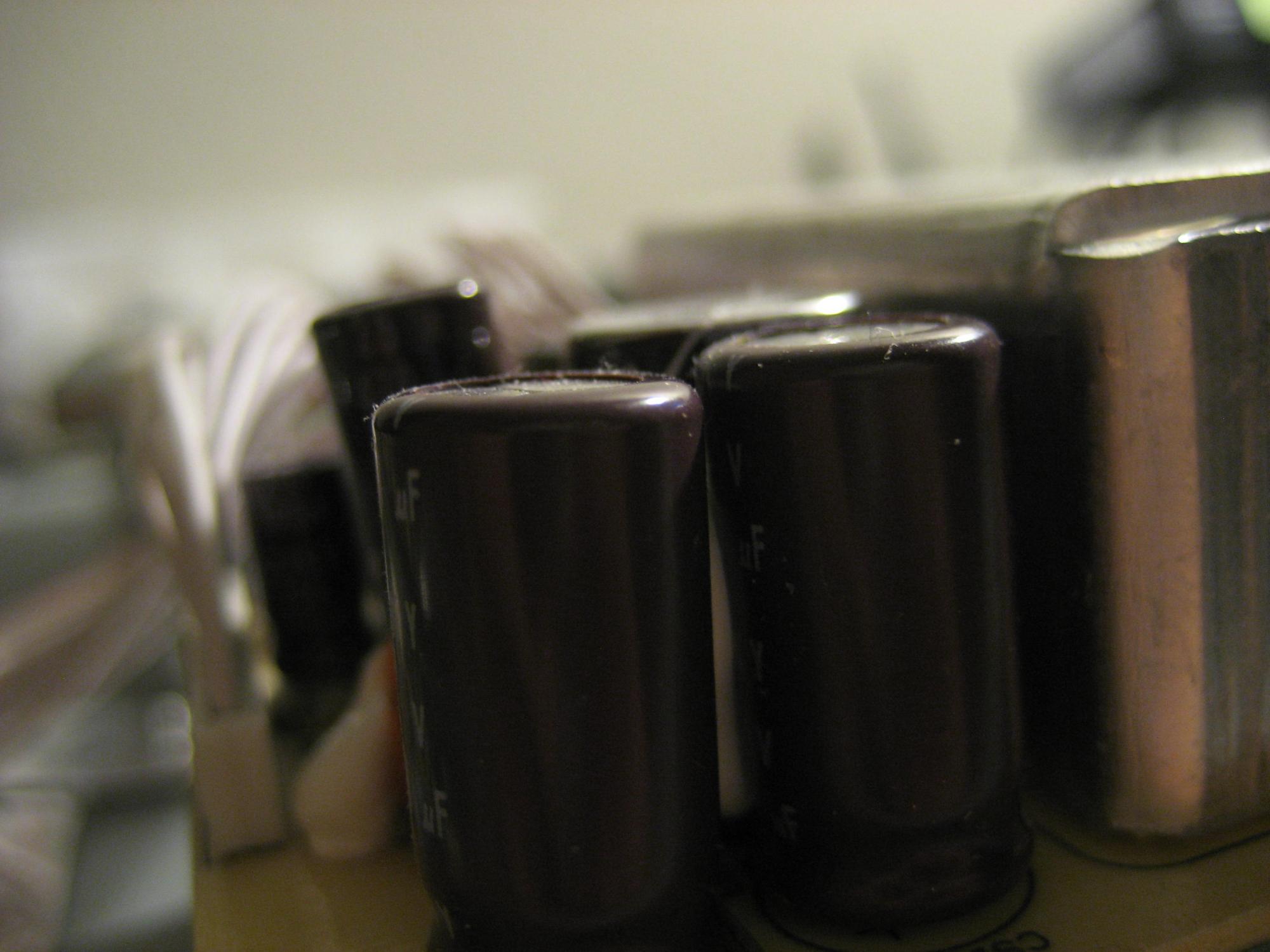

    One more question, are the cap specs always printed on the caps? I'm looking at them but I don't seem to see them in any of my pics, how do I figure out their specs?
      The specs should be on every cap. It will say something like 470uF 25V.
      I notice both me and Renesis13 have the same 2 caps bad in the same locations...coincidence?
      As many have already commented on the poor design, the heat kills the caps. So it isn't a surprise that the same caps are bulging.

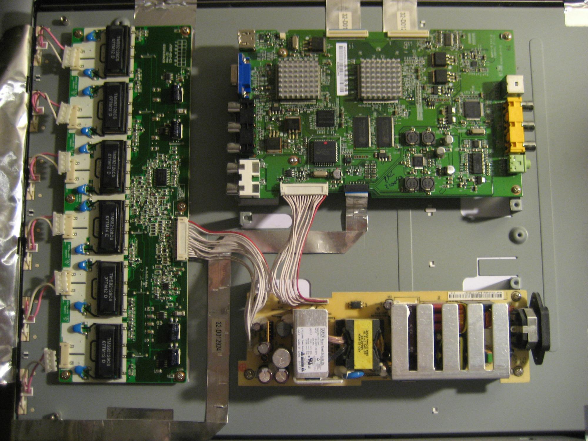

          Hi this is my fist post here, but I have the same issue I believe.
          I've opened the monitor, but none of the capacitors look like they are bulging at all. One thing I do notice is there is a constant clicking coming from the power supply when plugged it. Its random about 2-4 times/second.
          If the capacitors are not bulging can they still be bad. I had the flickering on/off issue before it died a while ago.

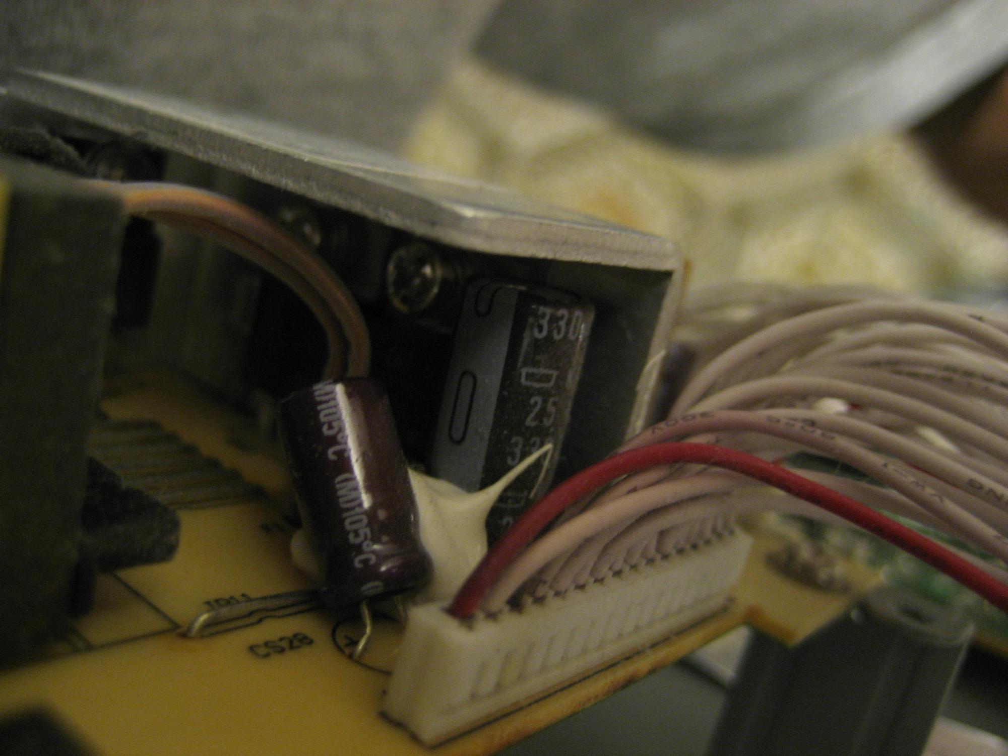

            The Power Supply is obviously trying to start,hence the clicking.Caps don't need to be bulging to be faulty,an ESR meter is cetainly the best piece of Test Kit in these situations,but if you have not got one,then perhaps the initial and possibly the cheapest solution would be to change ALL the electrolytics on the board,except the largest one,usually in the 100uF,400v range,and take it from there.Dependant on your location in the World, there is lots of info on this site for the range of caps you will need and also some Suppliers.
              The clicking is the power supply trying to start like Rtech explains.
              The smallest capacitor next to the SMPS plays an important part in the startup process and can be bad without signs of bulging.
              This cap is usually in the 22uF and 50V range (as a guess). Replace with something like Panasonic FM or FC.

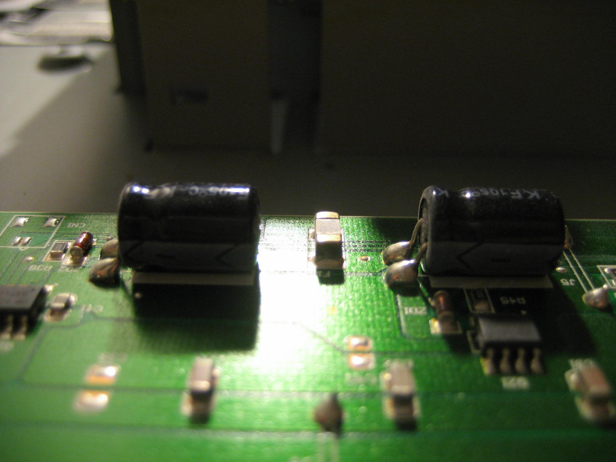

                    I've got the monitor open now. I found two capacitors that are bulging on the top of the left most board (the inverter?).
                    I'm going to replace all 4 on this board to be safe, but I'm wondering if I should replace every capacitor. There aren't any bulging capacitors on the power supply, but there might be a baddy in there as well....
                    To be sure I'm going to purchase (4) 100uF 35v 11.5mm(H)x 8mm(Dia), but I'm wondering what company (Nichicon vs. Panasonic) should I purchase expecting high temperatures.
                      Yes, that is the inverter board.
                      Definitely replace all the caps on the inverter board. The power board seems to have United Chemi-con caps (the brown cap with crown symbol). They generally make good caps, but their KZG series are problematic.
                      Panasonic FM caps are a favourite here, but Nichicon makes low ESR caps as well. See
