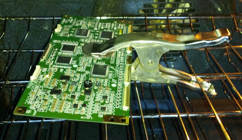

                      • lesterp
                        • Jan 2013
                        • 2
                        • US
                        #51
                        Re: Samsung 305T - Video Distortions
                        Just baked my 305T board (used a spring clamp to make sure things were well compressed) and its working like a champ. I put a large chipset heatsink on the altera chip and left the sheilding and the back cover off of the monitor. After 15 minutes of use the heatsink is extremely hot, no wonder these chips come off the boards.
                        • lesterp

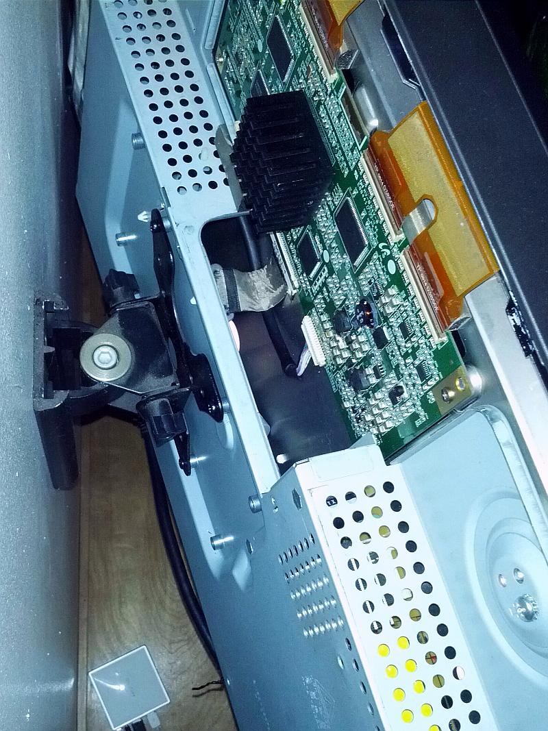

                          • C0rnholio
                            • Feb 2013
                            • 2
                            • Romania
                            #53
                            Found a 305t for a good price. Looks like it has the mod heatsink + fan made by the owner. I don't know much info about it's history, nor have I seen it in "person" to inspect what kind of mod was exactly done to it.
                            Is it safe to purchase a monitor that was previously "baked" or reballed? After re-balling I know the problems will just come back if you don't cool it but w hat's the expectancy AFTER doing the re-ball + cooling added? Anybody had problems after adding the cooling system or this is pretty much safe and future proof ?
                            I've had some trouble with the famous nVidia BGA issues with some of their cards and I know the re-baking was due every month.
                            I don't want to purchase a monitor I have to "bake" every 2 weeks

                              I know some will differ with my opinion, but I'll offer it anyway: If it was "baked" in someone's oven, you don't know what temperature they baked it at and for how long. This method is used by many that don't have access to reballing equiptment and tends to be a hit or miss method for restoring your video card. Personally, I would avoid buying, since all components are heated up, which may fix the video chip, but may also shorten the life of other components on the board. People will use this method to restore a laptop, video cards, etc. Once they get it working, they quickly sell it off to someone else and it becomes their problem. The problem seems to resurface after a while and you can only rebake these boards so many times.
                              Re-balling is the professional method of restoring the card as you're only working on the chip in question and not heating up the entire board. This method is not foolproof and relies a lot on the equiptment used and the technician's skill level. Helps to find out about the reputation of the shop doing the reballing.
                              Re-balling and the additional cooling fan is the way to go, but as you probably already know, it's always difficult to predict how long the "repair" will last.

                                  • SoerenM
                                    • May 2013
                                    • 2
                                    #57
                                    Hi there!
                                    First wanted to thank all of you guys for this great valueable resource of vast problem fixing knowledge ... unfortunately I've got the same 305t (plus) problem as many here had/have. After nearly 3 years the monitor already exhibited the same problem (green "pattern" noise/lines) and got repaired/replaced within warranty. But now a good year later, after warrranty ran out, the same problem re-appeared.
                                    From what I gathered I'm very certain it's the same Altera chip/solder problem...
                                    While I'm still a little "afraid" after reading all the "success stories" I want to try the baking procedure now and see if this will work.
                                    Just wanted to ask first... I gathered that I have to disconnect everything from the TCon board (the one with the Altera chip on it) .. so all I got is the bare board. Then I put it into my kitchen oven.. hm should I chose "air ventilation" or "top bottom heat" only? Set that to 190-200 degrees (celsius) .. put the board in and let it bake for 8-10 minutes, right? No "pre heating" (waiting until the oven reached full temp), right?
                                    And it seems most people fix some aluminium foil/clamp contraption to the Altera chip so it really "stays" in place while baking...
                                    Still afraid it might bake to long or something.. could 10 mins be too much already?
                                    Thanks for any tips!!!

                                      Thanks to several guys helping out via PM - thanks so much!
                                      It worked!!! Disassembled the 305t plus, removed the board with the Altera chip. Baked it in a normal convection oven that was pre-heated to 200° celsius (baked for 8 minutes). Let it cool down for over an hour. Reassembled and reconnected... et voila - perfectly working monitor again!
                                      Priceless! =)
                                      • SirFloyd
                                        • Jun 2013
                                        #59
                                        Howdy,
                                        I'd just like to add that the oven reflow method worked for me as well.
                                        My 305T+ initially just had a discoloured vertical stripe about 1.5inches wide on the right side of the display. After a week it then started to flicker and there were more vertical stripes of different colours as well.
                                        I removed the board with the Altera chip and baked it in a preheated oven at 200°C for 9 minutes. I then opened the door to the oven and let the board cool in there so as not to disturb it while the solder was possibly still molten. Once the board had cooled I reassembled the monitor and it was all good.
                                        I should note that I did all this less then 30min ago so the problems may reappear, but it's working for now. I'll certainly come back and update this post of there are any further developments.
                                        Thanks everyone!
