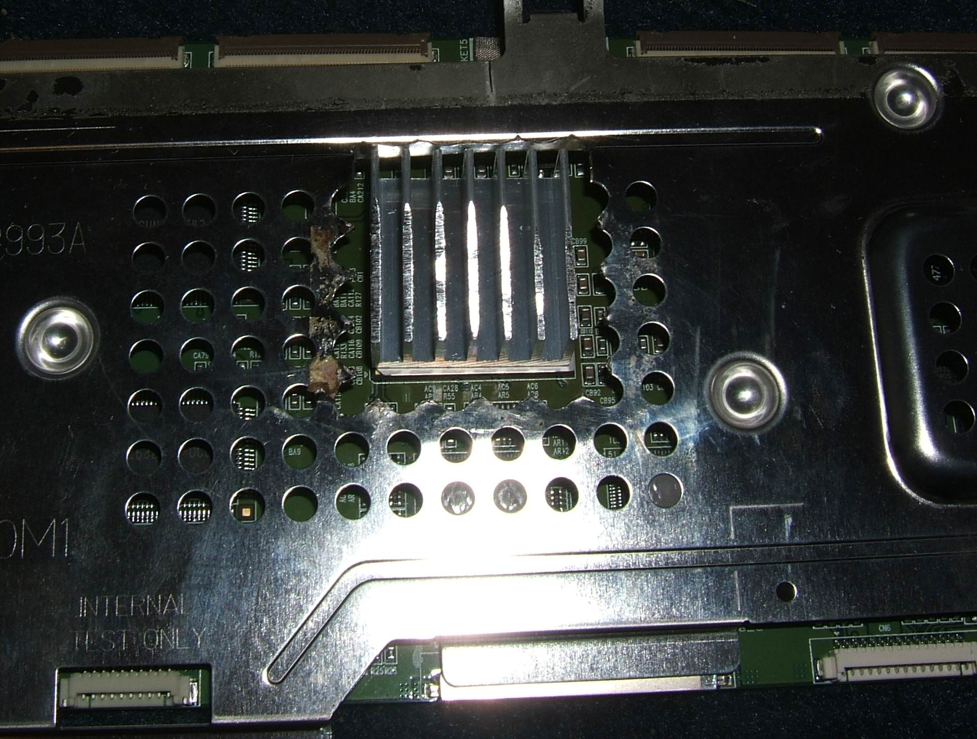

        I ended up reflowing the ALTERA BGA chip myself. First time I tried the heat gun method talked about here: http://hardforum.com/showthread.php?t=1527751 that lasted a few weeks.
        I reflowed it a second time doing the same thing. This time I heated it longer. It held up about a month after that one.
        Finally I started reading about how the guys with the HP DV9000/DV6000 laptops were oven baking their motherboards to reflow their gpu's. I ended up baking my whole board in the oven at 375F for 8 mins. That was in Jan 2011. It's been running ever since.
        I did also leave the back panel off of my monitor. Then I cut a whole in the metal cover of that board, and added a BGA heat sync from a old motherboard, using thermal paste between the chip and heat sync. I then made a large plastic cover that mounts on the back of the monitor. That cover holds 3 120mm fans powered by my computers PSU. It's quite the contraption.
        So really just a reflow will not do it. You need to be able to cool that chip down while it's running. If you google "305T reflow" there is many examples of people doing similar things to their monitors to keep them running.

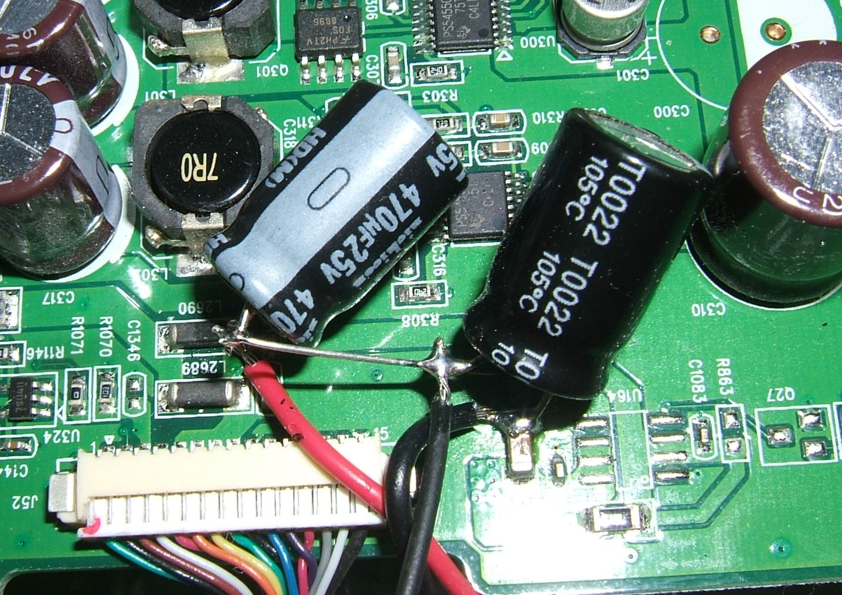

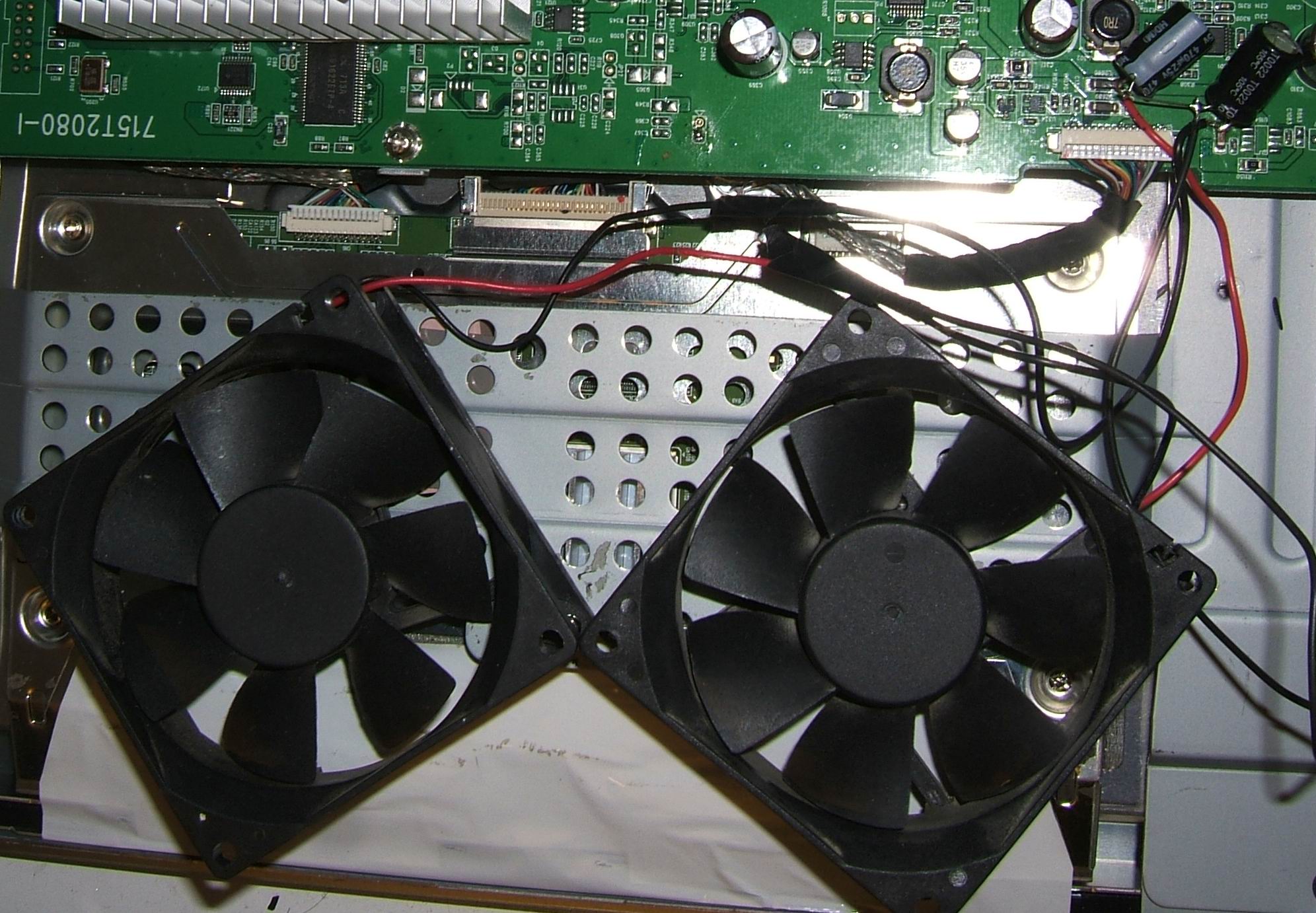

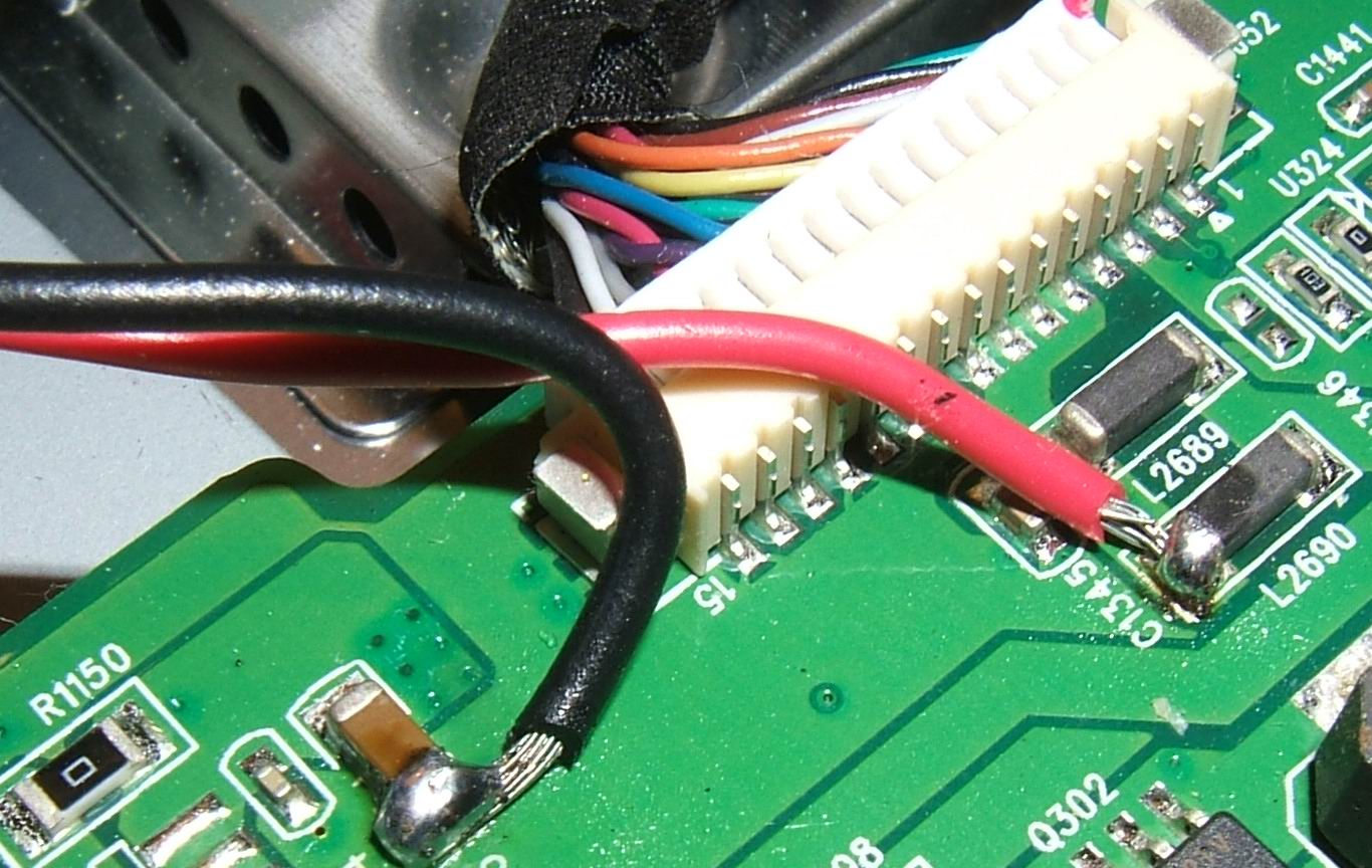

                        My reballed XHD3000 lasted about 2 months so heat is the problem and magic solder won't fix it. Through unfortunate circumstances I bought a used T-Con board and this time I added a fan mod. I have no idea how to fit fans into the Samsung 305T but 2 80mm ATX fans, two capacitors, and some wire fits very well in the Gateway XHD3000. The fans are quiet and completely automatic. I cut a hole in the metal frame case and added a real heat sink. I wanted the fans to mount reliably yet minimally interfere with monitor assembly.
                        I didn't want the fans to run all the time but I wanted to ensure there was no chance that the fans wouldn't run any time the T-Con board is running. The UP2202T-01P power supply provides 24v and 12v. The inverter runs off 24v but I couldn't find any power switched with the monitor. Interfacing with BLON would require a MOSFET driver and I'd like to avoid active components and circuits. The T-Con display driver board is supplied with 3.3v and 18v and both are switched on and off with the display. I decided that 2 12v fans in series running on 18v would run them at low speed to keep the noise down. I mounted two standard ATX power supply fans and wired them in series. They were quite noisy. I decided that was due to the dirty power draw of DC brushless fans so I placed 470uf 25v capacitors across each fan which cut the noise. Now when I run my hand across the top of the monitor the case is cool where the fans are. The rest of the monitor stays much cooler than it used to.
                        The circuit is simple: two fans in series to 18v, a cap across each fan also in series.
                        The fans mount to a frame member with one screw per fan so they can rotate for minimal interference to assembly. The pictures show them rotated out to allow the RF shield to be put on. Then they rotate together against the shield.
