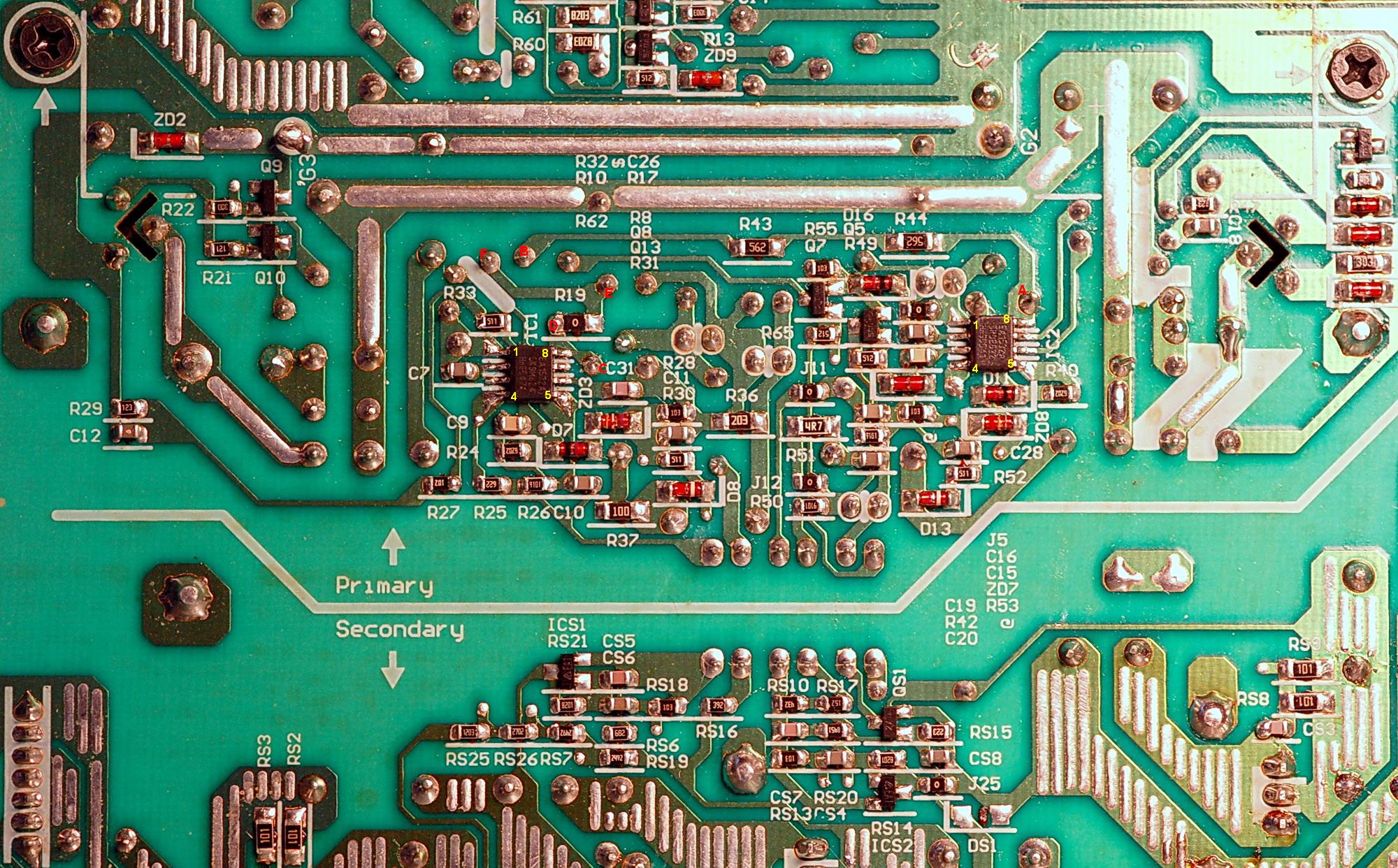

    Can I check these voltages with just the power supply plugged in? It will be hard trying to do it plugged into the monitor but I can give it a shot if need be.
    Pics as requested. Any others, just ask. I broke out the DSLR this time so the pics will be better than the previous ones that sucked.

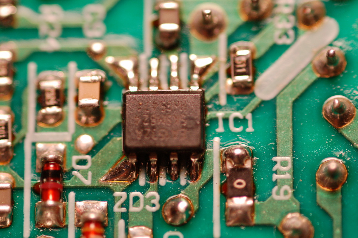

      BTW, in the pics, the numbers on the chips are upside down.

        OK, I was correct. Pin 1 is in the upper right corner; pin 2 is the pin to the left of it. given that there are no output voltages from the power supply, just plug in power; it's not necessary to hook up anything else.
        What I would like is the voltage on all of the pins of IC1 and IC2. You can use the - lead of the large capacitor as the ground point.
        As always, use the proper precautions when working on line voltage equipment.

            OK, that indicates the chips aren't getting power. I'd appreciate having a larger picture of the area. Roughly I'm looking for a picture of the board without the shield, and a single shot as large as can be uploaded to this site of the area within the yellow lines.

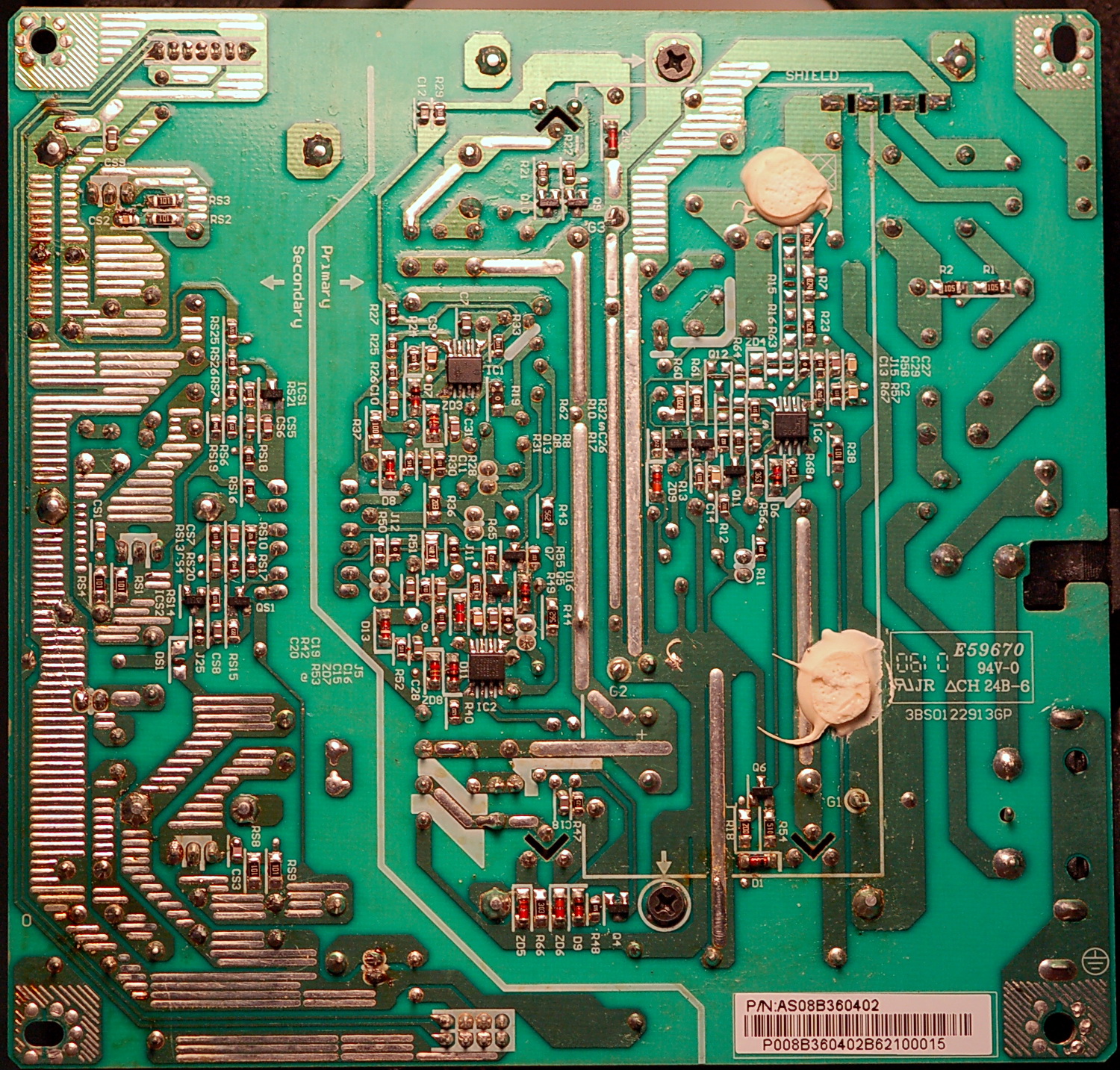

                Bill, your pics are below. Anything else, let me know!

                  Wow!!, this is tough. I've marked up the picture to indicate some points on the bottom that I want identified on the top.
                  As I indicated, IC2 appears to be the controller for the standby SMPS, while IC1 is for the main SMPS. I've labeled some points of interest. Point 'A' is pin 8 on IC2; point 'B' appears to be the source of the power; it goes through R43 and R44. Check the resistance of both R43 and R44, also what components on the top side of the board are connected to points 'A' and 'B'?
                  I have even more questions about IC1; I've used up letters 'C' through 'F'. Again, I'd like the components on the top side identified.
                  One thing, it appears that power for the SMPS controllers is coming from what I identified as a PFC circuit. What is the part number for IC6?

                    Point A is one leg of cap C17.
                    Point B is one leg of jumper J8 which leads to the pad north of it right under the label "R60". If you draw a line straght up from B, you will hit it. From there it seems to run to a giant trace that includes the choke wrapped in yellow tape.
                    R43: 5.58k ohms
                    R44: 5.59k ohms
                    Point C is one leg of cap C8.
                    Point D does not go thru the board; it's just a pad.
                    Point E is one leg of cap C22 (one of the primary side ones I have on order). The other leg is just east of there, under label "R31".
                    Point F is one leg of jumper J3. The other leg is just north, at the double pad connection. That second pad belongs to diode D4 whose other leg is just west of the double pad.

                      Once again I've been busy with Paint. It's not as much fun as fingerpainting, but the cleanup is easier.
                      If I interpreted your description correctly, the dashed yellow line represents jumper J8. Please confirm. Does the trace from the north end of J8 go to point A or B on my latest masterpiece?
                      What is under the blob of glue I circled in blue?
                      I'll have to do more research to identify that IC.

                        Yes, the dashed yellow line is indeed J8. The north trace goes to point A. Point B is only one of the two pads on that trace island.
                        The glue blob (ground shield offset) has nothing under it. Just the rest of the crosshatch symbol along with an R6 (north) and an R14 (south) label.
                        You drew a blue line but didn't ask about it. It's diode D14. A big boy.

                                    No cont. to G1 from the other two. That's why I was asking. So far all tests have been done with the shield in place but I dunno how much more bending those leads can take.

                                      Check the shield and make sure all three are connected. If they are, use a jumper wire to tie them together. I'd use a fairly heavy gauge insulated wire and keep it as short as possible.
                                      IC6 is a UCC28501 PFC controller. Check the voltage from pin 8 to pin 6.

                                        Voltage between pin 6 and 8 is just a few millivolts. Around 7.

                                          OK, this is driving me nuts!! I'm having problems tracing this area. Earlier you had given me a nice big picture of IC1 and IC2 and the area surrounding them. Now I need the same for the area around IC6. The same size as the one for IC 1 & 2 would be great, and covering roughly the area outlined in yellow.
                                          FWIW, I'm having trouble figuring where IC6, pin 8 is connected.
