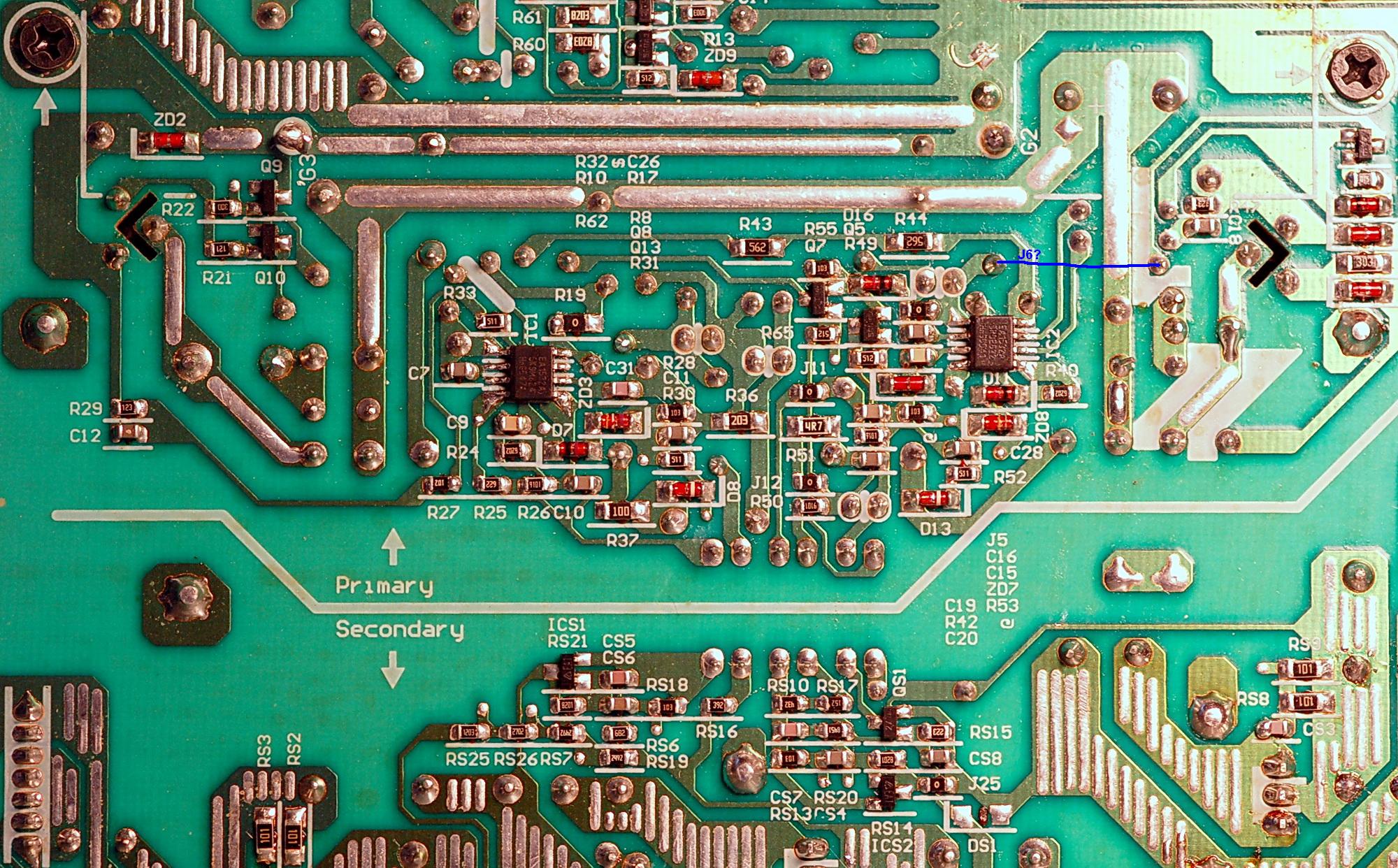

    Okay, I checked everything and before I throw a hundred numbers at you, diode ZD6 measures .8 ohms.
    ZD6 is the second diode from the top next to FET Q3 that you circled in yellow. It connects to the top leg of the FET.
    Let me know if you still want the results from the IC's. They both gave nearly identical results.
    Can I get excited yet?
    Yep, get excited. A shorted diode very well could be responsible for the problems. If it is holding the FET off, the power supply won't work. Of course, the next problem is I don't have the foggiest idea what the rating of that zener is. I just hope someone can step in with an idea. I'm out of my area of experience at this point.
    I'd say there is no point in comparing resistances of the two ICs; they are most likely not the problem. It WOULD be a good idea to remove the diode and verify it is shorted. If it isn't obvious, DON'T try to see if the monitor will work without the proper diode in place.

      Hopefully this will help. I have attached a shot of ZD6 to see if anyone can chime in on this one.
      Also, I located another seemingly identical diode elsewhere on the board (ZD7) and it came back with .76 volts.
      Anything else I can help with, let me know!

          I'm trying to find out what rating that diode has to replace it and it's apparently a lot harder than it seems. From what I understand, the markings are not standardized for diodes like they are with resistors.
          Does anyone know anyone that would know this info that could tell from the pic? Or maybe somewhere I can take my pics for ID on that diode?

            You're right, there are no standard markings on SMD devices, but that is only a problem, not a show-stopper. We have to reverse engineer this circuit, which shouldn't be difficult.
            1. Look up the application note for the SMPS controller.
            2. Look up the application note for the power switch (Q3?).
            Between those two, it should be possible to determine the voltage and power rating of the zener.
            I've been trying to figure out just how the zener is connected, that is going to have to wait until my eyes improve.

              If this zener diode is between the gate and source pins it is typically used for
              transient suppression and/or ESD protection. Typically though I see they are
              zener diodes that is connected back to back such to suppress positive and
              negative transients. For this application they may have only considered
              protecting positive transients for cost reasons I'm sure. For this power FET it
              needs at least 4V to enhance it so I would expect the drive voltage to be
              between 4-10V. Then using a 12V or 13V zener at 0.5W or more would
              suffice. On some FETs you will find this back to back zener build into the FET
              package. See an example of this with the attached FET spec.
              Since it is only their for the occasional transient you may be able to unsolder
              it and turn on the PSU to test out if your only problem is with this zener
              diode. Once you know that this is the problem then a replacement zener diode
              is highly recommended.

                  These zener diodes on the gate of the FET is used for protection. They are
                  typically "optional". I have seen schematics where these diodes are marked as
                  "NC" meaning no connection. The board is layed out with place setting(s) for
                  these diodes but they can opt out of not having to put them on based on
                  accelerated life testing, simulated lightning, overload and repeated on/off
                  cycle testing. But if they had failures during these test they can add these
                  diodes in without having to relayout the pcb again which is a costly and time
                  consuming proposition.
                  I have dowloaded the spec for both the controller and FET but neither of
                  them mentions about having to add these diodes for protection. As these
                  are "optional" and also depends on how much money you want to take out
                  of the parts BOM (bill of materials) they may or may not end up on the board.
                  One could select a FET that has these protection diodes build into it as the
                  like of what I have send previously but that may delay the time and cost you
                  more money before we can get to see this unit up and running. Of the schematics I have seen which do have these diodes in them they are rated
                  between 12-13V, 0.5W. You got choices to make now:
                  - remove it and see if it comes up
                  - go get a 12V zener and replace the shorted one
                  - go get a replacement FET with integral zener diodes with similar ratings as
                  04N70BF.
                    #69

                    I will desolder the diode and report back with results, unless of course you recommend another course of action.

                            Ugh...
                            Removed the diode, it read 4.8 mega ohms one way and open the other.
                            Measured the pads where it was with it removed, .8 ohms.

                              Maybe the power FET?
                              PlainBill
                                #75
                                Re: Acer AL2423W: Recapped, Still Dead!
                                The FET the diode was connected to has these markings:
                                04N70BF
                                540191
                                It is Q3 on the board.
                                How do I test one of these? Or should I just replace it?
                                Thanks!

                                  If you have removed it, check the same pads as in three posts above. What is the resistance with the FET out of circuit?
                                  We are trying to identify the cause of the .8 ohm resistance you saw.
                                  PlainBill
                                    #77
                                    FET removed, resistance the same as before, .8 ohms.

                                      AAARRRGGGHHH!!! I'm glad the only beer I have in the house is a bottle of O'Doul's. I've found the .8 ohm. It's the large flameproof resistor between R46 and C1. ZD6 is tied to the source pin. The large resistor is for current sensing. %T@#$$%T^%$%!!!
                                      OK, now that I've go that out of my system, let's get back to work. Note the picture I've attached. ZD5 and R66 protect the gate of Q3. It appears Q4 provides the drive for the gate of Q3. Please verify the pin I've labeled D is connected to the lower end of R48 and the upper end of R48 is connected to Q4. What is the part number (package code) of Q4?
                                      Lastly, measuring from the - leg of C1 (the large cap), what are the voltages on the three terminals of Q4.
                                      Test Q3 by measuring the resistance between all three terminals - left to center, left to right, center to right.
                                      I'm going to go hit myself over the head with a bottle of O'Doul's.
                                      PlainBill
                                        #79
                                        Both confirmed.
                                        2X followed by an E on its side, like so: |_|_|
                                        L=190mV
                                        C=1.5V
                                        R=0V
                                        Seems to give me different results each time.
                                        First Time:
                                        L-C = Open
                                        L-R = Open
                                        C-R = 3.16 megaohms
                                        Second Time:
                                        L-C = 17 megaohms
                                        L-R = Open
                                        C-R = Open
                                        Third Time:
                                        L-C = Open
                                        L-R = Open
                                        C-R = Open
                                        Is my meter switching it or something?
                                        All subsequent tests result same as the Third Time. I hope I didn't cook it with my meter.
                                        All above results were obtained with the FET removed. Advise if the test should be repeated with the FET re-installed.
                                        Thanks, Bill!

                                          We are making progress. For the time being we will assume the FET is good.
                                          Q4 is the modern day equivalent of one of the earliest transistors I used - a 2N2222. 2X translates to an SO4401, MMBT4401, etc. It SEEMS to be in an emitter follower configuration, and as close as I can tell, gets it's collector current through J6, which SEEMS to be attached to pin 1 of IC2. I sketched it in on the first attached drawing, please verify.
                                          This has caused me to examine some of my assumptions. Before we go too much further with this particular section of the power supply, I have marked up the top view. According to the legend on the right side of the second picture, this supply has 5V, 12V, and 19V outputs. The voltage rating of the caps should identify which diode (1, 2, or 3) is associated with each diode.
                                          Also, there are two connectors, CNS1 and CNS2. Which goes to the logic card, which goes to the inverter? As a bonus, which voltages appear to go to each?
