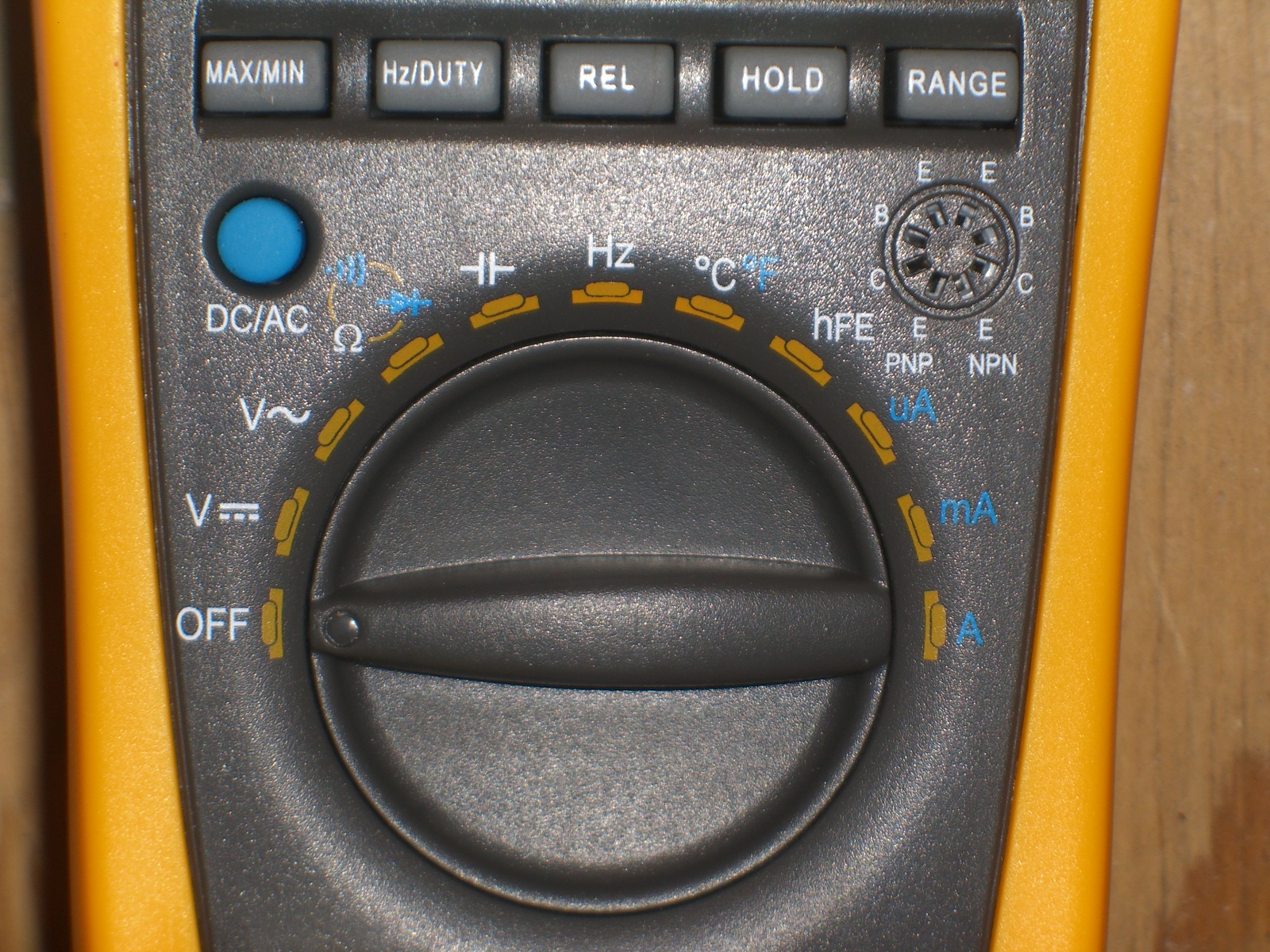

            Also for this monitor I have gotten some new tools.
            I have a 0-30v variable power supply in for if I need to "APPLY" voltage somewhere to this board as well a a multi-meter with more options that my current. I included a pic of the multi-meter in case any of the function may be handy for figuring this out.
