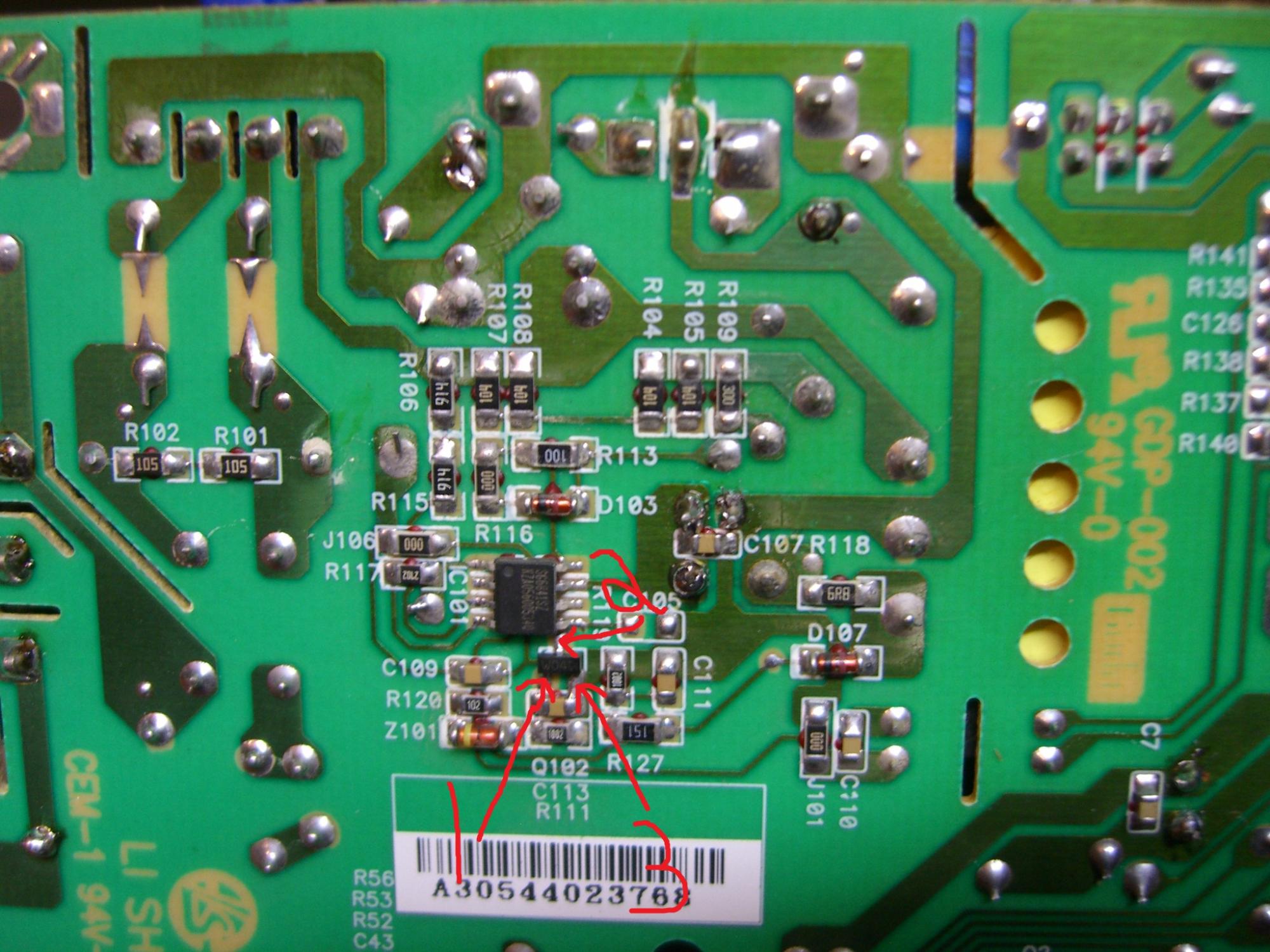

    Okay, it looks like Q102 is a general purpose NPN transistor, PMBS3904. Spec sheet below. Pin 5 of IC101 is basically used to shut down the power supply in case of over temperature. Since a thermistor is not being used here like it is in the pdf schematic, the temperature function is not being used. From the IC101 specs, it looks like pin 5 has to be held at above .65 Volts to prevent power supply shutdown. Once it drops below .62 volts the supply will shutdown. With the monitor on can you measure the voltage of pin 5. If it's going below and above .62V, shut off the monitor and perform a short circuit check on Q102 using the numbering config on the spec sheet and retiredcaps instructions at this link:

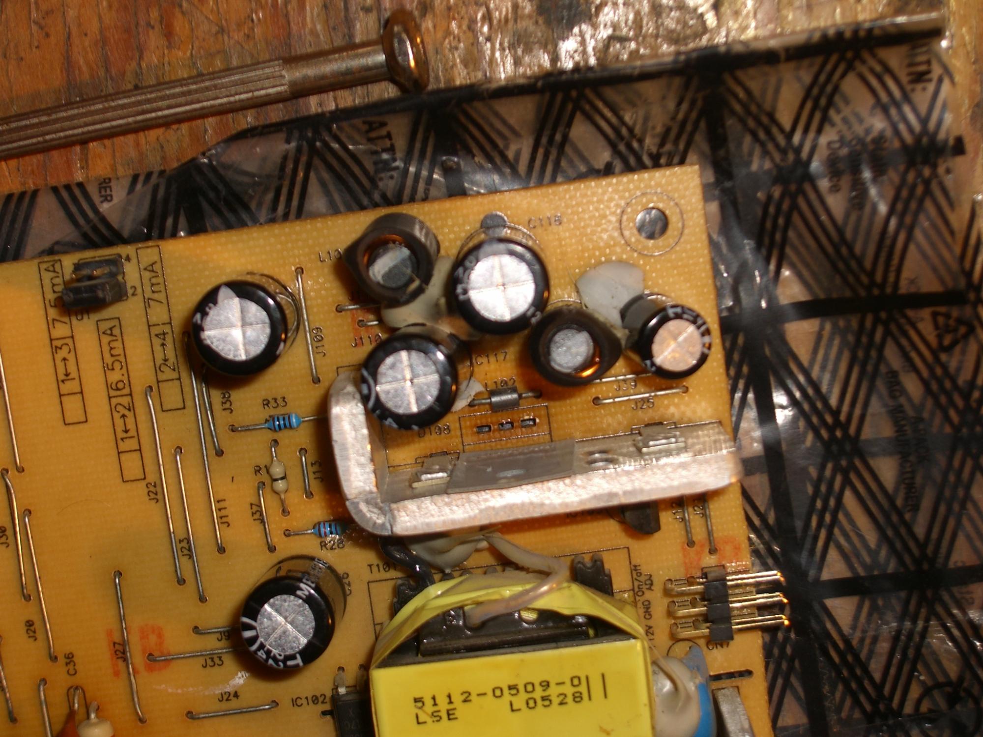

          • UserName666
            • Aug 2010
            • 76
            #45
            Re: Daytek F19AH
            Q102 reads as follows according to the pic I added (In circuit - No live power)
            1-2 = 11.80 Mohms
            1-3 = 9.97 Kohms
            2-3 = 11.77 Mohms
            • PlainBill

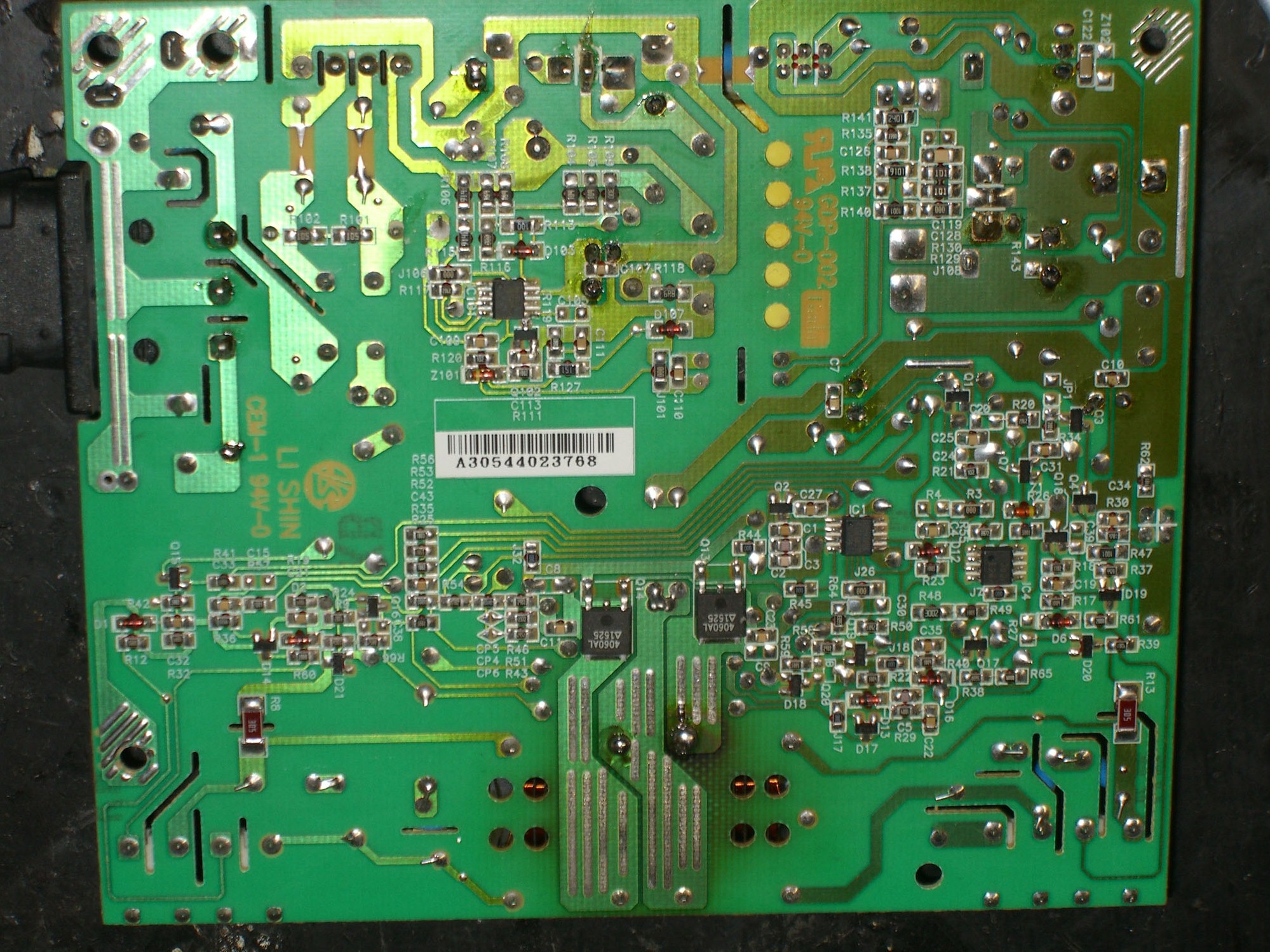

              • jetadm123
                • 2169
                #47
                Re: Daytek F19AH
                Originally posted by UserName666
                One thing I should have mentioned right of the top is this monitor was used in a poorly ventilated cabinet and all of the sudden just went out and you could faintly smell burnt electronics. The poorly ventilated cabinet makes me think this was an overheat issue.
                Since you mentioned that you got a whiff of the "magic smoke", can you please post two of your cool pictures of the entire board, both top and bottom.

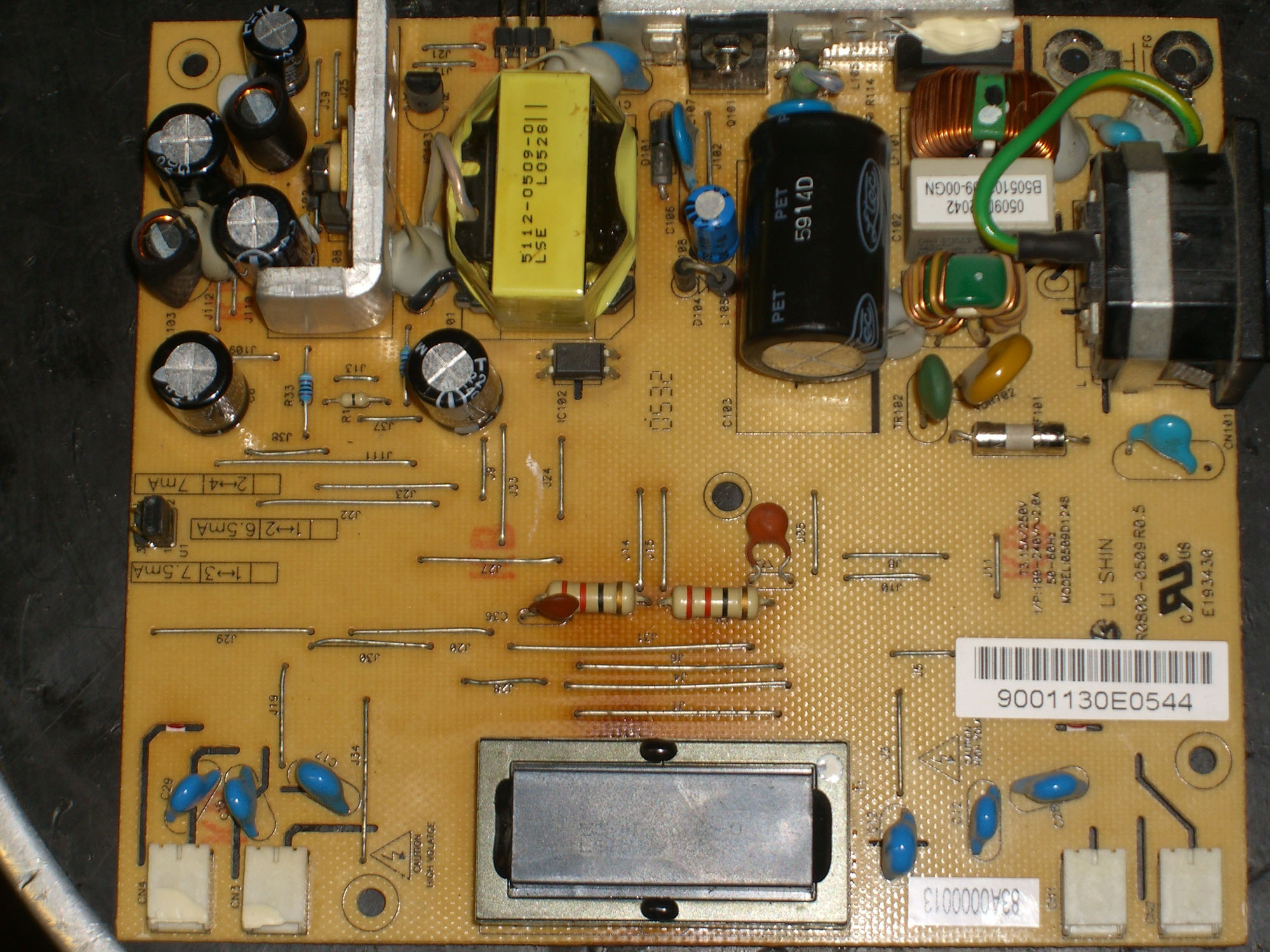

                • UserName666
                  • Aug 2010
                  • 76
                  #48
                  Re: Daytek F19AH
                  Done. These are the highest megagpixel setting my camera can do.
                  • retiredcaps
                    • Apr 2010
                    • 9271
                    #49
                    Re: Daytek F19AH
                    There is a possiblity that acer 1914bm uses the same power board as this Daytek. You can search acer 1914bm service manual to see if there is one with schematics.
                    I got this idea from the 0509d1248 designation (right above the li shin) on the board.

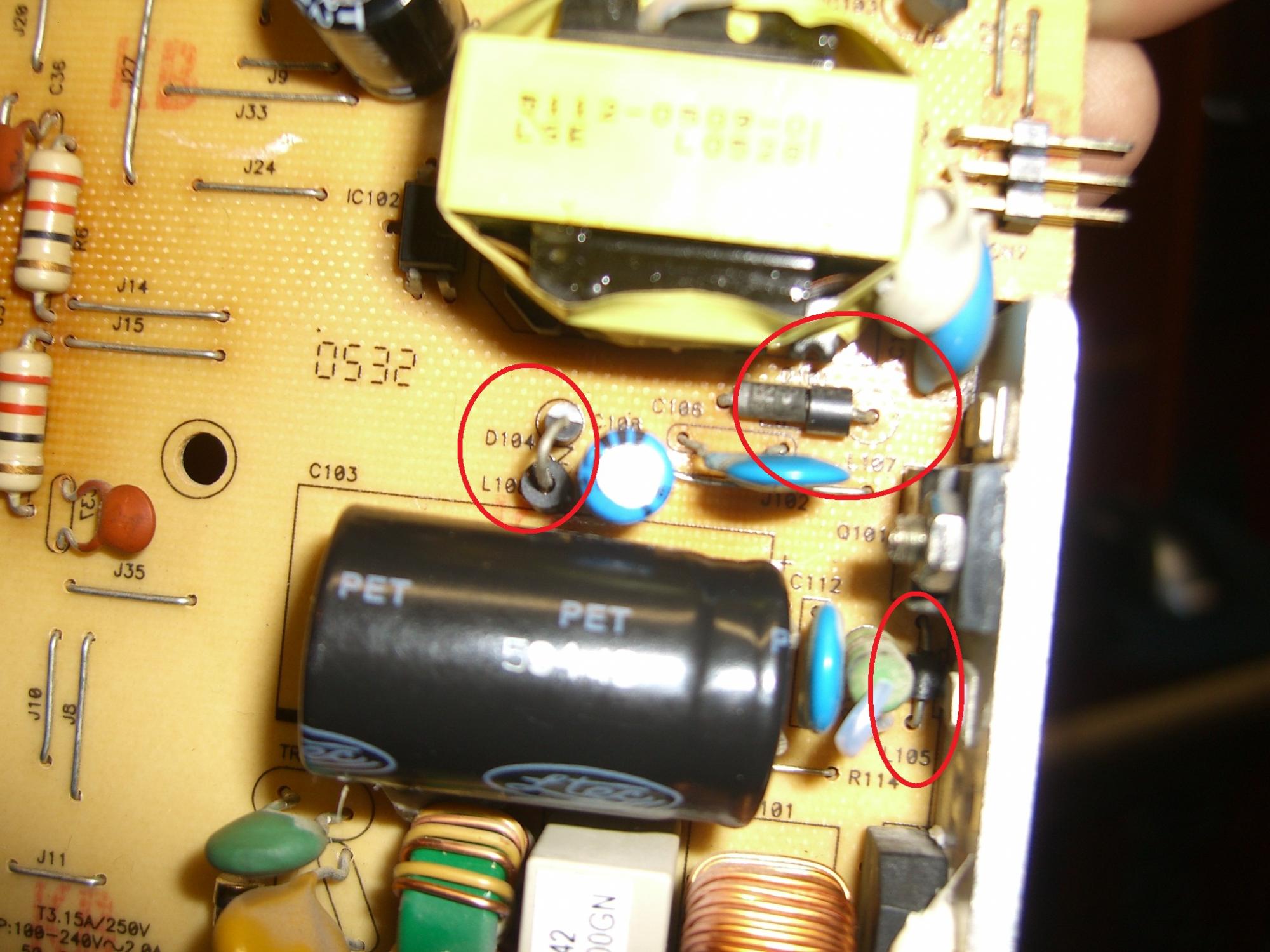

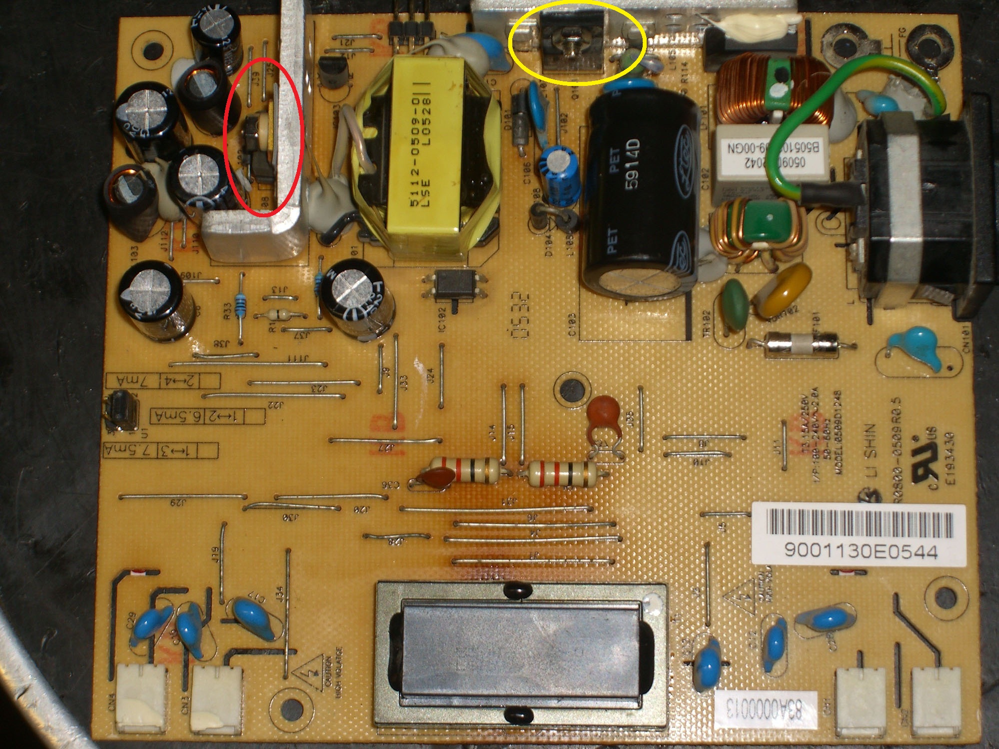

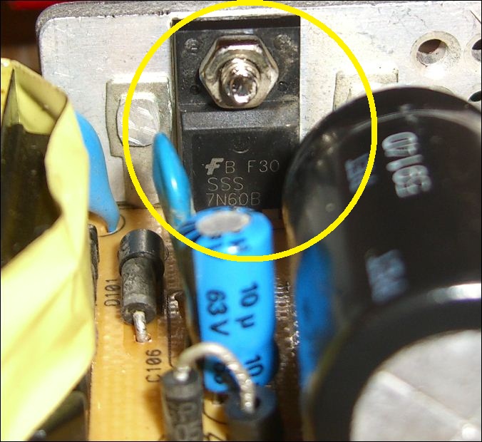

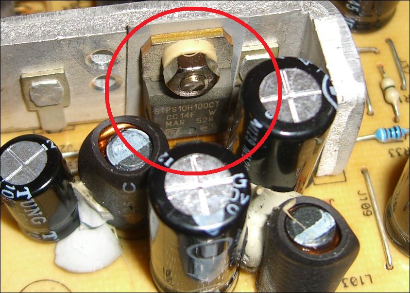

                      • UserName666
                        • Aug 2010
                        • 76
                        #51
                        Re: Daytek F19AH
                        I should have asked first but I hope these tests can be done in-board because thats the way I did it.
                        The one circled in YELLOW on the heatsink by the filter cap is:
                        1-2 = Starts at 41 Kohm rises to about 400 Kohm then jumps to about 1.2 Mohm and keeps rising. Reverse leads 0 Mohms
                        1-3 = 86.1 kohm reverse leads 81.2 Kohm
                        2-3 Starts at 18.5 Mohms and drops. I stopped testing at 12 Mohms. Reverse leads 0 Mohms
                        The one circled in RED by the cluster of caps is:
                        1-2 = 27.1 ohms reverse leads 26 ohms
                        1-3 = 00.3 ohms reverse leads 00.3 ohms
                        2-3 = 27.1 ohms reverse leads 26 ohms
                        Part #'s are visible in pic 2 & 3. I didn't know if that was a letter F or a company logo.

                          • retiredcaps
                            • Apr 2010
                            • 9271
                            #53
                            Re: Daytek F19AH
                            0.3 and 27 ohms suggests this is shorted or bad.
                            edit: Datasheet is at
                            You will have to desolder this component and test out of circuit to verify it is shorted.
                            F, I think, is Fairchild.
                            --- begin sig file ---
                            --- end sig file ---
                            • UserName666
                              • Aug 2010
                              • 76
                              #54
                              Re: Daytek F19AH
                              OK & ya know what...The one with 00.3 ohm reading (red) is DIRECTLY BESIDE the capacitor that was bloated by like less than 2mm. I'll get to the desoldering in a little bit and get back w/ he readings
                              • retiredcaps
                                • Apr 2010
                                • 9271
                                #55
                                Re: Daytek F19AH
                                Is it possible that your replacement capacitor soldering is touching this component? That would cause false readings.

                                • UserName666
                                  • Aug 2010
                                  • 76

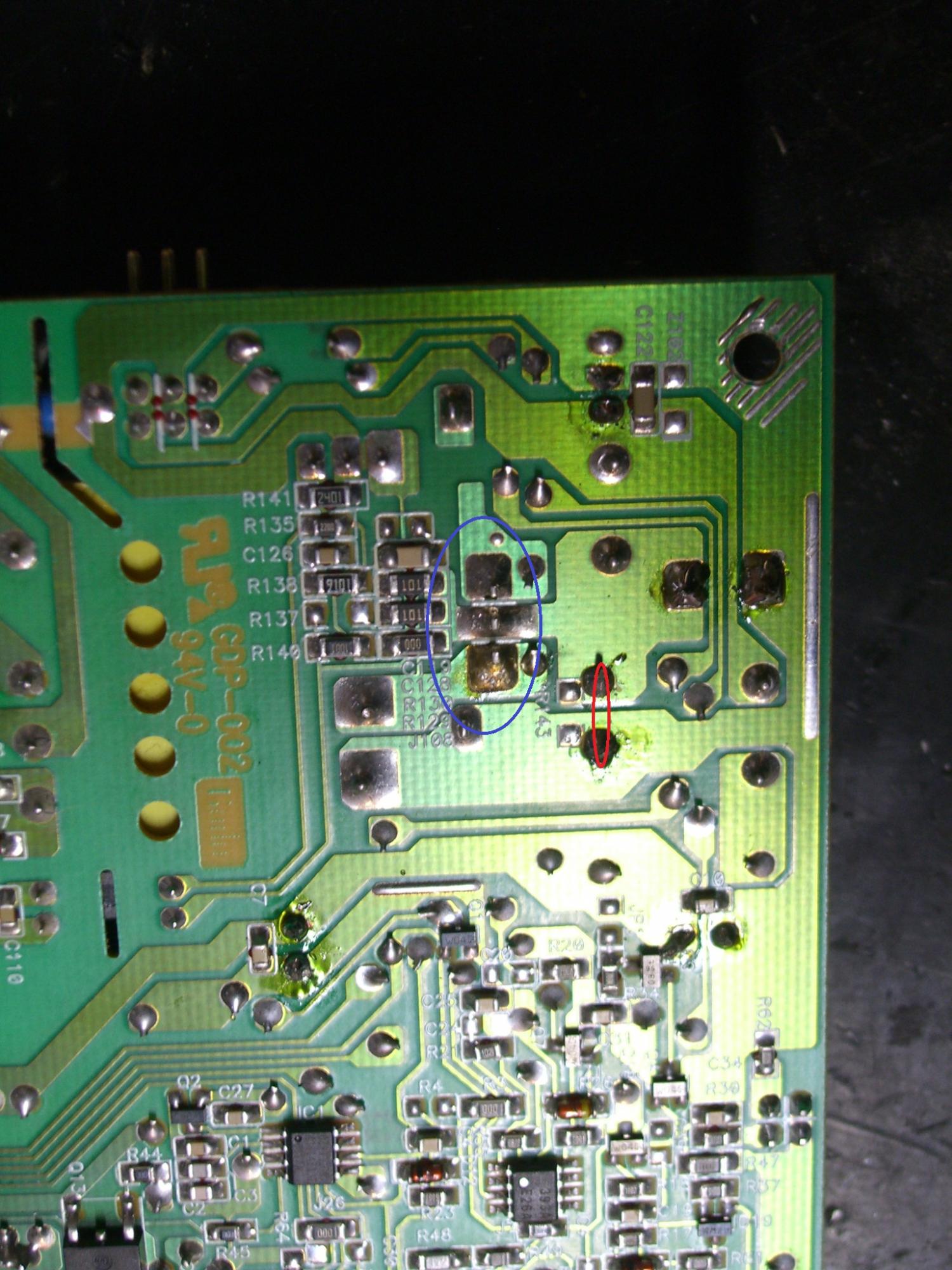

                                  #56
                                  Re: Daytek F19AH
                                  No I meant 2mm close on the top of the board but looking underneath the middle pin of the rectifier IS connected to the cap that was bloated.
                                  Rectifier in blue and the capacitor that bloated is in red.
                                  • retiredcaps
                                    • Apr 2010
                                    • 9271
                                    #57
                                    Re: Daytek F19AH
                                    Okay, soldering all looks good. No bridges. I suggest you desolder the component and test out of circuit.
                                    If it is bad, a replacement is available at digikey for just over $1.

                                    • UserName666
                                      • Aug 2010
                                      • 76
                                      #58
                                      Re: Daytek F19AH
                                      OK I pulled the STPS10H100CT from the board and it reads:
                                      1-2 = Starts at 30 Mohm and continuously drops rapidly-reverse leads- Starts at 32 Kohm and drops slowly.
                                      1-3 = Starts at 26 Mohm and drops rapidly -reverse leads- Starts at 36Mohm and drops rapidly
                                      2-3 = Starts at 30 Mohm and drops rapidly -reverse leads- 40.1 Kohm (steady)
                                      • retiredcaps

                                        Re: Daytek F19AH
                                        There is another component right by this STPS10H100CT. I can't see it from the angle of the pictures, but it has 02 and the end. I think it is a diode D102?
                                        1) what is it?
                                        2) if it is a diode, do a diode check with your multimeter. This component could be shorted? This would explain why pin 1-3 on the STPS10H100CT in circuit, but measure non shorted out of circuit.
                                        STPS10H100CT is good out of circuit from your measurements.
                                        • UserName666
                                          • Aug 2010
                                          • 76
                                          #60
                                          Re: Daytek F19AH
                                          I'm not sure what it is but it is labeled L102. D108 is what I just took out.
                                          This boards also has an L107,L105 and L108 surrounding the Filter cap. Not that has anything to do with anything. Just not sure what the "L" is.
