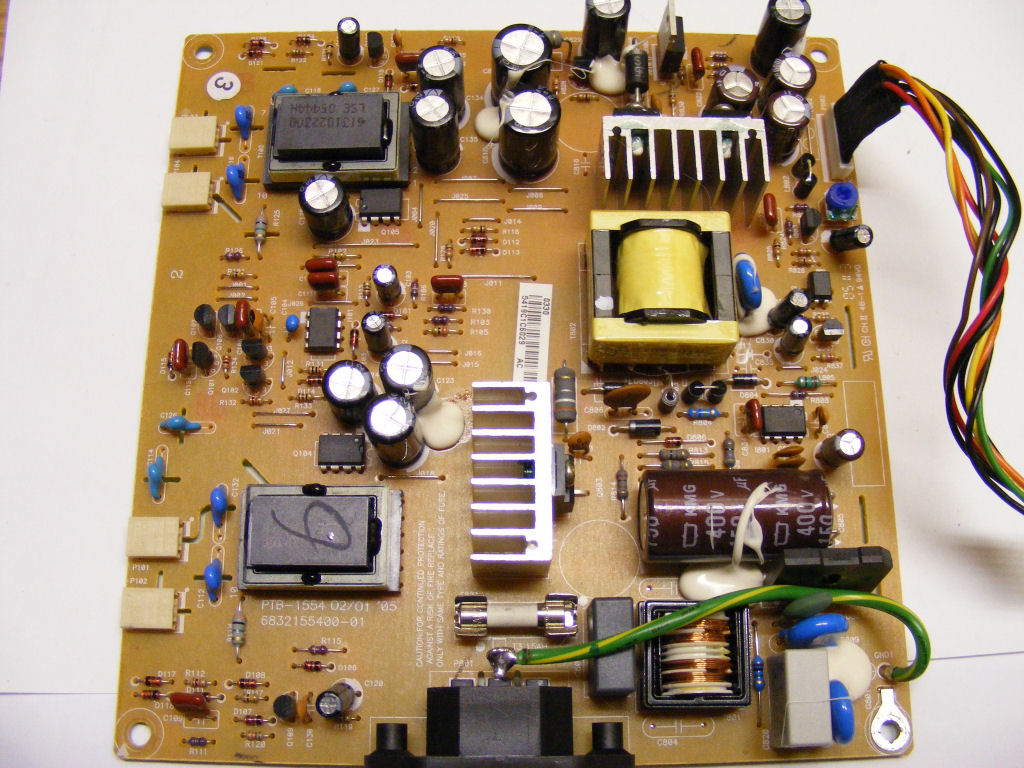

    Ok, I've about had enough of this one. The patient, an HP VS17 (PK657AA), was given to me by a friend and is determined to send me to the crazy house.
    Initial symptoms were the thing would turn on for a couple minutes and then go dead like the power was cut. Power button would not turn it back on. I went through it and touched up every bad solder joint I found, and replaced several capacitors.
    That got it to run for a couple hours instead of a couple minutes, but it would always go dead again. Pointing a fan at it made it stay on indefinitely, but then if you tried to turn it off with the button it would play dead again. It would not power up again unless you cut the power to it for a while.
    Replaced the 47uF 50V capacitor near the FAN7601 PWM controller. That got the power button to work properly, so I figure I'm getting closer. Measured the voltage at the Vcc pin on the PWM... 61 volts. Seems a bit high - the chip is rated for 20V. That's gotta be part of the problem.
    But, I'm now at a dead end - not sure what's causing the Vcc pin to get that much voltage. I have a part on a heatsink I can't ID - picture attached (it's the MOSFET dead center in the pic). 5V output reads 6.31V, 12V output is at 12.01V. 12V happens at the regulator at the very top of the board, next to the 5V and 25V output heatsink. 25V output reads just under 25V.
    Anyone have any thoughts on where next to look? Any help is appreciated.

      sounds like some component is getting too hot and goes into thermal protection.
      trace down where the VCC voltage for the PWM controller is coming from and why its so high..?
      also.. if the voltage on the VCC pin really is 61V, the 47uF 50V cap isn't going to last long i'd say..
      http://www.alldatasheet.com/datashee...AP2761I-A.html

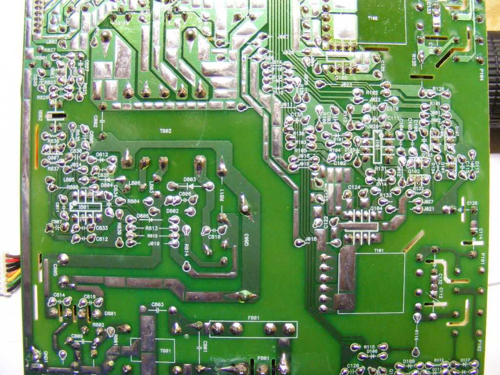

        That's what I thought. The topology of this one makes it hard to see what's running hot and what isn't due to short cables between parts. I need to find a way to run it so I can see what's overheating.
        The supply for the Vcc seems to be coming directly from pin 1 of the bridge rectifier, a U4KB80R. I checked that pin four times when I saw the 61V... couldn't believe my eyes. Maybe I was checking the wrong pin, but I was going by the datasheet so I don't know what to think there.

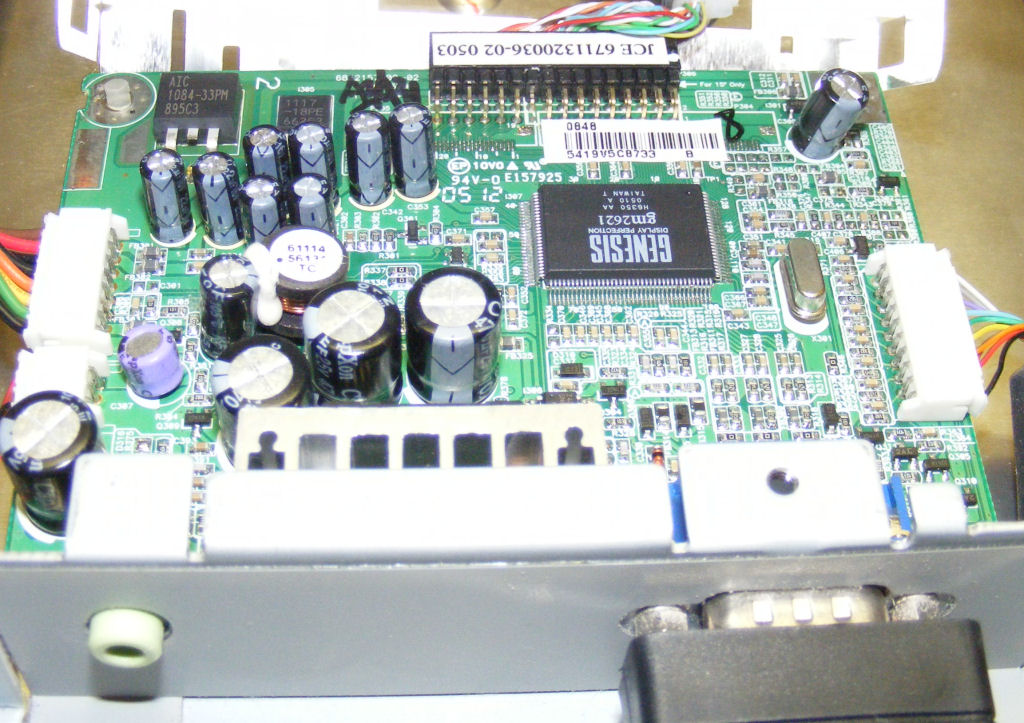

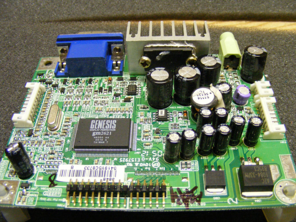

          Some more progress made. As it turned out, I remembered wrong about how the inverter board mounts - it was easy to check the running temp of the components.
          Observations - the only chip running hot is the GM2621 display chip. It wasn't bad when it first fired up, but after a while my brain made me take my finger off the thing. I could have held it longer, but it was getting uncomfortable. In the below pics, you can see the display board. On it, there are a ton of Capxons. Don't have replacements for any of them.
          There's an AIC1084-33PM on the upper left - I got 6.31V at the input and 3.31V at the output. Next to it, there's an LM1117-18PE - got 1.8V at the output. The IC by the VGA connector is a TDA7496SA that was barely warm at all - has lots of heatsink.
          I just wonder if those Capxon caps need to be swapped, if the 5V input is just too high, or both. Nothing on the inverter board was running hot, including the PWM controller.
            Any more comments?
            Presuming that the 6.31V is the 5V rail, I'd be keen to get that under control even if the two regs aren't smoking. It *may* be the cause of the Genesis chip warming unduly.
            Also any time I go to the trouble of opening a monitor, I automatically replace any CapXon (or other dodgy/bad_rep) caps I find.
            The TDA chip is the audio - it's idling now so I wouldn't expect any significant heating.
