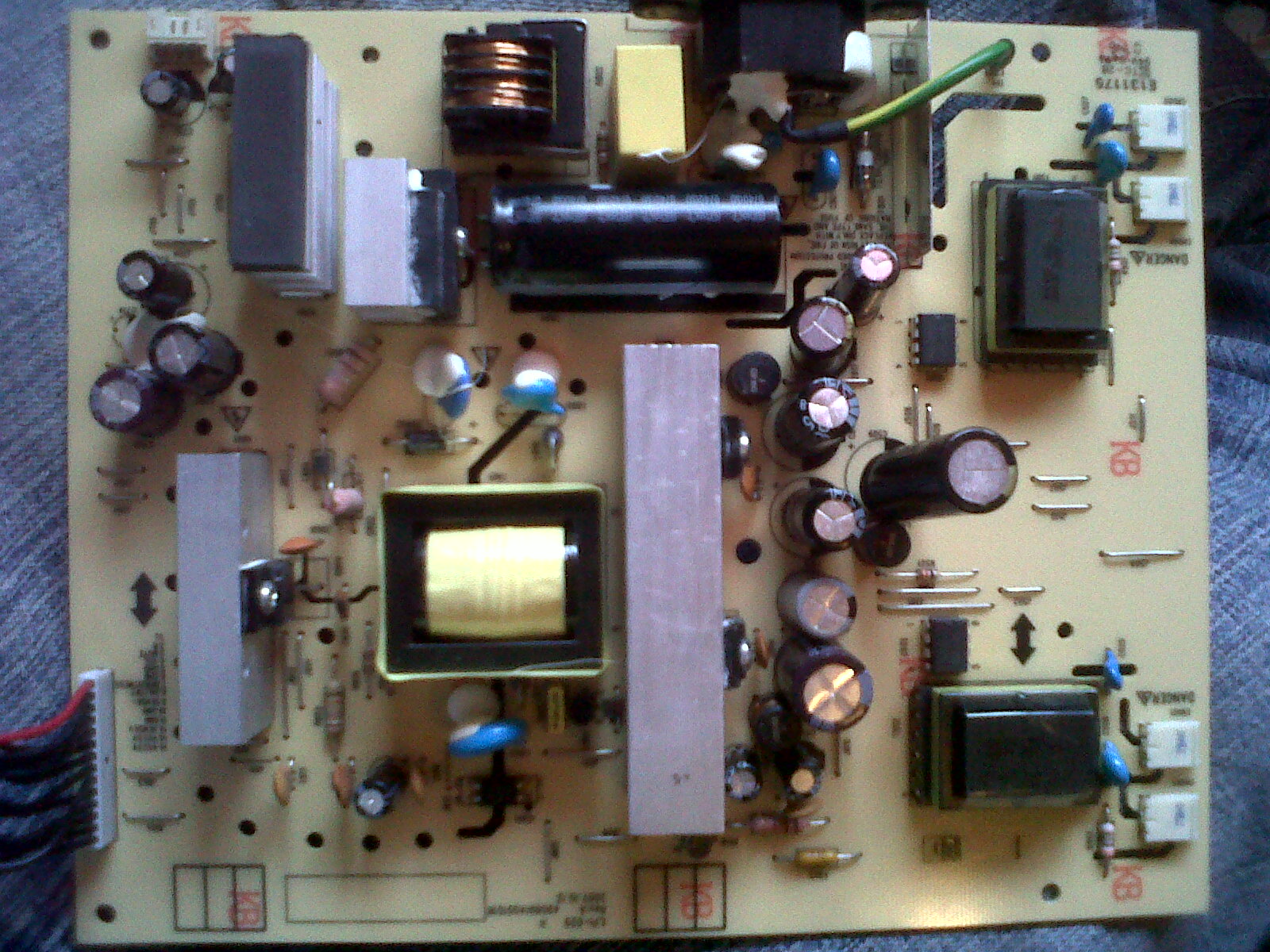

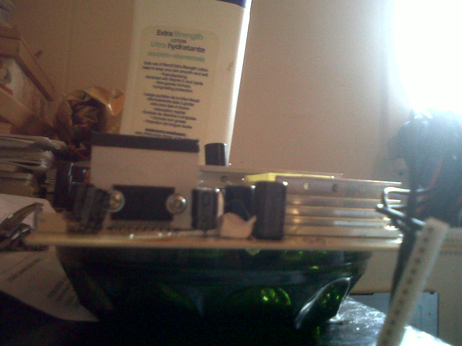

              • Mark369
                • Jul 2009
                • 163

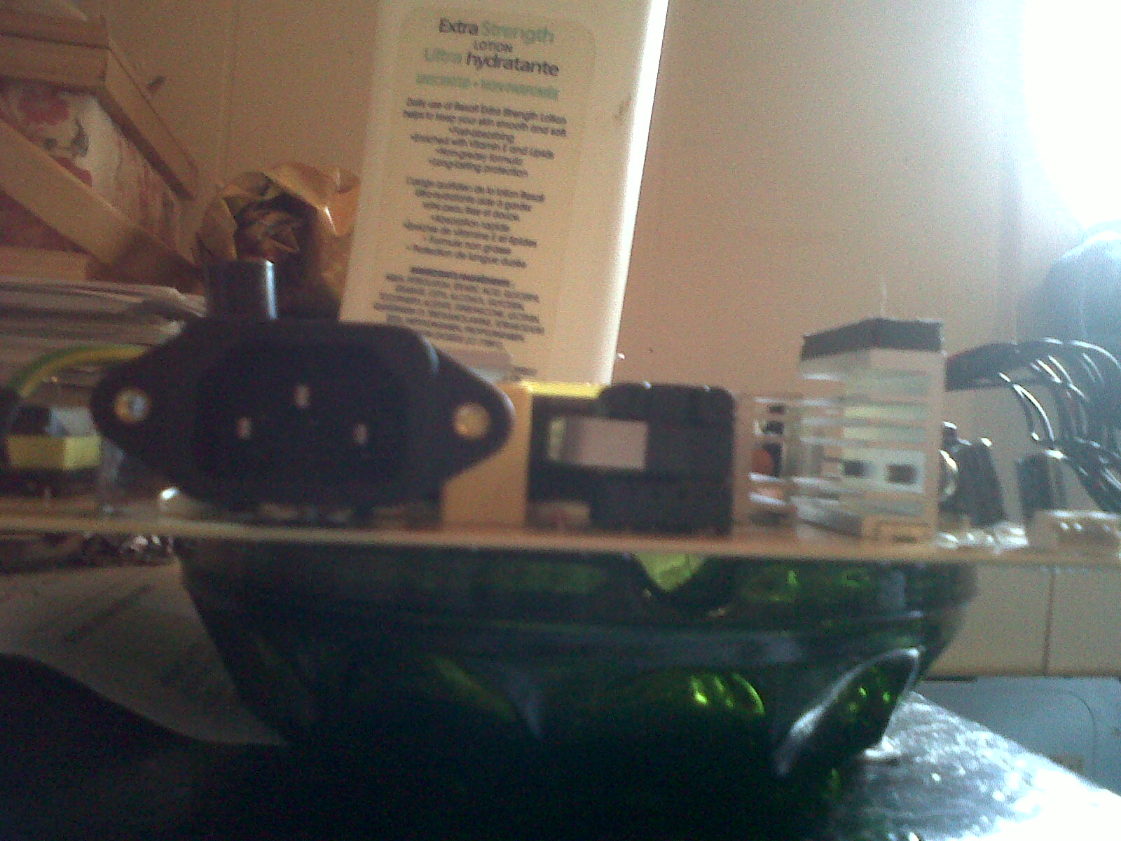

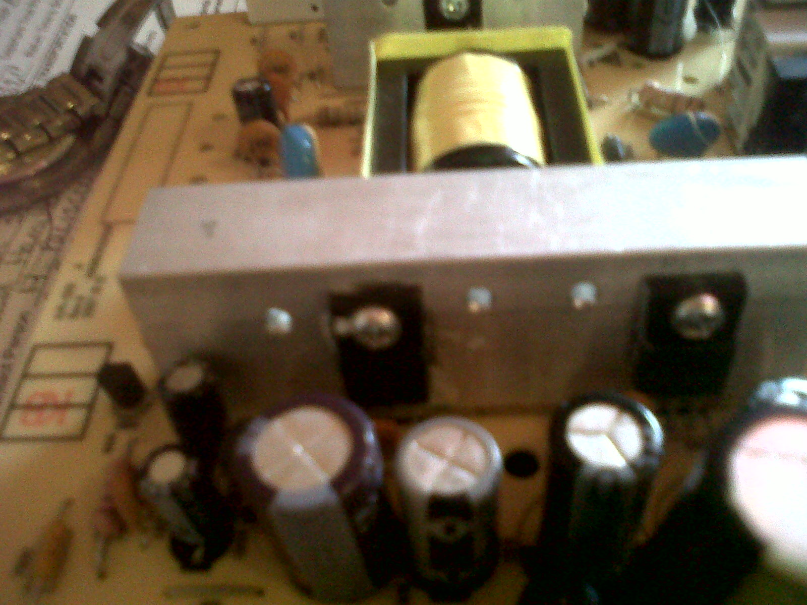

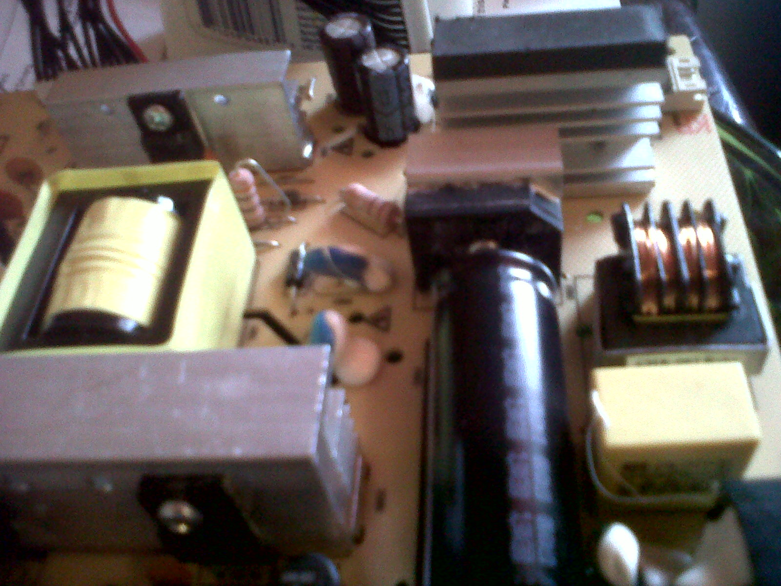

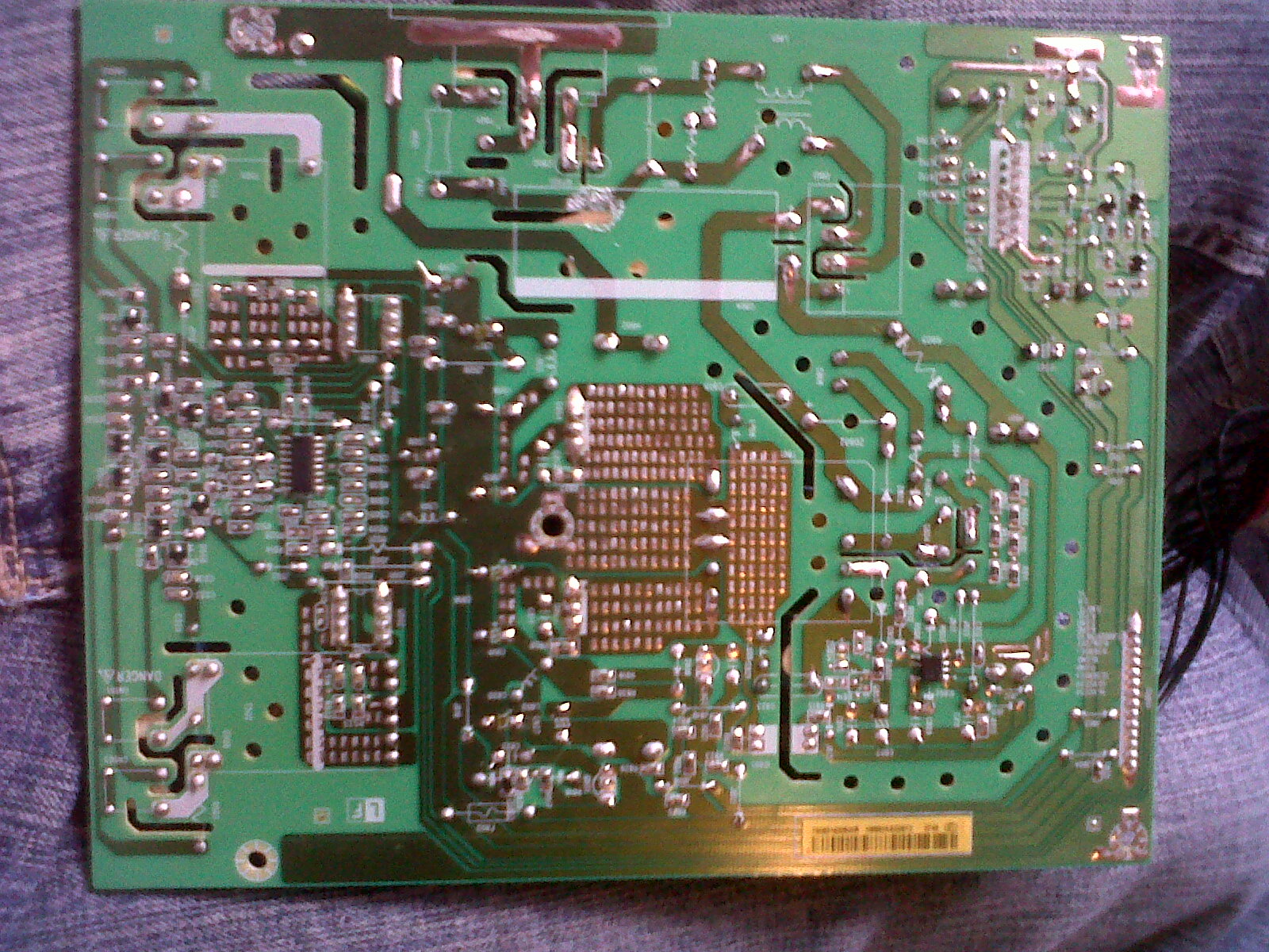

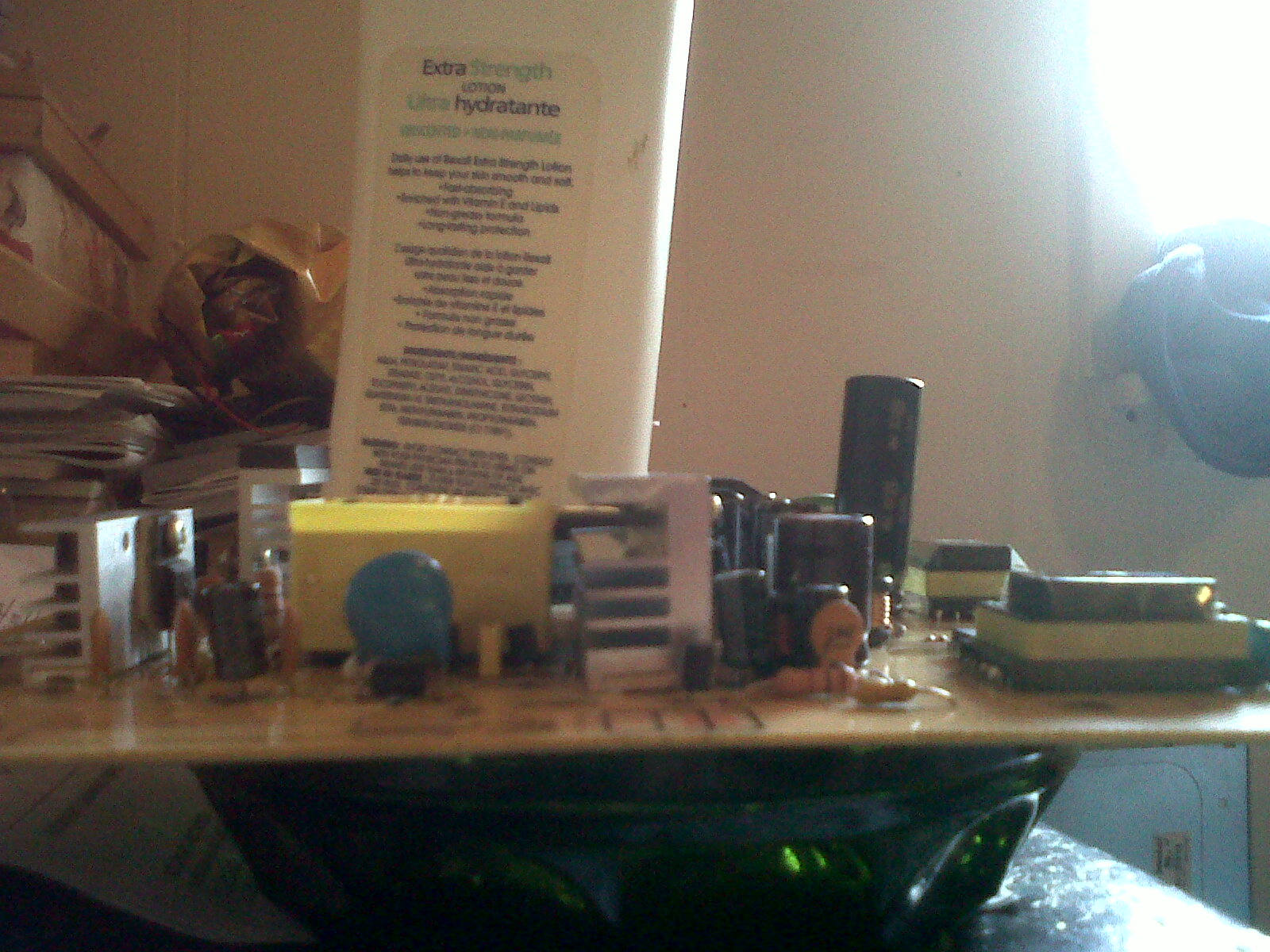

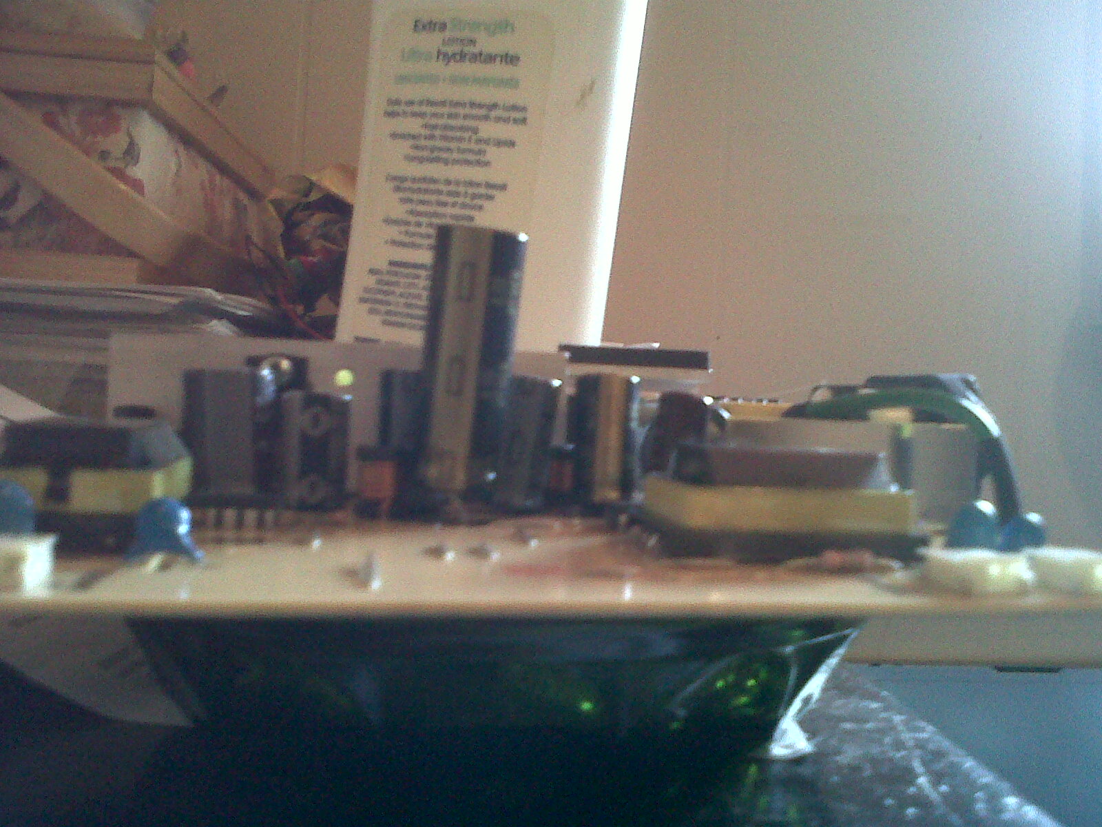

                Re: hp w2207h - died
                here are some pic's of the power/inverter board.
                the schottky diode attached to the big heat sink get hot.
                • PlainBill
                  • Feb 2009
                  • 7034
                  Please confirm something for me. You say the monitor is operating normally, connected to a working computer. After about 1.5 hours it displays 'No Input Signal', the after a few seconds the power LED goes orange and the backlights turn off. Is that correct?
                  If so, the problem is more likely to be on the signal (logic) card. I would suspect a voltage regulator.
                  PlainBill

                            • PlainBill
                              • Feb 2009
                              • 7034
                              it is not going to sleep i know this becasue i have it set up with 2 monitors
                              Enough!!! Let's get this straight before the top of my head blows off!!
                              Lower left corner of the second picture is the cable linking the power supply / inverter to the signal card. Just above the connector is a legend identifying the pins. What does that say?
                              PlainBill
