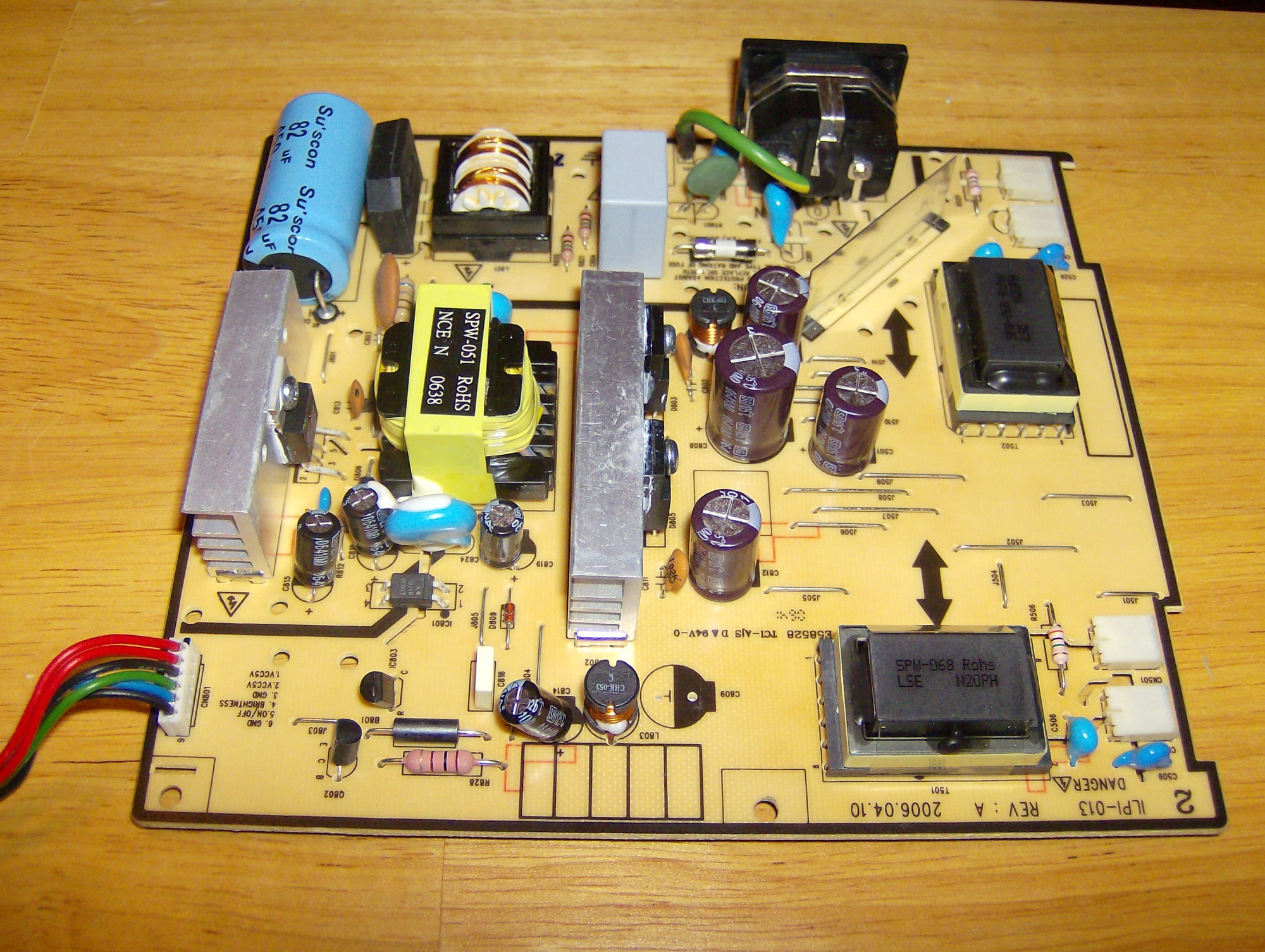

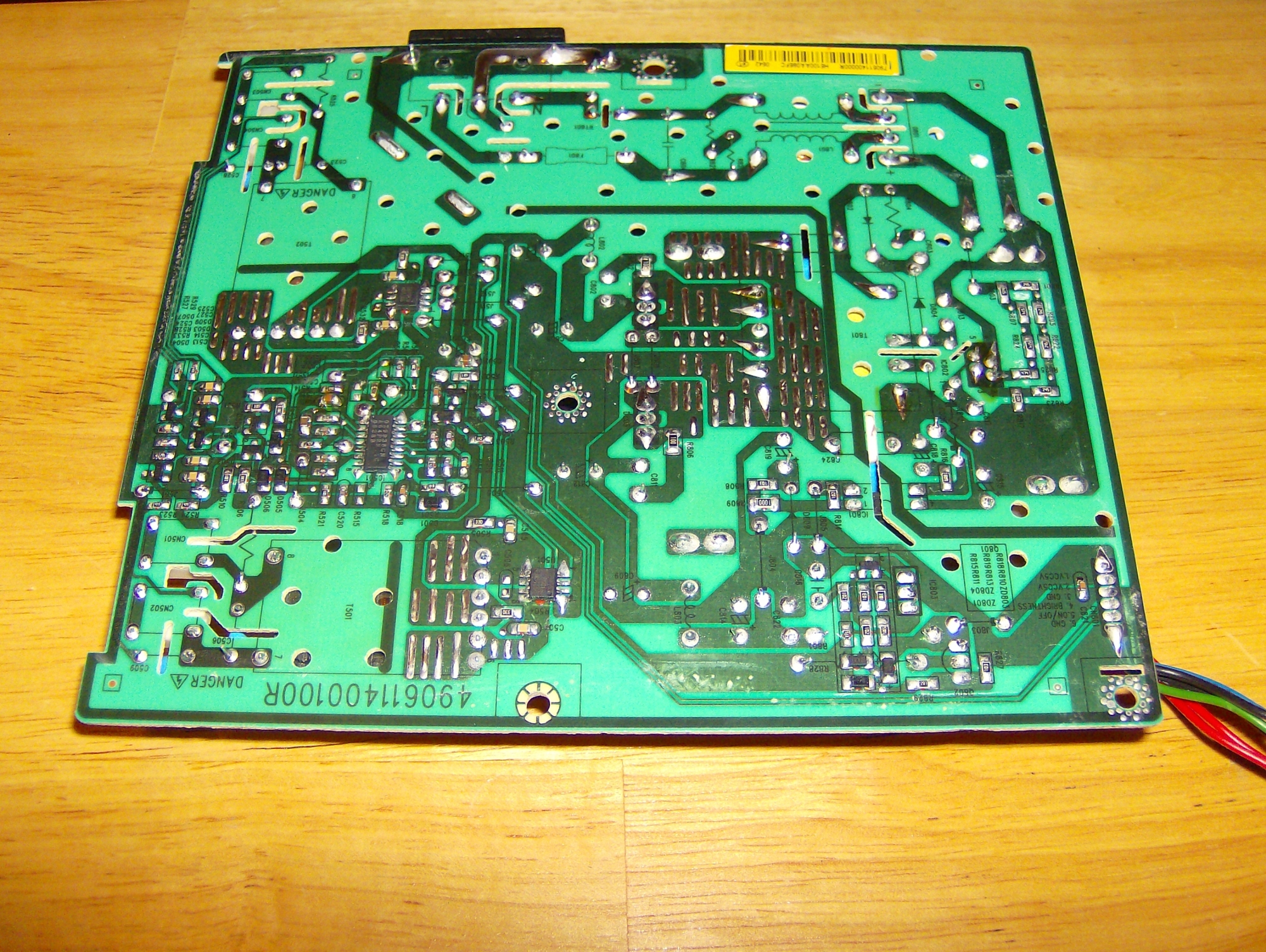

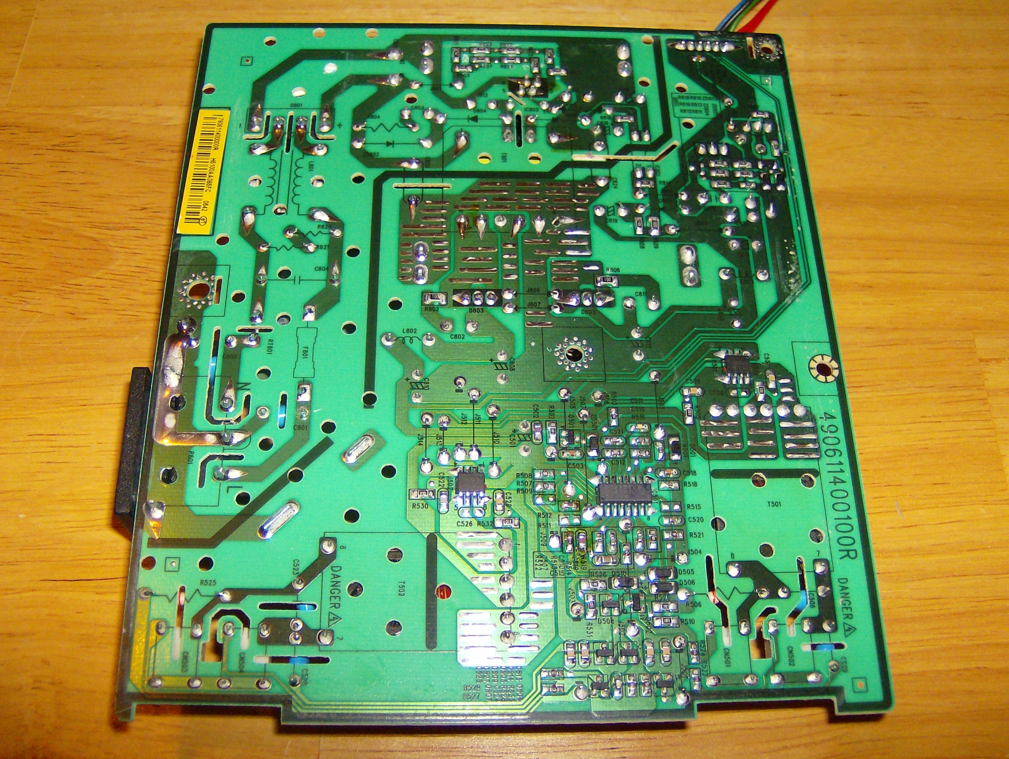

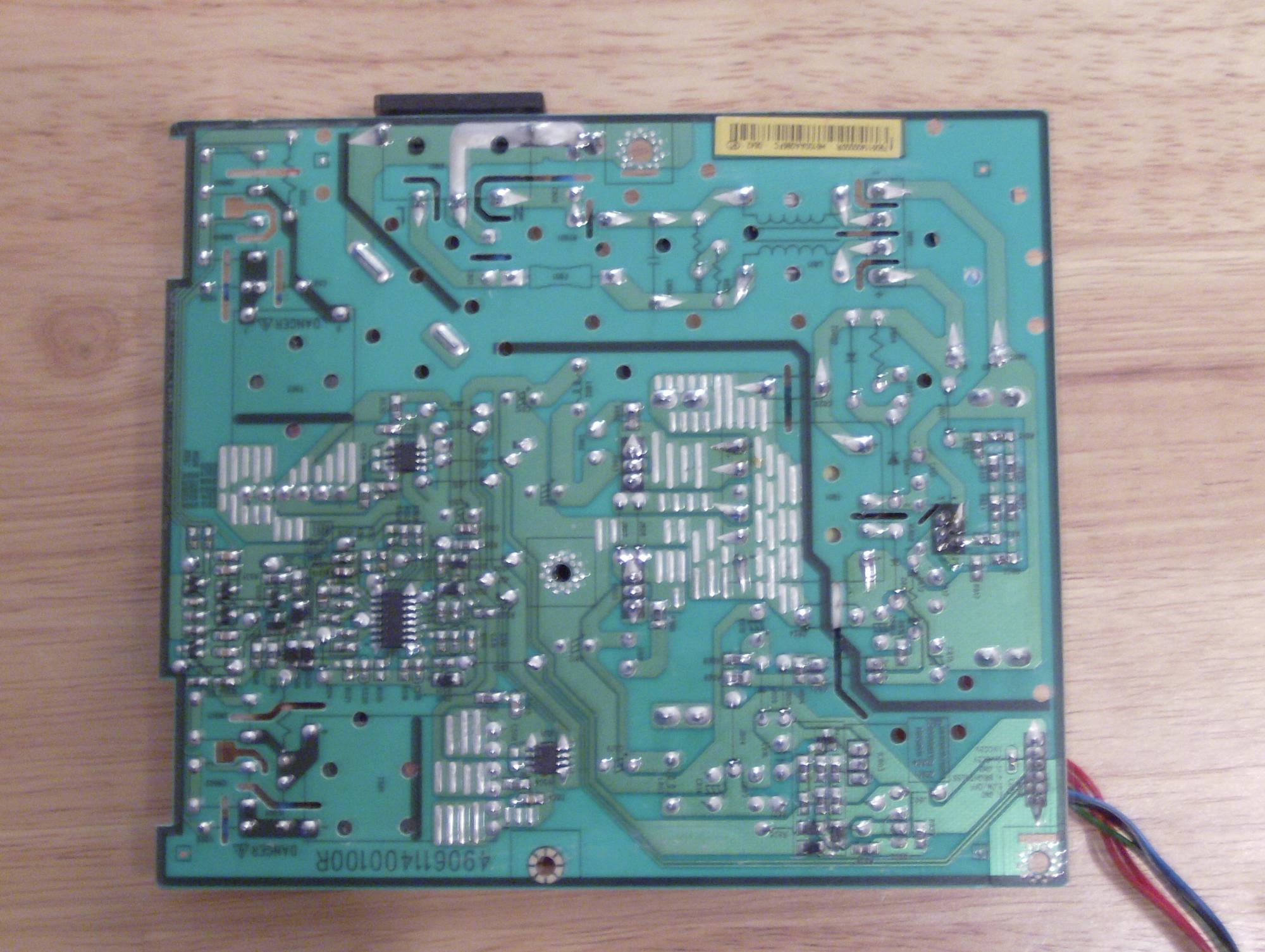

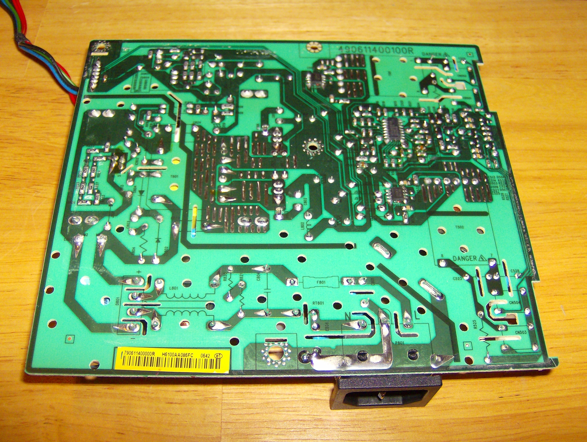

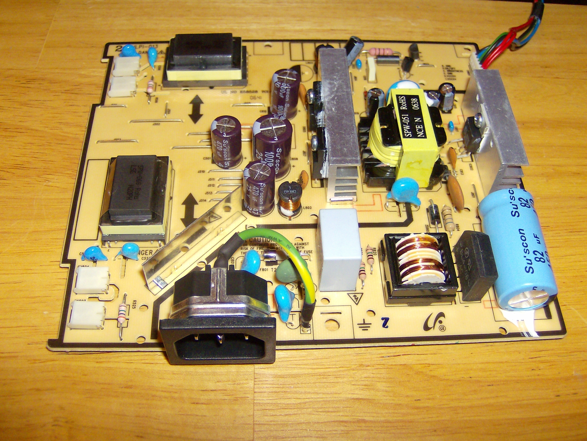

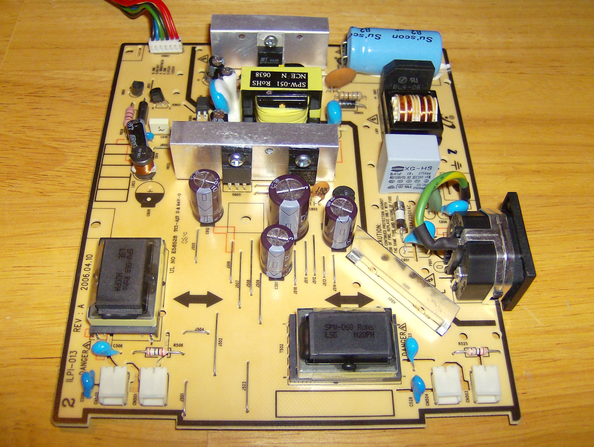

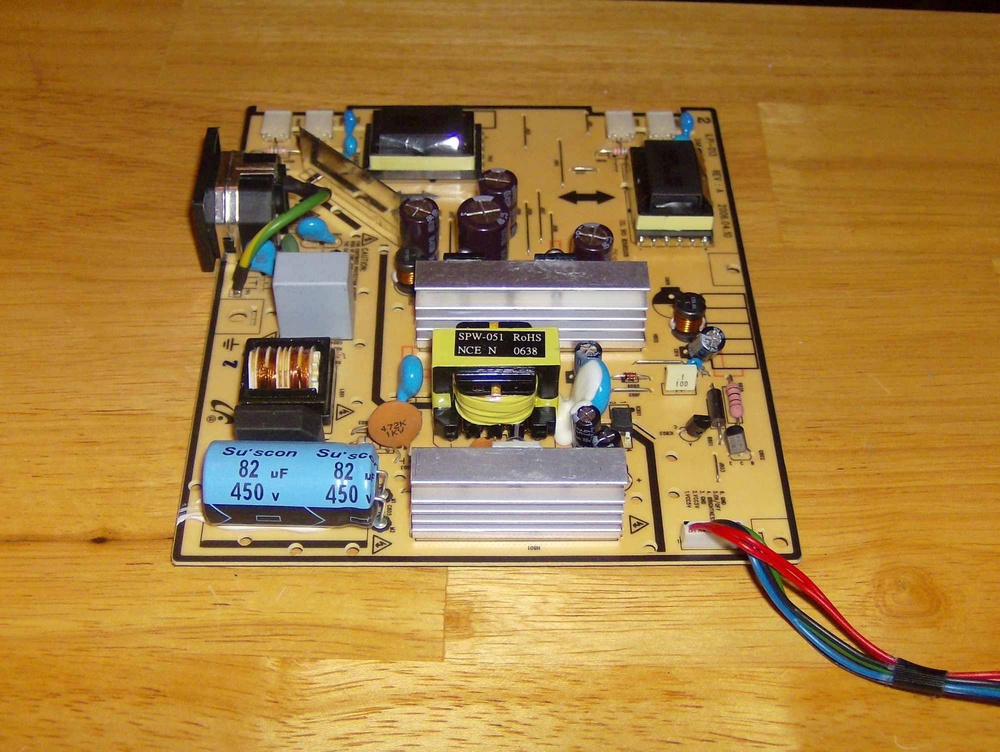

    I have a Samsung Model 731N with No Display.
    The power light does come on, green (does not go to amber).
    No matter if a computer is plugged into the monitor the Green power light flashes (it stays on about 1 to 1.5 seconds, then goes off and immediately comes back on to repeat the cycle), but there is no display.
    I am open to any ideas you may have.
    Attached is pictures of the PSU.

    Couple of quick things (going to try to sneak this reply in before PB gets here!):
    1. Search for some of PlainBill's past posts for a problem called "two seconds to black"; there are a few common solutions that take care of the majority of these occurrences (transformers, inverters, CCFL wiring). These tests have been described in great detail in many other posts.
    2. Take pictures with a little more detail. Here's a link to using macro mode for your camera: Photosmart M627 macro mode

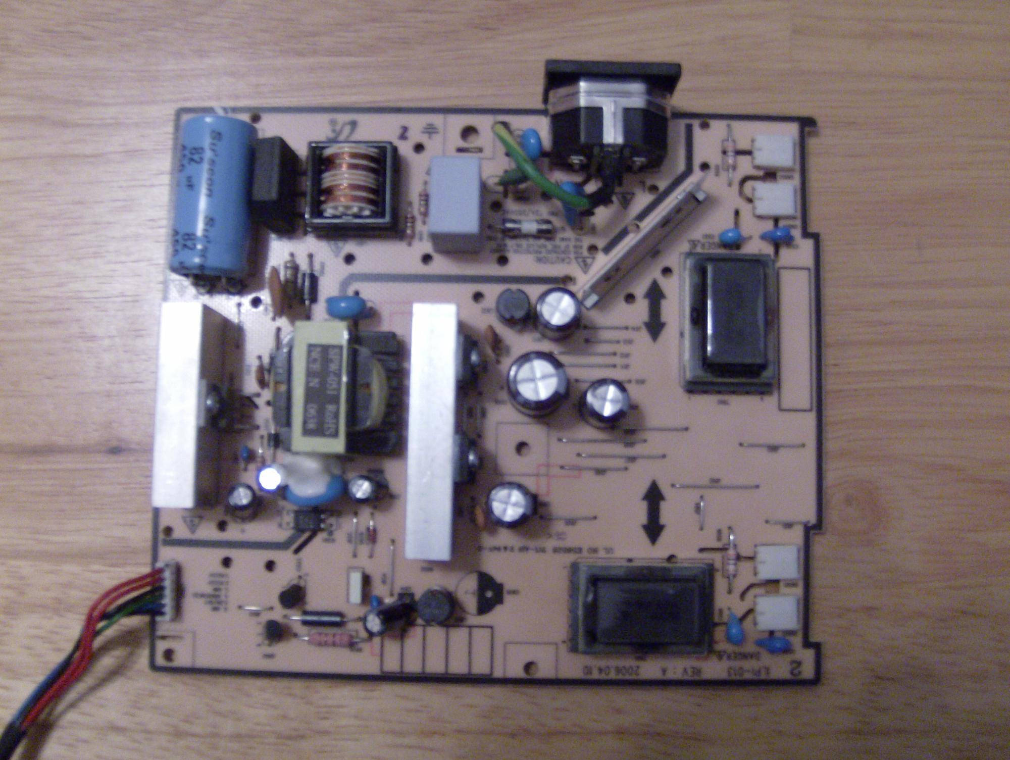

      Sorry about the pictures. I take the pictures at 3040 x 2288, but have to resize them (down to 2000 x whatever) to post them. I had previously been working on some small pictures and only saving them 25% Quality for web page work. So when I did these I forget to change the settings. Either way I took a few more pictures and they are below. Much better quality as you can probably tell.

        Apologies, I mis-read the original post about the power light coming on versus the screen.
        Have you replaced any caps or taken any measurements yet? Do you have test equipment handy (VOM or DMM)? Unless you've been able to troubleshoot and isolate a problem with particular component(s), generally the first step is to replace all of the electrolytic caps. Check for open fuses as well.
          Re: Samsung Model 731N No Display

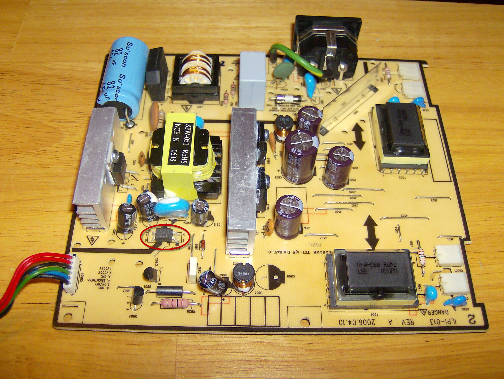

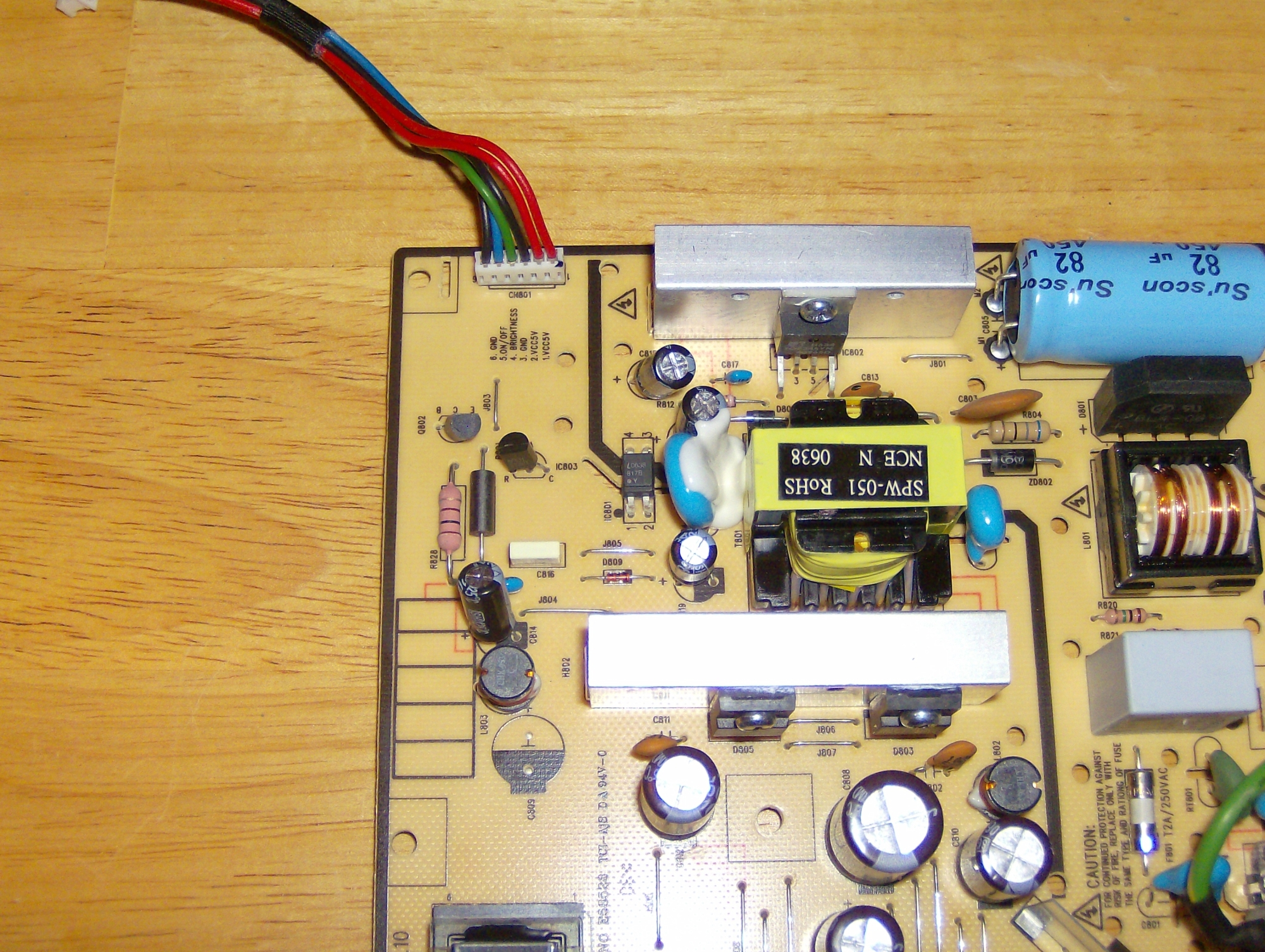

          I'd be interested in looking at this part (see circle). What's the part number?
          But I'd start first with the fuses, and if OK, then replace all the Su'scon caps.

            Attached is a better picture of that component you mentioned.
              A couple of points pop up.
              First of all, I'm concerned about the lack of a reading across the large cap. This should be 1.4 times your line voltage, or about 165 Volts DC.

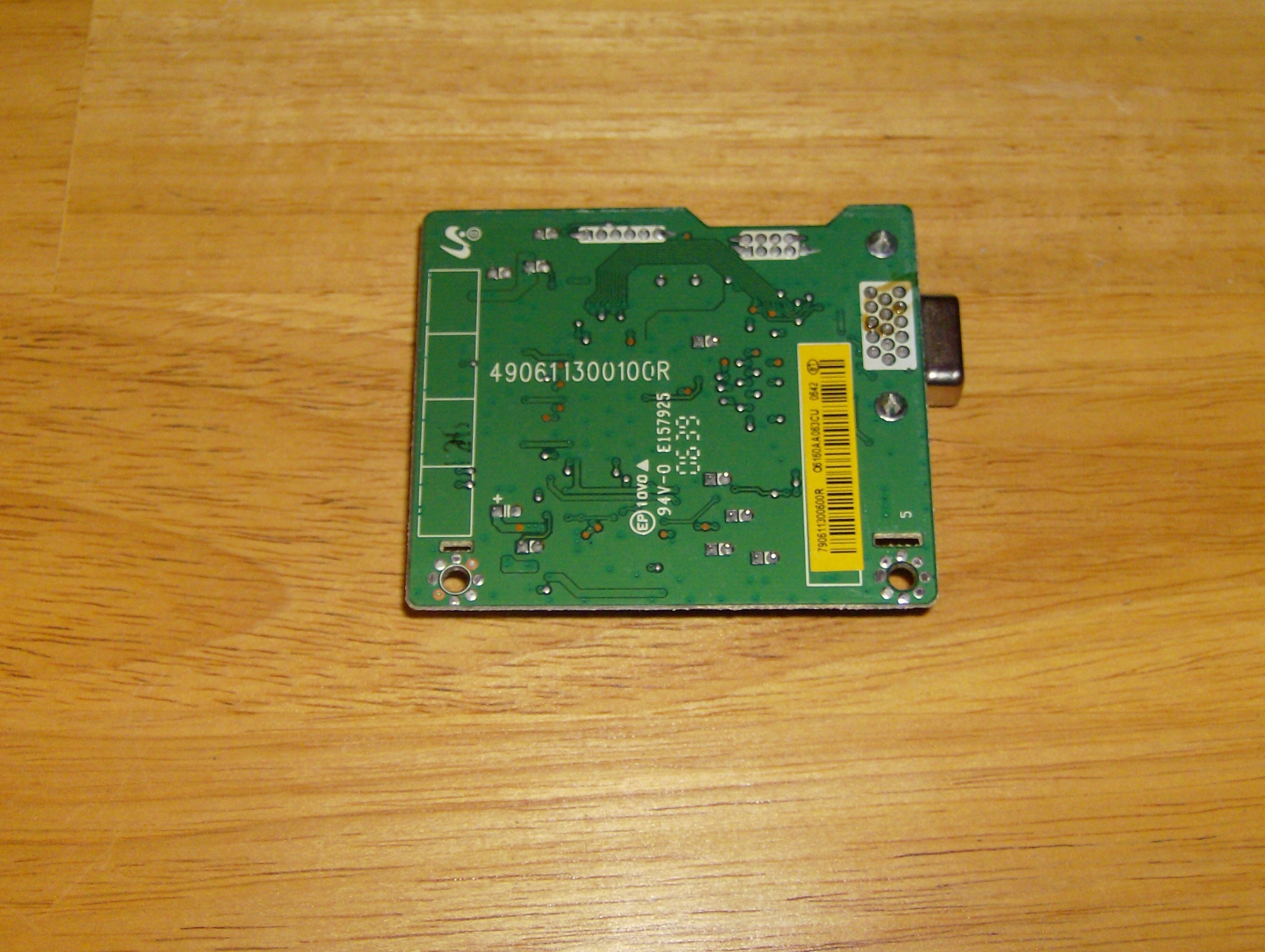

              Second, there is a multi-colored cable running to the logic card. There is a legend identifying the voltages on that cable. Check the readings from the Gnd pins to the other pins.
              As far as replacement caps; if the voltage reading across the large cap is correct, I wouldn't replace it at this time. Definitely replace the other 8. Post the values, voltage, and dimensions of the existing caps if you would like help identifying replacements.
              An excellent source of these caps is Digikey in Thief River Falls, MN. I won't say they are as isolated as you are, but they claim that on clear winter nights they look south to see the Northern Lights. Choose the First Class Mail shipping option for a fast (2 days), inexpensive (under $2.50) delivery.

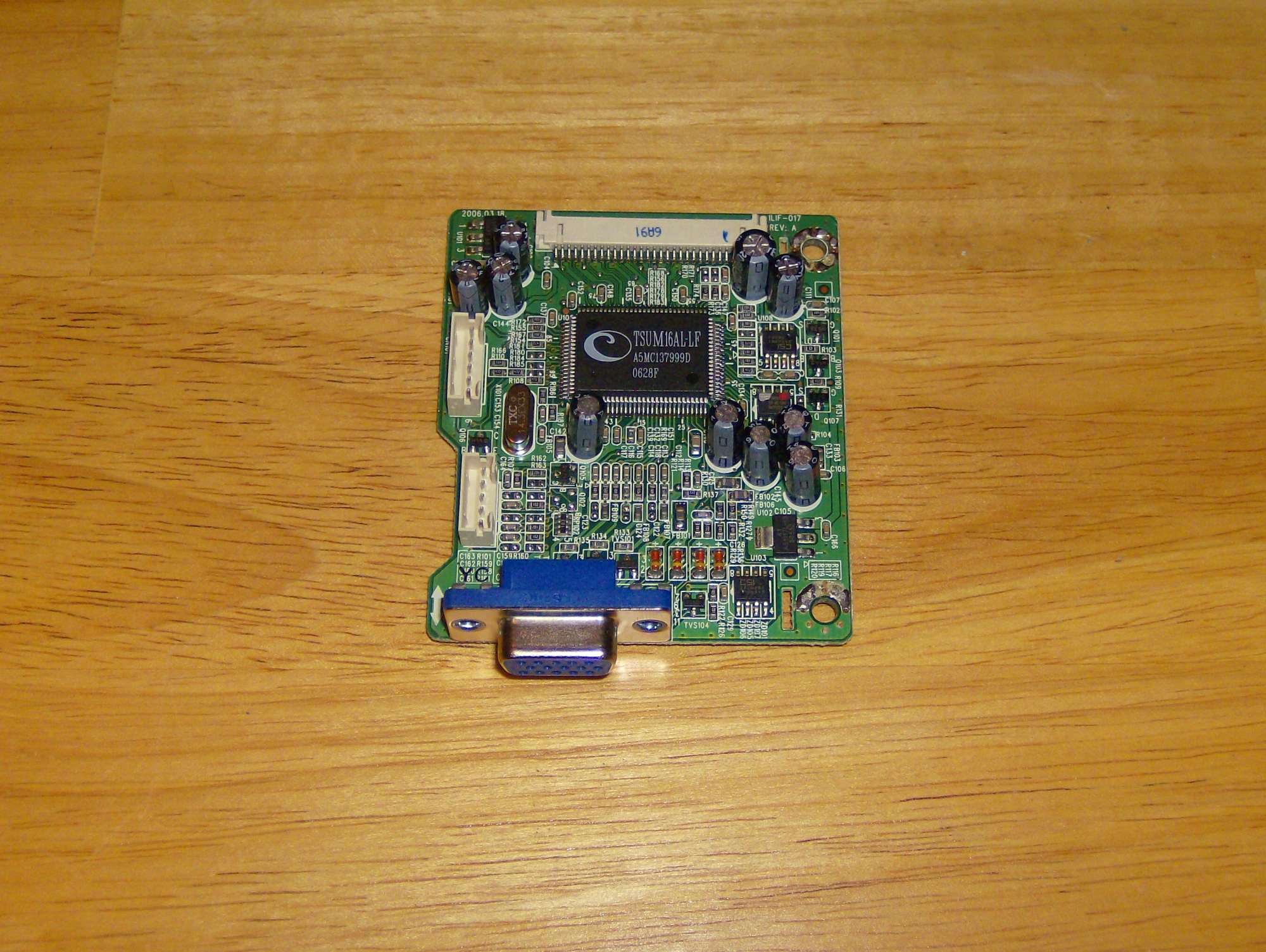

              One other thing to do is to post pictures of the logic card. Your symptoms sound like they might be due to a problem there.

                  As for the caps on the PSU...
                  1x Big Blue is 82uF 450V
                  4x Small Blacks are 47uF 25V
                  2x Small Browns are 470uF 25V
                  1x Med Brown is 1000uF 10V
                  1x Large Brown is 1000uF 25V

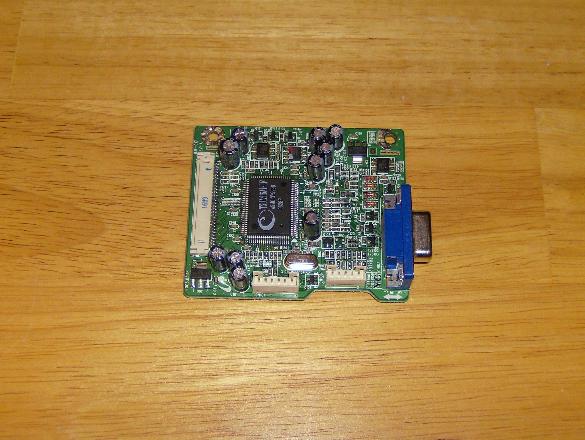

                  Attached is pictures of the Logic Board

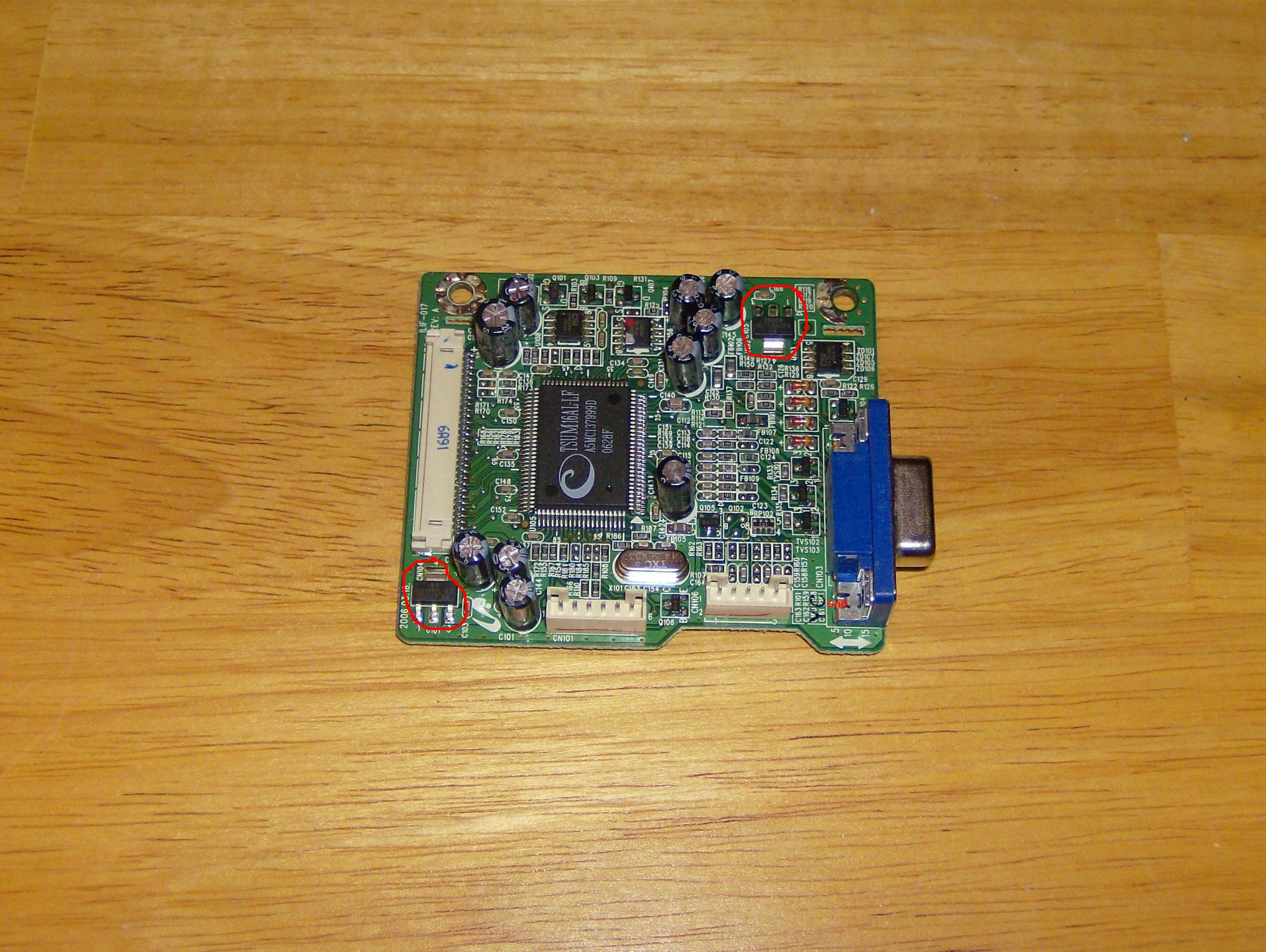

                                As for the two voltage regulators.
                                Lets call the upper right one Number 1 and lower left one Number 2.
                                Number 1
                                Labeled
                                Line 1 A1
                                Line 2 AS1117L-18
                                Line 3 B0552
                                Voltages
                                Pin 1 0V
                                Pin 2 4.02V (unlabeled)
                                Pin 3 5.06V
                                Pin 4 4.02V
                                Number 2
                                Labeled
                                Line 1 A1
                                Line 2 AS1117L-33
                                Line 3 B0637 38
                                Voltages
                                Pin 1 0V
                                Pin 2 3.28V (unlabeled)
                                Pin 3 5.07V
                                Pin 4 3.28V
                                All voltages were measured to ground, in the lower left on the Monitor plug.

                                        Bad news. The AS1117L-xx chips are voltage regulators, supplying critical voltages to components on the logic board. The xx in the part number indicates the output voltage. -33 indicates 3.3 volts, -18 indicates 1.8 volts. Severach had encountered a similar problem in this thread. Note in that case the overvoltage had fried the video chip on his monitor. At this point I wouldn't bother replacing the caps. If a voltage regulator becomes available, I'd try it before replacing the caps. An equivalent part by STMicroelectronics (497-6868-1-ND) is available from Digikey (497-6868-1-ND) for $.75 each.
                                        PlainBill
