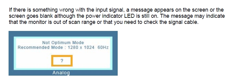

                      Re: Samsung Model 731N No Display
                      Here is all the manual tells you about my error. The manual can be downloaded from the Samsung website here. The manual is in PDF format. The picture is taken from this manual on page 32 and I give Samsung full credit for it. I just wish it was more helpful. I am still looking for a schematic.

                        Now that I've seen it, it appears likely that the monitor is expecting a signal, and seeing none, complains about it. My monitor does that. When you set this up as a second monitor, did you see an image display from the computer (not the error message)? If not, set it up as a sole monitor and see if it displays an image.

                          When I say secondary monitor I mean plugged into the monitor port on my laptop and configured as a second monitor, configured as the primary monitor, and configured just to display/copy my laptop screen. However I also tried plugging it into a test desktop and still had the same issue.
                          I think I will buy the logic card from china. I figure the monitor working is worth around $100, so I should be able to go up to $60 to attempt and repair it. Between the voltage reg with shipping and the logic card with shipping I will have sent $42. Well worth the attempt so far. You remove shipping costs and I will have sent $13 Oh the joy of living in the middle of nowhere.
