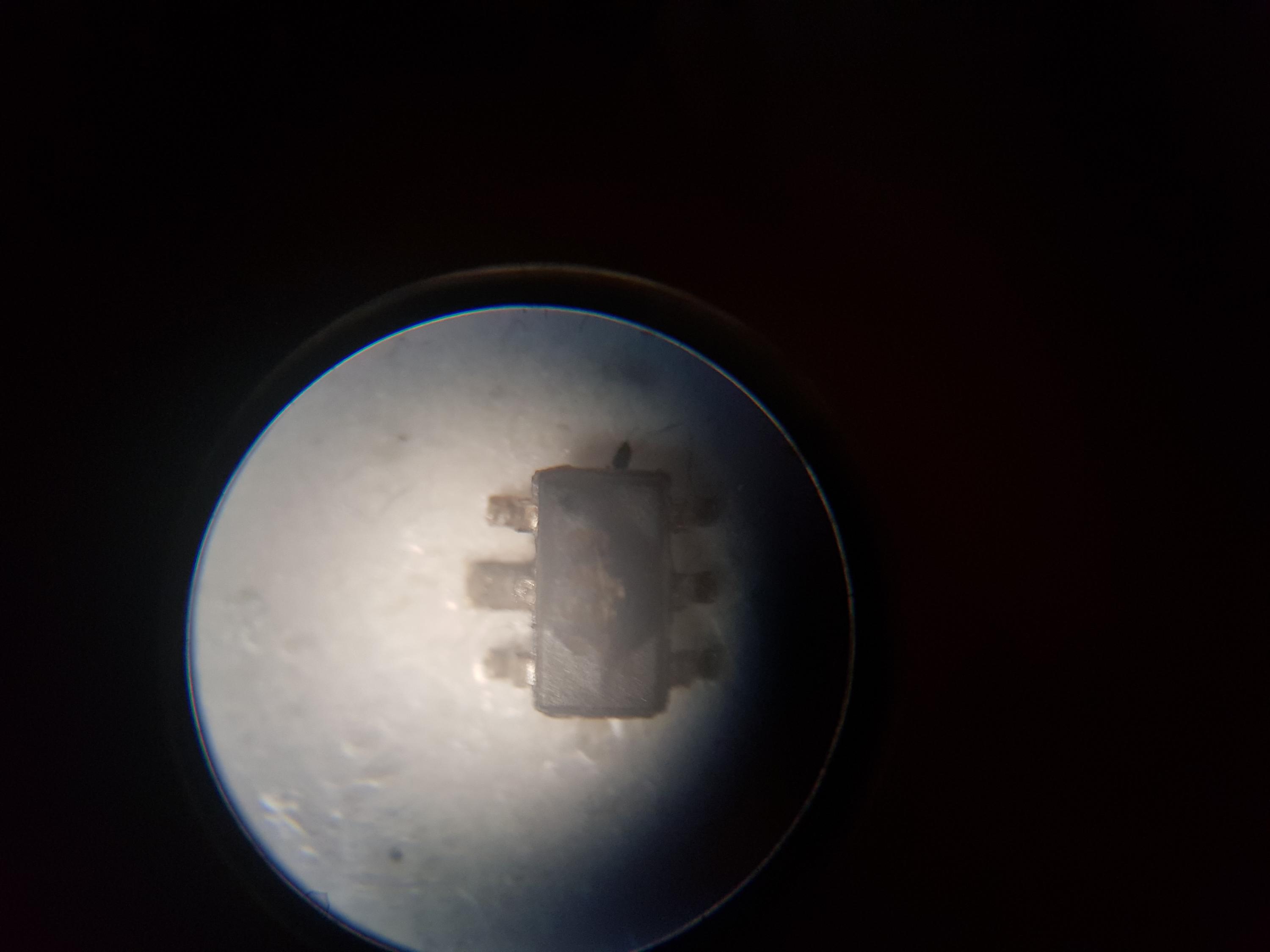

    My ASUS PG27V monitor died a couple of days ago. No LED no power at all.
    It has an external 19V power supply.

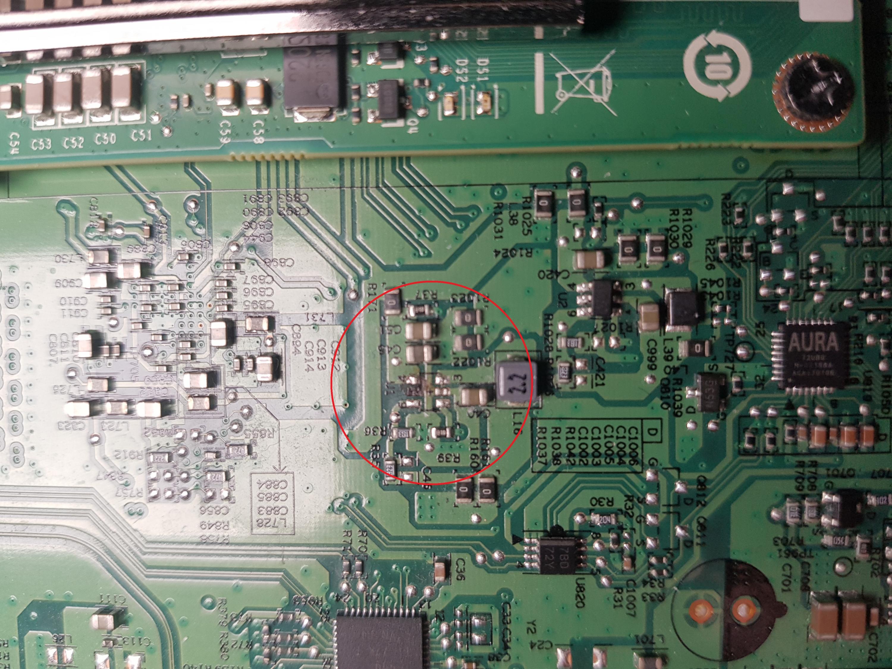

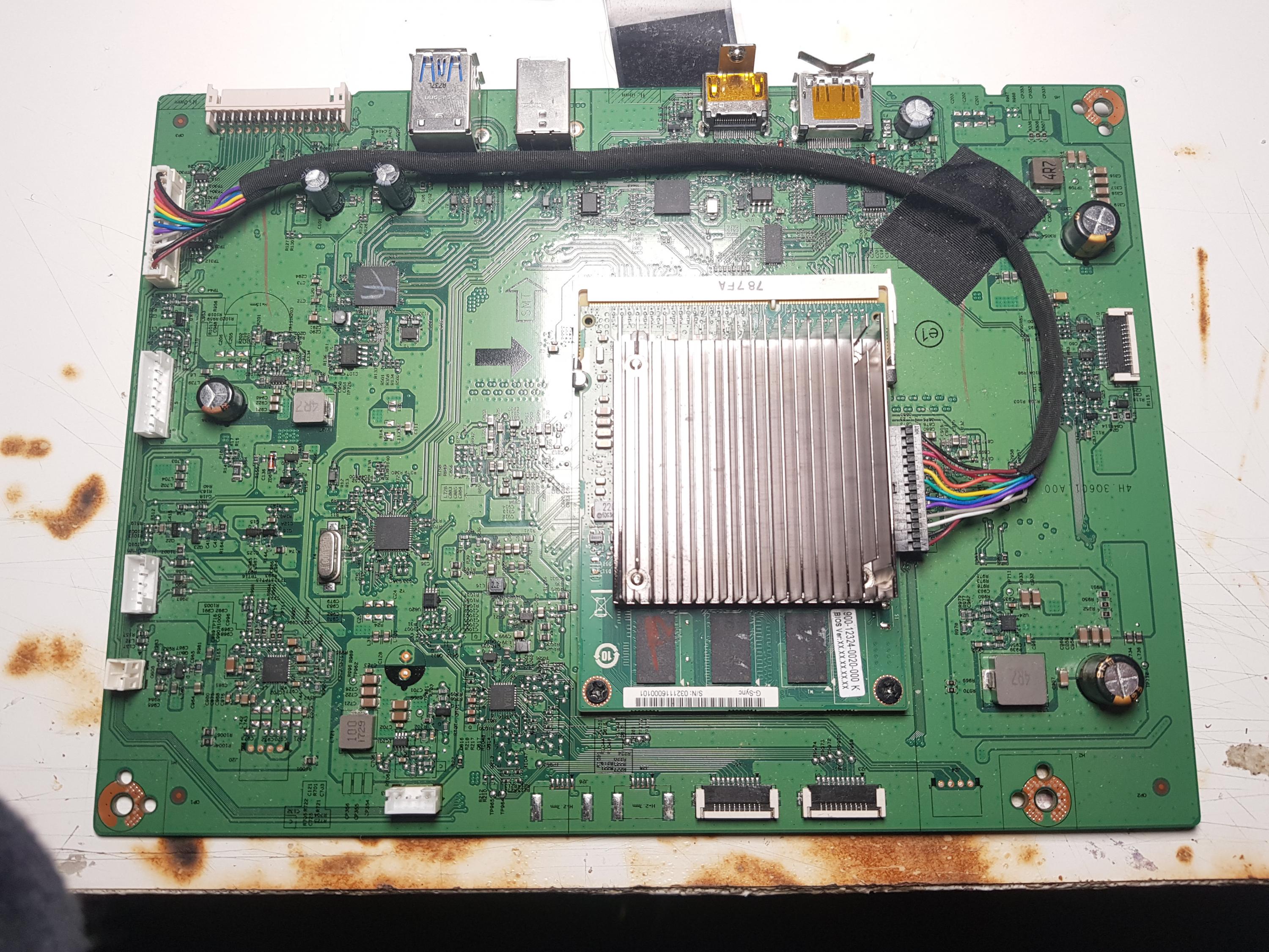

    I took it apart and it looks like there is a MOSFET SOT23? / Diode? blown. The board is a 4H.3Q601.A00.
    Below the blown part, there is the same or similar Mosfet with the lable "57199", but i can't find a datasheet to see if it is a shottky diode or an N-channel Mosfet.
    I need help to identify or figure out what part i can replace it with. I have some SOT23 Fets laying around.

    I suspect it is a LDO not a mosfet, Are you sure about the other number 57199?

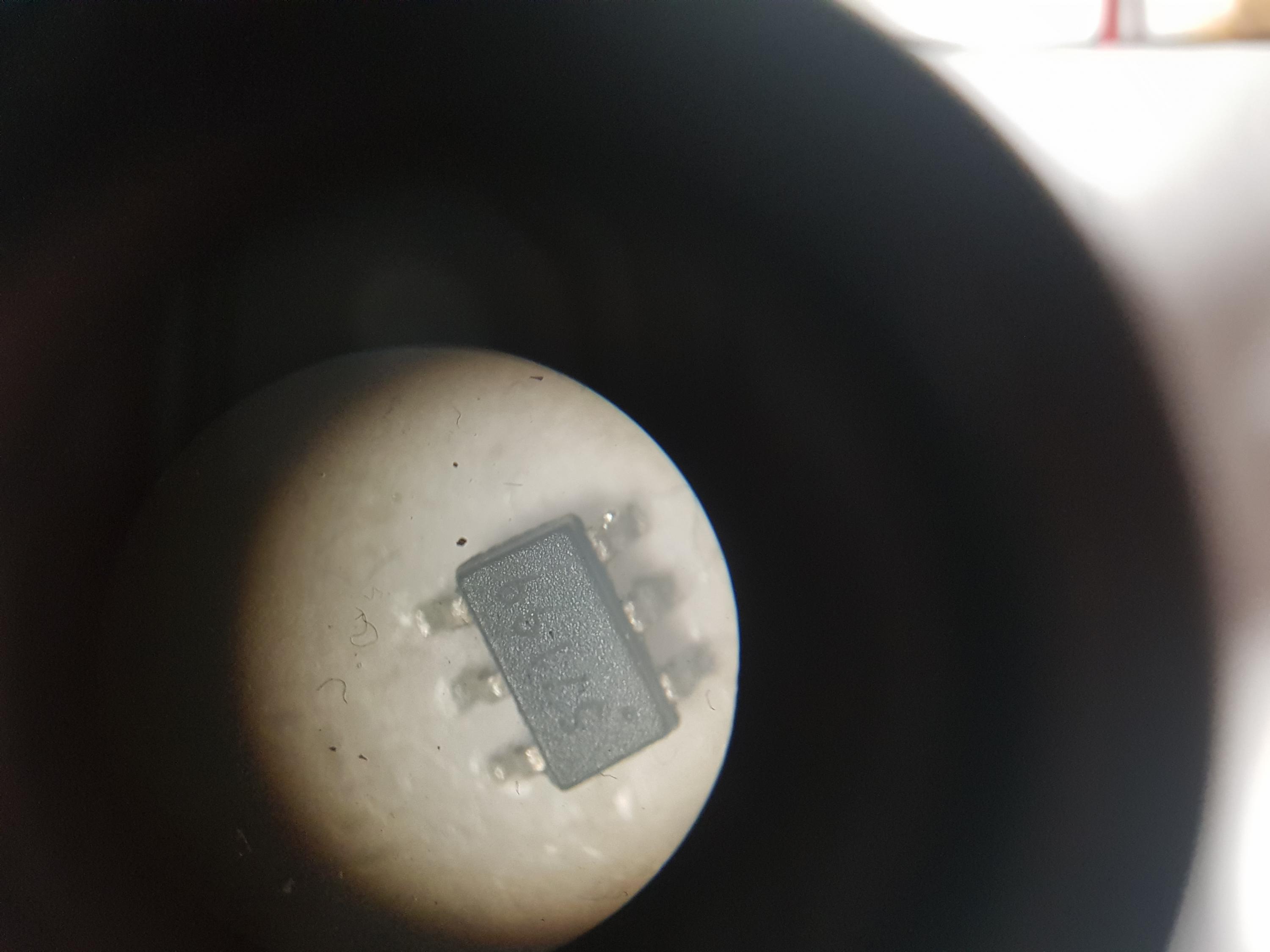

      Thank you for helping. I took a picture of the LDO its either 57199 or S7199.
      I looked at the blown LOD and yes you are right it seems like this one has a diffrent number on it ... it says "25A9" or "2549"
      Its very hard to see. I can't find any datasheet for either "25A9 or "2549"

        I can't find the number (it might be custom) but the ldo seems to have a pinout similar to a SY8009

          makes perfect sense. basicly i now go ahead and check the Vin voltage and replace it with a similar one.
