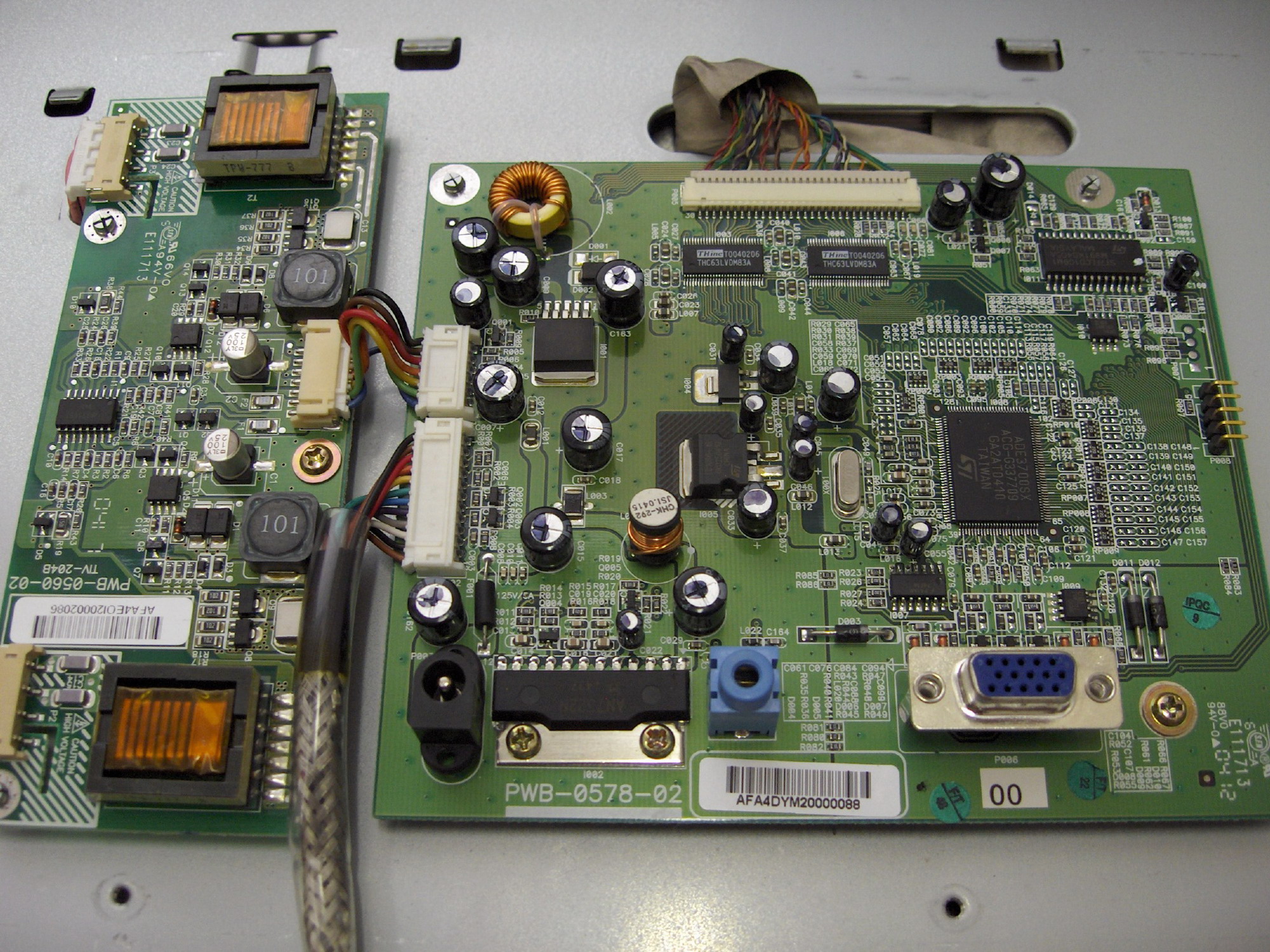

      ok i jumped the gun here. recently turned this lcd on and now i get nothing. no lights no amber no green. i do notice tho a small ticking sound coming from the power button area on lcd when plugged into its power supply. fortunately i took a pic of the power/signal board before when i took this thing apart before so i hope someone out there can possibly see something. any ideas. thanks.

          yes i tested it with a volt meter and also tried another 12v adapter. same thing. now that i listen a little closer there are two small speakers on the bottom left and right that are making the ticking/buzzing sound.
          pic attached is not mine but identical.

              ok i've done some deep investigating here....
              i rechecked my soldering job. its ok. now....heres what i have discovered.
              with the back cover removed exposing all electronic boards, and monitor plugged in to power, i was trying a few things and when i decided to unplug the video lcd cable from the power board lo and behold i got the display to light up to a white screen and nice and bright, then after roughly 10 - 15 seconds it went out and the yellow led power light came on and stayed on till i pressed the power button to turn off. after a few checks like this i tried something different. with the monitor plugged in and powered on to a white screen i plugged the video lcd cable back in to the signal board while powered on and got a signal image "check video cable" on the lcd then after a 10 - 15 second delay it displayed "going to sleep" it powered off and yellow power light came on. i am not able to power this item on with the lcd ribbon cable plugged into power board only when it is unplugged from power board. on top of that when im able to power lcd on to the white screen the green power led does not come but the yellow light does when it powers down. i hope i explained this well. thanks.

                ok im trying to bring this post back to life. any ideas as to why this lcd does this. here goes....
                computer turned on. lcd powered on. no green led light on?? i here ticking sound coming from the speakers. i have the back panel off. i unplug the lcd ribbon from the power board. the screen turns white. no led green light. i plug ribbon back into power board. i get windows image on lcd?? this is the only way to get this lcd to work? any suggestions.

                  That's the symptom of a power supply that's trying to start, but the load is causing it to current limit. When you remove some of the load (by unplugging the panel) the onboard supplies come up, and can sustain themselves when the panel is plugged in.
                  Thre are three approaches.
                  1. Take a picture from the side. Some of those caps certainly look like they are bulging.
                  2. I001, I004, and I005 are on-board regulators. Look up the data sheets for them and determine which is the output pin on each IC. Measure the voltage on each output when you hear the 'ticking'. Unplug, then plug the panel back in. Measure the voltages again. Replace the caps associated with the regulator whose voltage increased.
                  3. Replace C017 and the larger electrolytic next to the blue jack.
                  Hint: Option 2 will give you the feeling that you actually worked the problem through.

                    Have you checked the smaller caps, specifically the one right behind the DC jack?
                    Just had a Digimate 17" LCD which ran off a 12v power brick - it was taking longer and longer to get it to switch on, then it wouldn't at all.
                    Checked the 3 caps 2 x 100uf 16v and 1 x 220uf 16v in front of the DC jack, one 100uf 16v had an ESR of 1.08. Checked all other caps on the board, they had an acceptable ESR.
                    Replaced all 3 caps with 2 x 220uf 16v and 220uf 25v (all I had to hand) and it's working fine now (even with a missing pad).
