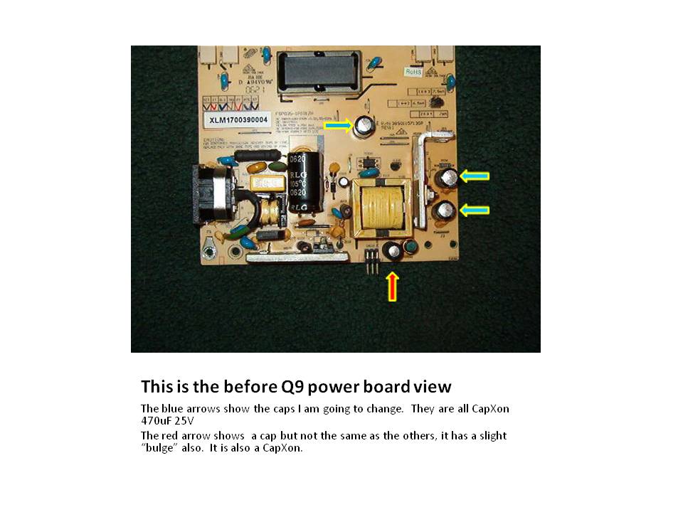

    We have the same problem with the Q9, and the same board as tiredcaps shows.
    So thanks for the very good coverage on what to do, and the pics. We will get back to you on how it all turned out.

        So I went in search of replacement caps and whoa... a whole new world of choices out there! I did the prudent thing and read your bad caps and good caps listings. I am leaning toward Rubycon or Panasonic. Suggestions are welcome since I have no clue in these matters.
        I do have questions on what exactly to purchase. I see all these different chemicle make-ups (I will refer to them as species) of capacitors. I think I am looking for 105C low ESR if I red everything correctly.

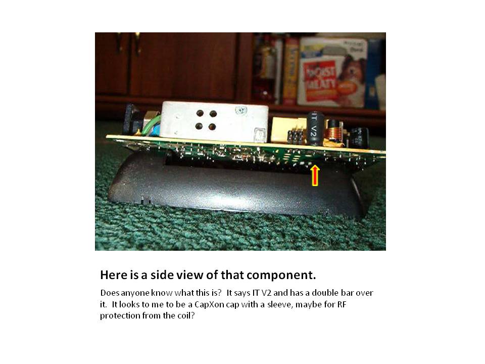

        There is one more question - please see the photos. What is this sleeve and how do I replace it? Does it come that way when purchased?
          I used Rubycon MCZ series, but Panasonic FM or FC series will work fine. Both are low ESR choices.
          Not sure. I looked at my own photos of this monitor and it is a cap indeed, but I didn't replace it.
          BTW, there is a "little" cap (C320) just right of the big cap. You should replace that too. It is part of the "startup" circuit. The little caps do not have to be bloated in order to be bad. Additionally, these caps are pretty cheap (probably 40 cents or less).

            I see no one answered my question on that sleeve. Any suggestions are appreciated. I want to do them all at once.
              My guess is to protect it from something? From what I don't know.
              Others may know its functionality, but if it were mine monitor and the cap was bloated, I would desolder it and cut open the sleeve to find out the uF and voltage. Maybe keep the sleeve?

                We finally ordered the caps and got the job done for both Q9s. It was real easy. We did not replace the small one, only the three 470's and the 330uF, which was hidded by what appears to be heat shrink.
                We did not replace the tubing. Mostly because the hubby was in a hurry to see if they worked. We will see how it goes.

                PS: We used Rubycon caps and orded from The Cap King. total cost = $4.21 (10 X 470 uF and 4 X 330 uF) and that included spares and shipping.
