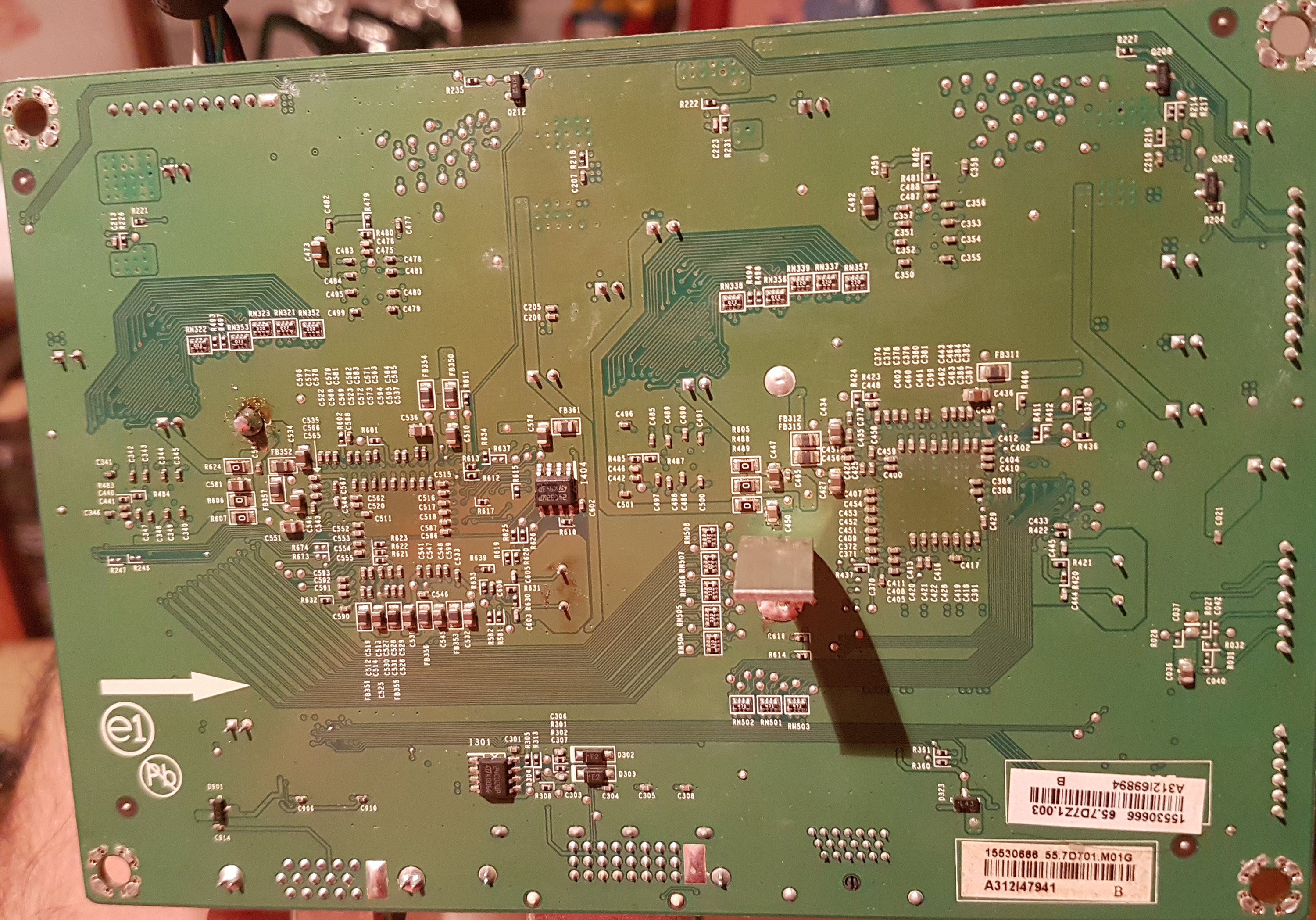

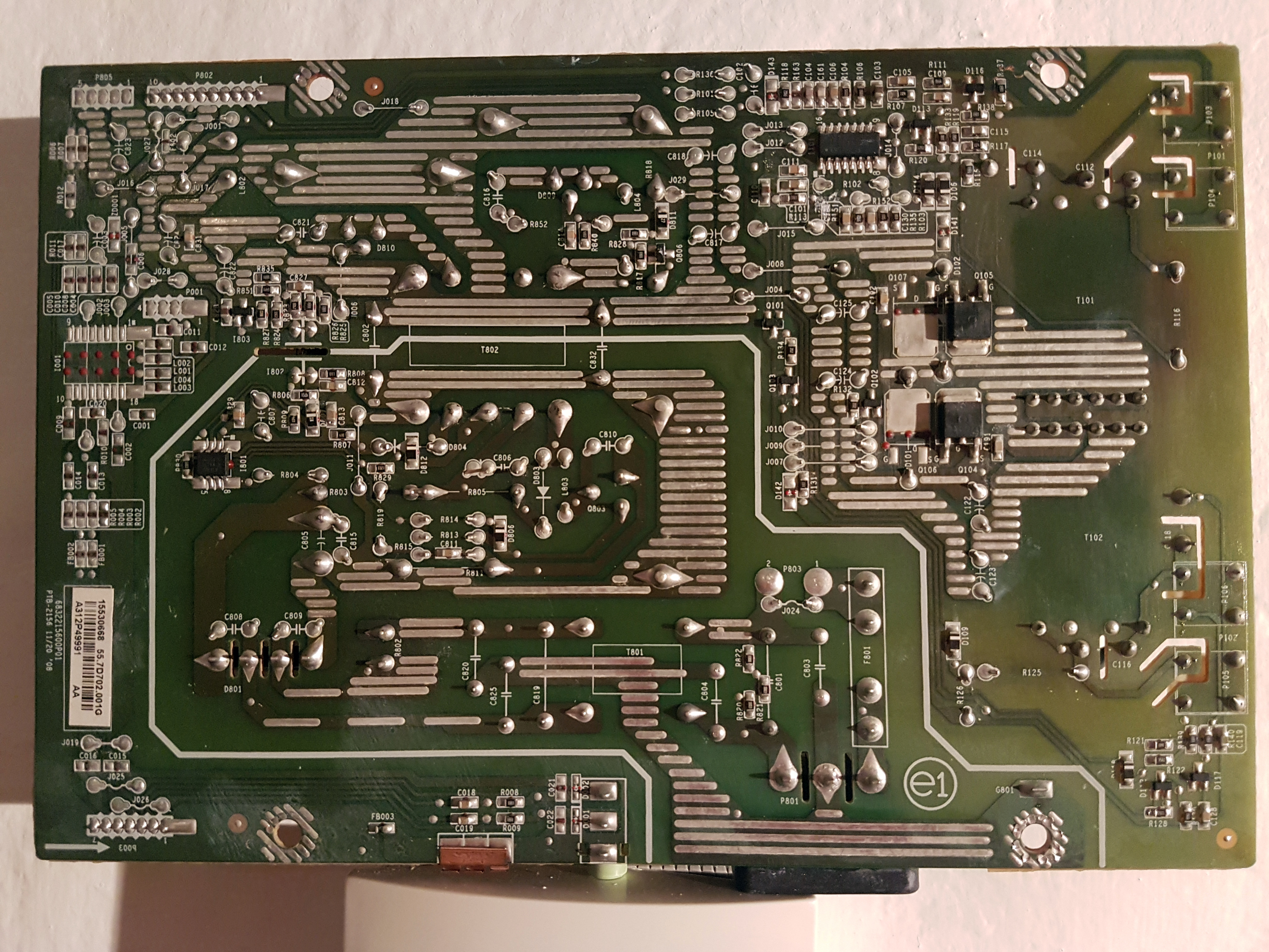

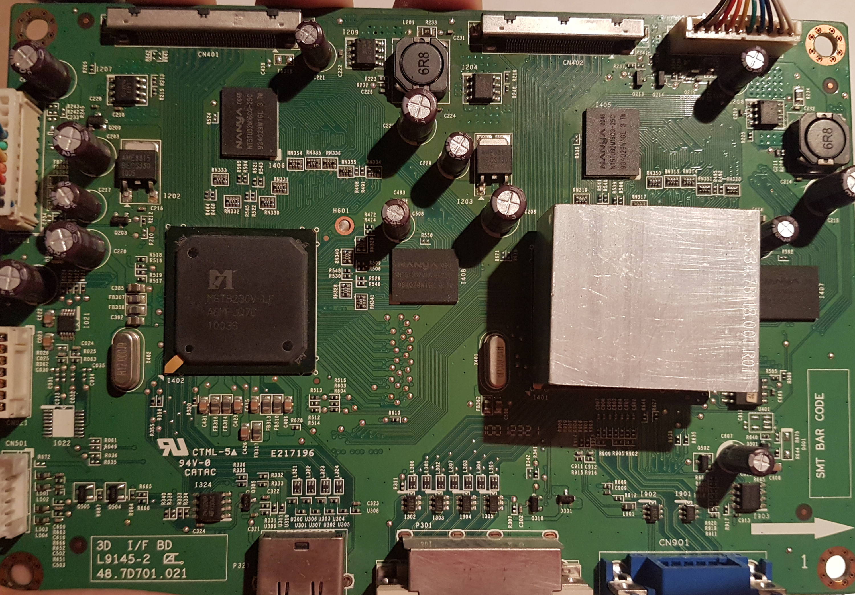

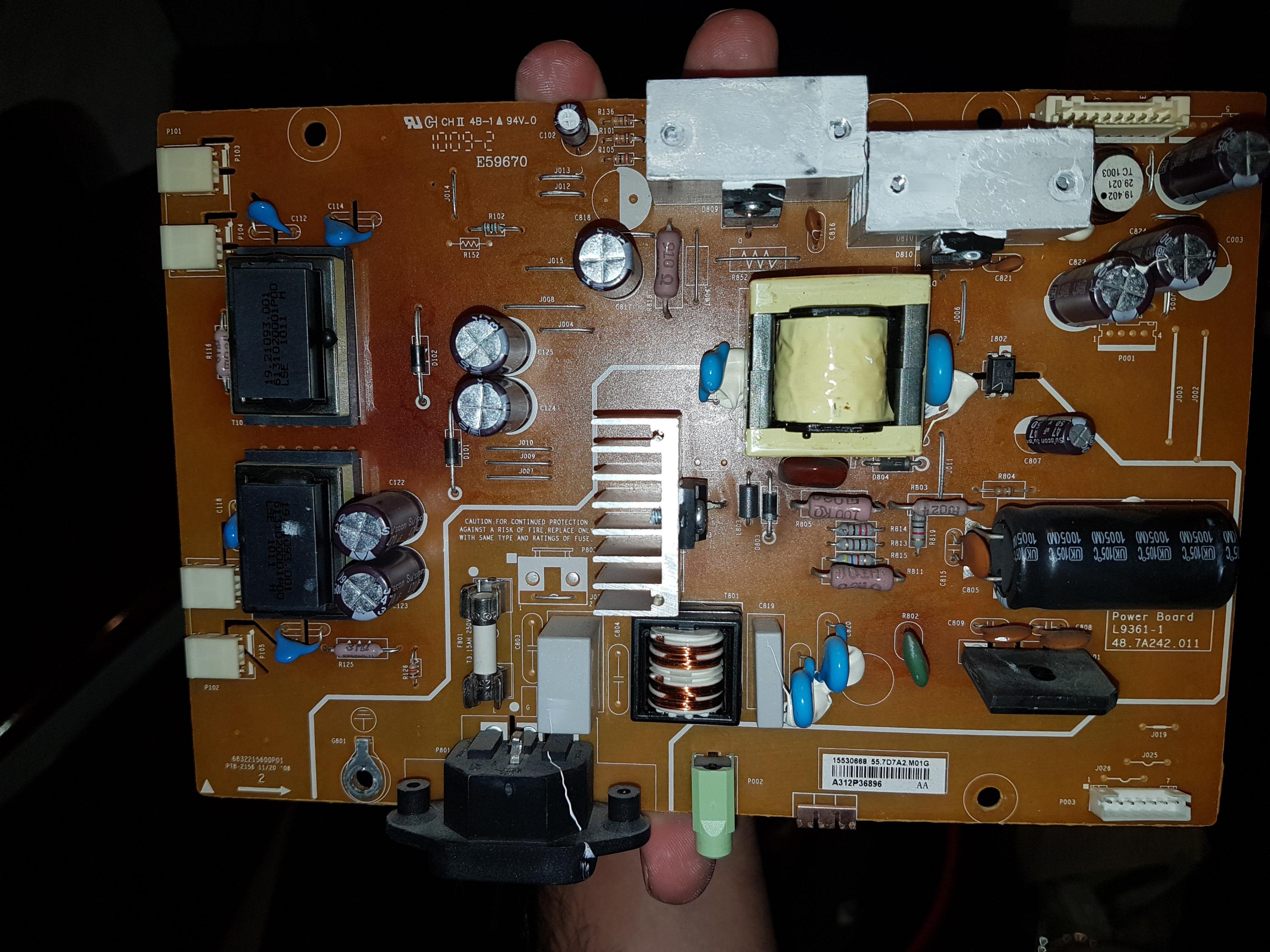

    Wouldn't let me edit my original post. Adding pictures of PS and main board.

      So, I took a gander with my lack of knowledge. Checked the PSU and was getting 5v off of both pins to the mainboard...
      So It's come down to the main board.
      Anyone have an idea where I should check first?
      I'll keep doing research, haven't found any documented guide / video or schematics of the board, so I'm a bit overwhelmed.
      the 5v pins on the PSU go into the main board on the red and orange wires on the front facing top left connector of the main board.
      EDIT: Following Budm's advice on the other post. Don't know how to check DCV on the board, but am checking the I202 and I203 Inverters???
      • G2idlock
        • Jun 2020
        • 5
        Re: ACER GD235HZ - Won't turn on
        I'm stumped I've reached the ever so slowly extending cap of my knowledge. As in the other post I checked the I202 and I203 (Not inverters, linear regulators) on the logic board.
        I202 and I203 are CMOS LODs Type AME8815BECSxxx
        http://www.ame.com.tw/datasheet/AME8815.pdf
        The diagram on the schematics shows me that pin 1 is ground, 2 out and 3 in. I'm using my $8 multimeter on diode testing ( ->|- ) mode to check if they work... But, color me stupid, I clearly don't know how to do this. I've tried red lead on 3, and black lead on 2 in I202 and get a increasing reading that caps out at 1850, then I switch black lead to 1 and get same number. On I203 same methodology but get 862 on pins 3&2 and 1850 on pins 3&1.
        What?
        What does this mean?

          5 VDC STBY on the PSU should be always on and goes to the main board. From there, when you press the power button, the main board should turn on the PSU (PSon) and the inverter (BLon). You should see somewhere between 2 VDC and 5 VDC on one or two of the pins on the returning to the PSU, in order for the PSU to turn on all power rails and the inverter. If there is only 5 VDC going into the main board and nothing coming back out from the main board to the PSU, the main board is toast. My best guess it would be then the main IC on the main board. Either it is bad, or it is a BGA issue.
          If you can figure out on the PSU what pins are PSon and BLon, you can force the PSU on yourself with out the main board by using two 1k resistors and jumping STBY to PSon and BLon and plug the PSU in. Once plugged in, the backlights should be on and all power rails on the PSU should be on too.

              I had the exact same issue but it wasn't due to a power outage. No power, no light. If I unplugged it from the wall it wouldn't come back on. The first time I let it sit for 3 weeks, tried it again and viola the light came on and the monitor worked for 3 months until I had to pull the power one day and it never turned on again...
              I started investigating and found a short to ground on pin 6 of I207 which led me to the BGA chip. I wound up re-flowing the BGA chip and it's now working again.
              I used the schematic linked in this thread to check voltages which was a big help (thanks to lepak06). It seems the 235hz and 245hq share a lot in common - https://www.badcaps.net/forum/showth...highlight=acer
