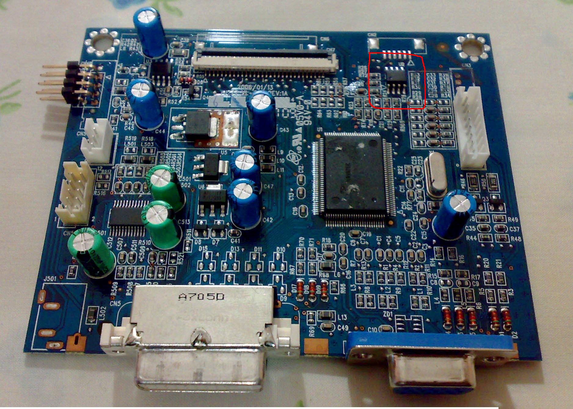

      Hello everyone I have the same problem and the conclusion to this is an eeprom Digikey part# 24LC16B-I/SN-ND
      according to the image of the mainboard The image has two such chips with eight legs which one is the eeprom or are two. eeproms
      Thank you

        Re: cy199 i-inc showing blue and yellow led only when connected
        On your machine do the two chips have any writing on them?
        Did you try the button resets mentioned earlier?
          Hi just done 2 of these have circled in red the chip that needs replacing.
          Once done turn on power and it may flash blue and yellow a few times before it sets up if not turn off and on again .
          Of the 2 i did one fired up straight away the other needed turning off and on again .

            Anyone know if these eeproms can be reset/wiped without having to remove?
            • sabre504
              • May 2010
              • 449
                Yes I saw that but as you are replacing with a blank unwritten chip it obviously doesnt need programming.
                I understand some atmel eeprom chips can be reset by shorting 2 pins SDA and SCL and wondered if it would work on this as well.
                If it did work it would be a lot easier than removal
                  Well i looked all over net and couldnt find a combination of buttons for a reset,tho someone else may have ?
                  Also looked for a way to short but again no joy so went the replace route .
                  But i suppose it would be worth a try and if it did'nt work then can still be replaced .
                    Well according to the image that Sabre54 put up it's the one on the right in red, their is another that looks like it on the left
                    yup I tried the button reset no luck

                      #30
                      Only the one i circled needs changing .
                      Cant remember numbers on the other one but not the same anyway
                        Hello all,
                        can be the eeprom "EE24C16P (24C16-10PI-2,7)" use instead of the factory-soldered "24LC16BI SN0646" ?
                          Received my eeprom for my cy199 I-inc after tree tries I finally got it in right
                          and working. with out hot air it's a PITA.
