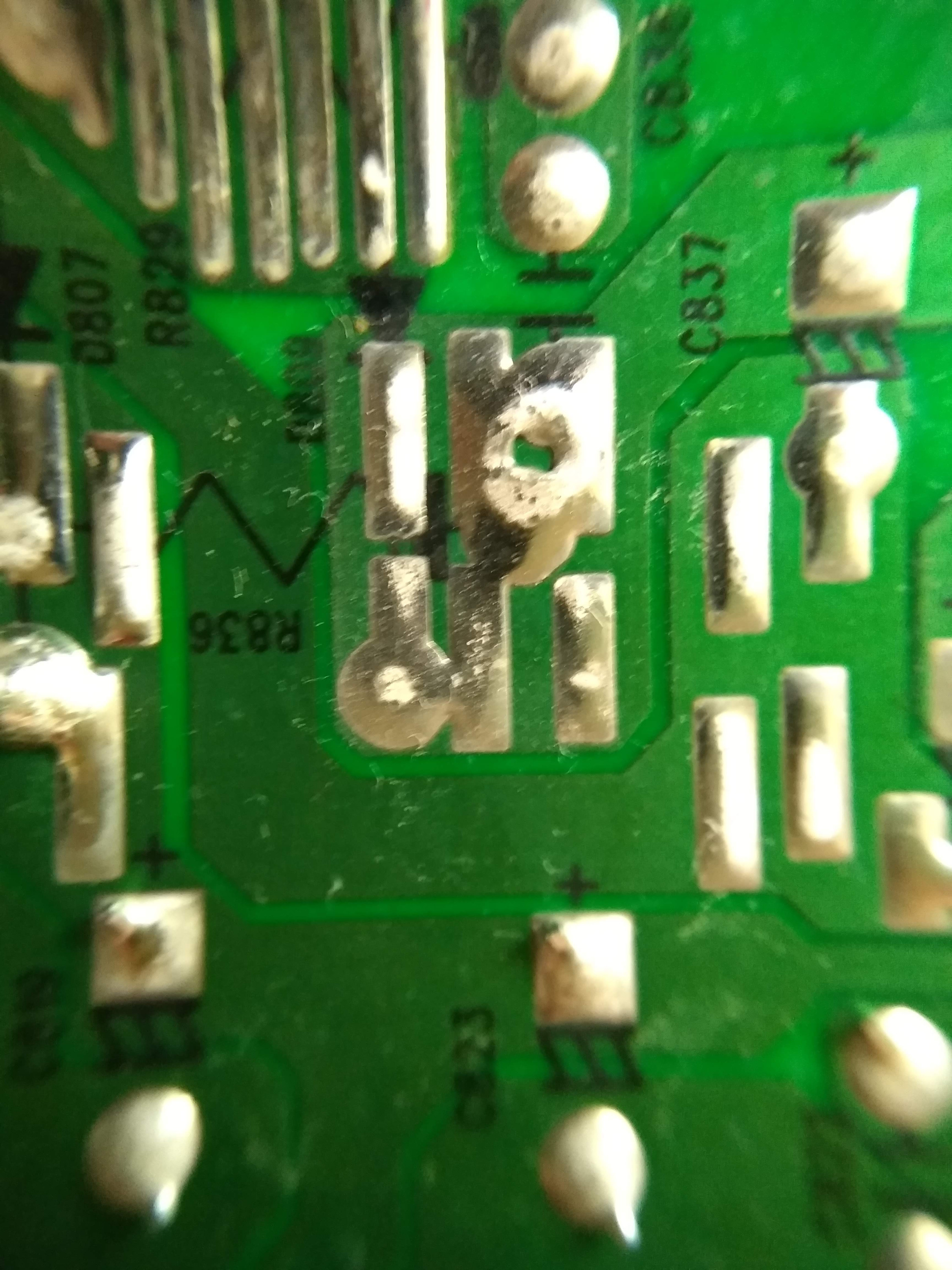

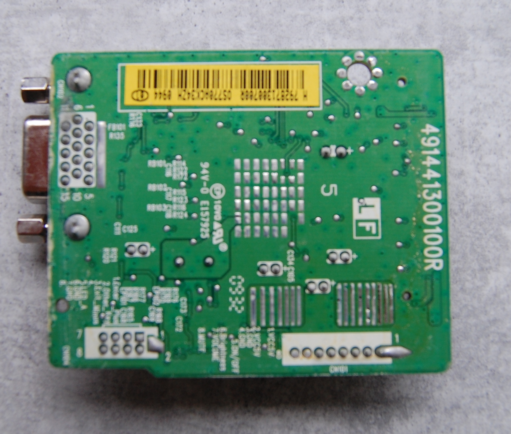

    I came here because Mr Google suggests the caps might be bad. I have taken the boards out and there are no obviously damaged components, though some of the solder joints look dry, or bubbly.
    I see from other threads that images are desirable. Happy to provide those, but I'd like some direction as to what photographs to take so I don't just spam the thread with images.

    We do need to see pictures of your boards. Make sure that they are high resolution and straight shot and upload them as an attachment. This won’t spam the thread, as the full pictures won’t automatically load.

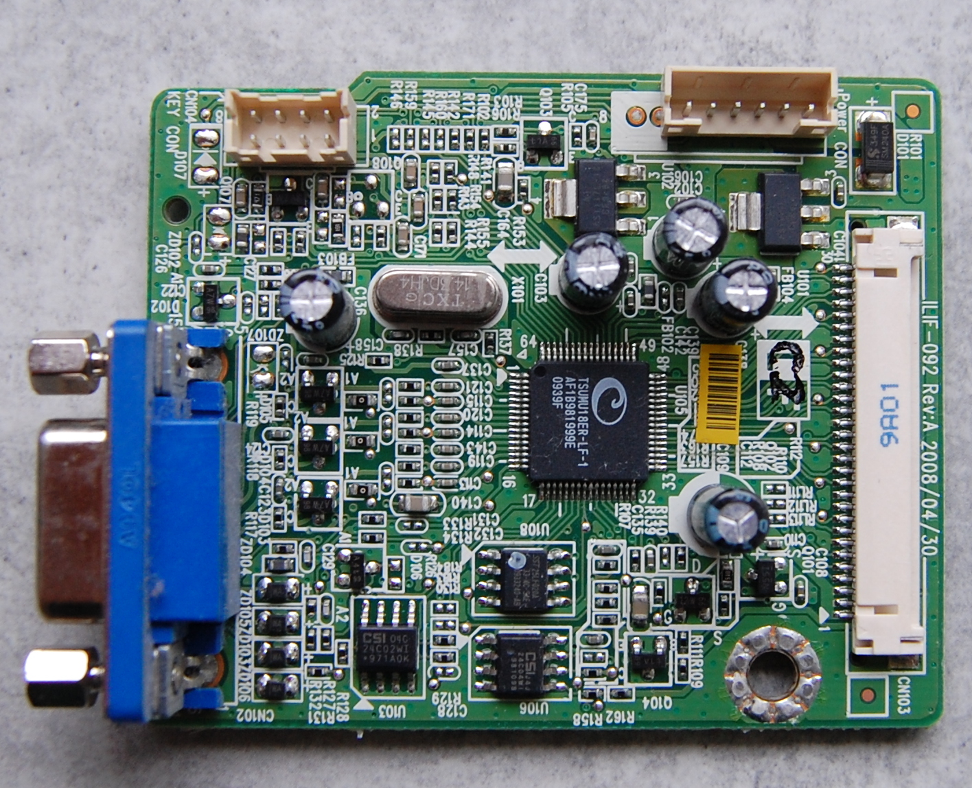

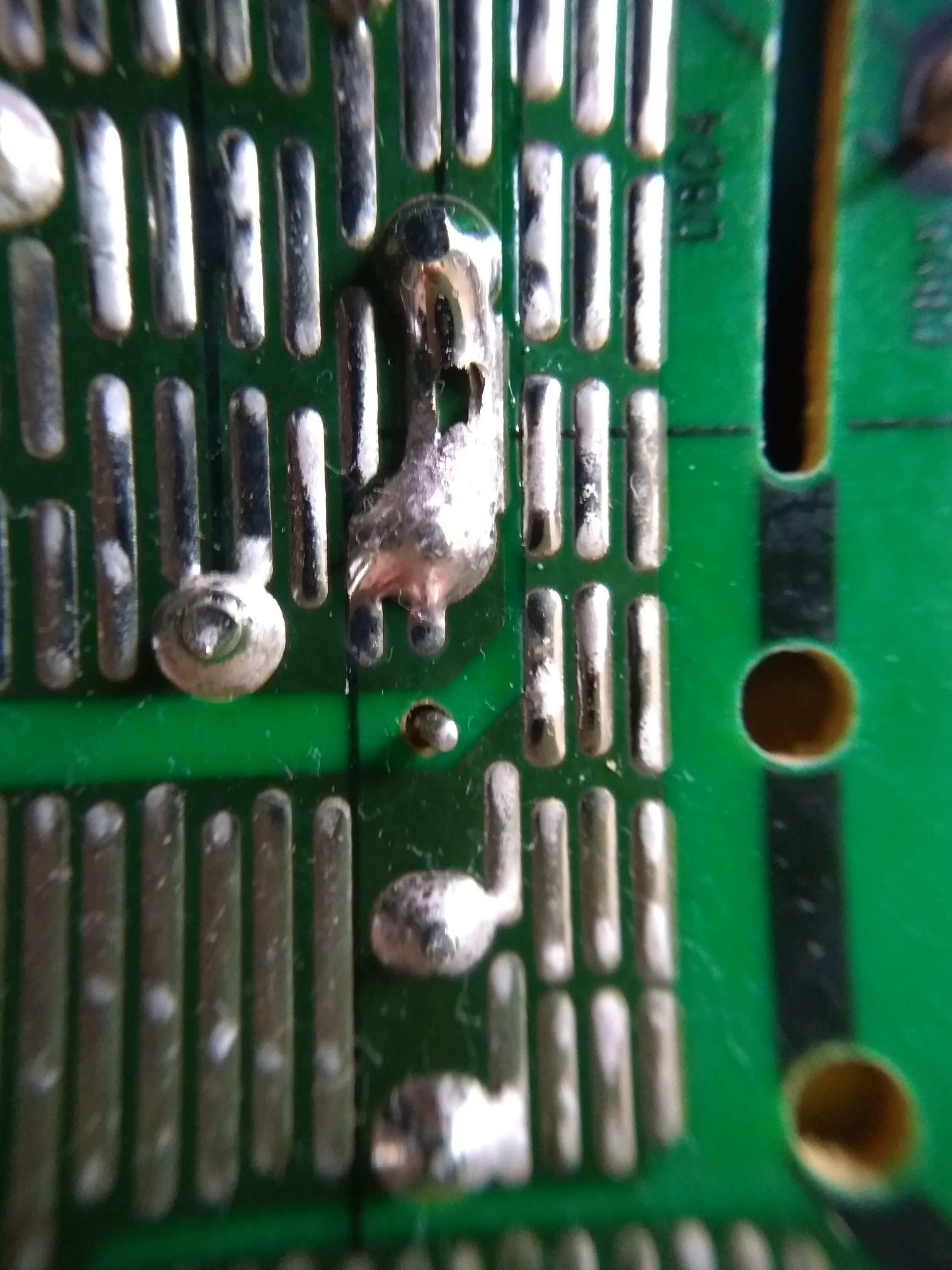

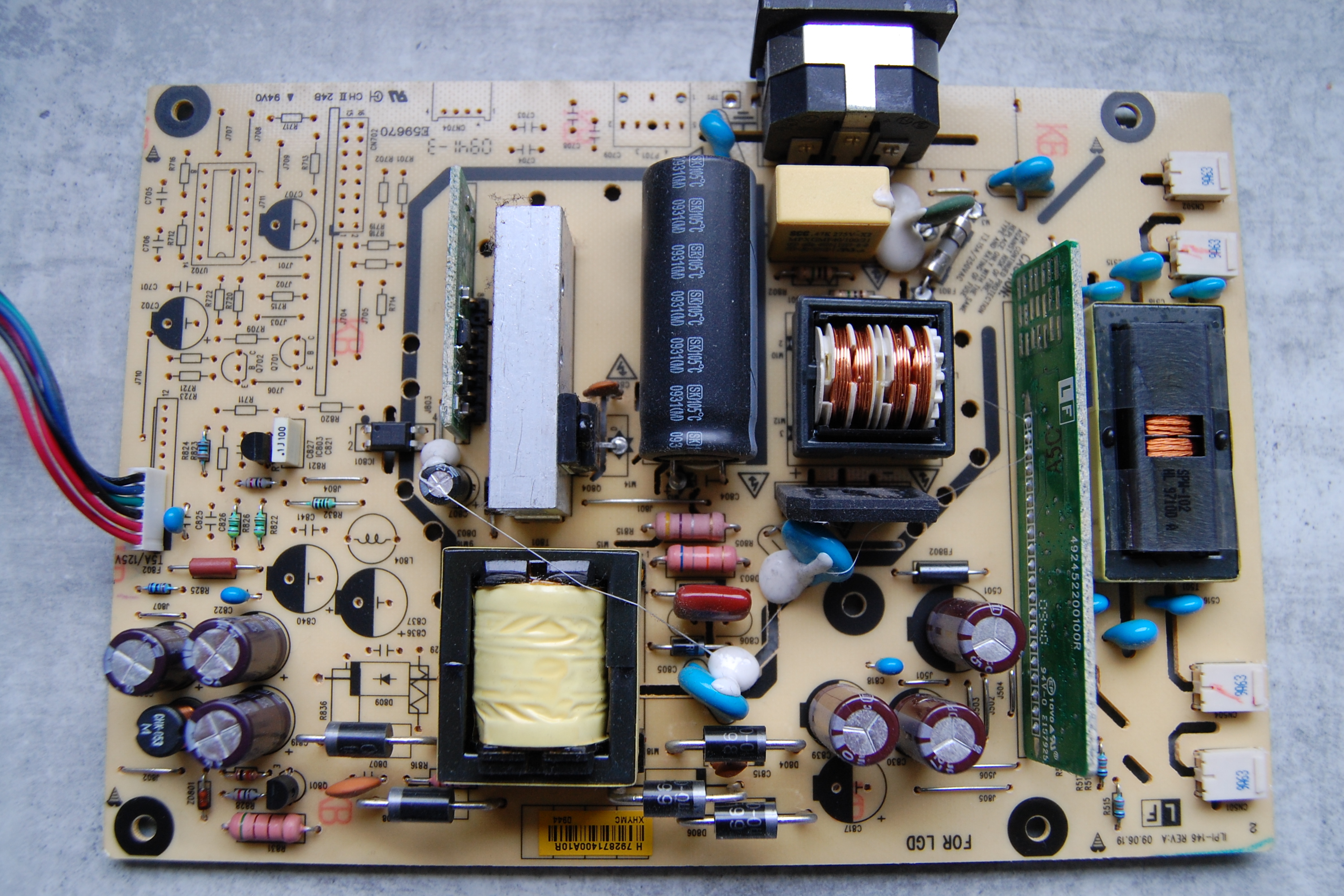

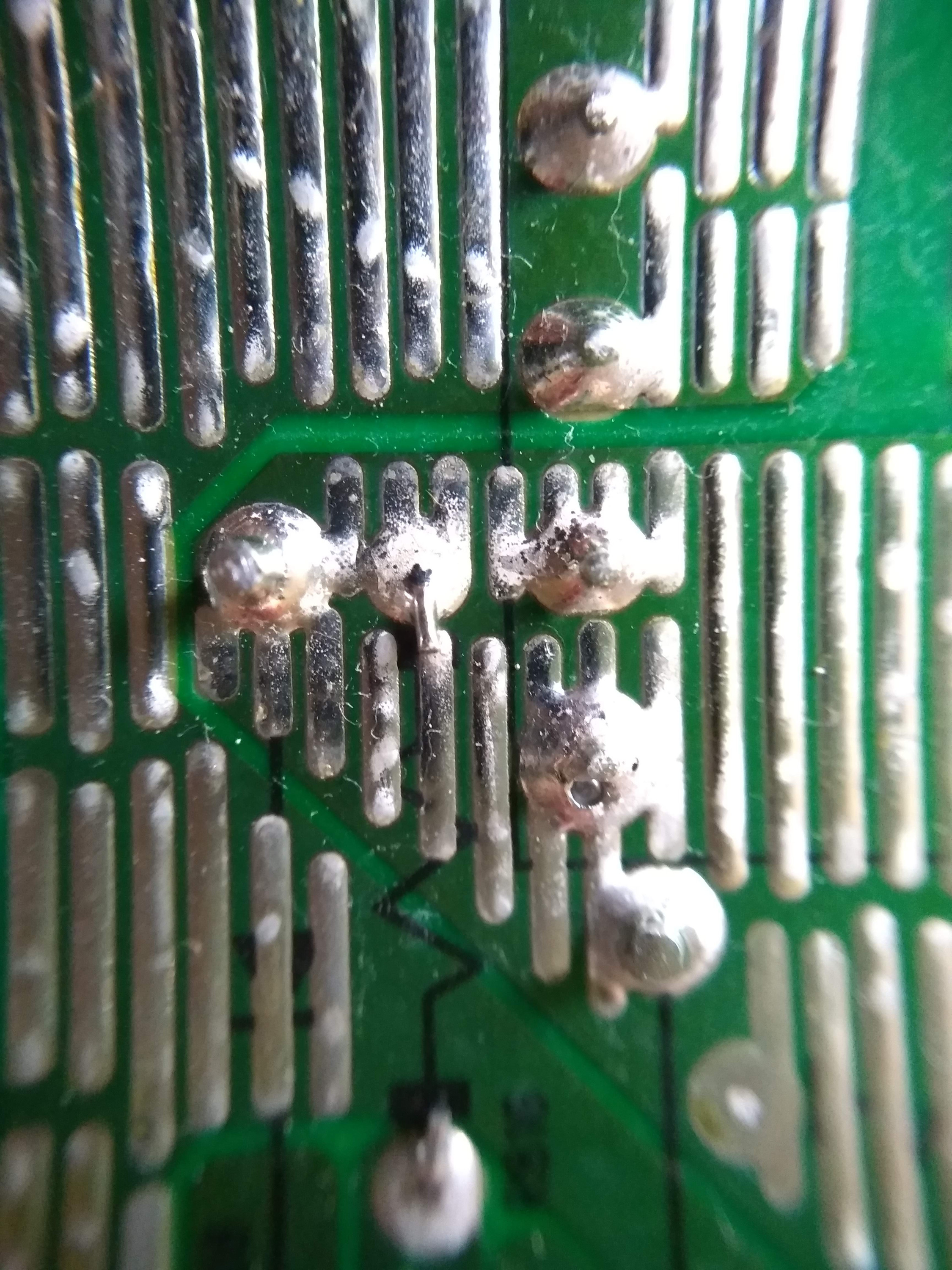

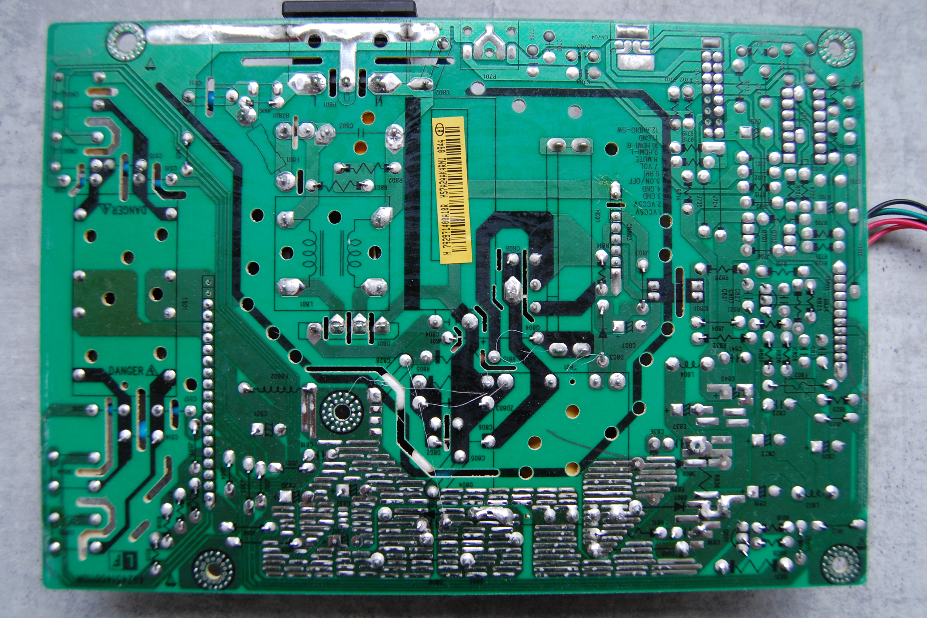

      Thanks for the welcome, this seems like a great and supportive place. I've attached some photos:
      • the overviews were taken on my wife's DSLR;
      • the close ups of various solder joints on the power board were taken on my phone with a cheap generic MACRO attachment.
      The signal board was hard to focus on with the big camera (photography tips welcome!). In any event I'm happy to take MACRO shots of any specific components.

        Since your problem is erratic at best, I'd go looking for bad solder joints first. Looking at your power supply picture #2 (bottom) I see dry / cracked / rings on some solder joints. Resolder everything that looks shady, has a heat sink on it and the transformers (weight).
        Sometimes heat (wifey's hair dryer ) comes in handy heating parts of the power supply (just don't over do it) also don't forget to give her the hair dryer back! Freezing (a can of air upside down) also can help you find a problem.
        If the monitor won't start because its cold, heat up the capacitors and see if it will turn on. If the monitor is hot and it shuts off, could be an IC cold solders etc.
        There isn't anything BGA, so no need to reflow any boards in the stove.

          Thanks @CapLeaker, I've reflowed the dodgy bits (no pic yet because the resolution it too big, even from a phone which is frustrating, and I haven't got time to resize) but am yet to reassemble the monitor (small baby providing a happy distraction) - fingers crossed

                Might ought to re-open it and see if the same solder joints have went cold again and/or if more solder joints have went cold. Also, can you please post photos of the capacitors in the monitor?
