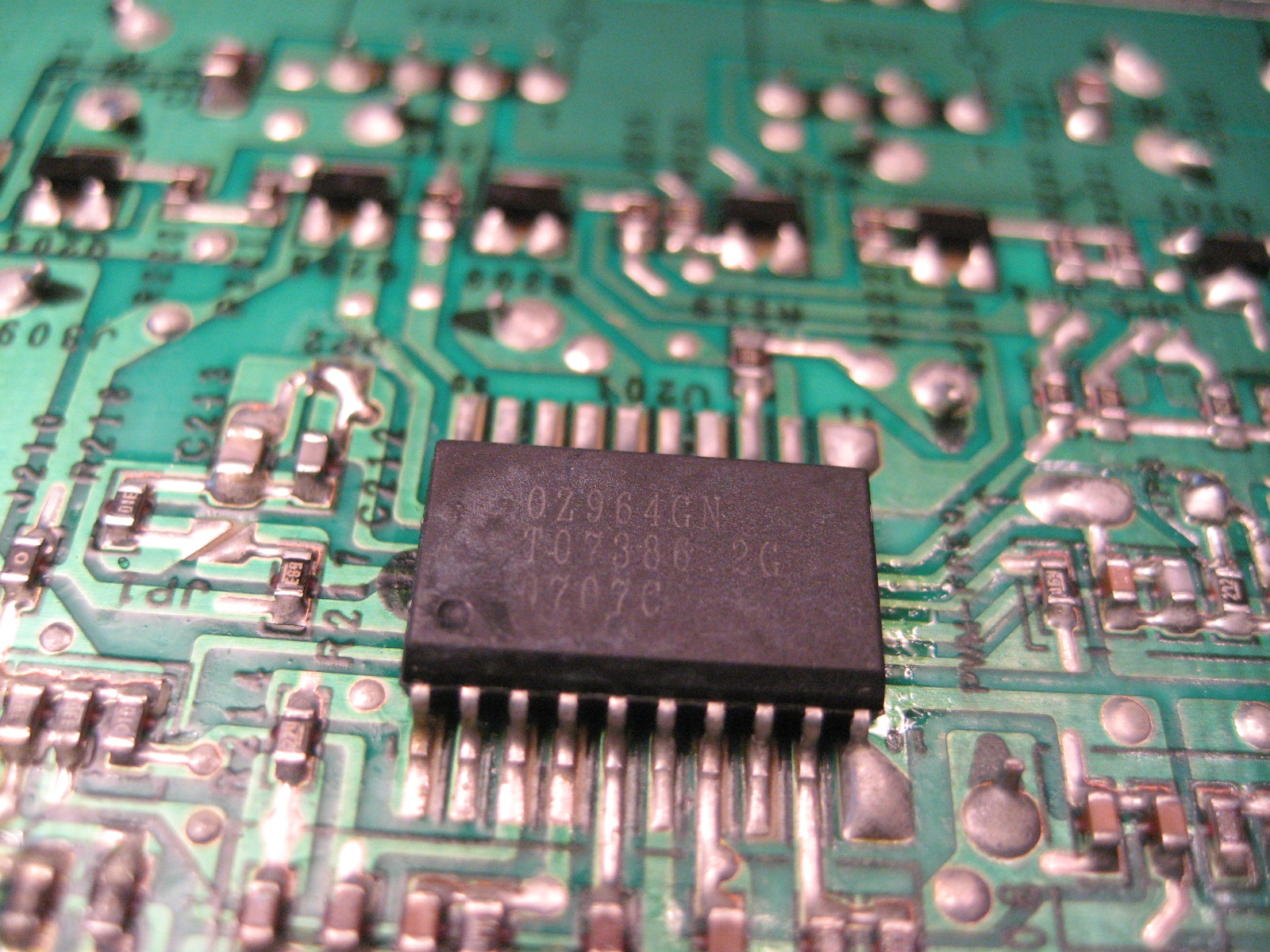

              What is the part number of the inverter controller IC? That will give some clues as to what is happening.
              PlainBill
              • SLBEngineer
                • 14
                #47
                Re: Samsung SyncMaster 226BW
                I read it 0Z964GN
                T07386 2G
                0707C
                I have attached a pic of the IC.

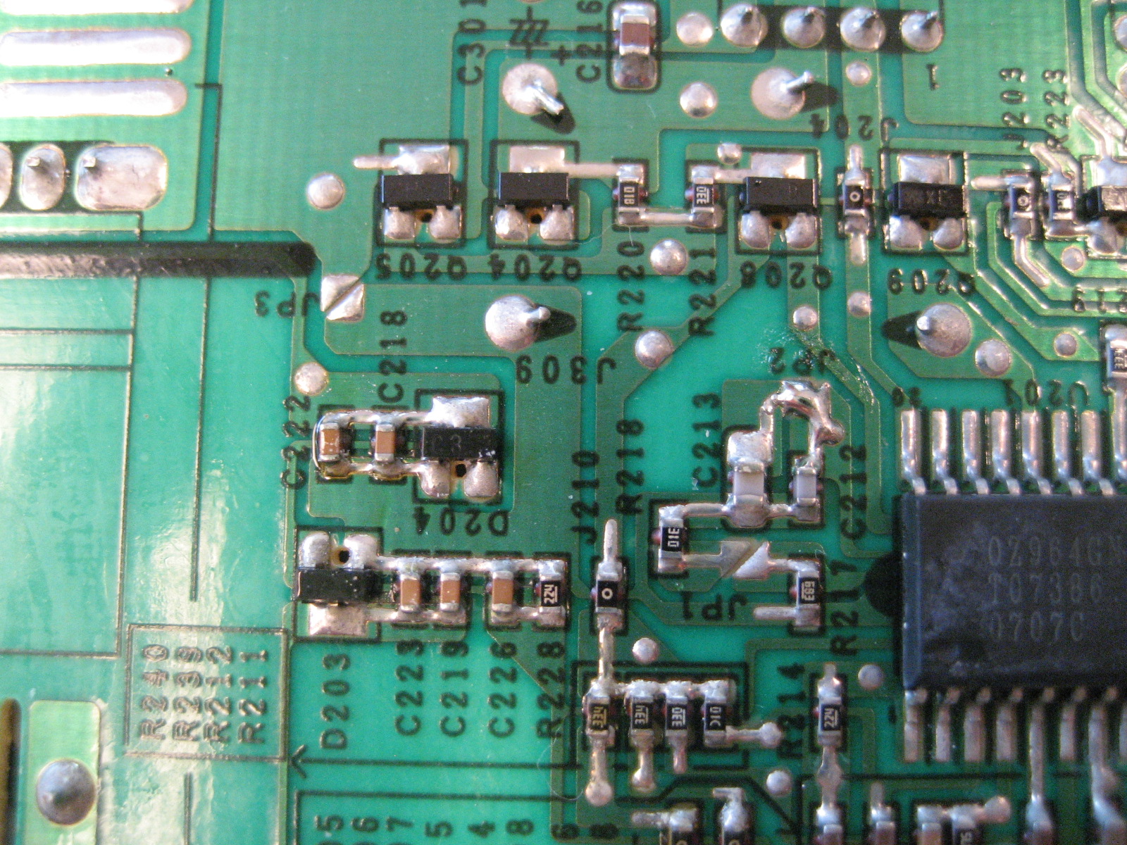

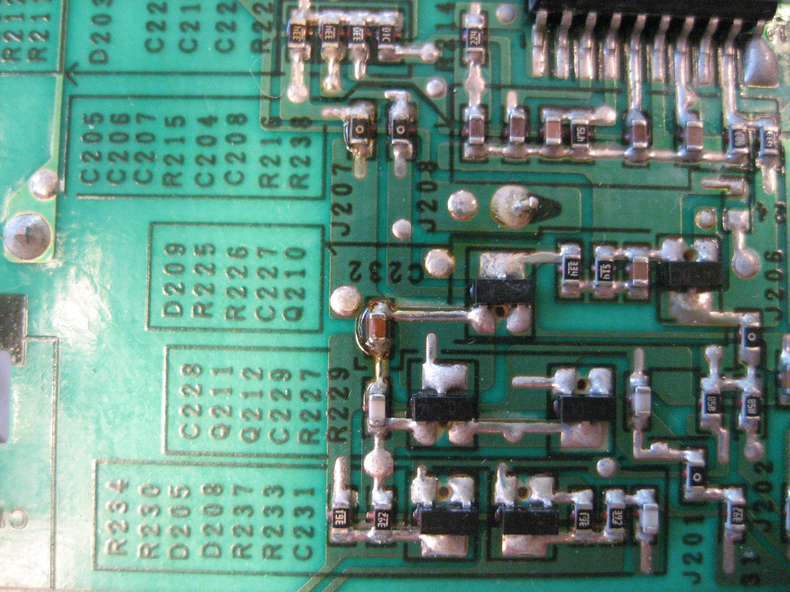

                              One correction. The IC is an OZ964GN (first character is 'oh', not 'zero'). Alldatasheet.com has a copy of the datasheet. Briefly, the IC provides two protection modes. Pin 2 is used to sense output voltage and will shut down the inverter if the output voltage goes too high. Pin 9 senses the CCFL current and will reduce the output if the current goes too high. Without actually tracing circuits I can't determine how the feedback signals are used. However, pin 2 appears to be the key. If that goes above 2.7 volts the inverter will shut down. Try to measure the voltage it reaches (repeat several times).
                              Also, if you would provide a somewhat more detailed picture of the components around the IC, I would appreciate it. Specifically, everything in the area between the two transformers, and extending down to the lower edge of the board.
                              PlainBill
                              • SLBEngineer
                                • 14
                                #55
                                PlainBill
                                PlainBill
                                I checked pin 2 with the VOM meter and the highest I saw it go was 900 mV dc. Not sure if I am seeing the entire picture with this meter! But it does spike and drop back off.
                                I have attached several pics. One shows the entire area around the IC. The other 4 show closeups.

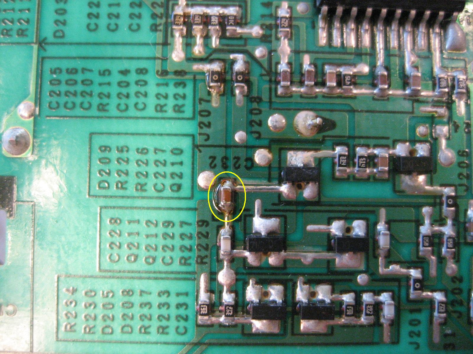

                                • SLBEngineer
                                  • 14
                                  #56
                                  PlainBill
                                  Does this component look like it has been hot? I have circled it in yellow on the pic.
                                  • PlainBill
                                    • Feb 2009
                                    • 7034
                                    #57
                                    Originally posted by SLBEngineer
                                    PlainBill
                                    Strange. There is something unusual about it, but that is part of the current sense circuit. It shouldn't be handling any significant current. But it looks like something has leaked from it.
