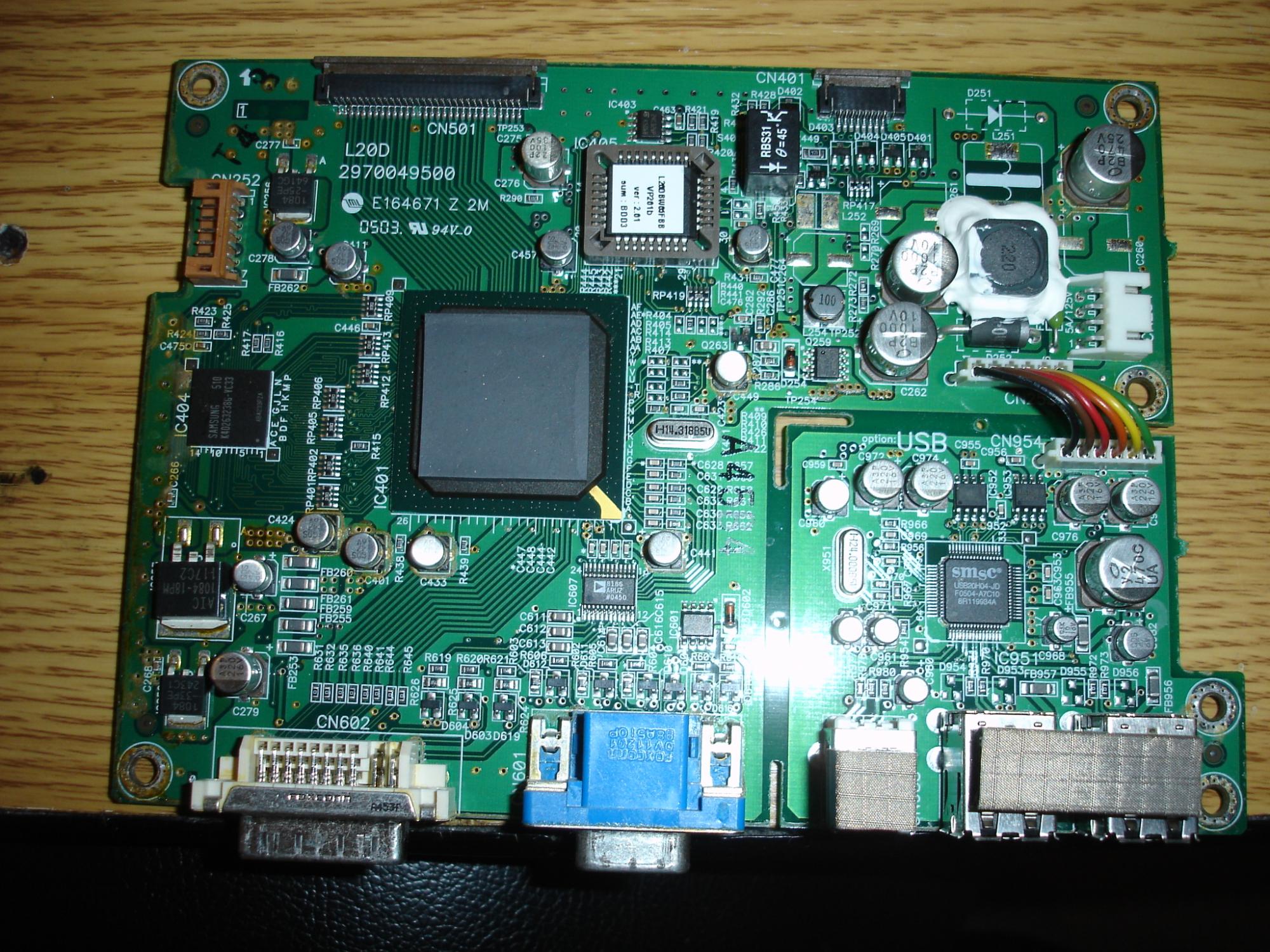

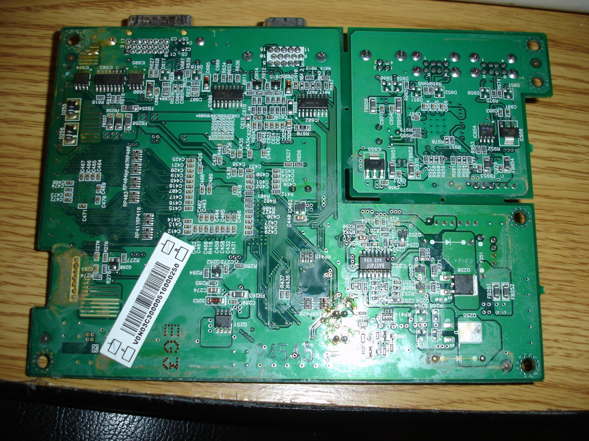

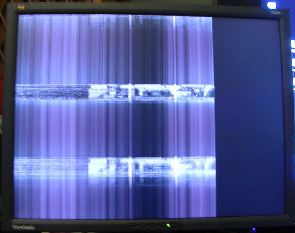

    I have a problem with a VP201b similar to that of Zocoloco's, posted elsewhere on this forum, but the behavior is a little different. For reference, I bought the monitor sometime around 2005 and it's worked perfectly up until 5-6 months ago:
    When I turn on the monitor it runs fine until it starts to warm up - generally from 4-6 minutes. Then one or the other half of the screen, divided exactly down the middle, will first start to flicker, then waver in kind of an "underwater" appearance, then deteriorate into vertical blocks and lines in the general colors of whatever's on the screen at the time, until the entire side is that way. After a little while that side will black out altogether. If I power the unit off and back on again, the affected side will invariably show up as vertical b/w stripes, as in the last photos.
    Eventually the remaining half will follow suit with the same symptoms.
    If I leave the monitor running for another ten minutes or so the halves will wink back to life and occasionally even go back to perfect, only to flicker and flake out again.
    I have a series of photos that illustrate the problem, the first three from a PC that just died, the remainder from a new one I bought to replace it. I'm hoping it's ok to put up a whole gob of photos - if not let me know.
    Thanks for any insight you can offer.

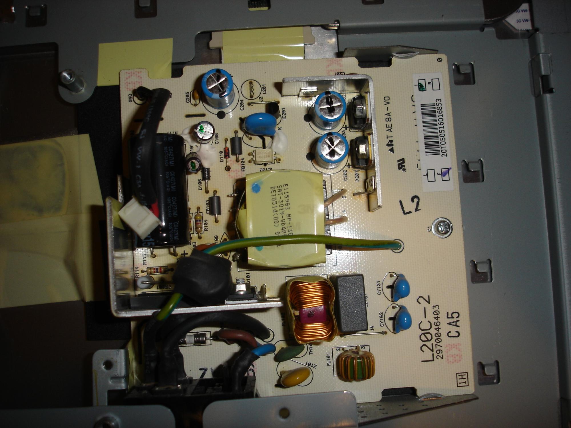

    Open the unit and post pics of the power supply.

      VP201b P/S pix
      Excuse the lengthy absence - I replaced it with a new monitor shortly after posting, and just haven't had time to open up the unit until now. So finally, some pix of the power supply, and one of the adjacent board, 'cause I'm wondering if that white stuff is epoxy that's supposed to be there, or crap that's leaked out of something:
      Please let me know if there are any other areas I should shoot.

        I have a VP201b with exactly the same problem, except that it only affects the left half of the screen. I have the same power supply, and there are no visually apparent problems with any components.
        The output voltage of the PSU under load is 17.70v. Individual bulb voltages measure (from the small return wires to ground):3.14, 2.96, 3.13, 3.00. The brown caps are all Taicons and the blue ones are Nichicons.
        I also have another broken VP201b that I could take some parts from, although i think that one has a short somewhere because it draws the PSU voltage down to ~2.0v, however it is 17.85v no load.
        Any ideas?

          Remove the Main board (green one) and wash off that brown, yucky stuff on the solder side. Also, gently remove the flat cable that is connected to the LCD and reset it. I would remove that yellow tape they used to tape down the cable. From what I've seen, the tape is putting too much stress in pulling the cable AWAY from the connector. I leave the flat cable floating (instead of securing to the back of the LCD panel).

            I did originally have that brown stuff on the back of the main board, and cleaning it off didn't seem to make any difference. However, after reseating the LCD end of the ribbon cable I only saw a brief glitch so far (it lasted less than a second) in a couple of hours of running the monitor. I haven't put the case back together yet, as I am planning to replace a few capacitors tonight, but I'll report back in a couple of days and let you know how everything went.
