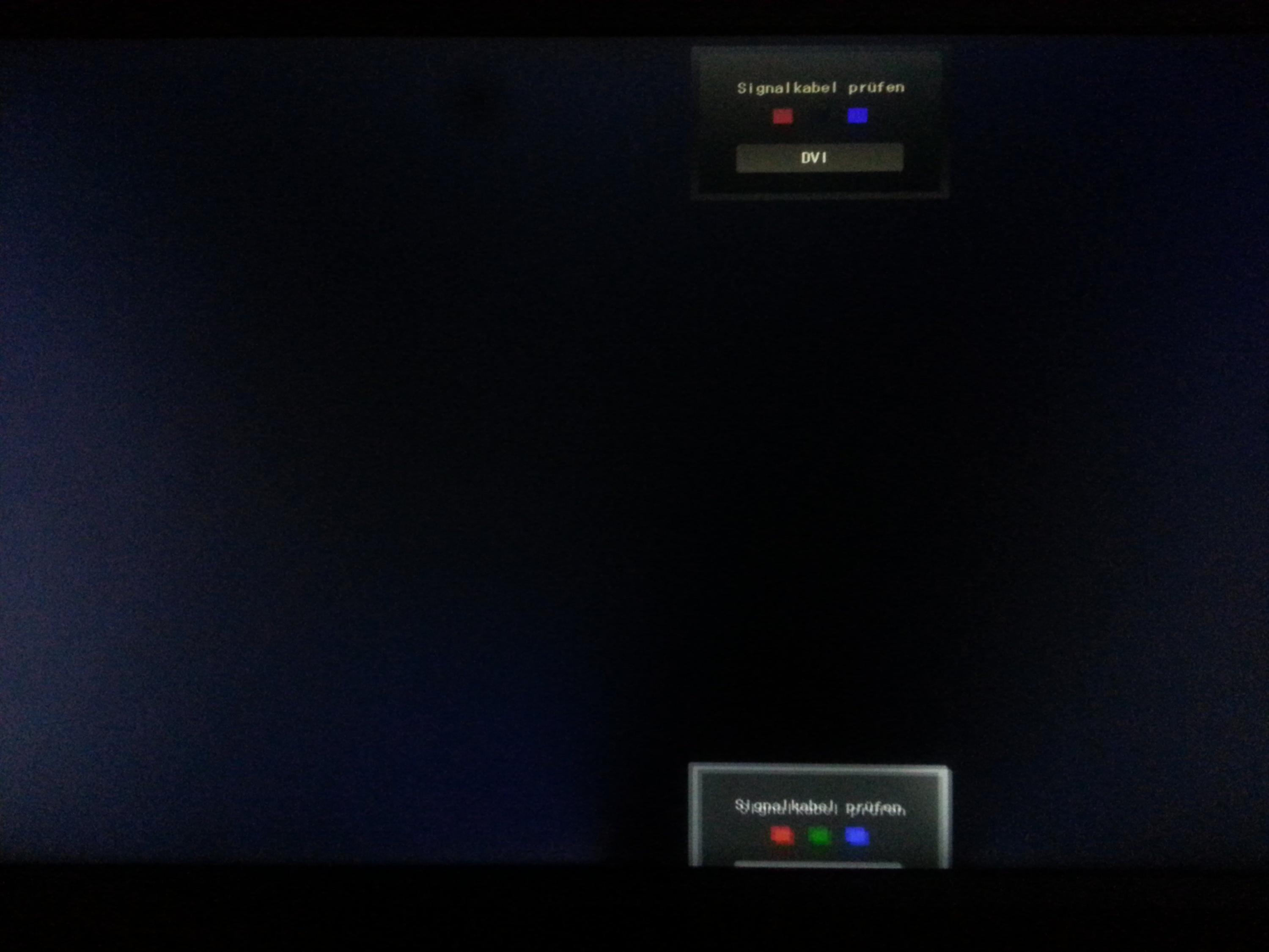

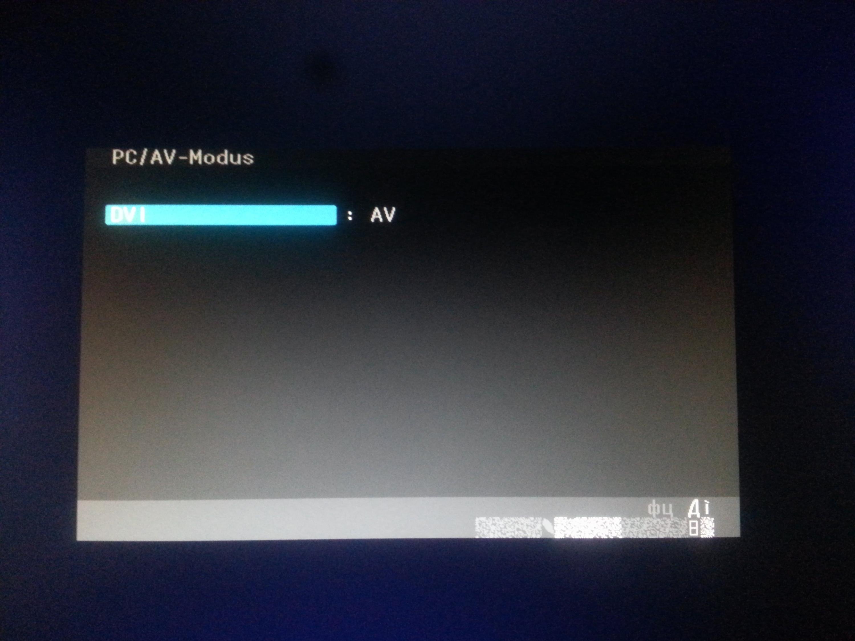

    Монитор Samsung S22C200N (шасси bn41-01916a) Dump.zip : the only dump found on the web. Turns on, but seems to be corrupt as well and not compatible with the panel. If I try to switch to VGA input, it goes black and freezes (no response to buttons). Same if I plug a DVI input.
    And 2 pictures, taken after flashing the dump found on the web:
    IMG_20191102_181612.jpg : illustrates corrupt firmware, only menu I can access, shows corrupt text on bottom right
    IMG_20191102_182130.jpg : illustrates possible panel incompatibility, working area for no signal box is 2/3rd of the panel and it gets repeated over.
