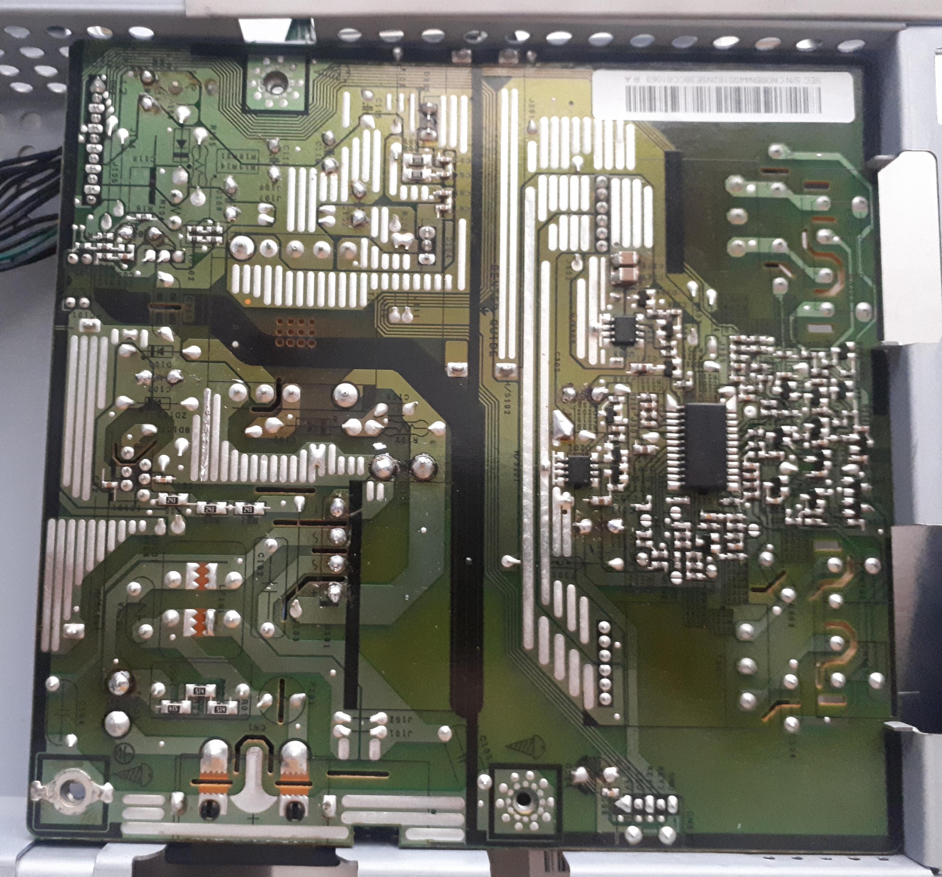

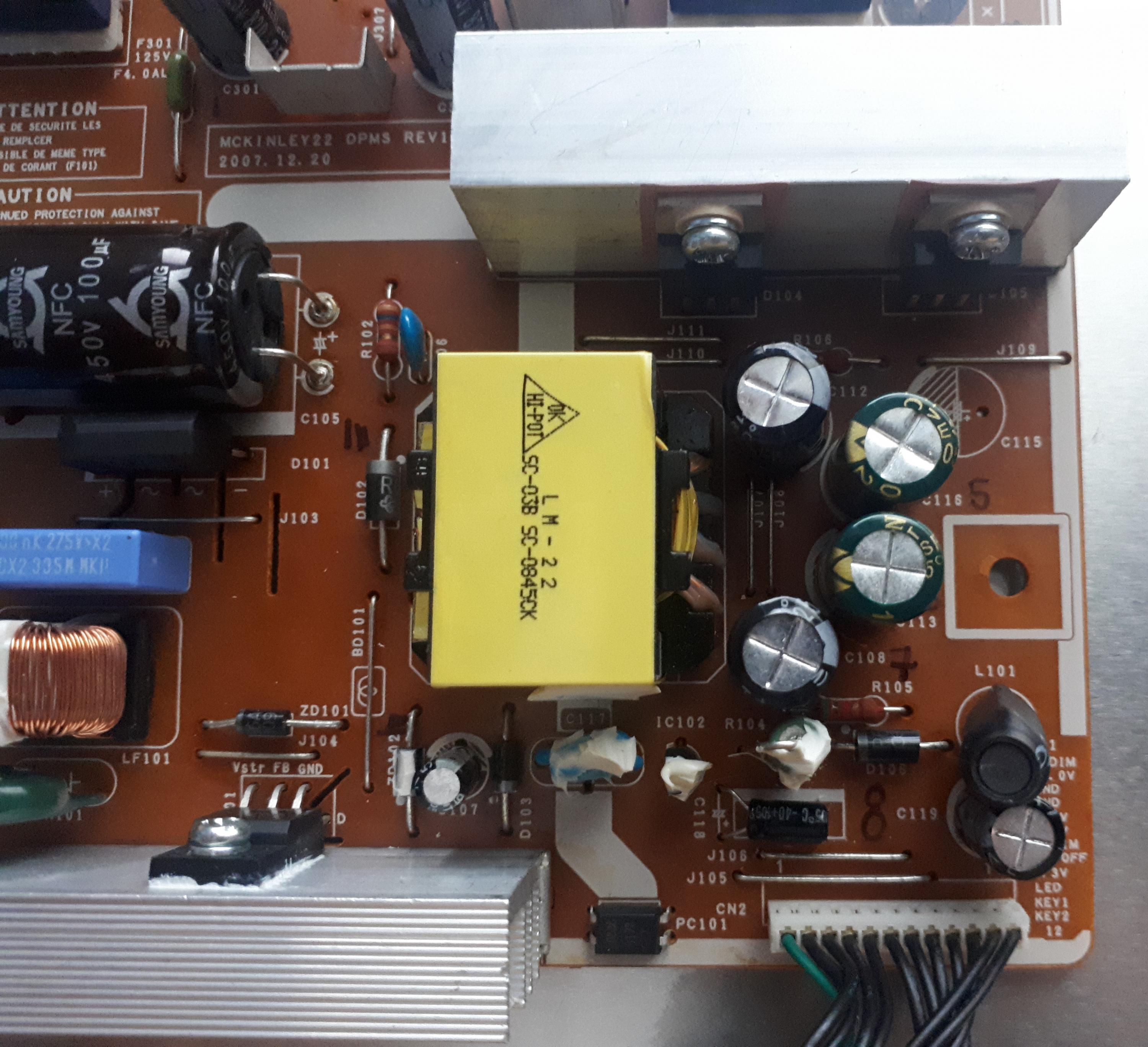

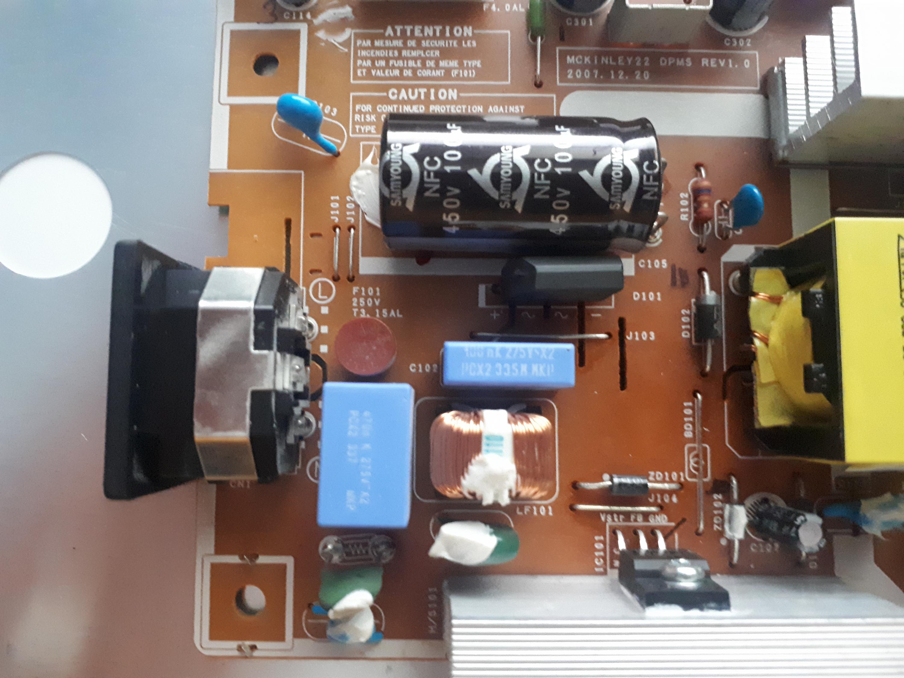

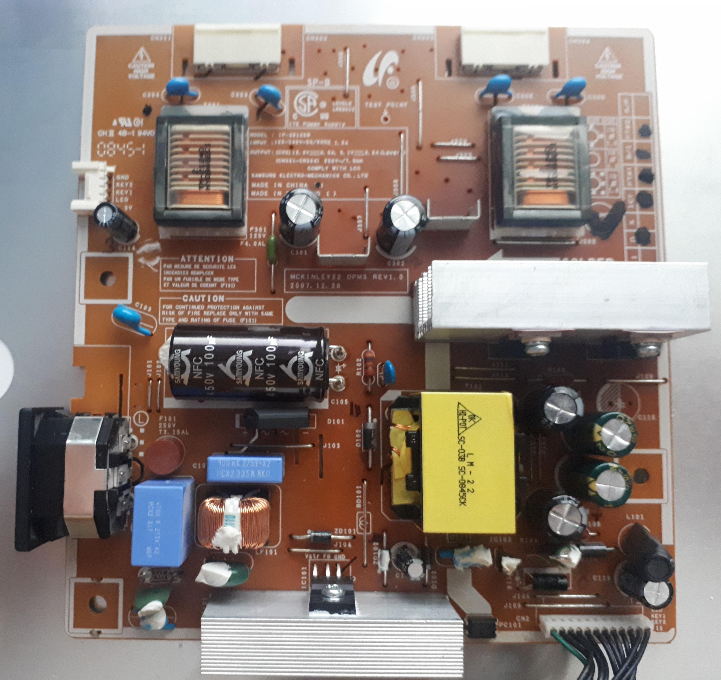

      Re: Need help with Samsung T220
      Here are the picture of the Power board
      Edit: I have changed caps, C301, 302, 112, 116, 113, 108, 119, 118, 107, 114. I have also changed bridge rectifier at D101 near the big capacitor.
      The 1000uf caps at C116, C113 were bulging before I changed them all.
                      So the monitor IS turning on when the power button is pressed correct?
                      It seems like the monitor has a backlight fault. Do you have 13v on both sides of F301?
                      Pin 10 should be for the front led and with 2v there, it should be lit. The fack that it changes tells me that the main board its working, but I think you have your readings wrong, the first row is likely OFF, and the second row is ON
                                        You can force the backlights on by disconnecting CN2 from the logic board and connect a 1k resistor between +5v (pin5or6) and BL_EN (pin 8)
                                        If you don't get the backlight, connect another 1k between +5v and pin 7 or try pin1
                                        This test will make sure the backlights are working and that the logic board is not sending the commands like it should.
                                        You measured .8 volts an pin 8 when the monitor was on and that is likely not enough voltage to turn on the backlights, it needs to be around 4volts
