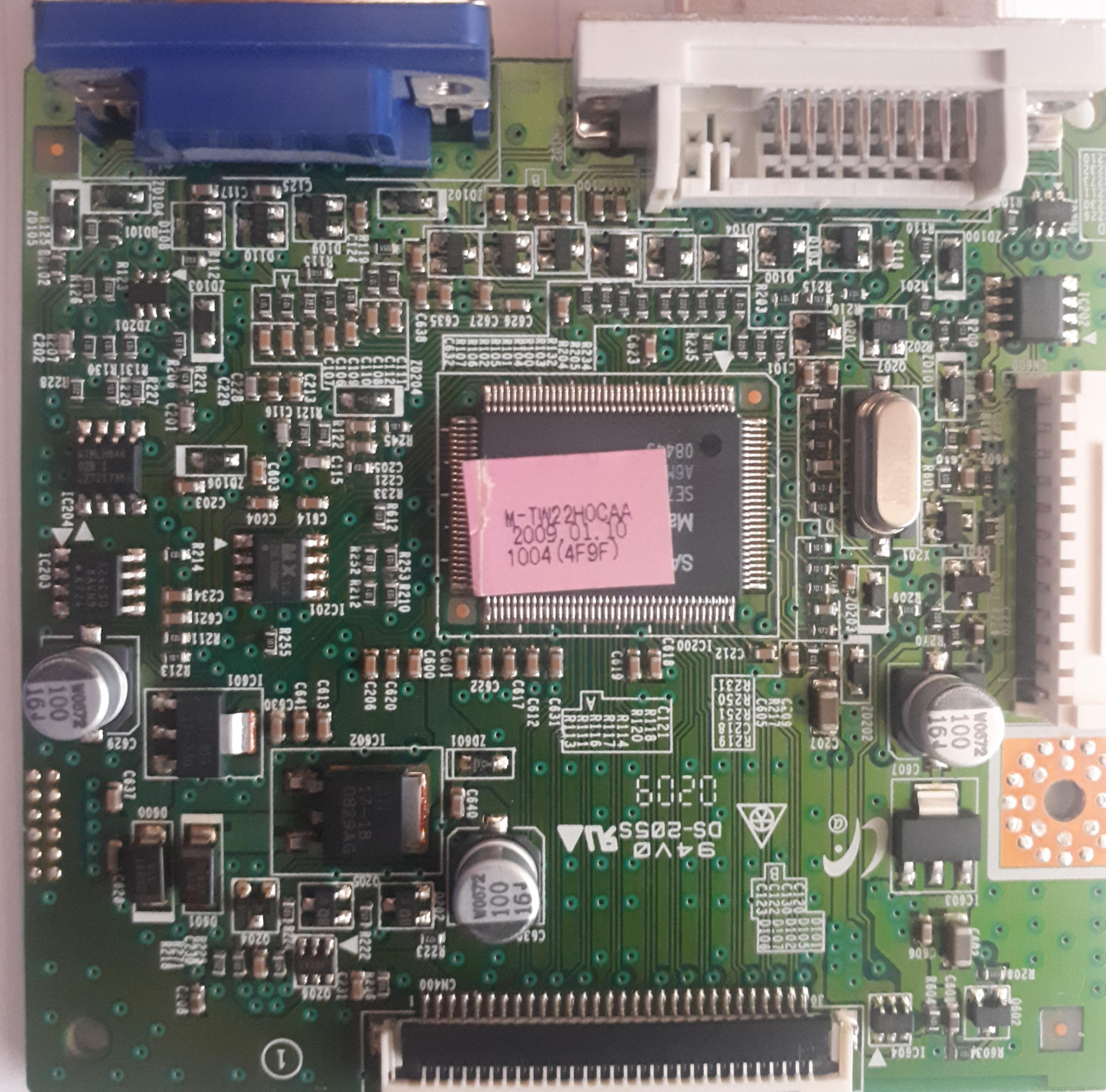

    Alright. Back after some more tests.
    Backlight works. Theres no doubt about that.
    The backlight worked with a 1k resistor between Pin 5 and Pin 8 but It was giving off a weird sound but the whole panel does light up.
    Before I did that, I checked for continuity between Pin 8 on the power board side and the other end (so I can insert the resistor on the other end instead of jamming it on the power board connector, you know safety and all. I was checking for continuity because I thought the wires changed places from connector to connector.) and i noticed that when I shorted Pin 8 (On/Off) to Pin 2 (13.0V) through the continuity setting on my multimeter the backlight turned on nicely. I also got a reading of 12.9V between Pin 8 and Pin 2. Im assuming that is to be expected?
    I did not test a 1k resistor between Pin 7 and Pin 1 as I have determined that the B/L works, however would it help to see what happens?
    • R_J
      • Jun 2012
      • 9593
      Re: Need help with Samsung T220
      Now we know the backlights work. but its not seeing the BL on command FROM the logic board, although it did change slightly.
      The extra resistor was to turn on the dimming if needed, it was to go between +5v and either pin 1 (BL_ADJ_PWM) OR pin7 (BL_ADJ_ANALOG). NOT between 1 & 7.
      Now you can start using the service mannual as it has the logic board schematic.
      First check the regulator voltages, IC603 (+3.3v), IC601 (+3.3v) and IC602 (+1.8V)
      Check the transistor Q601. This transistor is what enables the backlight.
      You can check the voltage on the base and see if it changes when the monitor is turned on and off. It should be around 1~3 volts and 0
      Also check the voltage on CN400 pins 1,2 or3 (LVDS cable to panel) It should have +5_PANEL +5 volts. If you do not have +5_PANEL, check the voltage on Q202, Q205 and finally Q206.
      Post a picture of the logic board.

        • caboose1835
          • Sep 2019
          • 27
          logic board photos

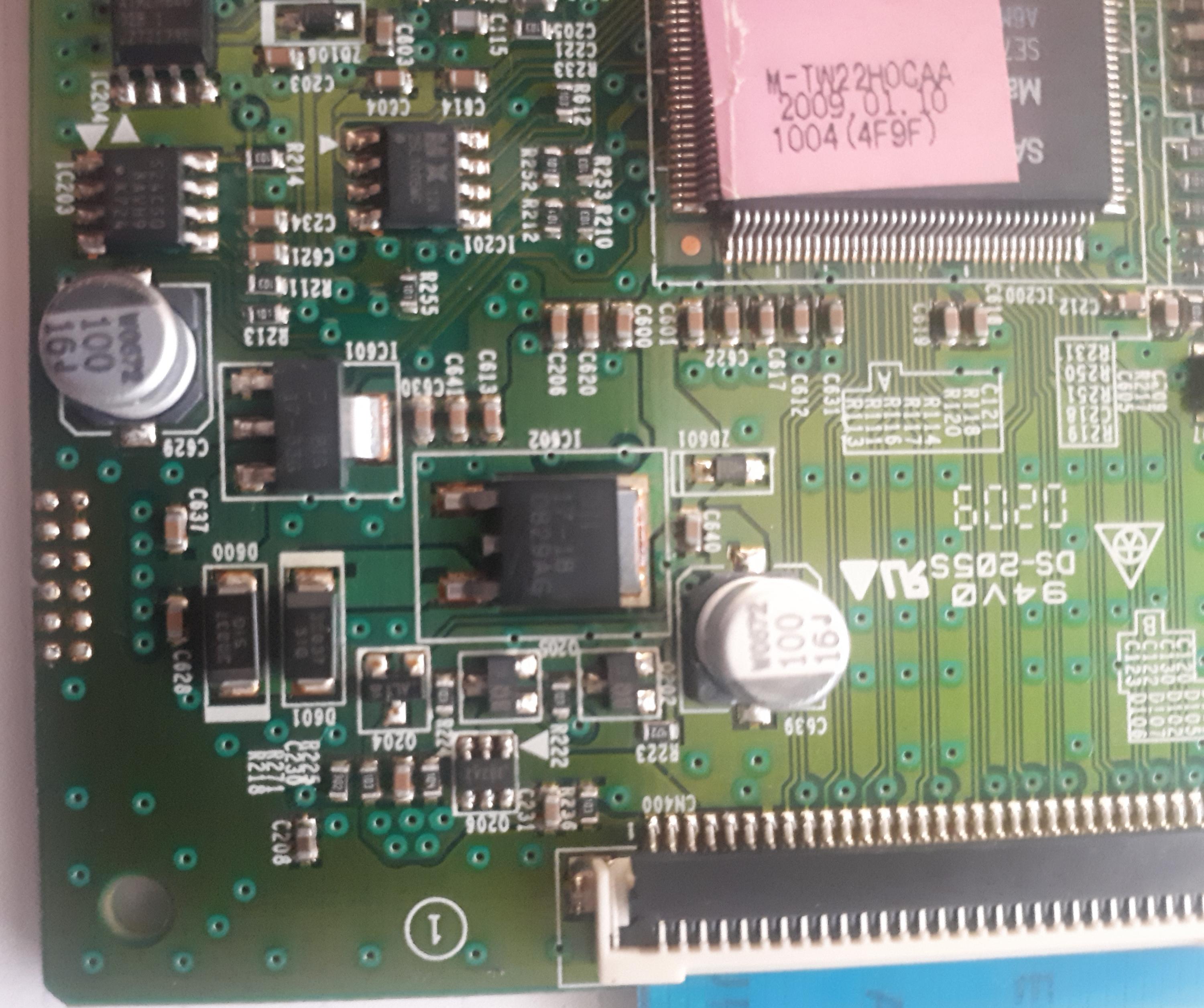

              Are you mesuring the voltage on Q601 across the transistor? Just measure the voltage to ground. Q601 could be bad. It's collector should switch between 0 and 5 volts.
              Look at the schematic for Q601, If the transistor base is 0 volts the transistor is in open state and the voltage on the collector will be close to +5 volts (turning on the BL_EN) If the base is above .6 volts the transistor is turned ON and the voltage at the collector will be close to 0v (turning OFF BL_EN)
              CN400 pin1~3 5v is good, the panel/tcon is getting voltage, does this voltage also change when the monitor is turned off with the power switch?

                  • R_J
                    • Jun 2012
                    • 9593
                    #29
                    Transistors are labled emitter, base, collector, not 1,2,3. I have no idea which is the emitter, base etc.
                    I think Q601 is shorted emitter to collector, or R600 is open
                    How do you know when the monitor is ON or is OFF? Your readings suggest otherwise for example Q206, pin 4 you have 0 volts ON state and 5 volts OFF state.
                    Did you ever check the front led? Fix it so you know when the monitor is on or off, The LED comes on when the monitor is ON, NOT when it is in standby.
                      Sorry about that, slipped my mind.
                      Corrected now except for Q206. I tried looking for a datasheet, and couldn't find one. Is that 2 transistors in a DIP6 package?
                      R600
                      6.48k ohm
                      Q601
                      E/C 6.50k ohm
                      As for how I know the monitor is on or off, I listen to the transformer while hitting the power button. When it goes the sound changes. I also totally forgot about standby states when a monitor is on but would normally "timeout".........Damnit. Gotta fix this LED.
                      Is there anywhere I can add a bog standard LED while doing this testing? Or do I had to swap out the thing
