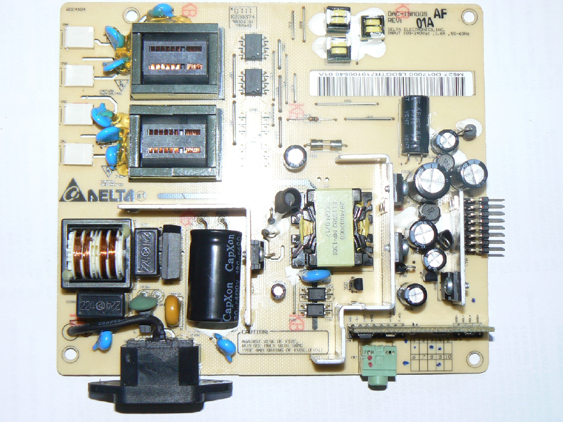

                              Greetings
                              I have the same flavor of board with the same component configuration as far as I can tell.
                              I was able to test the fuse for continuity and there is no resistance so its not blown. (This is the one circled in blue)
                              I measured the VDC across the capacitor right near the power plug and got 172. I tested the other capacitor as long as I was in the guts of the beast at it read 17.
                              The fuse the other poster mentioned on mine appears to be fine. I was able to test the continuity across it on the back of the board and had 0 resistance.

                                First problem: Read this.
                                Next, you have at least 5 bad caps.

                                  Greetings again.
                                  I figured that the canisters sitting upright should not have the tops be bowed out like that. The last time I was in the guts of a piece of equipment was in the 80's. (I really really like this monitor though). Hopefully it does not turn out its only botulism
                                  I was hoping it was only a fuse but that was not to be, that I can replace in most circumstances, but when it comes to heavy duty soldering I know just enough to be dangerous.
                                  Apologies for using offsite hosting but the images were too big for the badcaps.net hosting.
                                  I will shrink them a bit and repost them in this reply so that they are hosted onsite. I expect they no longer need to be as DPI intensive as your likely to have already cracked it as it were.

                                    Re: Chimei DAC-19M009 Power Supply problems
                                    Another Chimei DAC-19M009 here...
                                    not mine, a friends; he said display went black.
                                    Told him to try switching dvi vs vga; no change.
                                    Told him to use flashlight; can see ghost image.
                                    Told him to adjust bright/contrast;
                                    ... with control turned down display sometimes lights on powerup up.
                                    He opened unit up, pulled PS board, brought it over.
                                    (It is the same board and rev as in preceding post)
                                    Inspection reveals board discoloration around P605 inverter ICs,
                                    and 3 * CapXon 220uF 25V 105C 'KF' caps with bowed tops.
                                    (one by glass fuse, one between horiz cap and vert resistor,
                                    one between large green cap and regulator in above pic)
                                    Diode checked the P605's - they seem OK.
