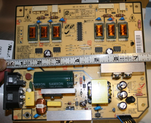

    Samsung SyncMaster 215TW crappy caps

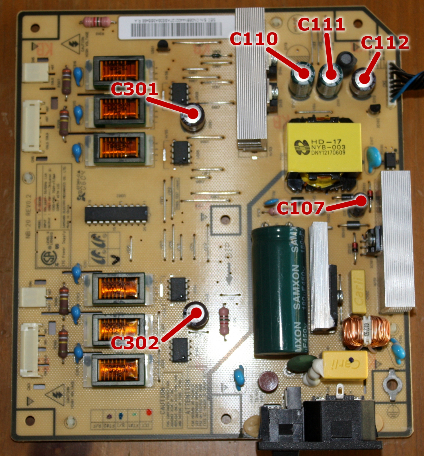

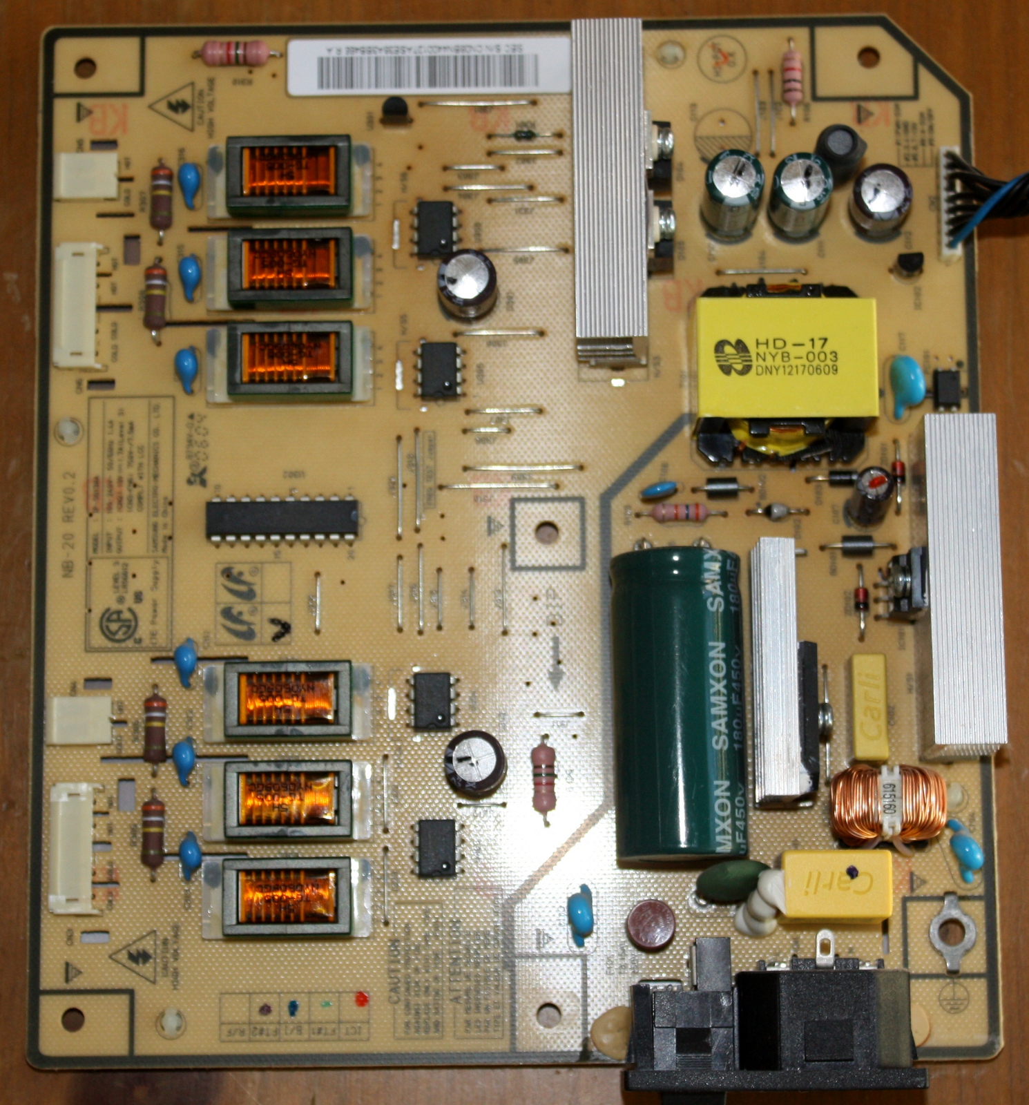

    I just thought I would share my experience with the SyncMaster 215TW LCD.
    Last week i heard a buzzing noise coming from the back, then early mornings when i turned on the LCD, it would power on for 1-2 seconds and power off by itself... i had to repeat this process 5-10 times before it would keep itself powered ON.
    I figured it may be a cap issue and did some research.. and surely enough i was right.
    Here is a picture of the power supply board for this monitor..
    http://img256.*************/img256/6537/img2095t.jpg

    Welcome.
    Replace all the brown caps, even the non bulged ones. Post info on them (capacitance, voltage rating and brand/series) and replacements would be suggested in no time.
      CapXcon 820uF 25v and 330uF 25V.
      I just packed it and send it off for RMA since i still had a few months warranty.. heh i already pulled out the caps though..
      But i got another one of these 215TW LCDs here and its making the same buzz noise, so its only a matter of time before it dies.

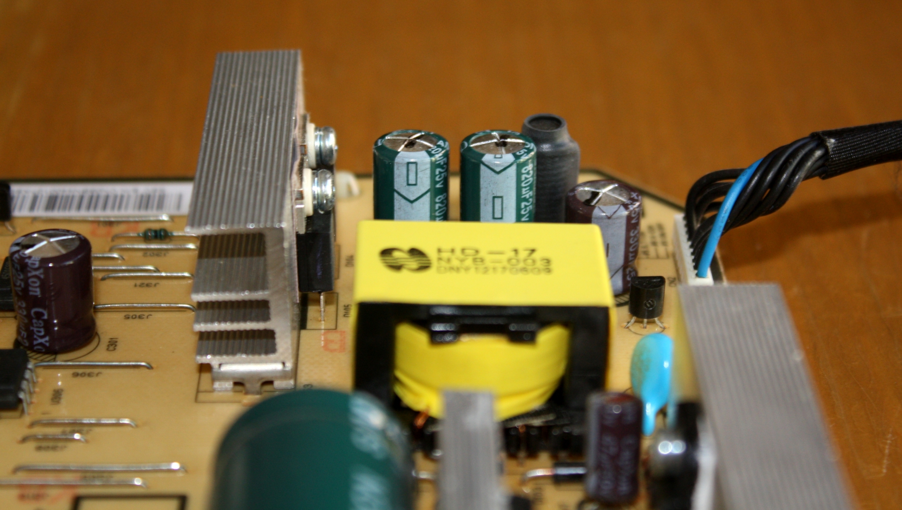

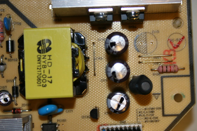

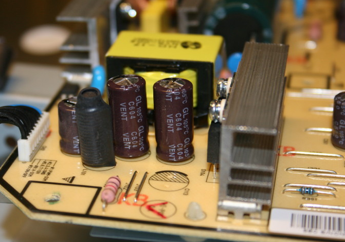

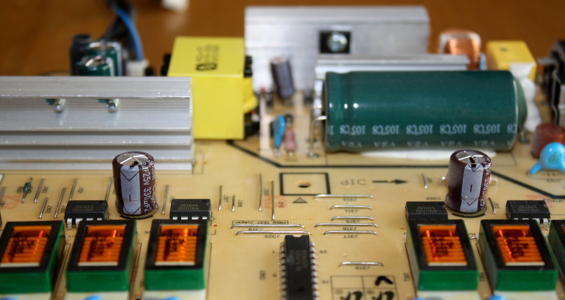

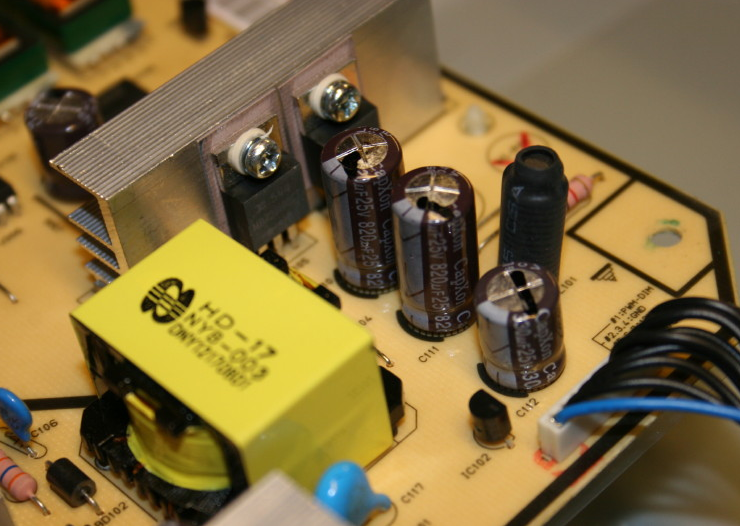

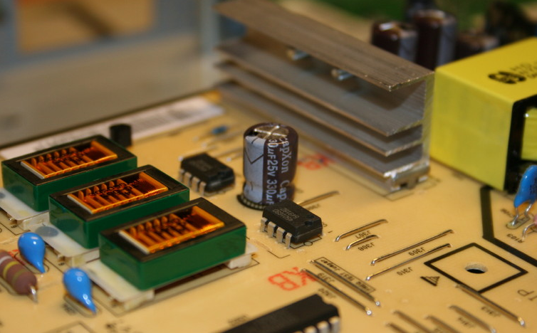

        I recently got a broken Samsung 215TW off craigslist. This monitor is 21" widescreen with CCFL backlights. Before I get to the repair, I wanted to note some observations on this monitor. Most monitors have maybe two video inputs, this monitor has 5 (DVI, VGA, component, composite, and s-video). It also has built in speakers (which I'm sure sound flat), and a very elaborate stand. The stand goes up and down, screen tilt, plus the screen can be rotated to portrait, and as if that's not enough, the entire base swivels almost 360 degree around. I've heard that this monitor cost over $500 new, and seeing all it's got I can believe it.
        Anyway, back to the repair. The person who gave me this monitor said the image would flicker. I never even turned it on, the first thing I did was open it up. As I suspected the problem was bad caps. I found 5 bulging caps inside. I ended up replacing a total of six caps. After the recap the monitor runs beautifully.
        Here are the details about the caps I ended up replacing. All the bad caps were CapXon brand. The big fat cap on the board was Samxon brand and I did not replace it.
        Location / Rating / Measured Capacitance / Measured ESR
        C107 / 47uF50V / 48uF / .6ohms
        C110 / 820uF25V / 258uF / 1.4ohms
        C111 / 820uF25V / 182uF / 2.0ohms
        C112 / 330uF25V / 21uF / 10ohms
        C301 / 330uF25V / 25uF / 14ohms
        C302 / 330uF25V / 26uF / 11ohms
        From these numbers the cap at C107 was probably alright, but I replaced it nonetheless. All the other caps were very low on capacitance and high on ESR, not to mention the bulge on top.
        Total this cost me $2.40 in replacement parts from digikey.
        Again thanks to everyone on this board, everything I've learned from others helped me in this repair. And hopefully my post will help someone else.

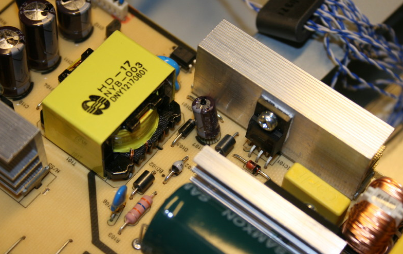

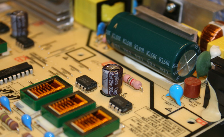

          First of all, thanks to Freezer for posting those pictures with notes on the capacitors. Until I saw that post, I thought C301 and C302 were rated at 30 microfarads, not 330 microfarads. Also, I referred to those component notes in this post.
          My parents have a Samsung Syncmaster 215TW with the same issue Freezer described, and is also described in this thread begun by Jinatra; the monitor flickers (and has been getting worse over time) when it first starts displaying a signal but if you give it time to "warm up" it displays a stable image. This also occurs if the monitor has been on, but is allowed to enter sleep mode for about 30 minutes, currently. I was originally going to try the board replacement which is described in this blog post by wcoastsands. Unfortunately, the replacement power supply board for this monitor is proving difficult to find.
          So, I opened up my parents' monitor and C110 and C111 are both visibly bulging at the top. I have attached pictures because I cannot tell if any of the others are bulging "fatter" than they should be; I'm not really that familiar with electronic components. I have put together my own PC, replaced components in the PCs of others and made Ethernet cables, but I have never soldered and I don't even own a multimeter (though I have heard of them before). That said, I have some questions before I start ordering parts.
          First question: Are any of the other capacitors visibly damaged? I can't tell if any of them appear to be fatter than they should be. I understand I should probably take this opportunity to replace all of the CapXon capacitors (I don't plan on replacing the very large green SamXon capacitor), but if for some reason I cannot replace all of them, then I plan to replace the damaged ones only (currently C110 and C111). I am also concerned about the way C107 is bent. Is it harmless for a capacitor to be leaning like that?
          Second question: I haven't found anyone saying which capacitors they have used to replace the capacitors on this board, so far. How close do the various specs of the replacements need to be to those of the original capacitors? In one of the comments on the blog post linked above, someone mentioned they replaced they replaced the two capacitors rated at 820 microfarads with capacitors rated at 1000 microfarads. What I've read so far about capacitors seems to point towards that being a bad idea and that you should use the same capacitance rating. As I understand it, a higher voltage rating is fine because that just means it will be able to tolerate higher voltages. But what about the ESR/impedence rating and the ripple current rating? I found these capacitors by Nichicon on Digikey but those two ratings are slightly different. For comparison, I believe the following is the specifications sheet for the correct series of capacitors used on the 215TW board:
          And here is the link to sheet for the PW series by Nichicon, which I've noticed was listed on the BadCaps good capacitors list in the FAQ: https://cdn.badcaps-static.com/pdfs/...382925d157.pdf
          Third question: The same blog post comment which mentioned using a higher capacitance for two capacitors also mentioned replacing C107 with something rated for higher temperatures because it is right next to a heat sink. But C110, C111 and C112 are also pretty much right next to a heat sink, and as I understand it these capacitors are rated for 105° C. Granted, C110 and C111 are the two which are obviously bulging at the top in my case, but the monitor has lasted for 5 or 6 years. Would anyone recommend trying to find capacitors which are rated for higher temperatures? If so, what rating would you suggest?
          Fourth question: On the subject of temperature, I read somewhere on BadCaps that people were recommending the use of soldering stations which can reach a temperature of 450° C and have a grounded tip. I can understand why you wouldn't want an electrostatic discharge into the board you're trying to repair, but 450° C seems like a lot of heat. Maybe this question is better asked in another part of these forums, but I was wondering why so much heat is necessary to solder. Also, I noticed RadioShack carries a rebranded soldering station by Madell. Anything about that one to be wary of?

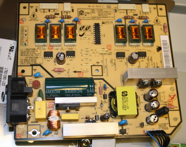

            First point, thanks for the pictures, but it's more effective to post just two or three pictures. The first should be a shot from directly overhead showing the suspected card (in this case, power supply / inverter) at as close to 2000 x 2000 resolution as possible. That is usually sufficient to show any bulging caps.
            The second picture should be a bottom view of the suspect board at the same resolution. The third is an over-all view of the back side of the monitor (with the back off, of course). If additional pictures are necessary, we will ask for them. Still, I prefer to be overwhelmed with an abundance of pictures rather than seeing one dimly lit out of focus picture taken with a cell phone camera.
            Now let's deal with this monitor.
            1. My recommendation is to replace all the electrolytic caps except the large 100uF, 450 volt one. It rarely fails. Capxon is a known bad brand.
            If you are in the US and order from Digikey a full set of caps will cost less than $10 delivered if you specify USPS First Class Mail shipping.
            2. It's a good idea to get as close to the original specs as practical. We aren't dealing with the Space Shuttle here, exact matches aren't necessary. I usually use Panasonic FM series, knowing that they are probably much better than original. It IS important to use low ESR caps that are designed for use in an SMPS power supply.
            3. I wouldn't bother trying to find higher temp caps. As you pointed ut, it lasted 5 or 6 years with crap caps, it's going to last at least 5 years more with good quality caps.
            4. Unless you are planning on doing many of these monitors, just stick with a soldering iron.

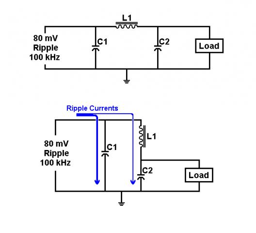

                                    In regards to blanket across the board [universal] advice that's only -responsible- advice that can be given.
                                    -- HERE IS ONE EXAMPLE OF WHY:
                                    Following PI circuit and component values taken from a Viewsonic Power/Inverter board.
                                    - PI filter redrawn to show parallel Ripple Current paths.
                                    12v circuit.
                                    Coil 0.6uH [@ 100kHz => 0.3770 ohm -- This high value for ohms overwelms C2 such that C2 ESR changes don't matter much.]
                                    'Original' caps: Capxon KF 1200uF 16v
                                    ESR = 0.061ohm
                                    Max rated Ripple Current = 1500mA
                                    Assuming 80mV Ripple @100kHz from power source.
                                    [ATX spec is 120 mV on +12v and a screen's basic PSU isn't going to be that good so 2/3 of the ATX spec is a conservative value.]
                                    Will be looking at C1 only as the current through C2 won't change much with the relatively high impedance of the coil in series with it.
                                    C1 branch with KF installed and 80 mV Ripple from power source.
                                    0.061 ohm --> 1311 mA Ripple through C1.
                                    [186 mA less than the KF's max Ripple Current rating.]
                                    Now you blindly replace the KF with an FM of the same uF/volts because you are too lazy to do the math.
                                    'Replacement' cap: Panasonic FM 1200uF 16v
                                    ESR = 0.018ohm
                                    Max rated Ripple Current = 2470mA
                                    C1 branch with FM installed and 80 mV Ripple from power source.
                                    0.018 ohm --> 4444 mA through C1.
                                    1974 mA MORE than the FM's rated max Ripple Current.
                                    Congrats!
                                    Your plan has resulted in exceeding your pet FM's max Ripple rating by almost 2 amps.
                                    In fact: The FM's max Ripple Current rating would be exceeded with only 45 mV of Ripple present.
                                    - So, in effect, the much lower ESR 'good' cap can only handle about 1/2 the ripple of the crap cap without overheating and degrading itself.
                                    So I'll repeat the standard recommendation that -responsible- techs hand out to people that could otherwise get into trouble:
                                    ---- - IF YOU AREN'T GOING TO DO THE MATH, then stick as close to the original values as possible.
