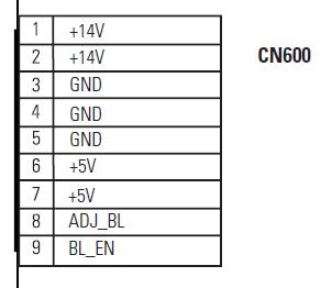

      Post something like this also : with (-) probe of DMM on pin 5 (either way, it is GND from top to bottom or bottom to top, is the middle one )
      1.-
      2.-
      3.-
      4.-
      6.-
      7.-
      8.-
      9.-
      Tha would help.

        • IRShifty
          • May 2009
          • 78
          Re: Samsung 910t
          12v
          12v
          gnd
          gnd
          gnd
          5v
          5v
          0v
          -100v

            Something is wrong here!! Operator error?

              That is what i was confused on. Checking the voltage the same as i did the rest of the pins, This one went negative and kept changing to different readings all around -100. I am confused as well.

                  That pin, in my case, is/was the BLON signal. It has voltage only when connected to a VBoard and with valid signal. The pin before it (the one you put 0v) was varying, so I guess it is/was the dimmer.
                  The PSU was connected to the VBoard or not?

                      See page 9-1 (page 45) on the mentioned service manual. There's the connector pinout with the voltages that are/must be present.

                          With the vboard i am getting:
                          12V
                          12V
                          gnd
                          gnd
                          gnd
                          5V
                          5V
                          47mV
                          8mV

                            pin 9 (BL_EN) should read 5V if switched on... but hey, it doesn't matter at all since your backlight works anyway.
                            pin 1 and 2 should be more like 13 or 14V according to the manual but i doubt that's the issue.
                            have you checked with both analog and DVI inputs?
                            if you have a scope, you could follow the manual (no input signal).

                              Dimming voltage (adj_BL) should be around 2.5 to 3.xV, The BL_EN is backlight enable pin which should go up to appox 2.5V ~ 5V (positive). I'm sure.

                                The manuals says 14v,, however I too measured 12v on that pins.
                                The last pin, the BL_ON line, showed 5v with valid signal attached.
                                That goes on for about 10 sec and then it goes black and then the screen is populated with colored vertical lines
                                I've seen a similar behavior, but the screen ended completely white. That was caused by a short that left the BLON signal always on. If you turned off that unit, it would do that.
                                If you connect valid signal to it, it must display something. The unit I had that used to shut down itself after a valid signal was applied, was fixed by changing only one cap, the (1) in my crappy schematic/drawing, as per PCBONEZ instructions.
                                Measure the BLON line with valid signal attached.
