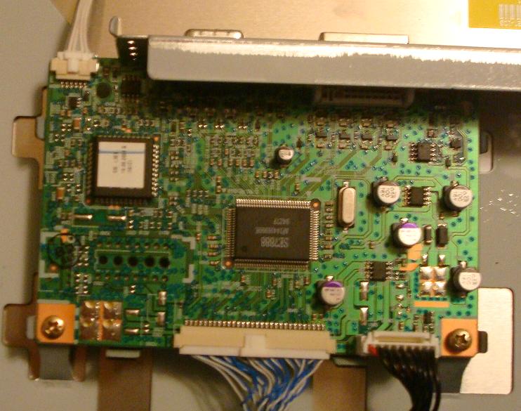

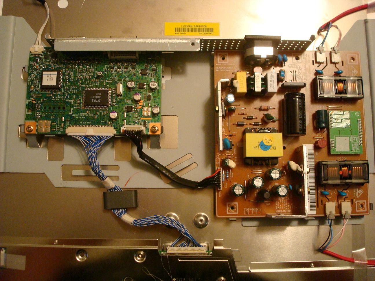

          Re: Samsung 910t
          Here are some pictures.
          • EGuevarae
            • Nov 2008
            • 1336
            Re: Samsung 910t
            Check the voltage readings on the lower left connector of first pic. Sometimes (very often) the pins are labeled (5v, GND, etc). Also, check the ribbon that goes to the panel from the vboard.

            • lucky13
              • Aug 2007
              • 412
              Re: Samsung 910t
              When powered on the back lights come on and it has an image in the top left that flashes between the words digital and analog as if it is searching for signal. That goes on for about 10 sec and then it goes black and then the screen is populated with colored vertical lines.
              That's the standard Samsung signal detection routine. If it doesn't think there is a signal Analog or Digital, it will keep showing that.
              So, that means your inverter board is good and your LCD works.
              My guess is there is something wrong on the logic/main board (the green one).
              If the voltages are there, then there is not a whole lot more you can do except get the same board elsewhere.
              Do follow the instructions eguevarae provided you. Good luck.

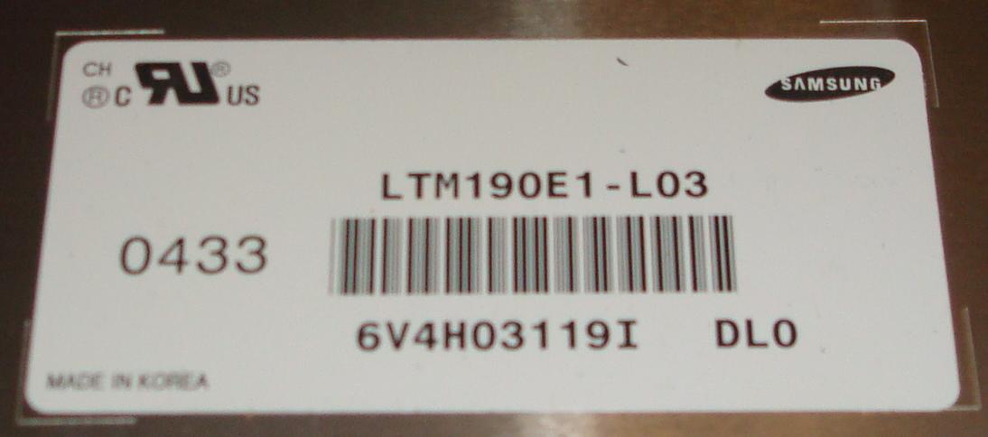

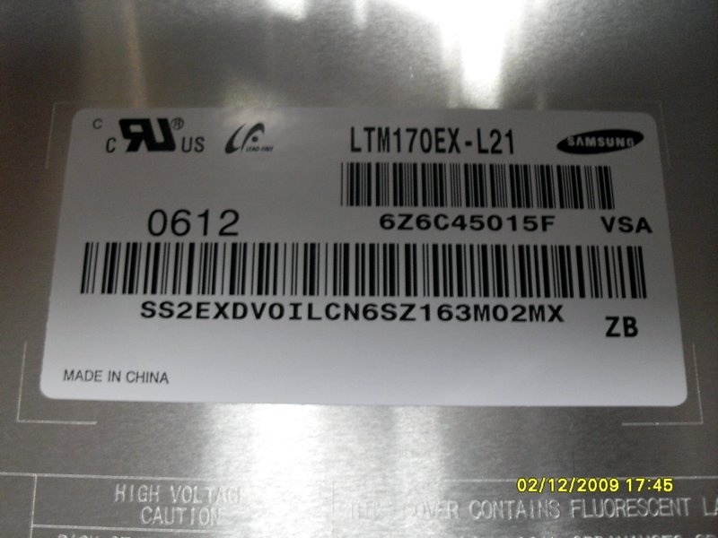

                    • Wizard
                      • Mar 2008
                      • 2296
                      Re: Samsung 910t
                      that's model code (samsung have 2 lines of models on sticker).
                      What is asked about is brand & model of the *internal* LCD PANEL.
                      Cheers, Wizard
                      • EGuevarae
                        • Nov 2008
                        • 1336
                        Re: Samsung 910t
                        Cheers, Wizard
                        Exactly!.
                        Look at the pic IRShifty, it is from the panel of a 730B. That's what I'm asking

                        • IRShifty
                          • May 2009
                          • 78
                          Re: Samsung 910t
                          • EGuevarae
                            • Nov 2008
                            • 1336
                            Re: Samsung 910t
                            I must have a screen like that. Let me see if I can locate it. If I find it, it must be with its VBoard. If found, I'll see if I can send you the VBoard.

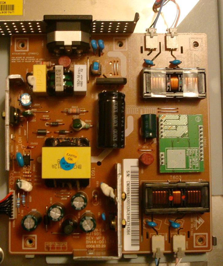

                            • IRShifty
                              • May 2009
                              • 78
                              Re: Samsung 910t
                              I will not hesitate to pay shipping, I checked the voltage but I was getting some odd readings. What should I get?

                                Re: Samsung 910t
                                You must have 5v and 13v. One line will show you 5v with signal and 0v without signal (that's the BLON line, which turns on the backlight).
                                Bad news : the screen I have is cracked. Sorry.
                                The connector is marked? I mean, has the GND, BL_ON, etc. signs or not? I can't remember if they are marked.

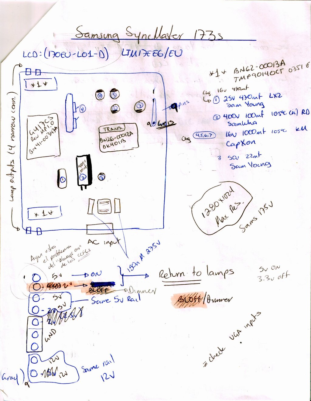

                                • EGuevarae
                                  • Nov 2008
                                  • 1336
                                  Re: Samsung 910t
                                  I just found this notes from a 173s, which uses almost the same (OK, it is the same ....) PSU/Inv as your unit.
                                  The "gray" in the note should be the "red" in your PSU.
                                  I don't know if your PSU would give 13v instead of 12 because of the 17->19" difference.
                                  Pins 1 & 2 are dimming and BLON.

                                  • Wizard
                                    • Mar 2008
                                    • 2296
                                    Re: Samsung 910t
                                    Still 13V, usually kind of high 12 voltage. I remember that for 17 & 19 because I repair these LCDs as authorized samsung shop.
                                    Cheers, Wizard
                                    • IRShifty
                                      • May 2009
                                      • 78
                                      Re: Samsung 910t
                                      I'm getting 9v on all of them, don't know how, but i am.
                                      • Wizard
                                        • Mar 2008
                                        • 2296
                                        Re: Samsung 910t
                                        Can we have detail again?
                                        What capacitors are used to replace and did this PSU get complete do-over with electrolytic capacitors? Little ones too.
                                        Cheers, Wizard
