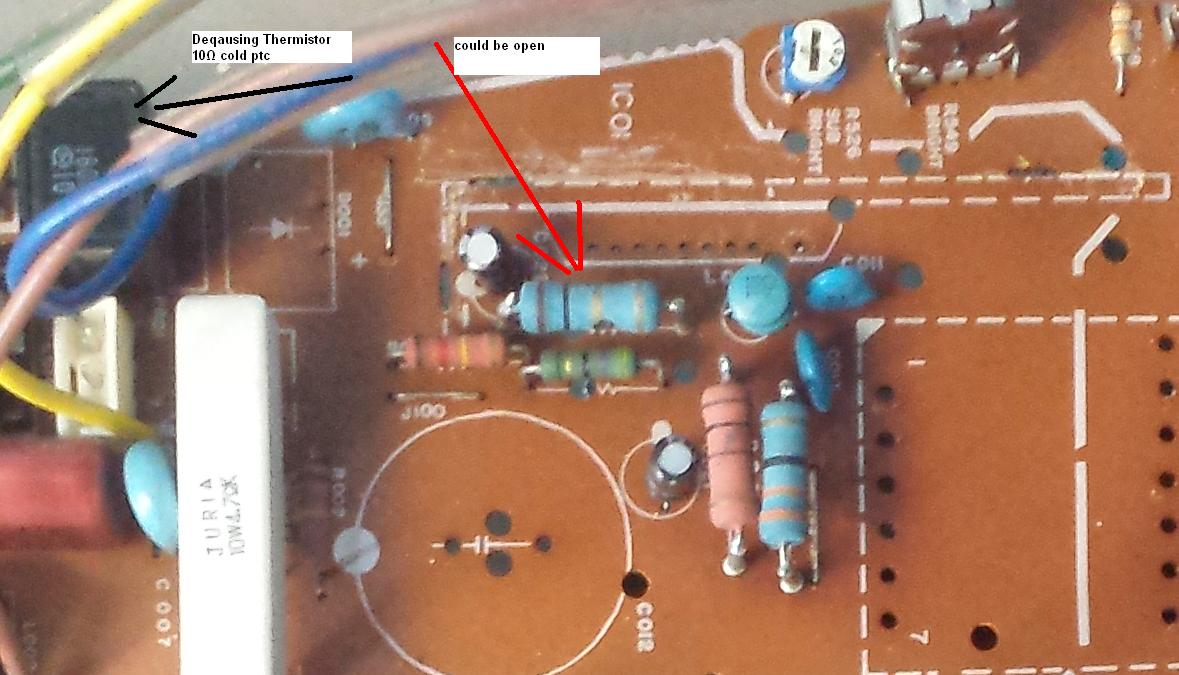

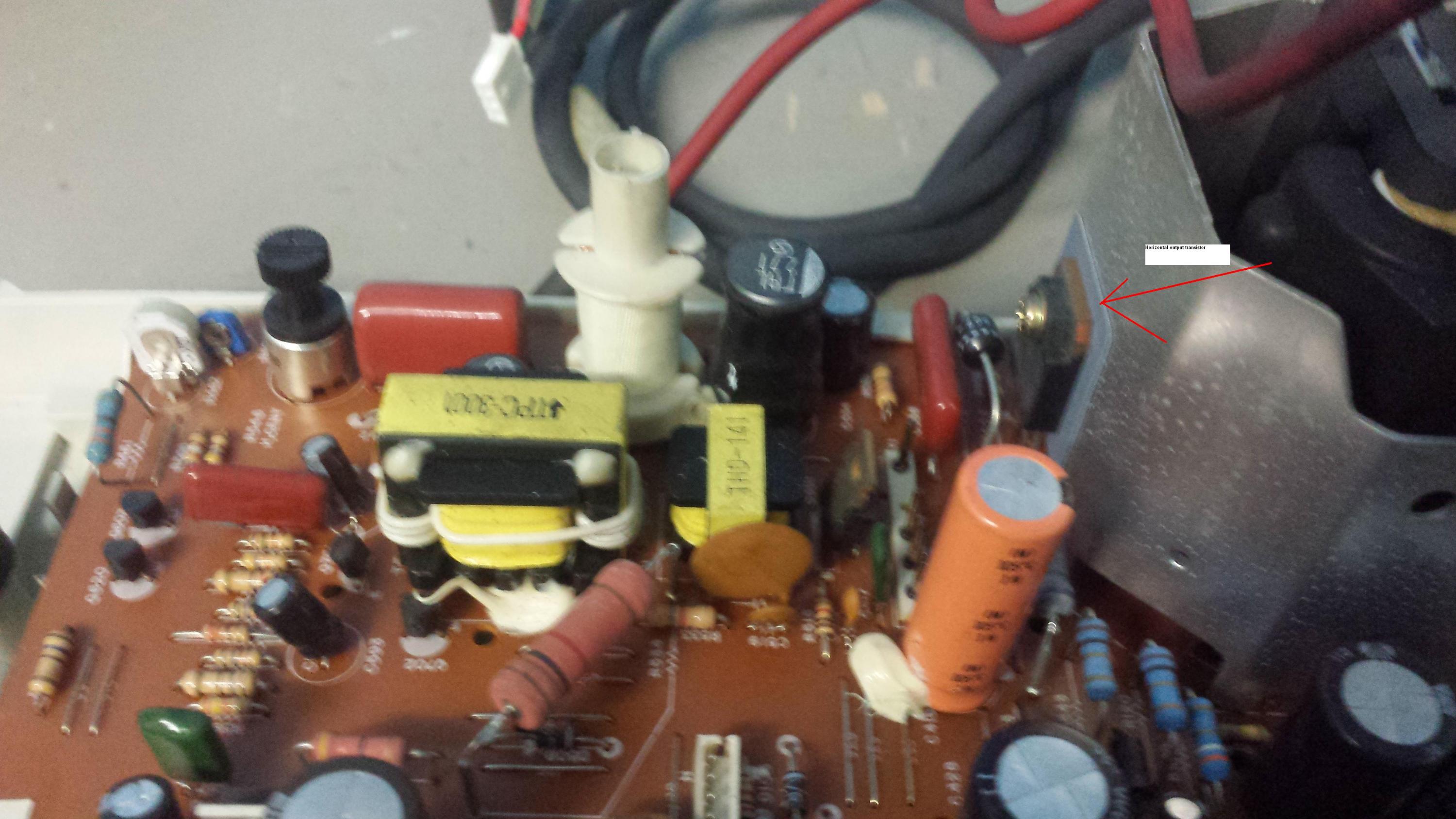

                                      Well that didnt last long. After all that I hooked it up to the old Tandy computer it goes with and It seemed to be completely fine with a good dispaly. The as I was standing there watching it boot up I heard a dull sounding "POP" and it went dead again. There was no smell or any smoke just the POP.
                                      Today I looked at and could see nothing external and the fuse was OK, so I undone everything I did to it ,removing all components & heatsinks again and inspecting them all for visible damage but can see nothing wrong with any of them. I tested the LB156 bridge Rectifier and it checks out as OK. Here are a few pictures of the PCB with the components and items in the way removed like a large capacitor and a transformer otherwise its just the rectifier, regulator, vertical transistor and heatsinks that are removed. Can someone tell me what the black box in one of the pictures is and how i test it (PR01).
                                      Pictures here
                                      Well now I am stumped. What could have caused the pop and it going dead?? any ideas anyone.
                                      • R_J
                                        • Jun 2012
                                        • 9559
                                        Re: Help with Old InterTan (Tandy) Monitor
                                        If you post the pictures in the thread. Use the Go Advanced and click on the paper clip to attach them.
                                        Pr01 is the degausing thermistor, it is a ptc, likely around 10 ohms cold, It is only used for degausing the crt, it won't effect the operation of the power supply
                                        Check the 1Ω resistor
