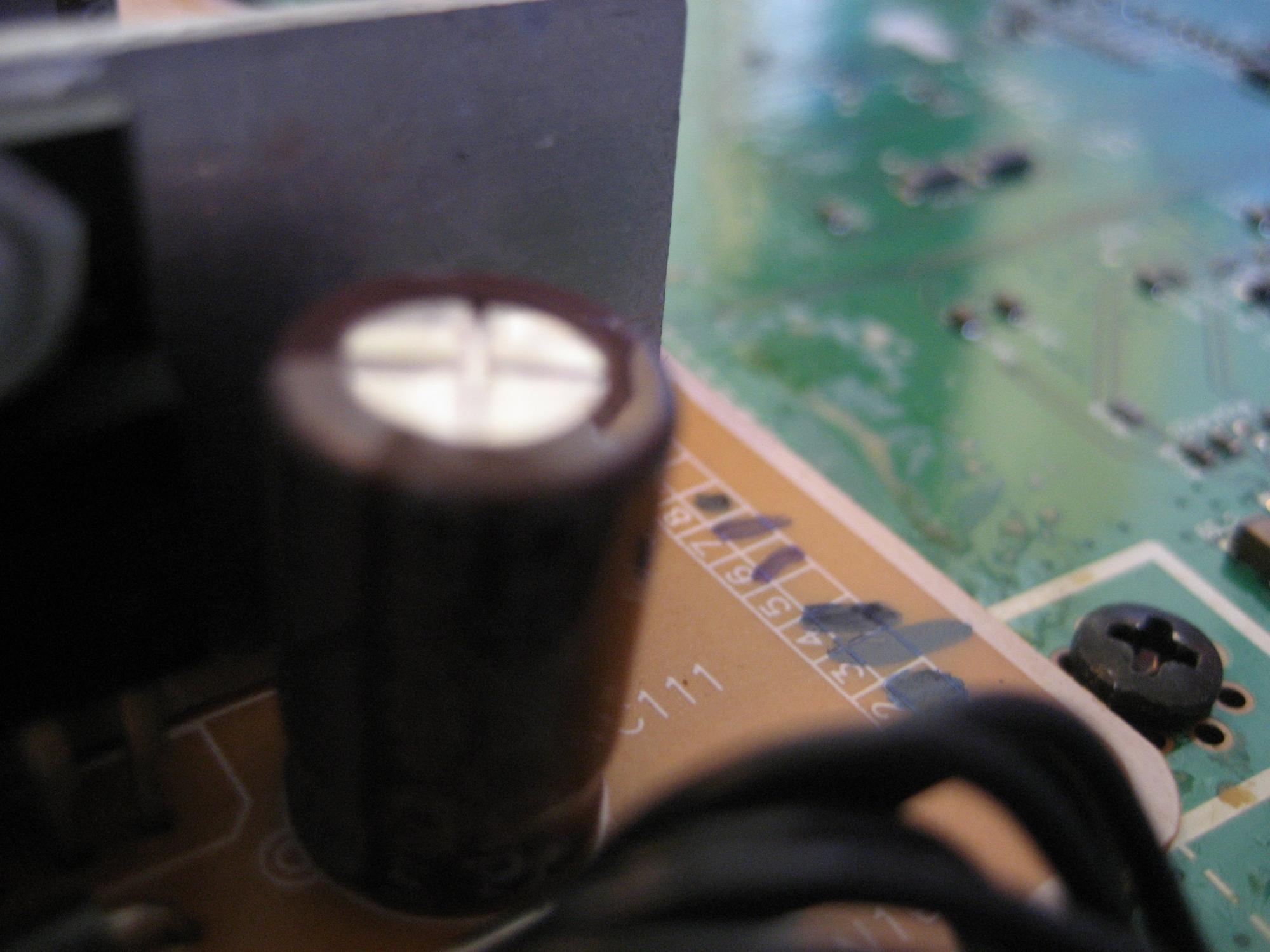

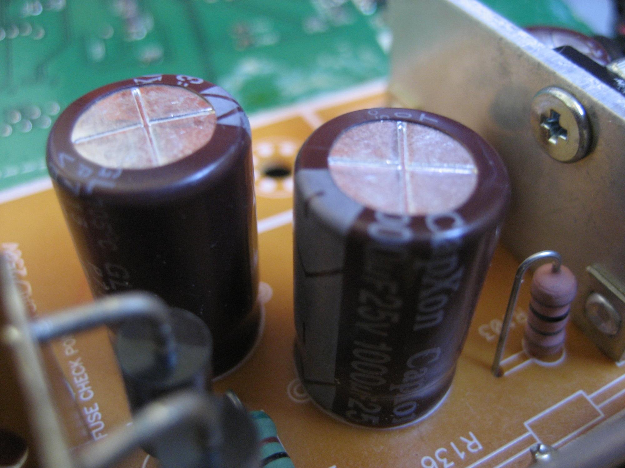

                          Hello everyone, recentely my Samsung Syncmaster 225ms broke down on me. I know the screen is fine because when I turn it on, I can see my computer monitor for a quick second and then the screen goes dark. If I shine a bright light onto the screen I can see my desktop, but only faintly. After reading about 5 pages into the fourm I am sure it is the capacitors that are broken. The only thing is, I don't know where to get or what kind of replacement capacitors are. I have gone to digikey and followed PlainBill's seach guide, but nothing came up. Samsung 225ms
                          In the pics below the first picture( a bit darker than the others) has the bad capacitor(at least I think it is) But I plan to replace all of them for more reliable ones. Can someone please help me figure out what capacitor I need to buy?
                          Thanks you so much!

                            Re: Samsung Syncmaster 225BW
                            Thanks you so much!
                            -Aaron
                            I'm not sure, but here's one way to do it. I count 11 electrolytic caps on the board. Don't bother with the big one; it seldom fails.
                            1. Measure the tallest cap on the board. That defines the tallest cap you can use.
                            2. Make up a chart showing the following information for each of the 10 caps you are going to replace: Capacitance, voltage, diameter, location.
                            3. Use the procedure I wrote for selecting caps. Double check the height; you don't want to choose one that is too high.
                            4. Post the proposed list. Someone will double check it.
                            PlainBill

                              What do you mean by each of the 10 caps I am using? Sorry, I am new to this. Also where would I find the capacitance, and what do I use to mark the location? Hopefully the pictures I took could help?
                              Also I don't really know how the chart would be set up, do you have an example of some sort I could see and mimic?
                                Look at the board. Each capacitor has a location number next to it. In the first picture I can read the location for one of the caps - C220. I also can make out the value - 470 uF, and the voltage - 25V (I think). In the last picture I can identify 3 more location numbers - C222, C221, C232. In the upper left corner are three more caps, at top center are two more tiny ones, and near bottom center is the last one; it's location number ends in 7. It's likely C220 is 10mm in diameter, 16 mm high.
                                So the table would look like this:
                                C220 10 mm 470uF 25V
                                C221 10 mm
                                C222 10 mm
                                  C221 10 mm
                                  C222 10 mm
                                  PlainBill
                                  Got it. So I have the chart made but when I input the information into the digikey search, nothing comes up. I did not choose any brand because I do not know what brands make certain capacitors, but I did watch a video on youtube showing the brand jamicon with the same uF and voltage as the C220 capacitor. Could I also find capacitors at Radio Shack that might make it easier?
                                  Also I need a desoldering pump, would I find that at Radio Shack as well? Or maybe frys?
                                  thanks so much
                                  EDIT: http://www.radioshack.com/product/in...ductId=2103624 For instance would that replace my current 470uF cap fine?
                                  -Aaron
                                    Soldering supplies you can pick up at Radioshack or Fry's. DONOT purchase caps from them as they are the wrong type.
                                    I supsect you are entering the wrong info at the digikey site. Using C220 from your list as an example, try the following:
                                    at digikey.com. In the part search box enter:
                                    panasonic fm 470uf 25v
                                    press the "go" button.
                                    You should get a couple of hits that match your criteria of size and height. Some caps you can buy in multiples of 1, but others require a larger purchase and some are out of stock. Obviously, you want to purchase in multiples of 1.
                                    If you don't see the cap you want, then in the above search string substitute fm with fc or fr.

                                          Thank you for checking. I have ordered them and I will post again once I have replaced the old capacitors with the new ones.
                                          Many Thanks PlainBill!
                                          -Aaron
