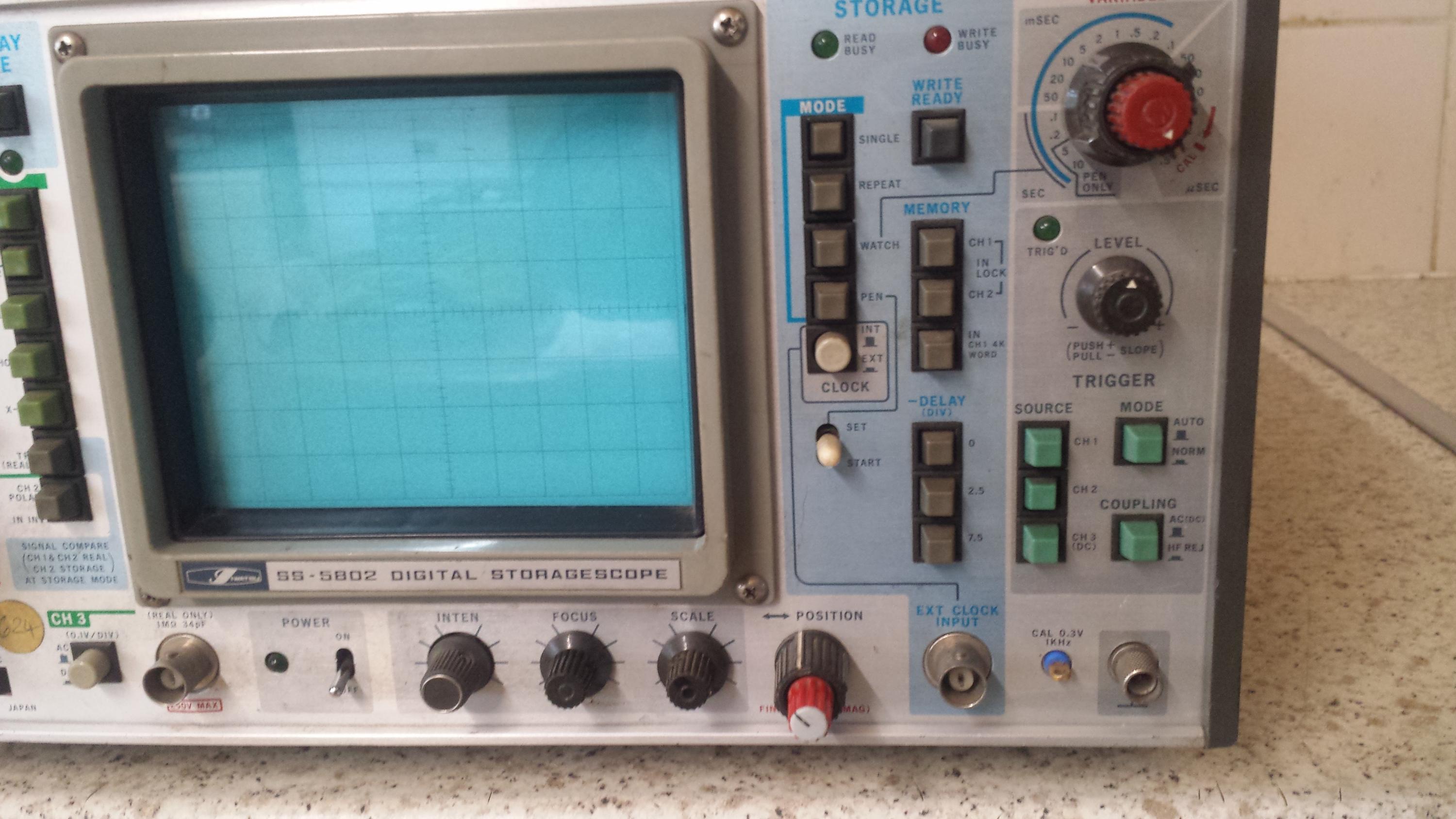

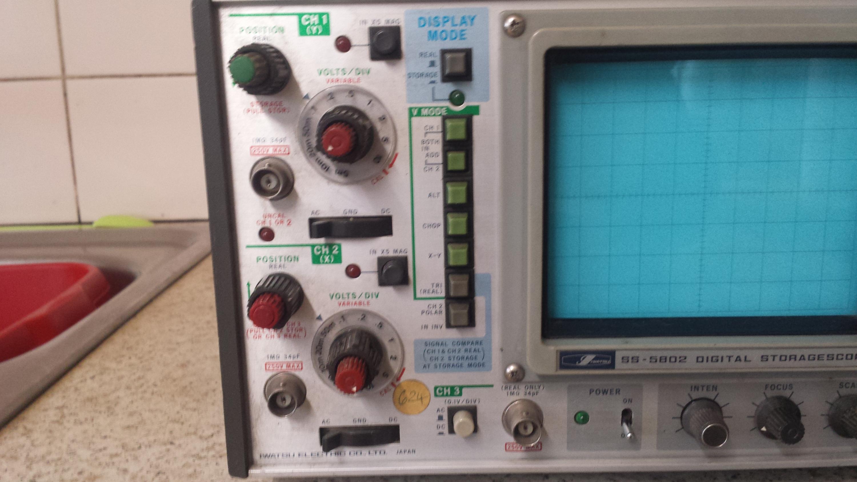

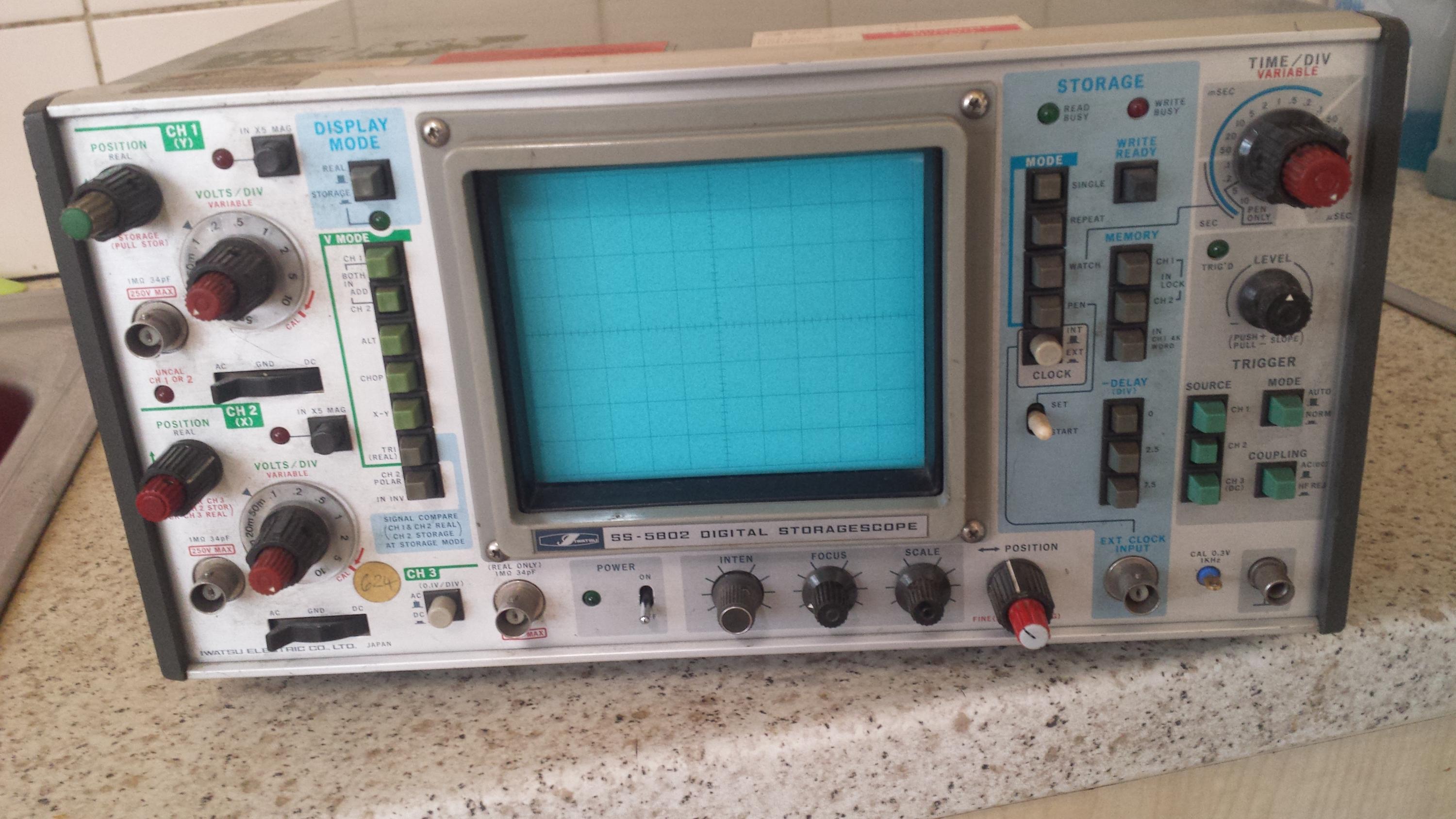

.What a stroke of luck I just found a nice "working" scope and its just 30 miles from me so I bought it so were back in business. Its a Iwatsu SS-5802 3 chanel Dual Trace Oscilloscope with 2 probes, .5uS timebase and comes with probes. I thought it was a 40mhz scope but it turns out it might only be 10mhz so I hope it will still do. If it is, I will collect it in the next few days. What do you think is it a good one? The guy says its been great although it has a slightly noisy fan but he says its been like that for years. Any Good???
That looks a nice scope pity if it is only 10mhz lets hope it can do the tests you need im sure a more experienced member will advise if its ok, have you used a scope before? or are you a newbie like me with them ive been watching a few youtube videos too try and get my head around all the settings etc.
HI everyone Thanks you all for your patience through all these oscilloscope woes. Anyway Ive got a goodun now and it came with probes and a full manual as well. The guy was a radio amature and he demonstrated it all working for me using a frequency generator or something so I know its 100%. I hope this will let me get this Zenith monitor repaired now.

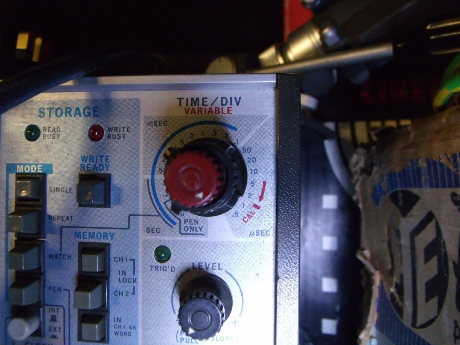

I am new to scopes RJ, what settings should I set it to? These pics show how they are set now. Sorry for this I have to learn, never worked with video signals and a scope.
i forgot, first you need to tweek the probe.
same setting as above,
connect it to the test-point - you may need 10mv per division - just ajust it for a visible squarewave.
on the probe or plug is an ajuster screw - it will have come with a PLASTIC screwdriver.
you need to ajust it so the wave is a nice square with straight corners.

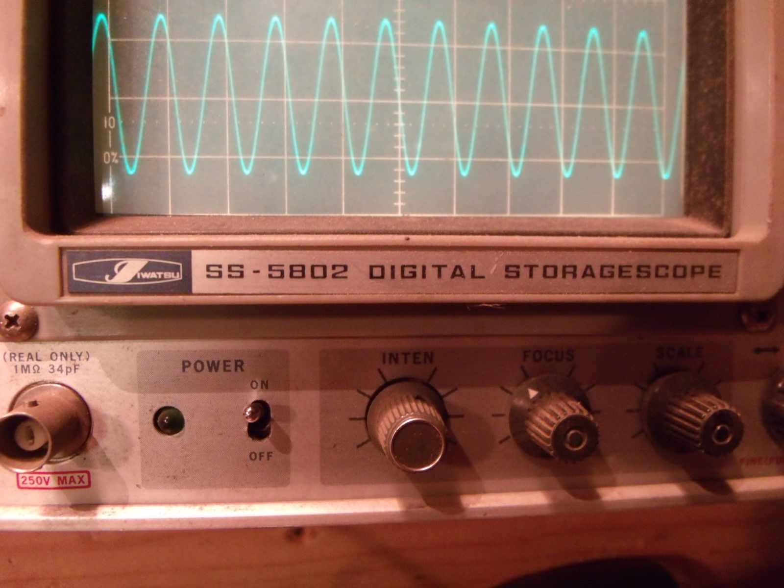

Thanks for those tips. I ddint know about the plastic screw driver so that was especially useful. Ive got both my scopes showing a square wave and calibrated probes on both of them. This proves I supose the Isotech scope is fixed as well I guess. Although the vertical lines are quite feint on both scopes but the horizontal very visible. Have to urn up the intensity a bit to see the vertical lines.
