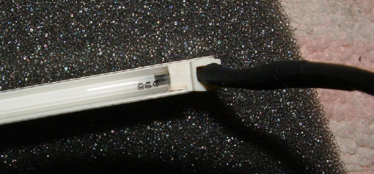

    Are there different wattages of these tubes at the same length? Could this be a case of 20w tubes in a 12w inverter?

    I'm no expert on CCFL tubes, but in florescent lighting if two tubes are the same length, but different diameter, the smaller diameter one draws less current. It thus seems logical that if someone substituted a larger diameter tube the exciting voltage to be the same, but once excited the current requirements would be higher. This is a SWAG!! Don't bet on it.

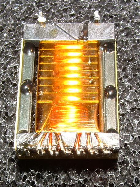

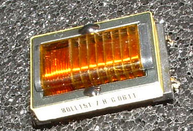

      Either way, if you get a chance to pull the transformer, pics of the bottom would be appreciated.

        It looks obvious to me that these lamps have very little time being lit,just by the way they look on the ends ,even after a short time you can usually see dark areas around the cathode where it gets hot.Resistor R7 is missing ,who knows if it is supposed to be .

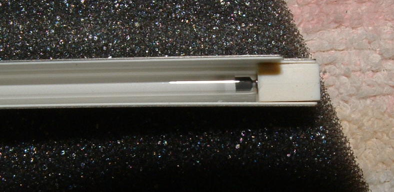

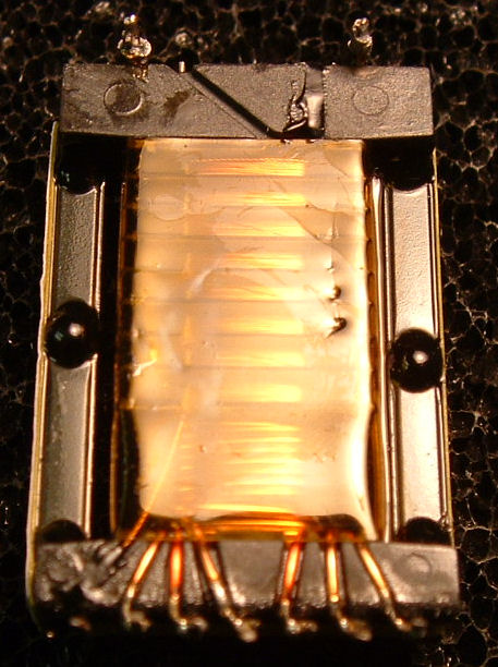

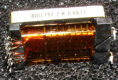

            The money I save on haircuts I use on stupid decisions to try and fix junk.Here are some pics for anyone interested ,of the transformer underside

              Thanks for the pics. NOW it makes sense why it APPEARED to have the secondary shorted.
              In the first 2 photos of the bottom-
              The secondary output high pin is the only one wired on the upper end (right). The upper left pin is unused electrically. The secondary ground is the lower left pin.

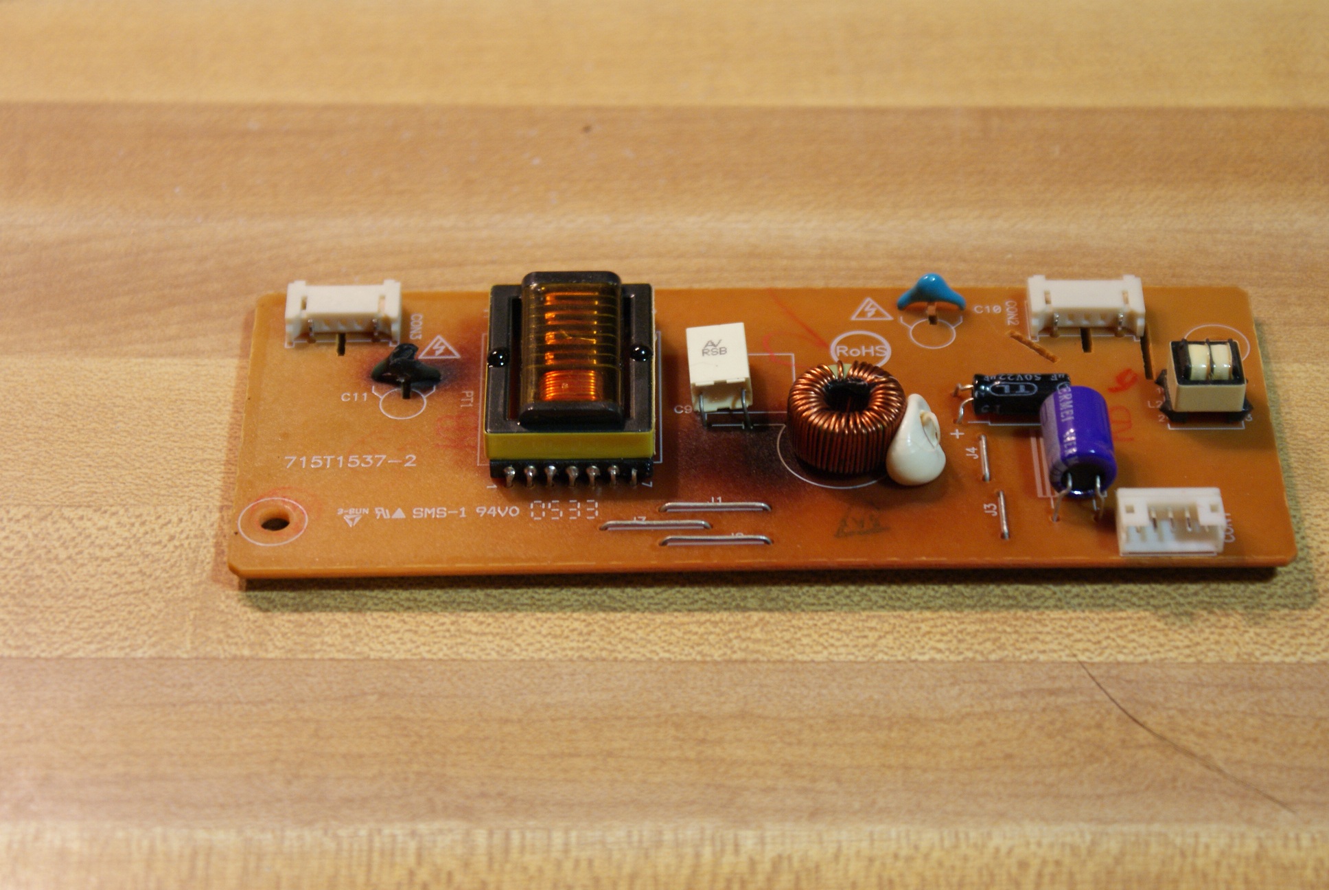

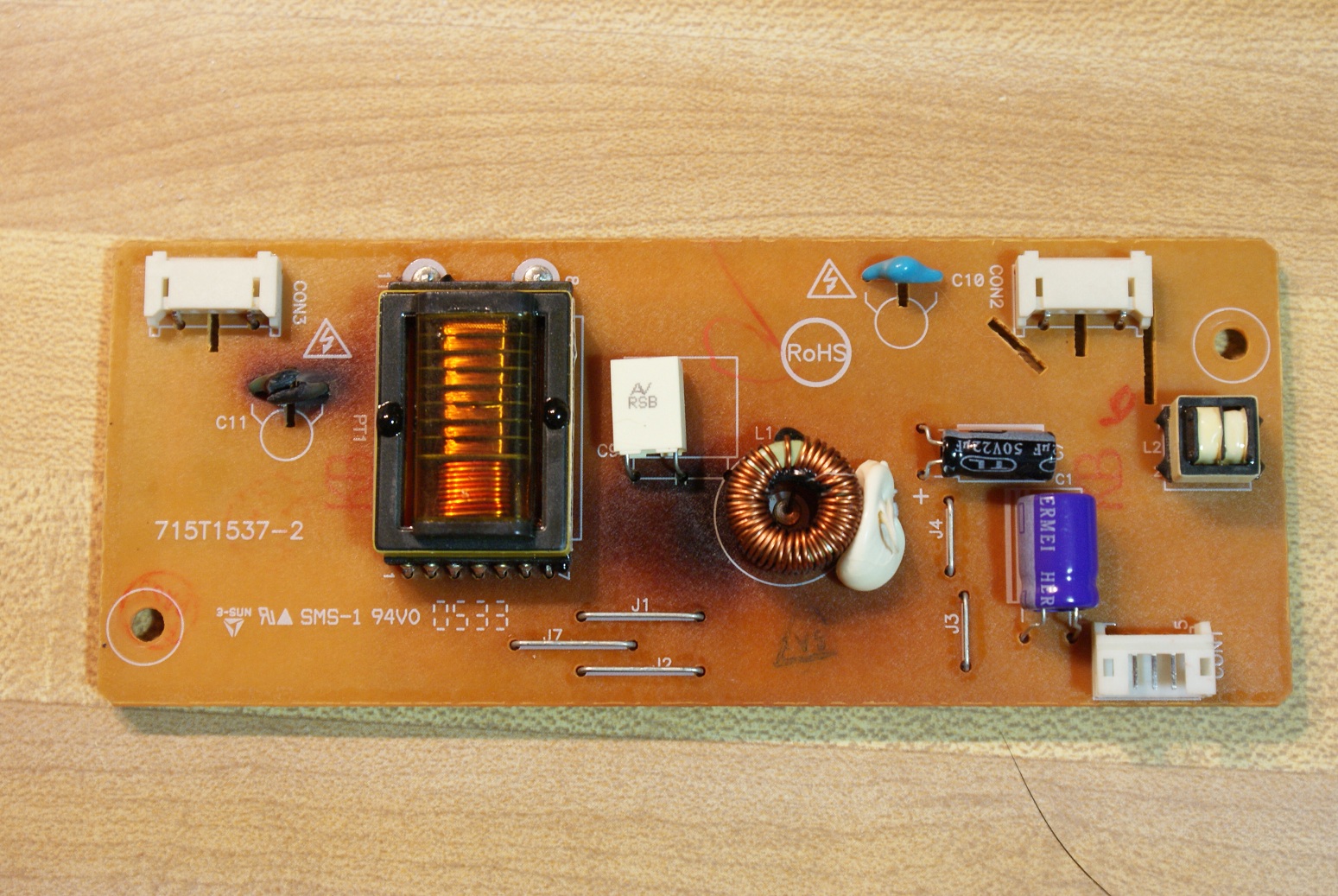

                        Here is a couple photos

                          Is this repairable?

                            the caps look like bad brands. replace those. but... the transformer looks overheated. i dont know how to test those but some one here does i bet

                              The general rule of thumb is "With enough time and parts we can repair anything."
                              C11 is the same value as C10. The numbers on (or better yet a picture) of C10 will help identify it. You will also want to scrape away any charred areas around C11. Make sure you match the original part, both for value and voltage.
                              The overheated area between L1 and PT1 isn't unusual. Odds are the driver FETs for PT1 are under there. Given that C11 smoked, odds are the inverter was working properly. A picture of the bottom side of the circuit board would be helpful. There might also be a fuse on that side.
                              PlainBill
                              As ratdude suggested, replacing C1 and C7? (The electrolytics) would be a good idea.

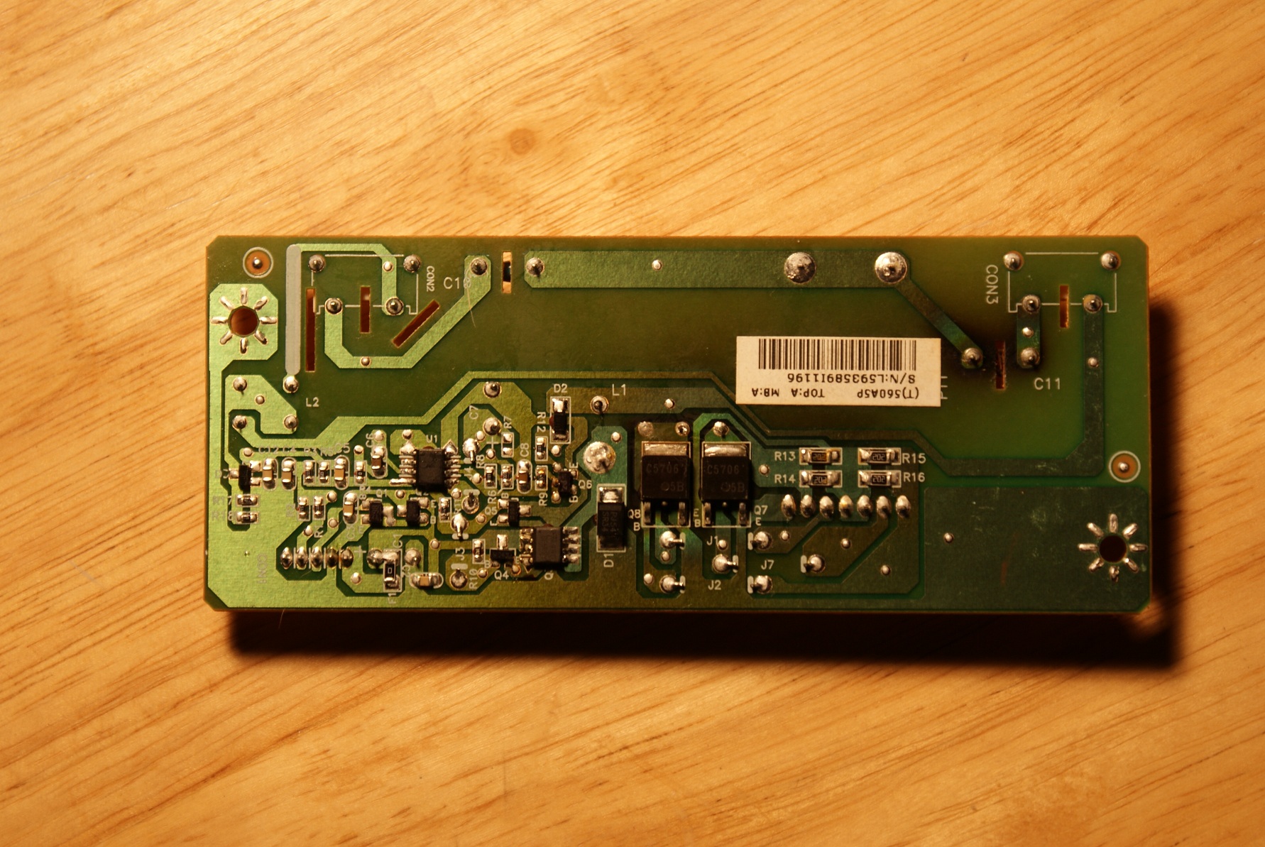

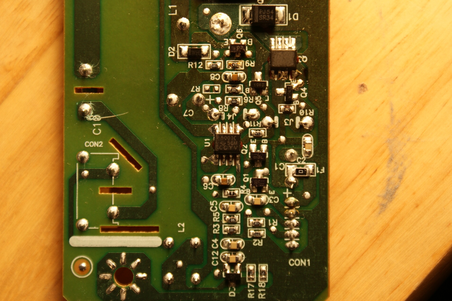

                                Here is a pic of the bottom. You guys are great help. I tried a couple of sites to buy this board but no one has it in stock for a decent price. So it looks as a rebuild may be the way to go. How would i determine the correct specs for this capacitor? There seems to be no numbers or any thing on c-10 to match it up with?

                                  I can't remember where I have read this but I think that blue cap is part of the lamp feedback (to determine open lamp shutdown?) so if it is burnt, there is a possibility the lamp connected to CON3 may be suspect.
                                    There are a couple of ways. The easiest is to use a DMM with capacitance feature to check the value of C10 (out of circuit). Another is to search for application notes on the PWM controller.
                                    I'm feeling pumped - the Twins beat the White Sox, sweeping the series so here is a quick rundown on the circuit. I've marked up your picture a little.

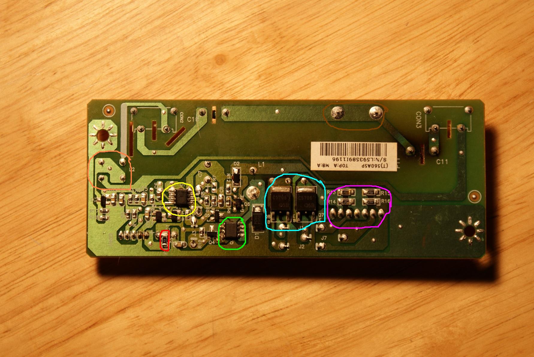

                                    The red circle is the input fuse. That is either an O (oh) indicating the fuse rating or a 0 (zero) indicating it is a jumper.
                                    The yellow circle - U1 is the PWM controller. Your picture is excellent, but I can't read the part number. That information MAY help with C11.
                                    The green circle (Q?) is a power FET, which boosts the output of U1 to provide drive current to the gates of - Blue circle - the power FETs (Q7 and Q8) which drive the primary of the transformer (pink circle).
                                    The brown circle is the high voltage end of the transformer secondary. Note that it goes through C10 and C11 to drive the CCFLs. The orange circle is L2, which provides CCFL current feedback to the PWM.
                                    NOW, to determine the value of C10 and C11, I suggest a couple of approaches. First, as I mentioned, measure the value of C10. Google application notes and data sheets for the PWM and see if they have a typical circuit. Google CCFL Inverter schematics and see if anything uses the same design. I know there is an extensive application note on inverter design out there from (Sanyo?), use a capacitor of the same voltage.
                                    And while lucky13 is wrong about it being part of the lamp feedback, it is reasonable to assume a bad CCFL caused excessive current through the capacitor and burned it.

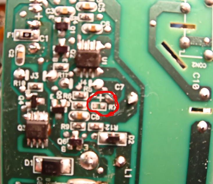

                                      Here is a little better photo. Thank you for all of the info you have given me.

                                        Well, U1 is a TL5001C, a general purpose PWM controller. Since it's not specifically designed to be used in a backlight inverter application notes won't be much help.
                                        I did find several schematics for inverters, which did provide a little information. All of them used either a 15pf or 27pf 3KV capacitor. Checking the value of the good cap would be a very good idea.
                                        It's been mentioned several times in other threads. The usual way to test inverters / backlights is to use a case mod light kit. These consist of an inverter and two 12" CCFLs and cost about $10. Use the kit inverter to test the existing CCFLs; use the kit CCFLs to test the (repaired) inverter. You will be dealing with voltages of 700 - 1000 volts and currents of about 5 ma so precautions are appropriate.
