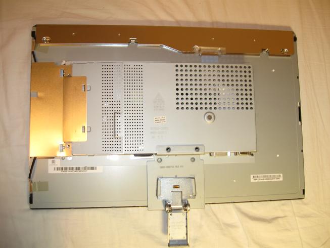

    Once the plastic back and stand are removed how do you get to the circuit boards without damaging the ribbon and cables.

      Rddube thanks for posting the PDF manual I was able to remove the power supply board.
      I don’t understand why the steel box that holds the circuit boards is not attached to any thing it is just held in place by the plastic back of the monitor.

              My old monitor died so I hit the thrift store looking for a replacement. I saw the worker set the Samsung 2253BW on the shelf so I grabbed it and tested for a screen saver and bought it.
              The monitor looks like new inside and out so I was shocked to find out it was made in 2007. This is why I removed the power supply to check the condition of the caps which all look like new.
              C107 47 x 50v Samwha XC
              C108 820 x 25v Sam Young NXB
              C112 820 x 25v Sam Young NXB
              C114 10 x 16v Sam Young NXB
              C115 1000 x 16v Sam Young NXE
              C116 1000 x 16v Sam Young NXE
              C118 10 x 50v Samwha XC
              C119 330 x 10v Sam Young NXB
              Inverter caps
              C301 820 x 25v Samwha XC
              C302 820 x 25v Samwha XC
              I have read several old posts here where bad caps cause the two surface mount inverter drives to short. It would be nice to know which caps cause the sm fet's to fail?
