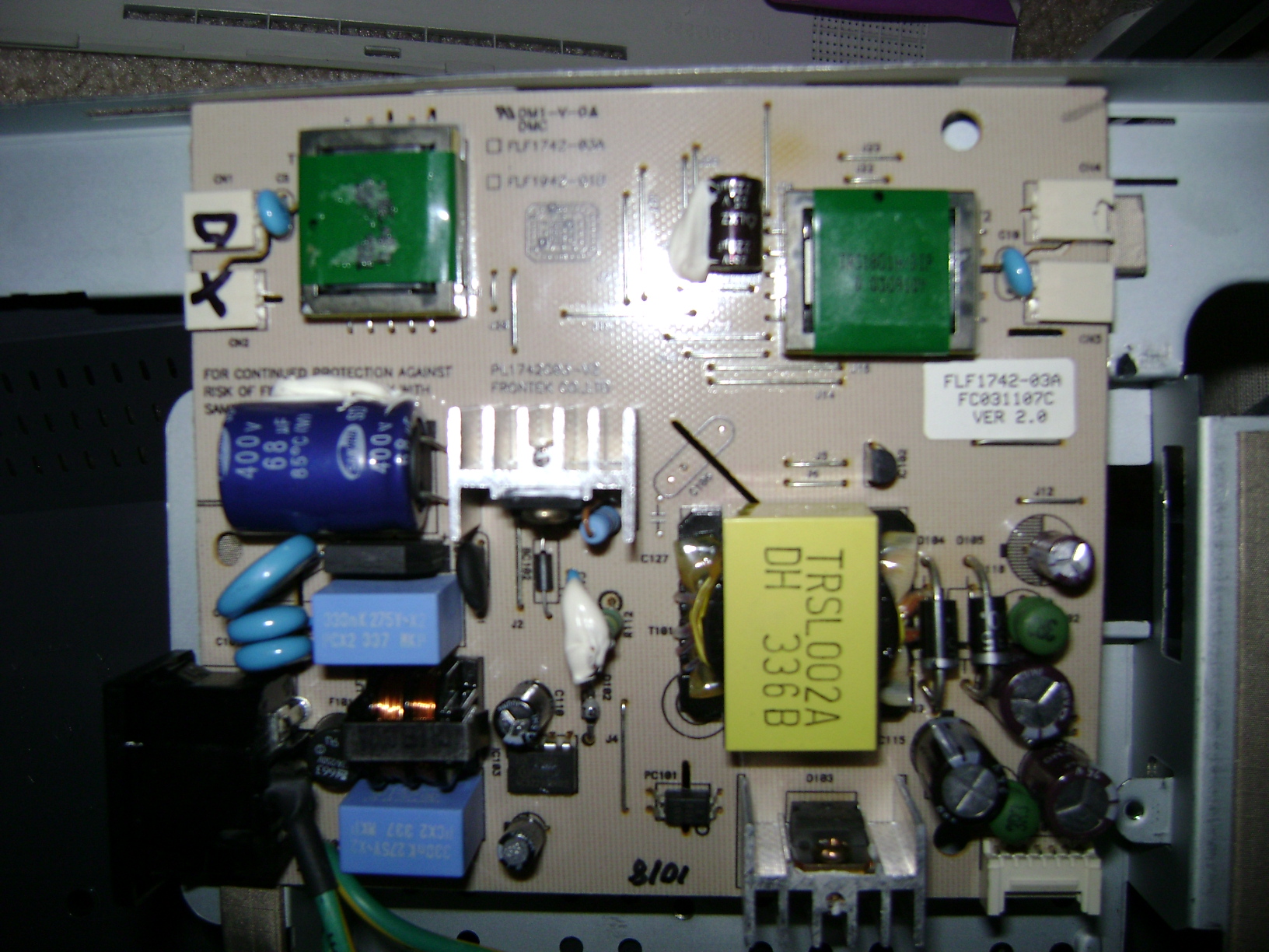

Hyundai 17 inch LCD monitor DEAD!!!! no power at all
  • shelby5041
    • Feb 2009
    • 1505
    • united states of america usa
    can anyone help me
    model L17T hyundai lcd monitor
    no power at all dead...no power light nothing
    can anyone guide me what to check i have it apart now
    all the caps look fine no bulging

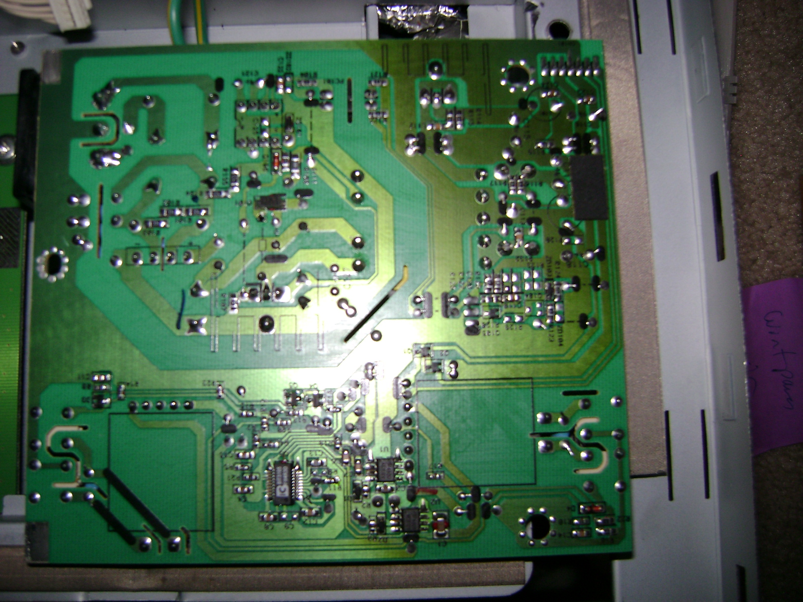

    post pictures of top and bottom of board for better assistance

        Re: Hyundai 17 inch LCD monitor DEAD!!!! no power at all
        here are some pics of the board

          if it's really dead (to be sure check the PS output with a meter) the fuse (F101, the round thing besides the AC jack) would be the first suspect.
            oh, and close-ups of the caps would be interesting.
            the inverter cap up there looks a bit fishy.
            aren't LXZ supposed to be blue?
            "Every normal man must be tempted at times to spit on his hands, hoist the black flag, and begin slitting throats." - H.L. Mencken
            • Krankshaft
              • Jan 2007
              • 2328
              That melted plastic on the inverter transformer looks disturbing.
              If that much heat was generated the insulation could have broken down and shorted it out.
              If you have two you may have to cannibalize one for it's inverter transformer.
              Unless thats just hot glue or something.
                its plastic i believe from the plastic protector that was around the entire board...like a thin plastic sleeve
                  i checked the f101 fuse and its fine........the lxz is black yes..that is the color its not discolored

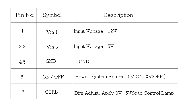

                    With power ON I'd CAREFULLY check the voltage across the big blue 400V 68 uf cap. It should read about 170 volts (+- 20 volts). If that is good take a look at the 7 pin connector in the lower right hand corner of the board. The picture isn't clear, but you should have voltage on several of these pins. Reading from left to right I'd expect the following voltages
                    1) 12V
                    2) 0 or 5V
                    3) 5V
                    4) Gnd
                    5) Gnd
                    6) ??
                    7) ??
                    6 and 7 are display blanking and brightness. If you don't see any voltage on pins 1-3 (measuring from 4 & 5) the power supply is dead.
                    PlainBill
                      yes there is a 7 pin connector on the psu board ..so if i check those pins individually i should get some kind of voltage and if i dont i know there is an issue with the PSU
                      and if there are readings then the power supply board is ok and i have other issues correct?
                            pin 6 is the power return pin (0v=off, 5v=on --thus should be tied to 5v to power the unit manually.)
