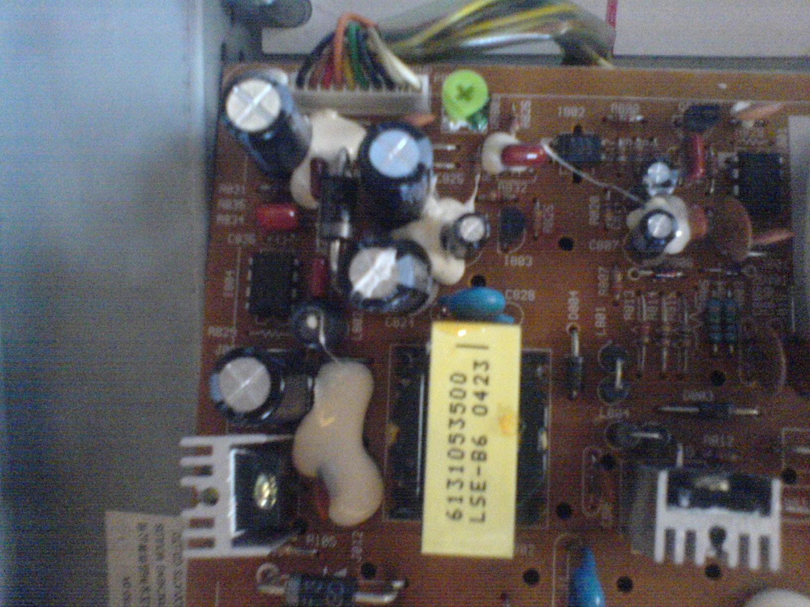

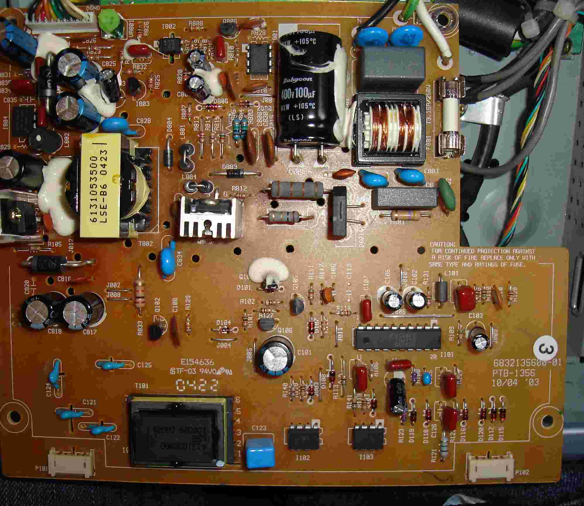

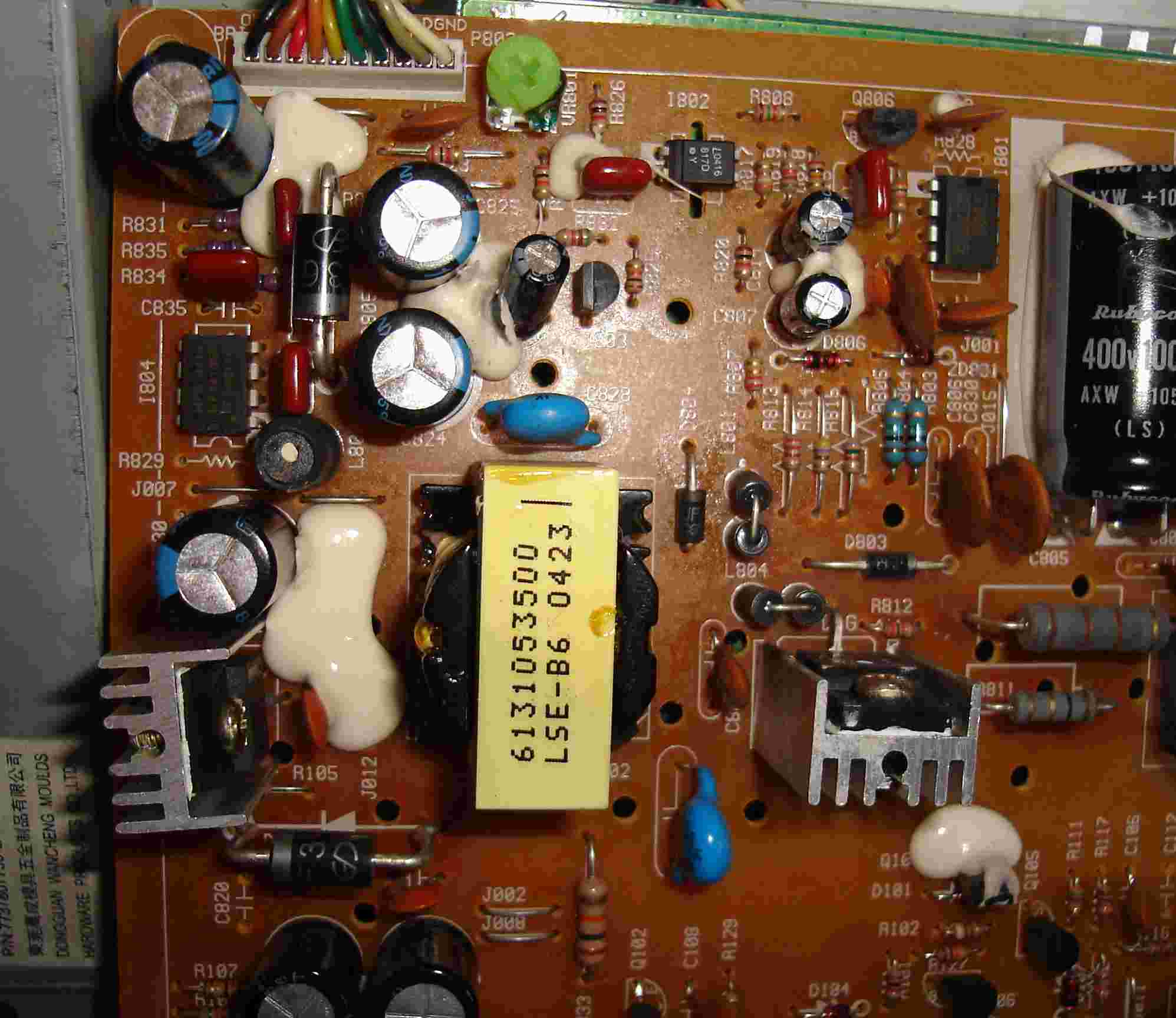

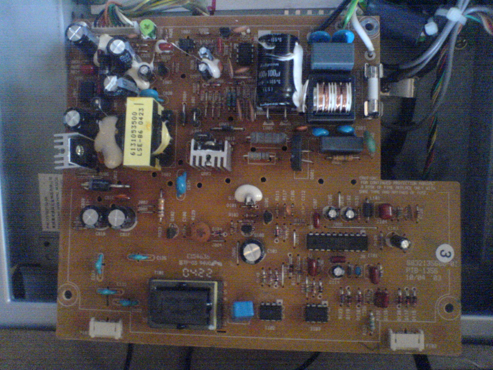

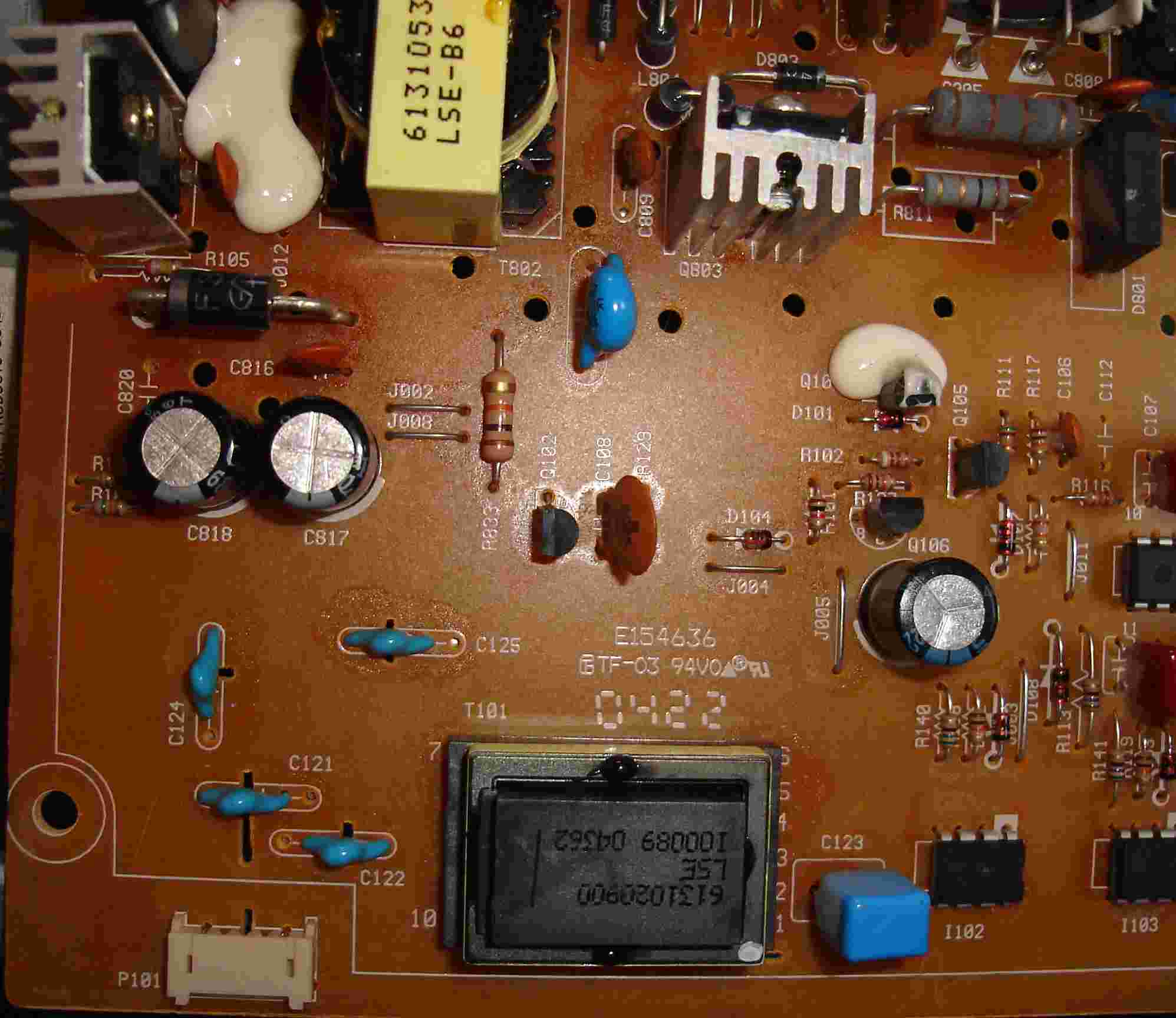

    The power invertor board is an E154636 and seems to associate with the COMPAQ PE1234. I've attached some pics.
    Any ideas?

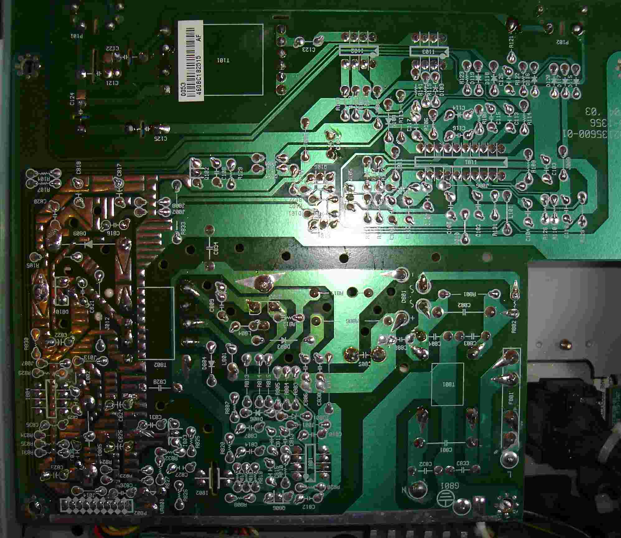

                can you post better photo of your board, both sides, clarity is poor, it will help others to help you, In the meantime check all solder joints with 8 or10 x magnifying glass for bad solder joints plus ring cracks in joints,pay particular attention to transistors and mosfets as well as anything on heatsinks, plus transformers,you may get lucky,best of luck

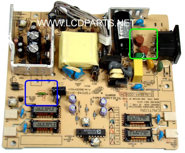

                      How would I recognise the inverter fuse?

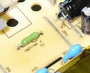

                        there are marking on the board . like PF = polyfuse F=fuse
                        i can`t see it on your photo`s. they are not good enough
                          Re: HP F1523 - 2 secs display then darkness
                          sorry i made mistake. i thought it was a benq power supply.

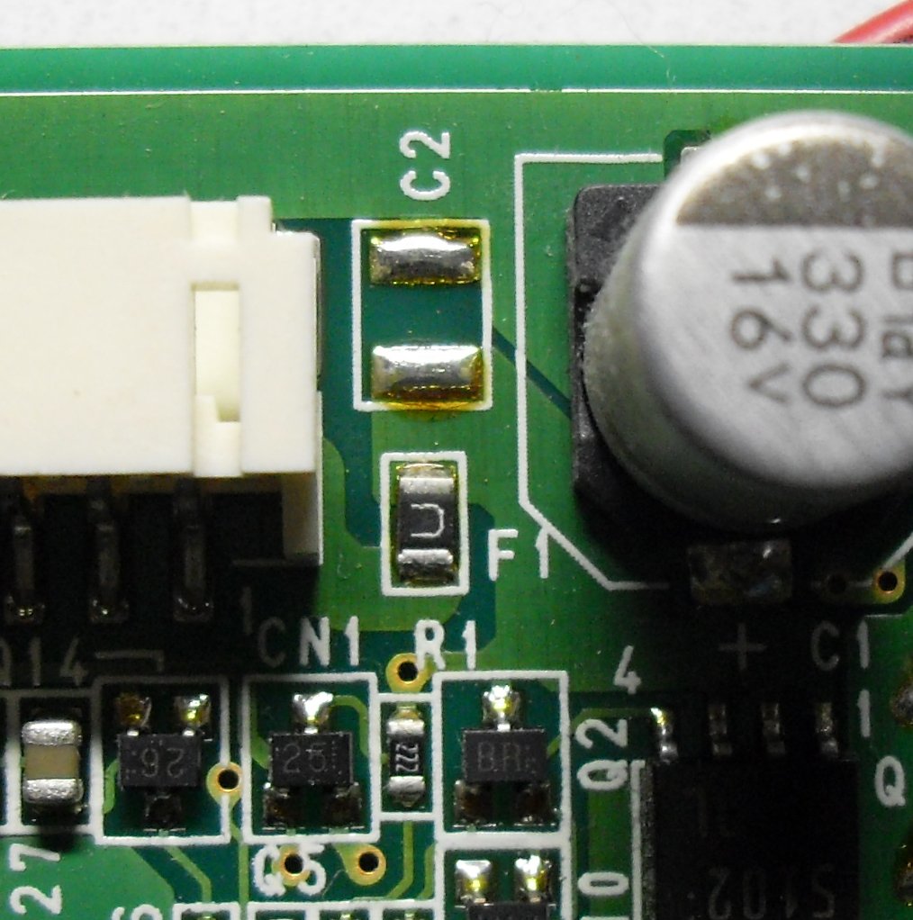

                            Yet, the markings on the silkscreen should be the same. Here are pics of three types of fuses. Hope this helps.
                            SMD Fuse

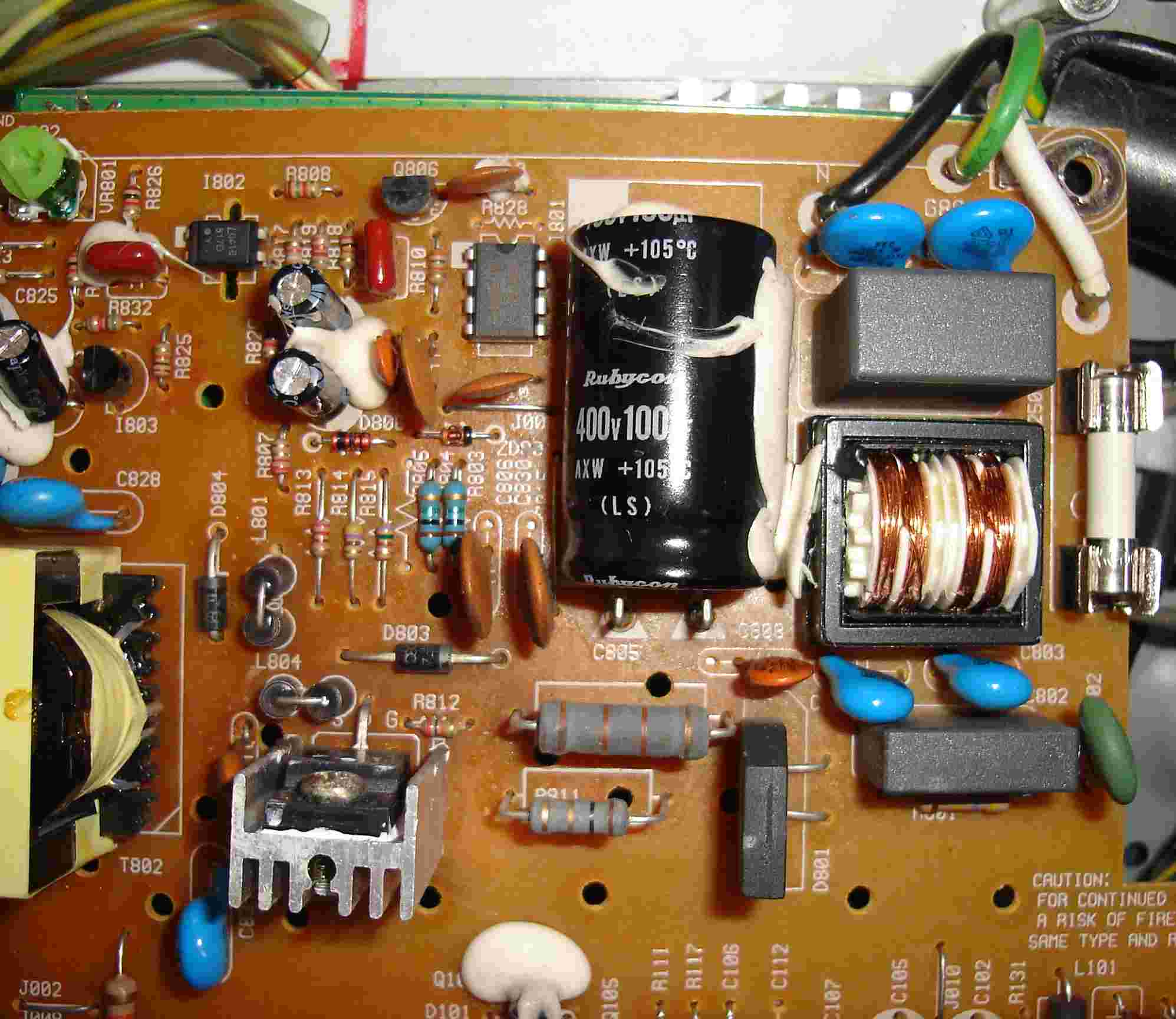

                              Hi
                              thanks for the updates Anno, EgueVarae
                              Maybe I've been a bit of a duffer here!

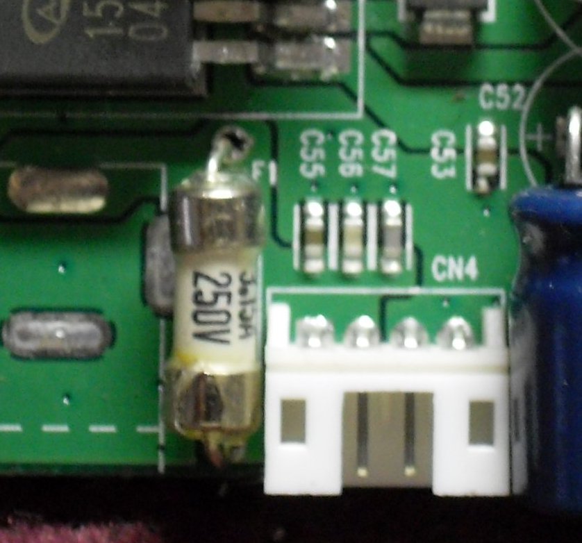

                              There is a rather obvious fuse with rating T3.15A/250V located near the power area of the board (top right of the 1st picture posted).
                              I assumed that it was simply a fuse similar to the mains supply fuse i.e. to restrict the current draw. The fact that power is getting through made me ignore it.
                              Is this the `inverter` fuse? I'll find out tomorrow regardless because I can swap out easily.
                                No, or at least not the one I (and I think anno too) was referring. That is the Main AC fuse, at the AC input. Look at the attached pic. The ones in green are the AC input fuses (different type, same function), and the one in blue is the inverter fuse.

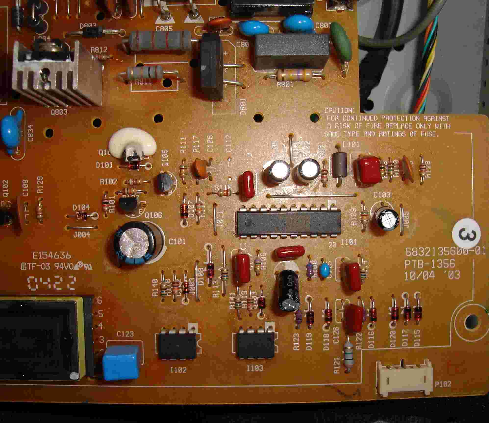

                                  What is the IC number on two of those twin 4 pin DIPs to the right of the inverter transformer?
                                  I'm willing say that they are DIP transistors and they drive the inverter transformer and one of them may be shorted.
                                  I'll get you a datasheet if you can give me the IC number so you can test them.

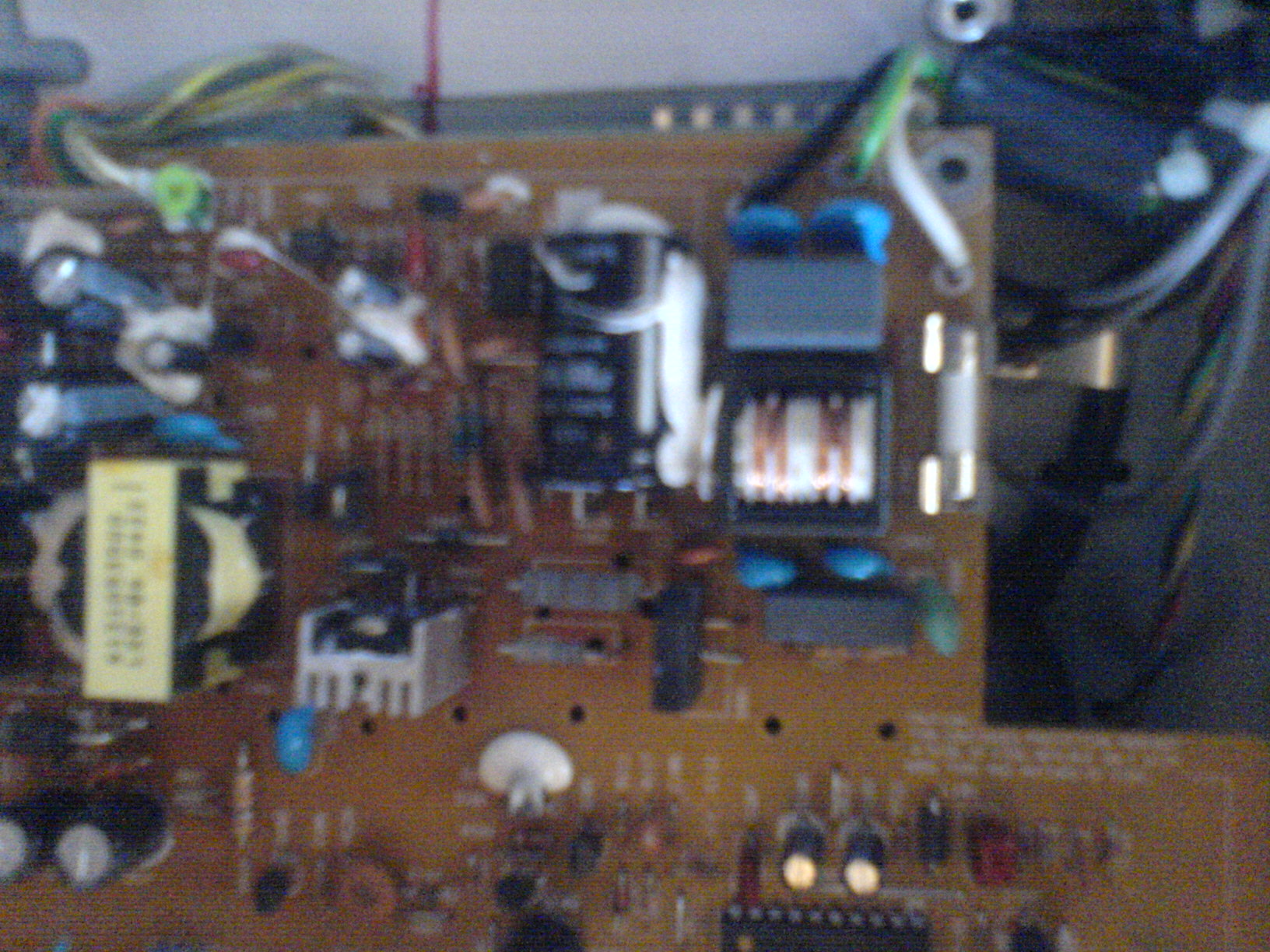

                                    hello again that fuse that you are look for, may also be black , resembling a resistor but more like a small diode, but all black, but it will have F something marked on board
                                    bob
                                      Hi everyone
                                      I'm at a loss in search of the inverter fuse.
                                      As BobDee suggested earlier, some improved pictures should help. Please restrict your mirth at my soldering prowess to 5 minutes only :-)

                                      I'm attempting to answer your question without displaying my true ignorance here. Are you referring to I102 & I103? If so, the print is very faint but I can read P600 BD4C15.
                                        2nd attempt with images
