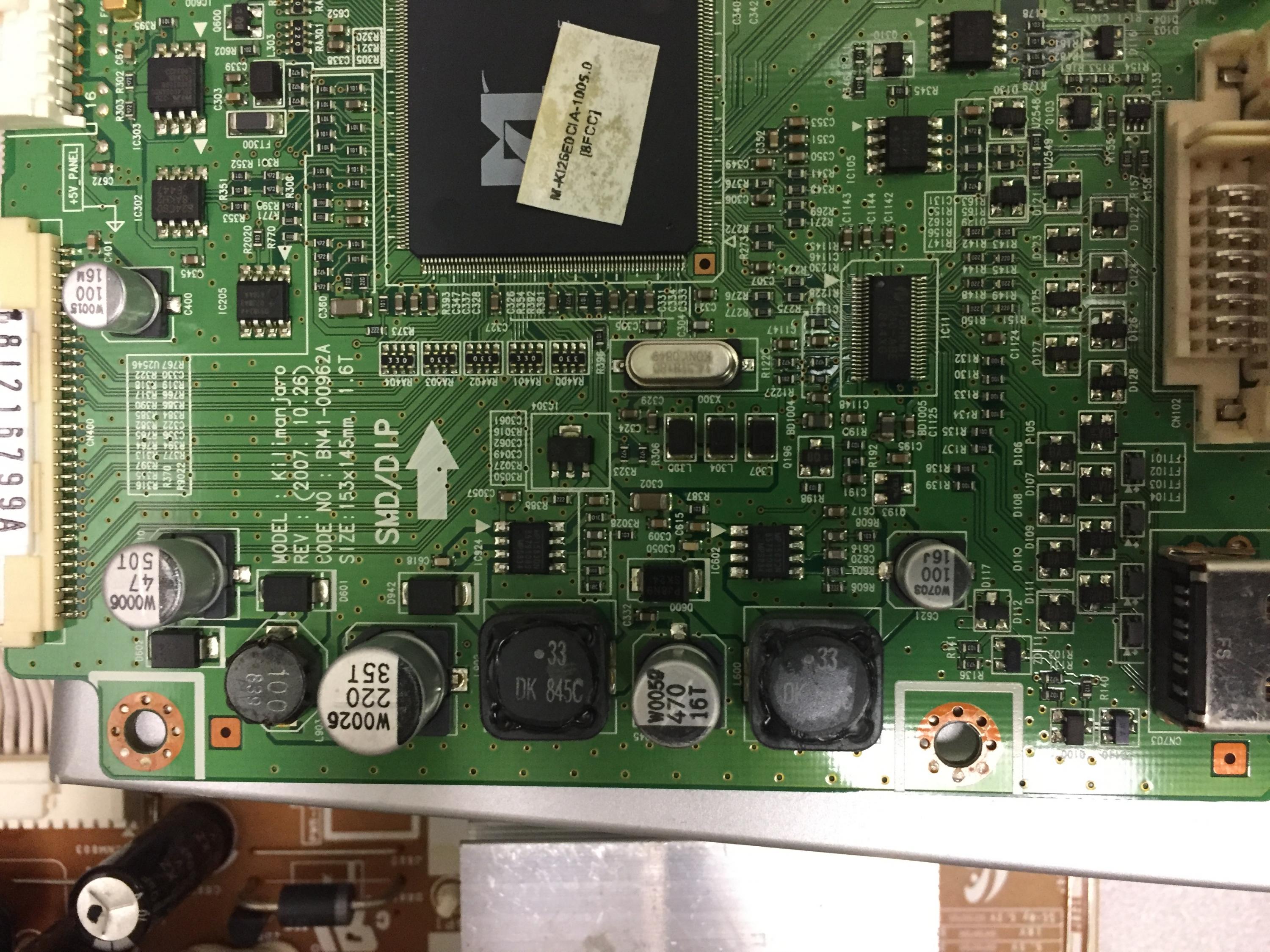

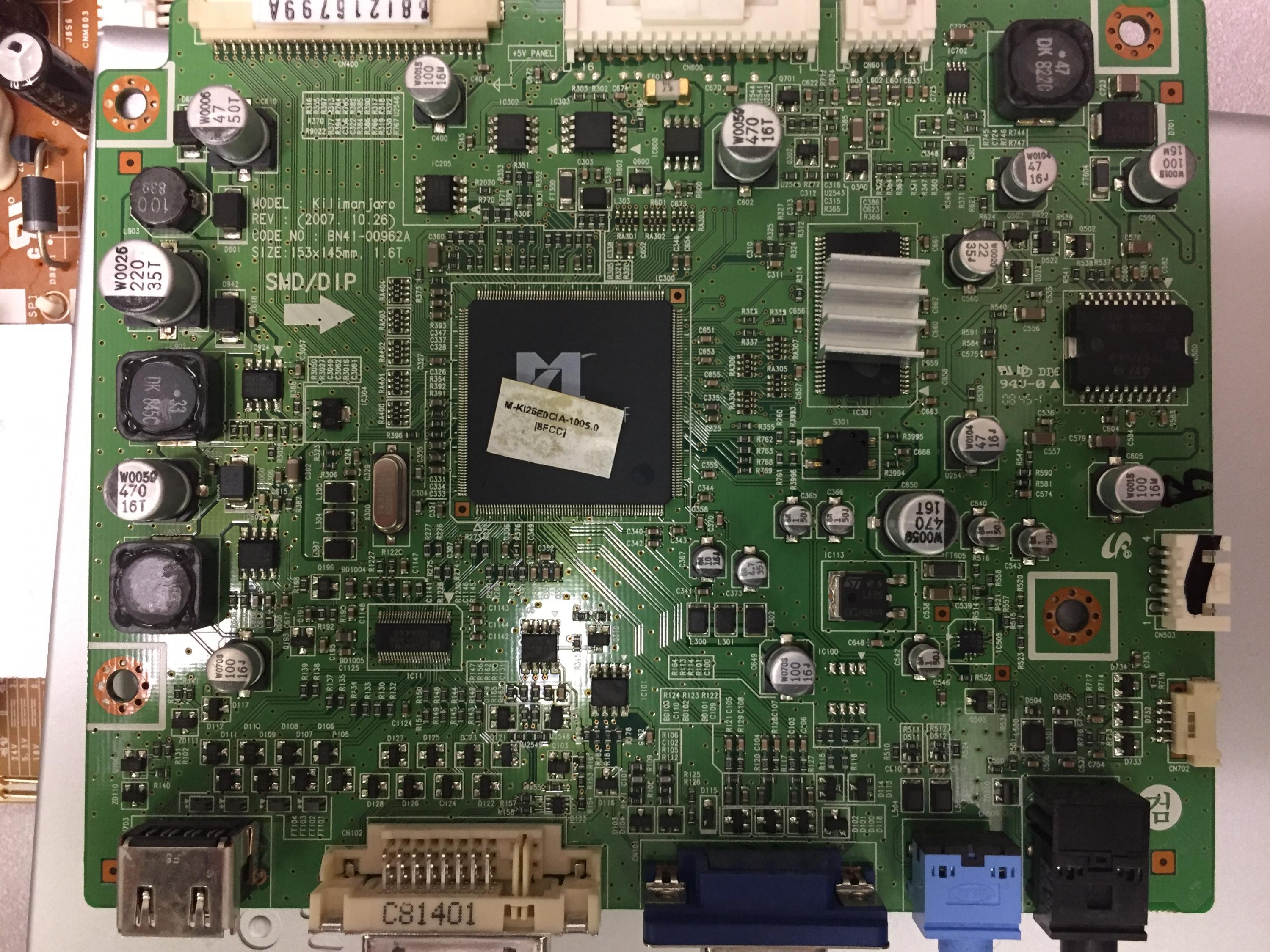

    I have disassembled the unit to remove inverter board, logic, and power. Visual inspection as expected did not show any visible signs of a problem else I would not need to post here.
    There is no other indication of a problem, meaning the power light, switch, controls, and such all work fine.
    I have a basic multi-meter, I have a macro lens, I have little time but lots of desire to save this monitor from the junk heap.
    I will attach the general pictures of the boards in the next post and await some help. If you want macro pictures of the components, please ask and I will respond when I can.

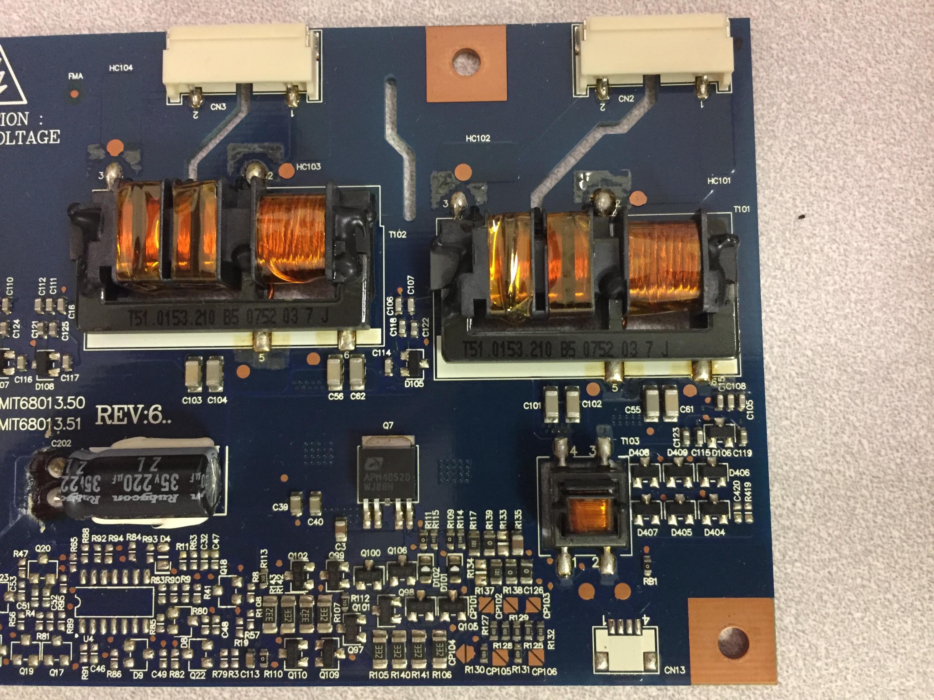

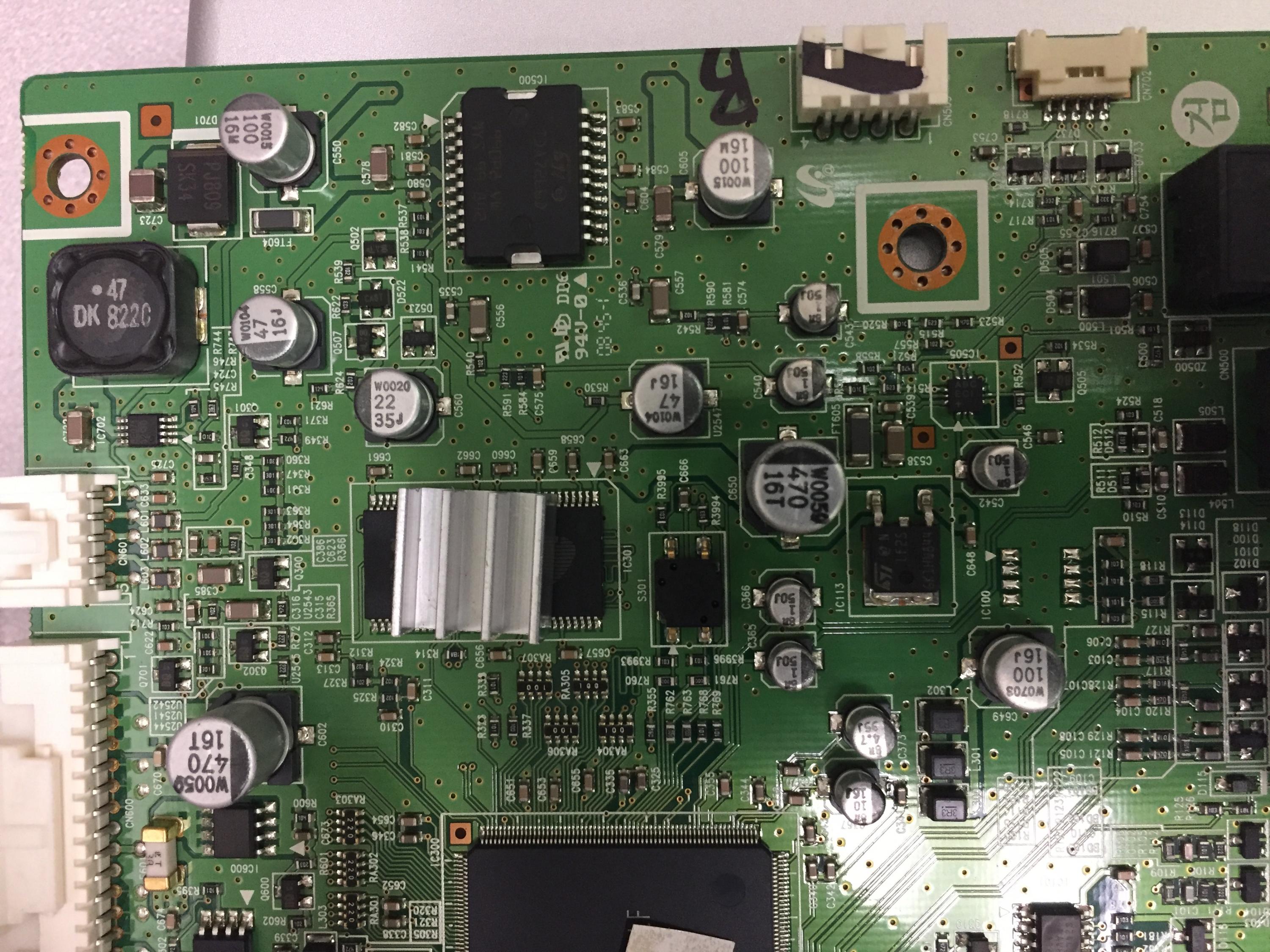

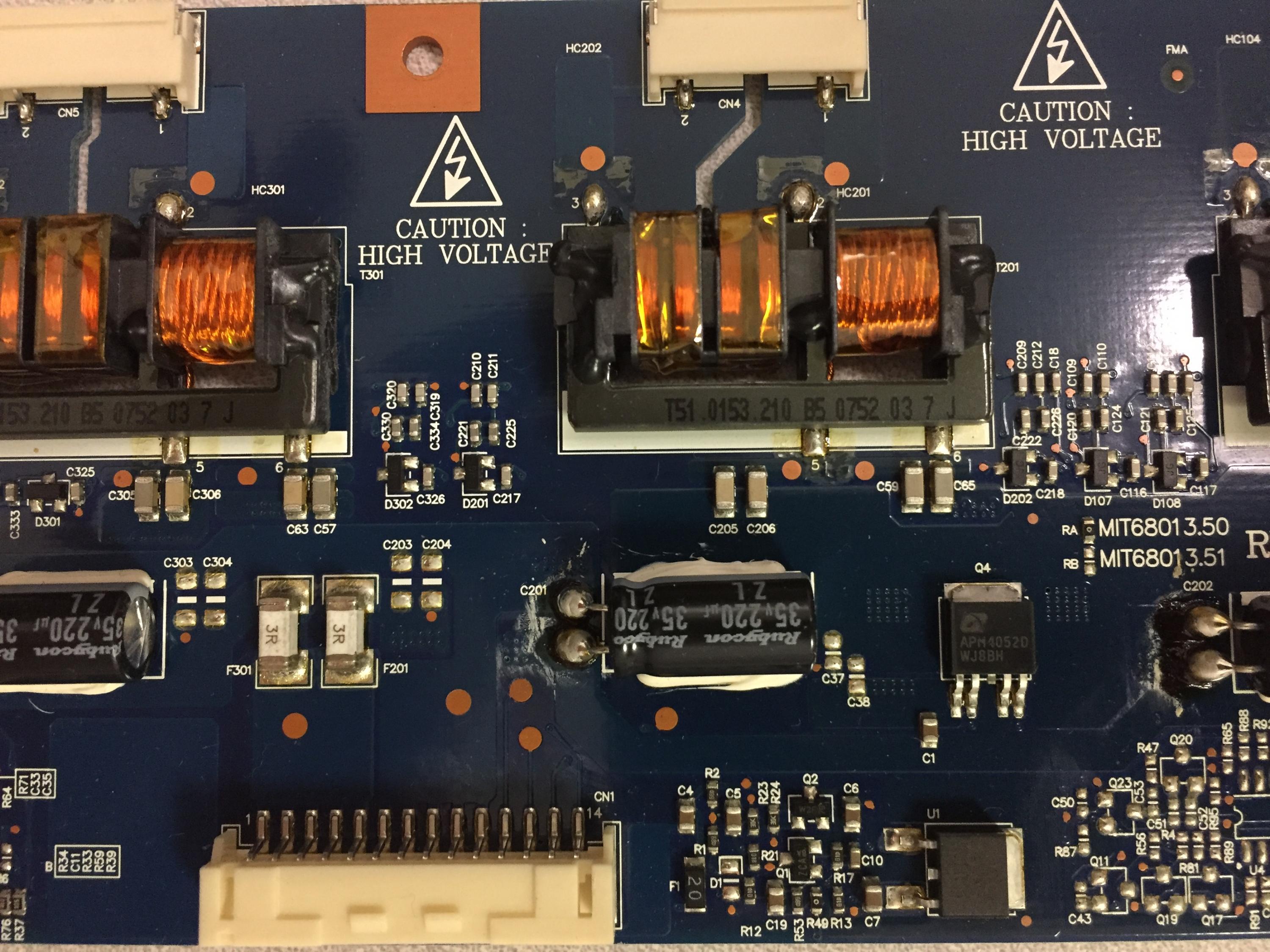

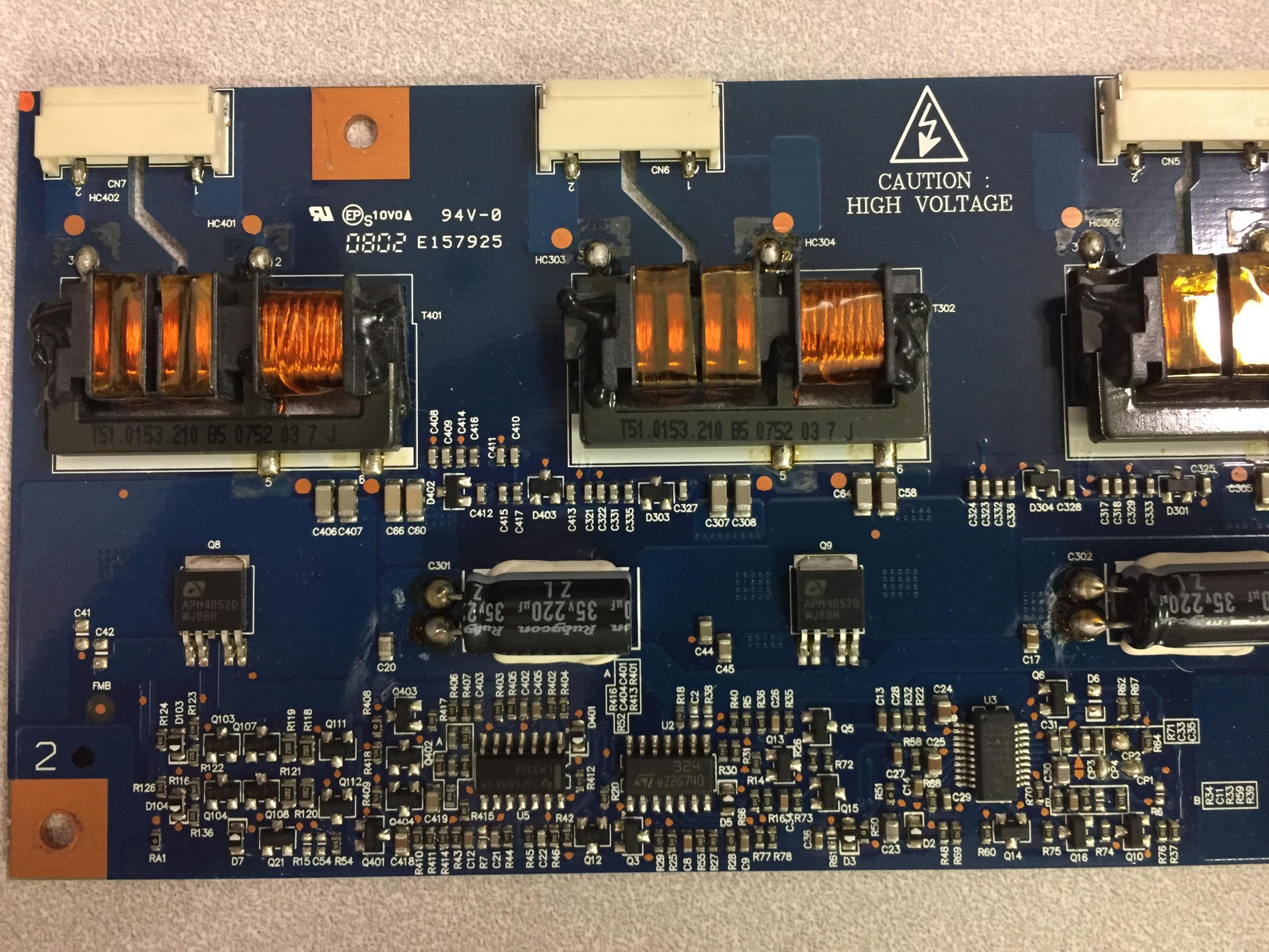

    Re: Samsung SyncMaster 2693hm - Dead backlight
    Inverter and logic boards.
    Power in next post.

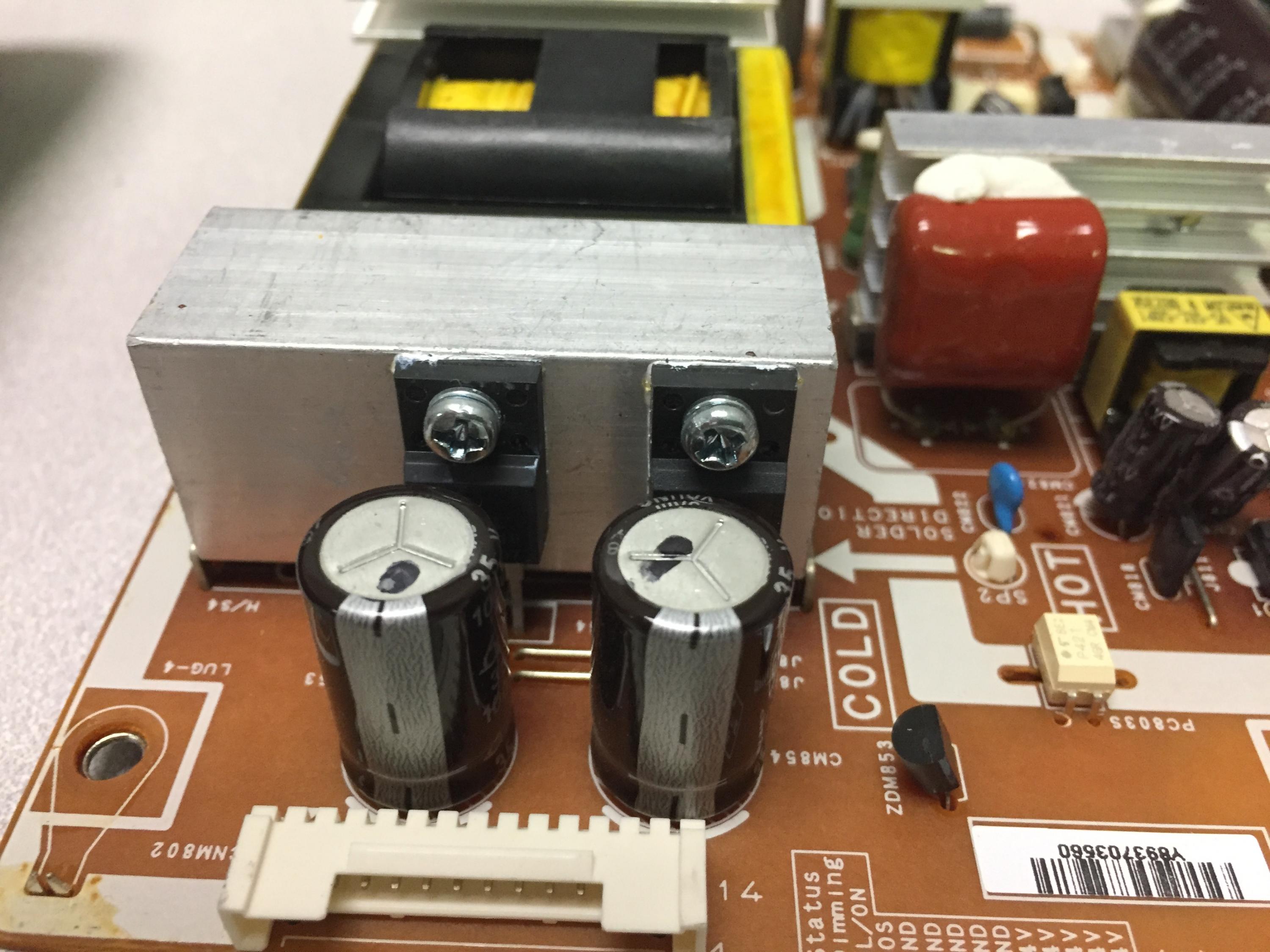

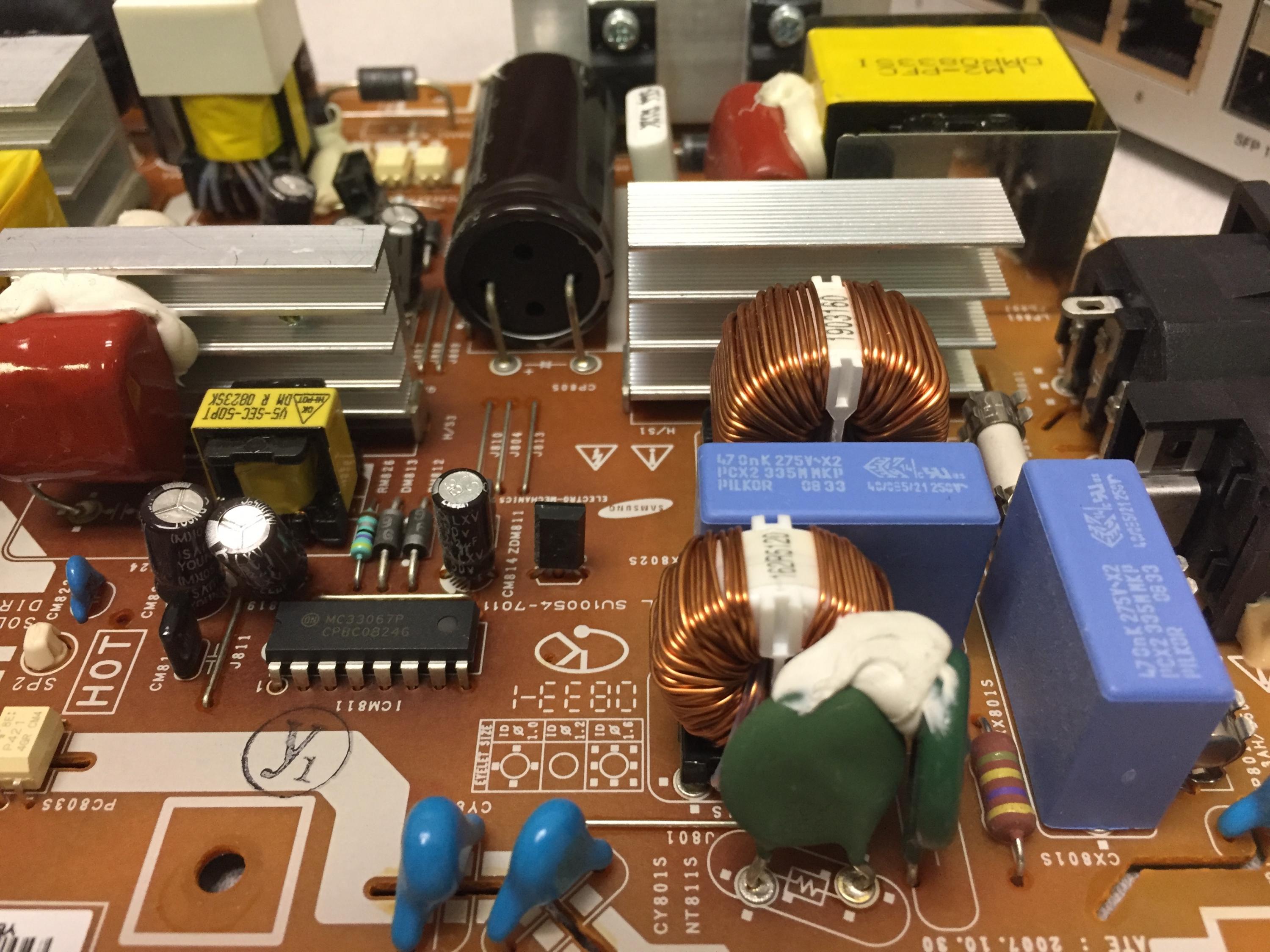

    • ensign.fodder
      • Nov 2016
      • 25

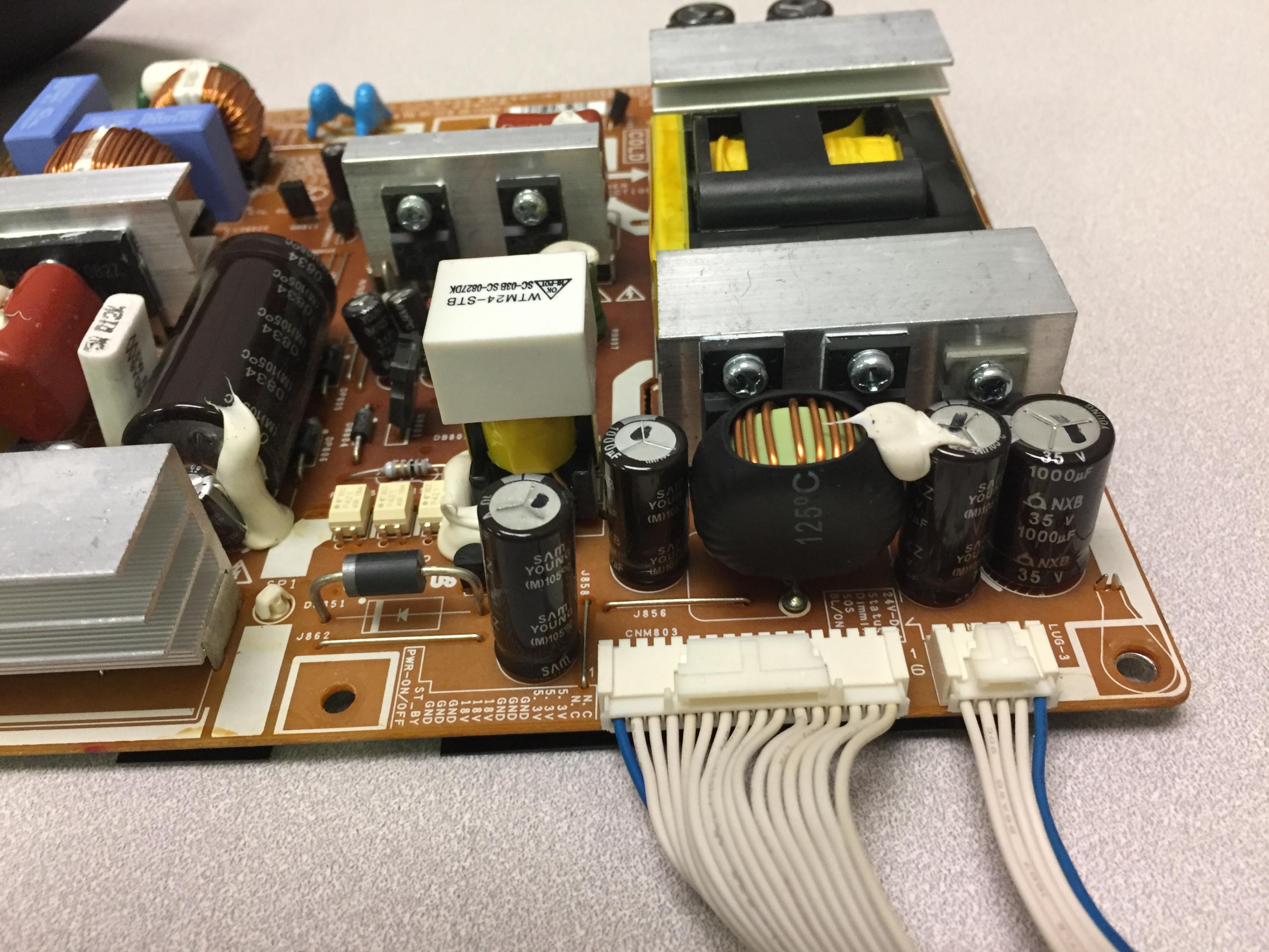

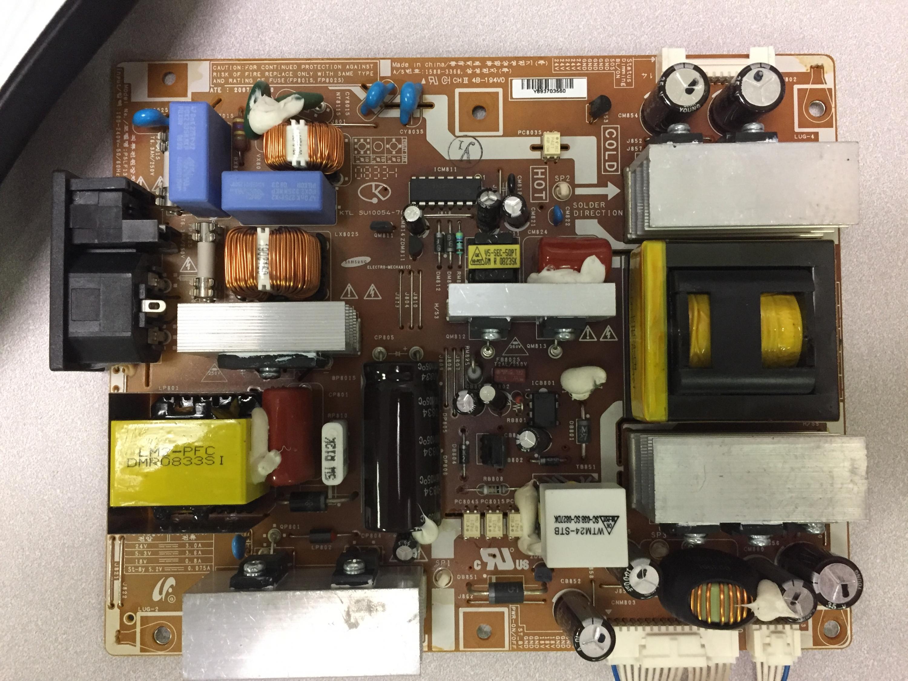

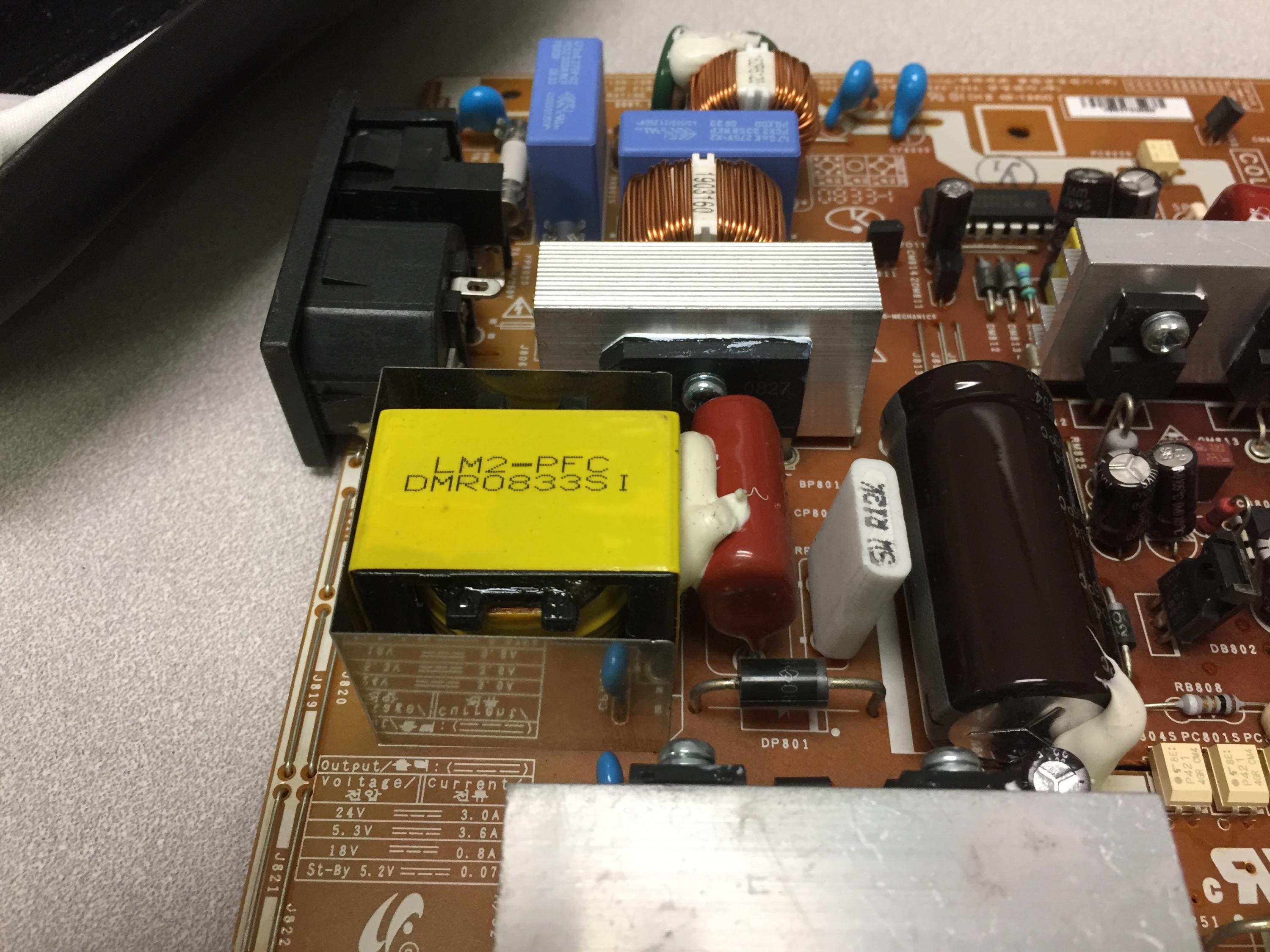

      Power board.
        • 30979
        the rubycon caps on the invertor are starting to dome.
        ZL's dont last anyway.
        the psu looks surprisingly good.!!
        • ensign.fodder
          • Nov 2016
          • 25
          OK - so happy to break out the soldering kit (iron, bulb, wick, etc) and replace those four. Can you provide a better sense of your answer, meaning how are they starting to "dome"? I checked the sticky (A guide on how to troubleshoot 2 seconds to black) and it says you cannot test the caps with a multimeter.
          Thank you.

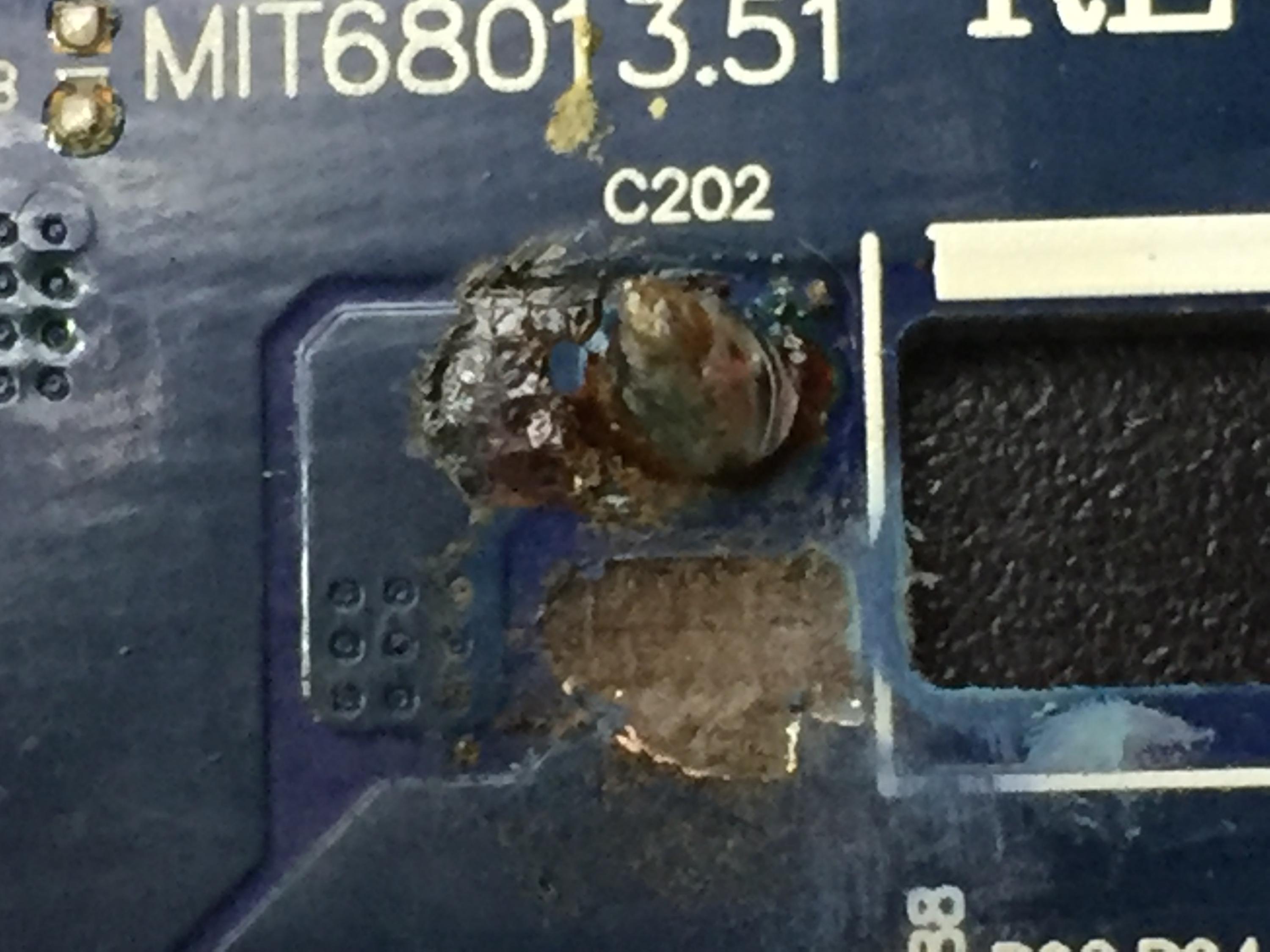

                        Next question - How to remove old caps safely?
                        So the caps are not through hole or similar, but have large globs of solder so I expect some sort of pad or similar underneath. I clipped the existing cap's legs off and was thinking about next step, and thought I would ask two questions.
                        1) Soften solder and use wick and bulb to remove and free cap leg or just soften solder and embed new leg?
                        2) If the pad get damaged, how would I know and what can I do about it?
                        Thanks!

                          • ensign.fodder
                            • Nov 2016
                            • 25
                            Re: Next question - How to remove old caps safely?
                            Thanks!
                            Any thoughts in this? I ask since I have seen some scorching (PCB) around the first one I removed and it did not come out clean. Meaning even with full solder melt it seemed "stuck" to PCB. Once I remove rest of the solder, I am afraid for what I will find. Second leg on same cap did not present same issue. Solder melted and leg came out leaving solder blob in place.
                            Thanks for all the help.
                              • 30979
                              the "scorching" is probably flux, try to scrape it a bit with a flat screwdriver.
                              • ensign.fodder
                                • Nov 2016
                                • 25
                                Did as requested but still not confident that part of the PCB did not come off.
                                Will post pick in a minute.
                                I did find the edge that showed copper color and tested conductivity to next pad so I think I have enough to work with but may always be a point of failure.
                                Of course I have to see if this fixes it in the first place.

                                  • cpt.charlie
                                    • Sep 2013
                                    • 270
                                    • Spain
                                    You need to check signals like bl_on and have a look at the inverter controller IC.
