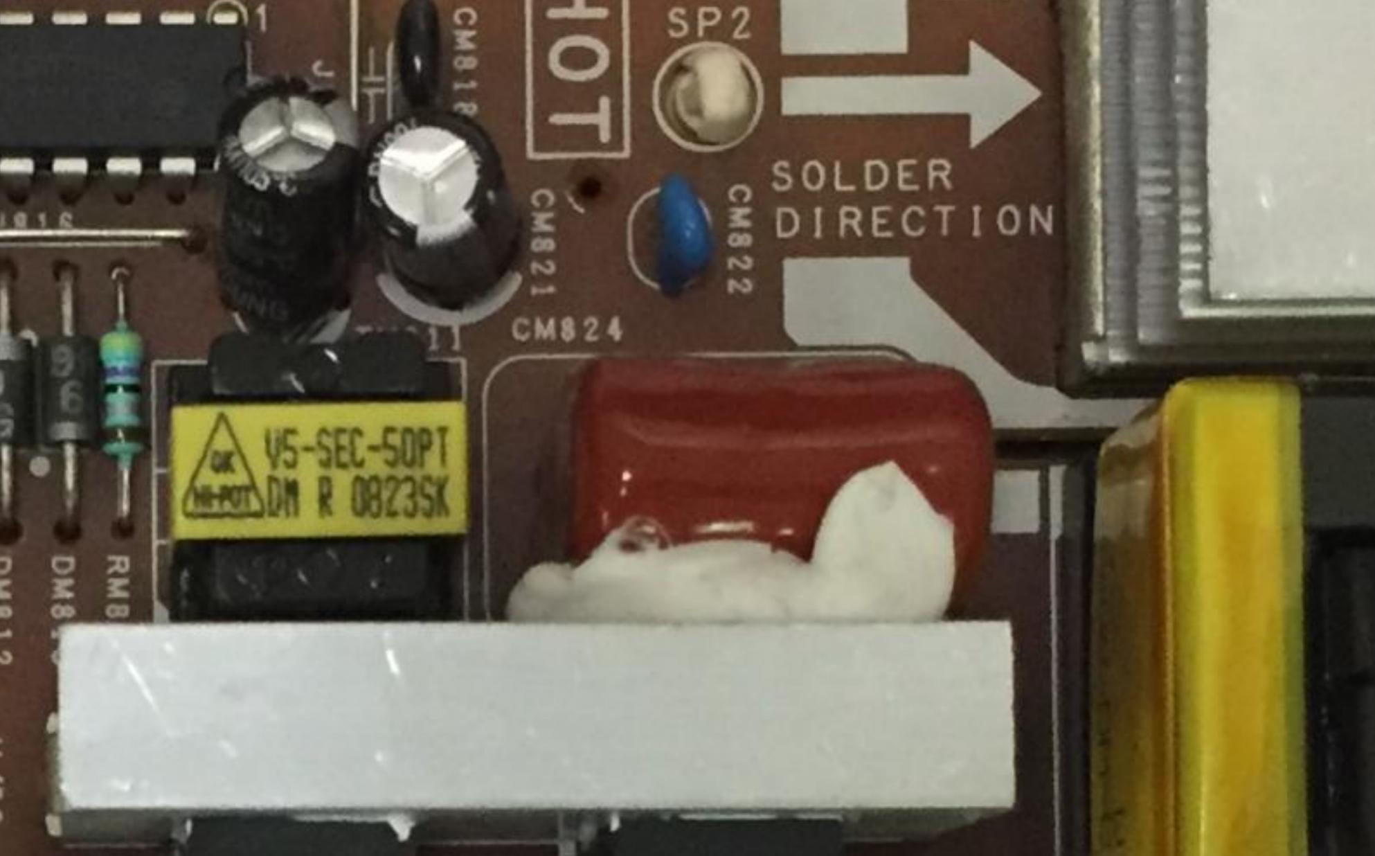

    See those connectors? They have labels for each pin to tell us what they are for, so we need you to take DCV reading of each pin when the unit is plugged in but the power switch is not activated, then take the reading again after the power switch is activated.
    You MUST report the readings in the format that we can easily read by putting down the PIN NAME, and follow by the DCV readings, very simple request. Black probe of the meter is on GND pin.

                  You do have 18V/24V power supply problem.
                  You need to check the CAPACITANCE of CM824.

                        That cap only needs to be tested for capacitance.
                        You can buy an new board if you do not want to buy more tool or just replace cap and see if it will fix the problem or not.

                            One think I forget to ask you to check is the DCV between the two legs of the main filter cap (the 450vdc large cap laying on its side), it should have about 380~400vdc.
                            Be real careful since it is in the hot side of the circuit.

                              It registered ~312vdc and CM824 ~157vdc.
                              Let me know next steps and thanks again.
