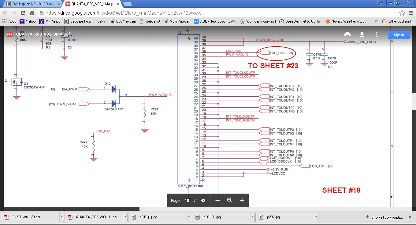

    Hello all. I'm new to the community and my apologies if this was discussed in a previous post. I have a Inspiron 17R N7110 that has dim backlight to the LCD. When I plug it it to an external monitor i can see everything in that monitor. I searched every where for a solution but nothing on my model, all I find is solutions for the 1545 model which tells me to replace the F1 or F8 fuse. If that's the case on mine, does anyone know where are those fuses located? thanks in advance
    My motherboard model is
    DA0R03MB6E0 REV; E

              I think the video cable connects to J2 ( IMG_0025) near hole and RB's mark.
              @bigsam731
              To check circuits was work or not, make sure you've connecting flex cable to mobo.
              - measure on pins 38 39 40 of J2 connector (P.18 on schematic) should be +19V
              - on pin 2 & 3 of J2 should be + 3.3V, This point usually have problem, if you get no voltage in here, trace back to signal LCDVCC_TST EN, sometimes bad mosfet or missing signal en for Q2 ( more complicated, could be chipset was bad, hope not)
              - on Q23 at gate should be high to transfer +3.3V_RUN to be +LCDVCC

                        So this what I did for a test, I attached pin 36 on the LCD cable to pin 2. And sure enough, I NOW have back light on the LCD. I know its a bad soldering job but I figured it was just a test. Here are some pics...

                            The only thing that I thought, could be that the voltage come from panel itself, and need signal at pin 36 to generate small sircuit and make 19v pulling down and then make panel be working
                            after all this, we don't know is it safety for KBC or not. I see you get access to touch KBC chips, Do you feel the KBC get warm?
                            And That thing is beyond my knowledge
                            We need for any advise from other tech guy

                                Pin 36 (LED_EN, PDF page 15, 19) is the same as BL-ON pin, <1V = Backlight LED off, >2.5VDC = Backlights LED on. This BL-ON command signal comes for the main board to tell the LED backlights circuit to turn on or to turn off, so it looks like the mainboard is not sending the command signal to allow the pin 36 to swing high toward the 3.3VDC. I would use 470 Ohms resistor between Pin 36 and the 3.3V power supply, never connect anything directly unless you know for sure how the circiut functions.
                                Since you are able to force on the backlights AND the cable is still connected to the main board, it means that the pin 36 may have the open circuit back to the main board where the switched transistor and the pull up resistor are otherwise you would not have been able to force on the backlights, the transistor must be in the OFF mode right now, if it is on that would have damaged the transistor when you jump pin 36 directly to pin 2 (3.3VDC supply) and the pull-up resistor is not in the circuit right now either to pull the pin 36 high to make the backlights come on, if the resistor is present and the transistor is off, the backlights should be on without forcing on pin 36 with 3.3VDC.

                                    What did you use for the GND ref for the meter when you measure the DCV on pin 36 with the cable back in place?
                                    I see the LVDS connector on sheet 18 of the SCH, PIN 36 is named LED_BAK, I see that it goes to sheet 23 of SCH to pin 18 of IT8518.

                                      I used different GND and I still got 19V on pin 36. And yes that is the only connection I see between pin 36 on pg. 18 and pin 18 of IT8518. However, there is a resistor (R472) on page 18 that is between the two pins. I might be wrong but I don't see any other connections there. I don't understand how IT8518 is supplying 19V to pin 36 unless its coming from somewhere else.

                                        I doubt that you are getting 19V otherwise lots of components in that section would have been damaged including the circuit in the backlight control circuit.
                                        The key point in this case is that the DCV on that pin 36 should toggle between <1V for LED OFF and >2.5VDC for LED on.
                                        That 10K resistor between pin 36 and the circuit GND is there so the input at pin 36 will not be floating, it is terminated with 10K (R472) Ohms, you should read the DCV between that 10K (r472) legs to see what you have.
