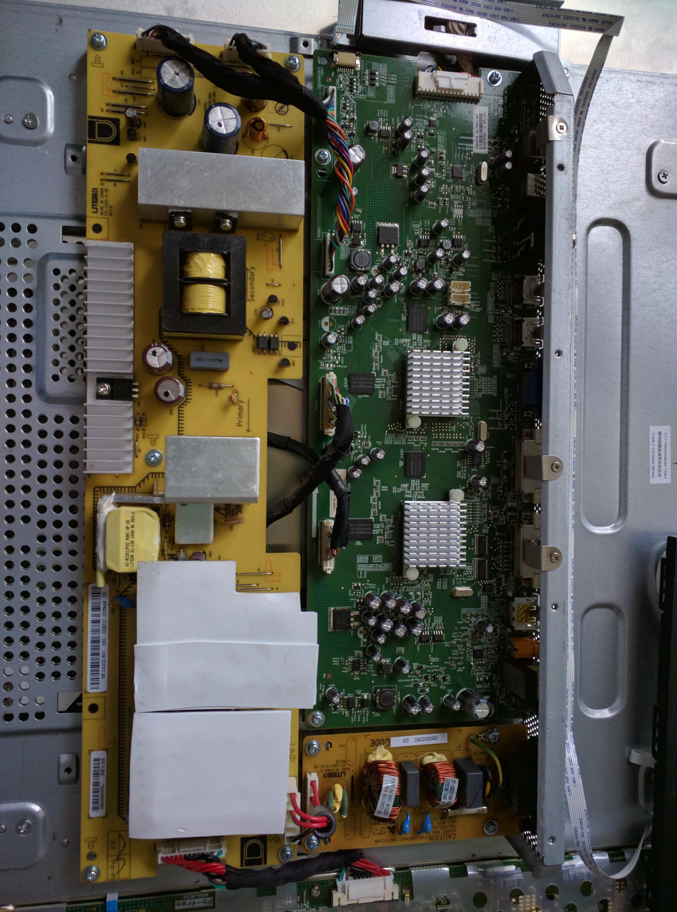

            Maybe upload some high resolution straight shot pictures of your PSU and mainboard.

                  Re: Dell U3011 no display after a few minutes
                  This is what the board looks. I looked at the caps and didn't notice anything out of place. The board does make kind of like a high frequency hum when the monitor is on, but does not have input.
                  I don't have really any tools that are specific to troubleshooting electronics, but can probably get access to some if I know what I need.
                  Thank you for all of the help. I will post steps on how to dismantle with pictures shortly.

                                  With a DMM measure the resistance of the output winding on each transformer and compare them to each other. IF there is more than 3% difference, it's bad.
                                  Since the monitor comes back on when you shake it, it sounds more like some cold solder joint or a bad connector?

                                    It could be. I'll check the solder joints. It would come back to life when I would shake it while it was fully disassembled. I put it partially back together so I cold use the stand with it and now shaking it does not bring it back to life.
