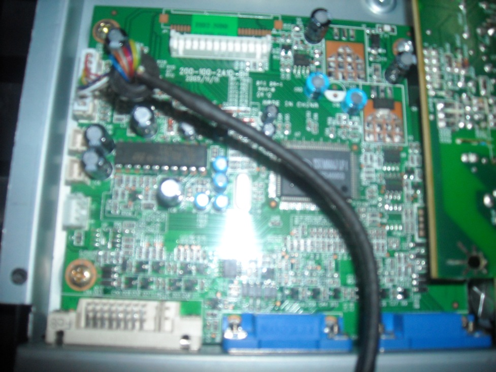

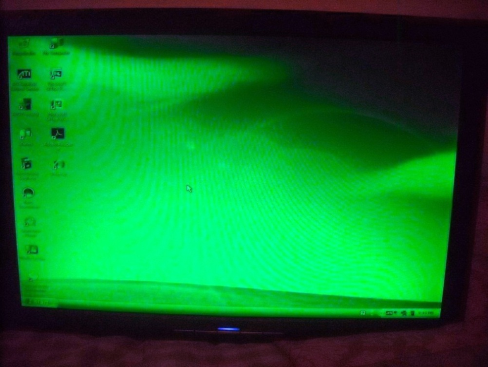

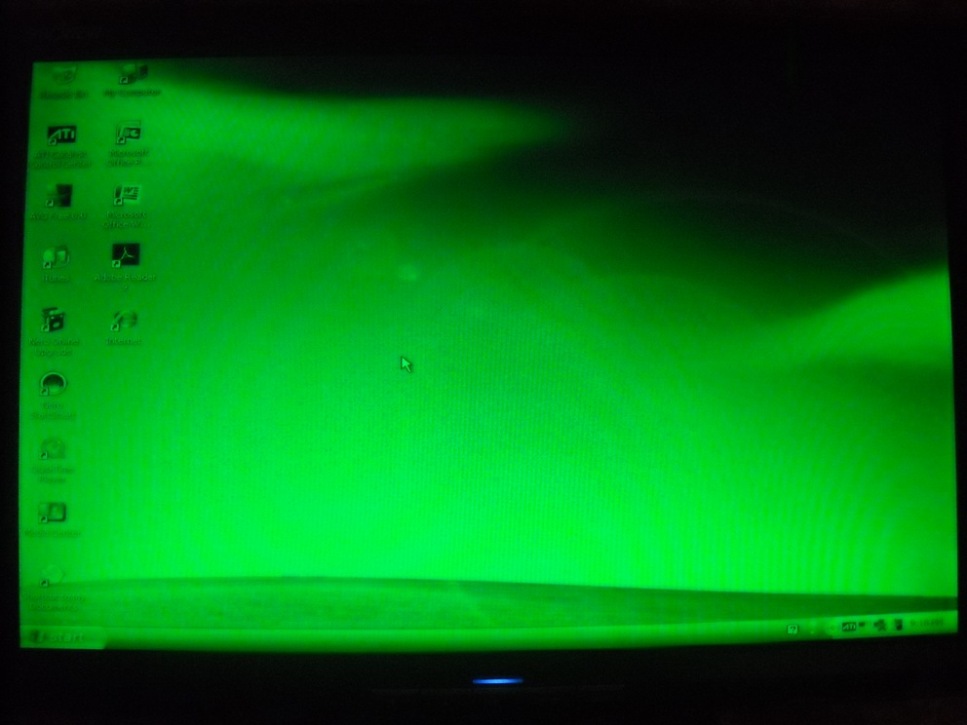

    Proview Pl926wbi
    i have opened this moniter and checked all power supplies including fuses,caps and cant seem what the promblem is. I suspect that is the logic board.Dose anyone give me advice
    thanks, olivercan
  • geforcefly
    • Jul 2006
    • 33
    Re: Proview Pl926wbi
    When I see a display displaying only one color, chances are it's the video cable or the computer's video card. Try a different cable to see if it changes things.
    • kc8adu
      • Nov 2003
      • 8832
      • U.S.A!
      esp if the menus are in color.
      a long shot but could it have a mono setting in the setup?
      mashed pins in the db15?
