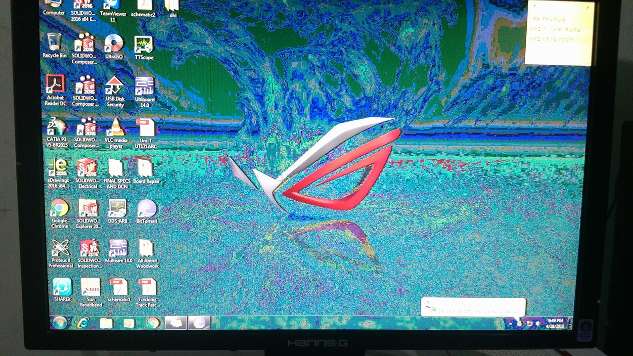

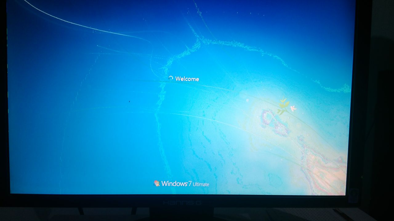

    I'm having problems with my 8 yr old monitor (Please see attachment). Is it a corrupted firmware? Do anyone have a firmware of this model or any service manual? I think it has something to do with the LVDS mapping but i don't have any info regarding the service mode of this monitor. Any help will be appreciated...thanks..

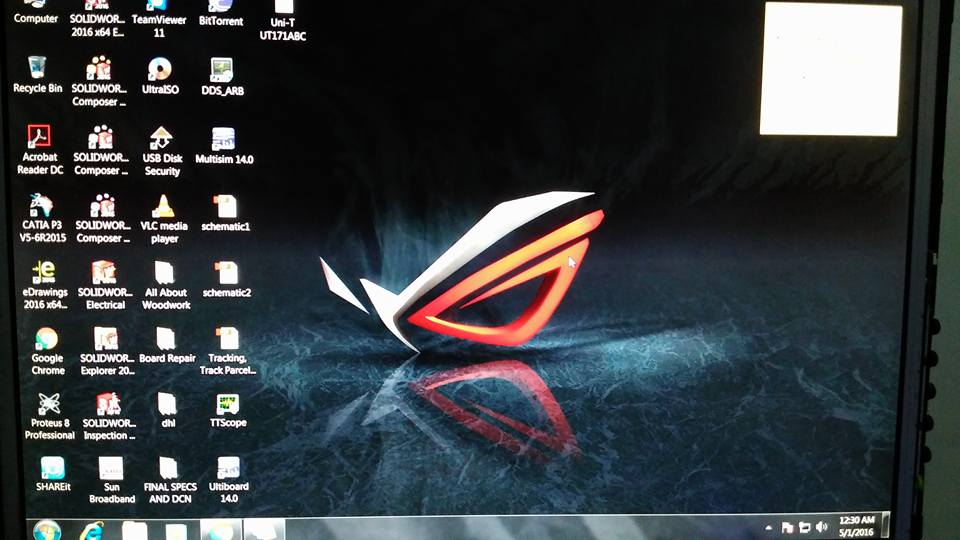

    Done. Problem with LVDS cable. Since no replacement available, just fixed cable temporarily using hot glue.
