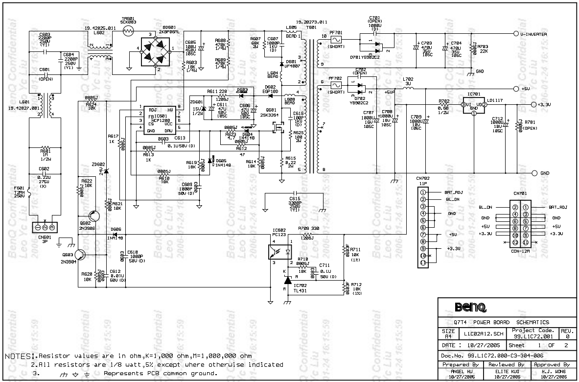

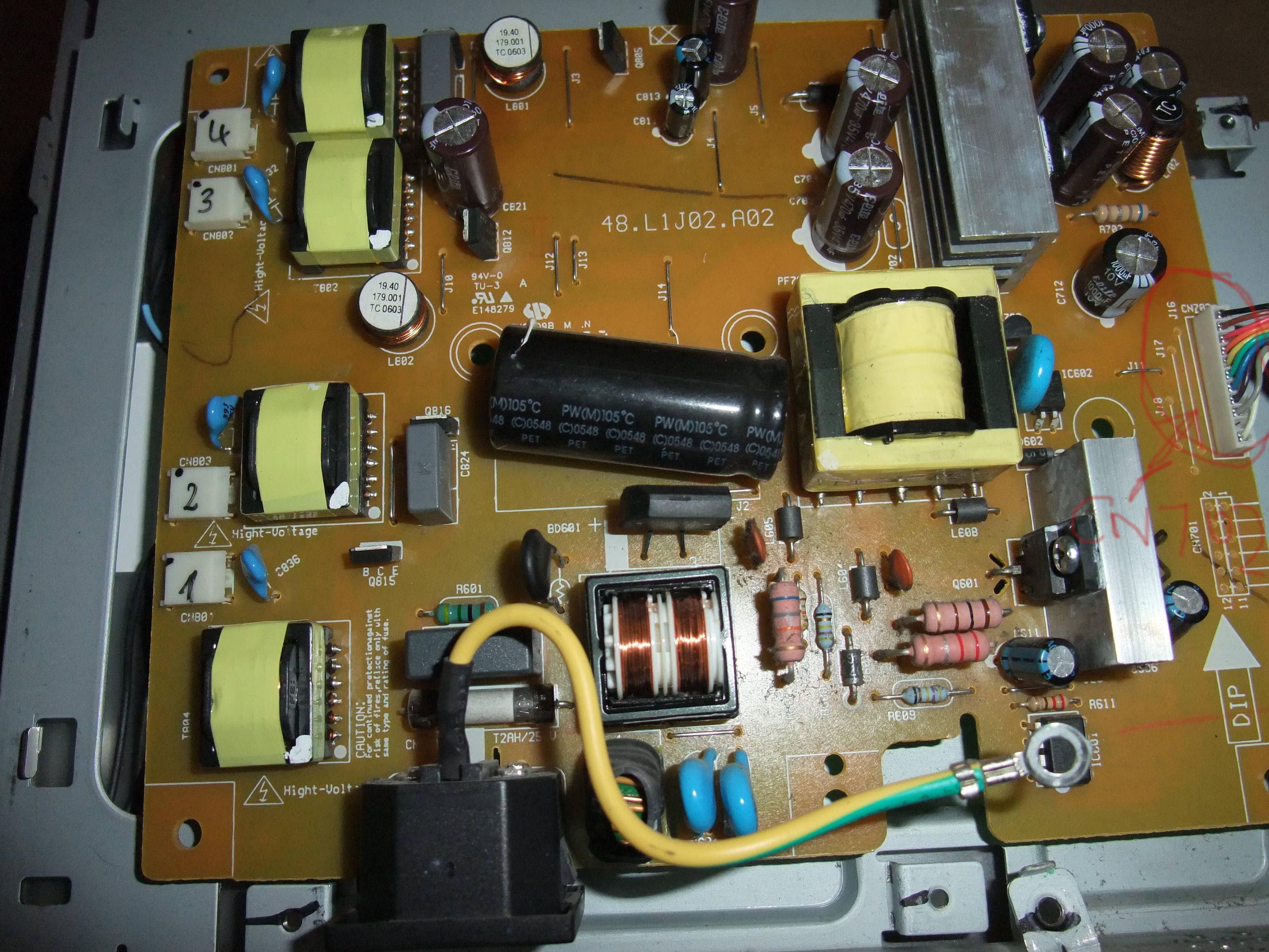

    I'm a little lost on how to solder a led conversion kit to my BenQ monitor.
    This is the LED inverter I have:
    http://www.laptoptvparts.com/product...o-led-monitor/

    I figure ENA, DIM, & GND are located at CN702 as they are shown there on the schematics but where is the VIN? There aren't any 12v caps.
    Re: VIN/12v on q7t4/fp91g?
    The output of the power supply that has V-Inverter lable as shown in the diagram is the one you will want to use to power your LED driver. Just solder the V+ of the LED driver to the positive leg of C704, the GND to the Negative leg of C704.
    BL-ON is connected to ENA

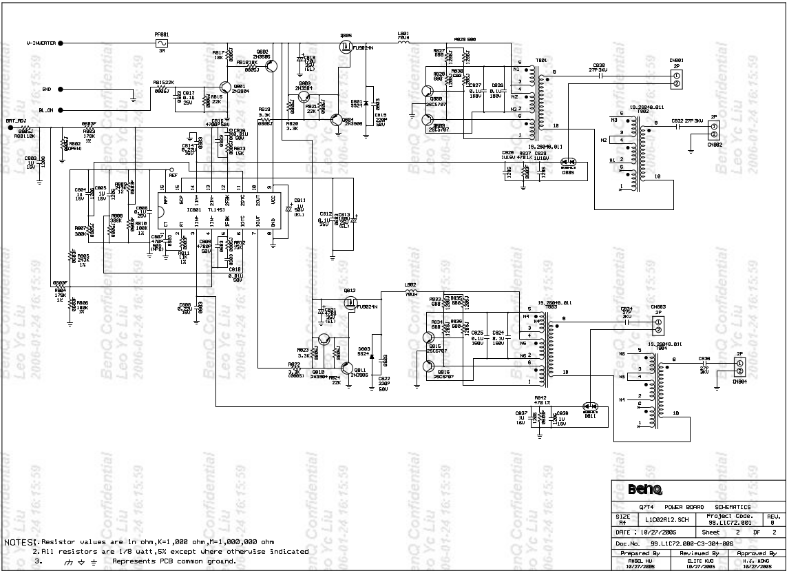

    BRT-ADJ is connected to DIM but you must remove the resistor (on the second page of the diagram) that is connected to that BRT-ADJ pin.
    Fuse PF801 should be removed also.
